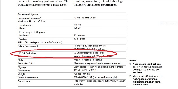

If you ask me, my active setup was driven by 3-way Hypex Fusionamps, that was the setup with the capacitor test too. The tweeter was a CD+horn with sloping down frequency response towards highs, so in theory it was logical to use a capacitor to get a more flat fr response to begin with, plus in theory it provides a better protection for the high fr driver, but we can see from previous replys that the extra protection is not necessarily true in all cases.
Anyway, if the capacitors had a transparent sound, they would have stayed in the signal path, but I didn’t hear it that way. The same happened with an L-pad to passively reduce the tweeter level.
