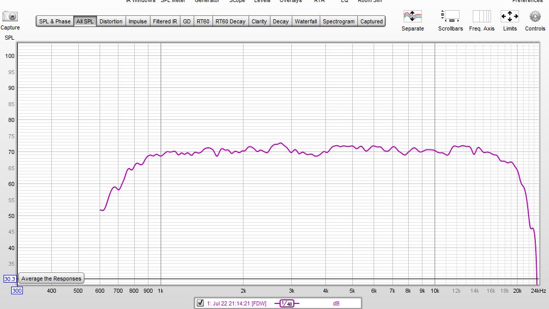

As for the 18Sound comps, I should be sorting the amp issue or taking more measurements but I can't stop listening to them! Incredible amounts of resolving power, well recorded vocals sound uncannily real but with none of the harshness that I find uncomfortable with most of the Ti diaphragms I have heard. My room is quite small and I was afraid that these large horns would be too much but they work beautifully.
Frequency response using just two bands of EQ. This was with a 775Hz crossover but I am now down at 630Hz. I don't have a raw measurement saved but It looks very much like this except it drops off above 10Khz
