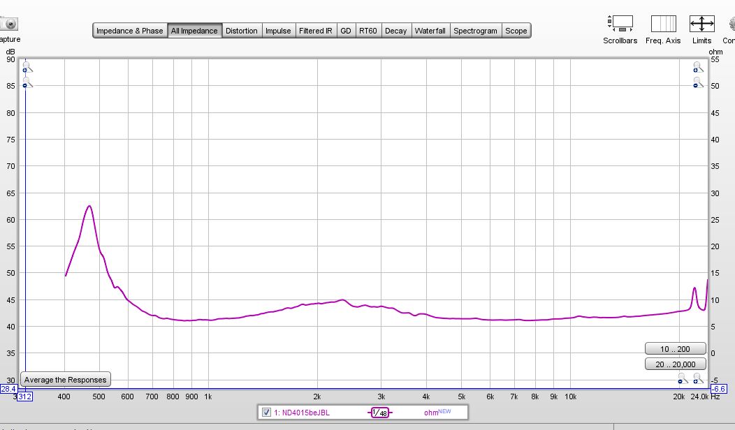

Here is an impedance plot of the ND4015be on JBL 2384 for anyone who's interested. Breakup is above 20KHz so not bad for a 4" diaphragm!

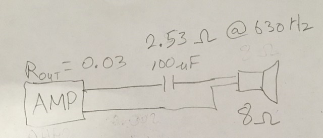

Is the mecanism described about amplifier damping factor 'protecting' the CD at work with tweeters too?
A series capacitor would eliminate or reduce damping of a tweeter, but lacking a horn, would not result in as much diaphragm movement resultant from exposure to high SPL low frequency.
Mpa's concern is from the amplifier side, my bringing up the capacitor problem in this situation was just for "completion" ;)
Art
Myth?

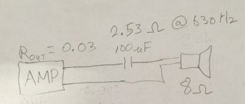

If you use 33 μF cap for 1st order, it inserts 7.66 Ω at crossover.
Not much damping there.
If you spend a lot and use 100 μF, as shown in sketch, it inserts less impedance.
Either ways will neuter your high damping factor amp.
If we are talking about a woofer, we could add Some damping to its cabinet.
Not so with a tweeter nor a CD.
There are better ways to add passive DC protection without crippling damping.

Which would be a "better" protective solution for a 4 Ohm tweeter in active setup ? :
A bigger capacitor in series outside of the crossover slope or half as big capacitor + 4 ohm resistor in series ? Im asking this mainly in hope of reducing capacitor size .

Why go an octave below. Put it right in the crossover region. Do your crossover measurements with the cap in place.
This is not correct. A capacitor selected for the existing crossover frequency will add addition slope to the tweeter crossover and cause additional phase shift.
An octave minimum or two below the crossover frequency is my recommendation.
The primary goal is to keep DC out of your driver not to make the capacitor part of the crossover.
DT
Well, I'd say it was correct, as the suggestion was to make it part of the (overall) crossover (slope), so that the active crossover would need a less steep slope, hence the suggestion to take new measurements with that cap in place. After all, for a decent crossover performance one would need to shape the acoustical output. Not selecting a named crossover in software. So it could work to make the protection cap part of it.
It would limit the possibilities to play with the cut-off frequency.
Hello,
If there is already crossover in line between the amplifier output and the speaker there is already a capacitor protecting the HF driver. An additional capacitor would not be needed.
The OP tells us that this an active crossover Bi-amp setup, why make the protection capacitor part of the crossover with the problems of phase shift and the like, in the middle of the 300 to 3000 Hz frequency range, the goal of bi-amping is to avoid all that stuff. It is a mistake to add a inline capacitor in the middle of the crossover frequency.
