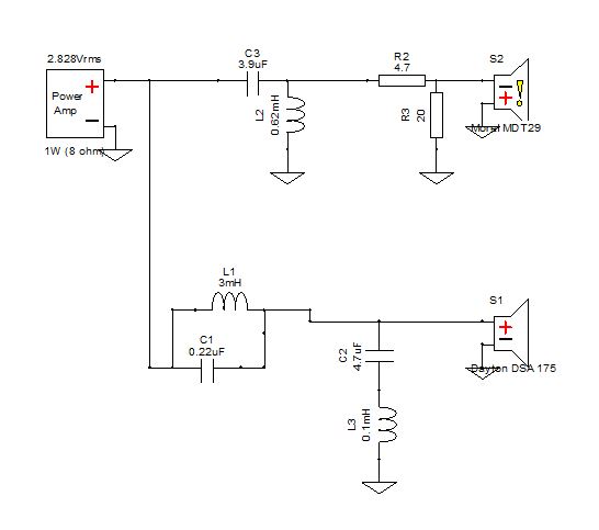

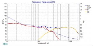

I had a go at a draft Xsim crossover for those drivers using makers' data, no measurements means it won't be accurate, of course. But it should give you a start.
As noted, I'm a beginner at all this and do not have the expertise or knowledge that other more experienced forum members will have. So please, seek their input.
I've assumed your cabinet is 8-10" wide. I would add that most projects which use the DSA175 use a smaller cabinet than yours, so after you see how it sounds, you made need to install a shelf to reduce the volume.
The Morel tweeter seems to take a dive after 10,000 Hz, but so do my Morel CAT378s and they sound fine.
HTH
Geoff

NB I was not able to obtain the ZMA (impedance) data and graph for the Morel in a form where I could use 'fptrace' on it to convert to a graph. There's a hefty impedance spike at 1,000 Hz which might need treatment by way of a resistor across the tweeter terminals, probably a 33 ohm would work, but you should seek another opinion on that issue.

This coming week I will get real data and add to the information here. I hope that can help some with what you are calculating. I noticed even with your software and designed crossover there was still a bump right where I just made a cut. I find that interesting. I have my laptop all setup with REW and mic ready to make some real measurements this next week.
I'd only regard a sim done without measurements as a starting point. Not surprising that my sim has some bumps, etc.
The sim is just that - a simulation, based on manufacture's data and in the case of the Morel tweeter, traced from that data as best I could. That data may not be accurate; some maker's data is reasonably so, others' is not: "Garbage In, Garbage Out". The Dayton data is, I think, based on an infinite baffle system and will differ from what's measured when in situ, but their data is widely regarded as accurate.
Good luck with your measurements, I think they will prove interesting.
