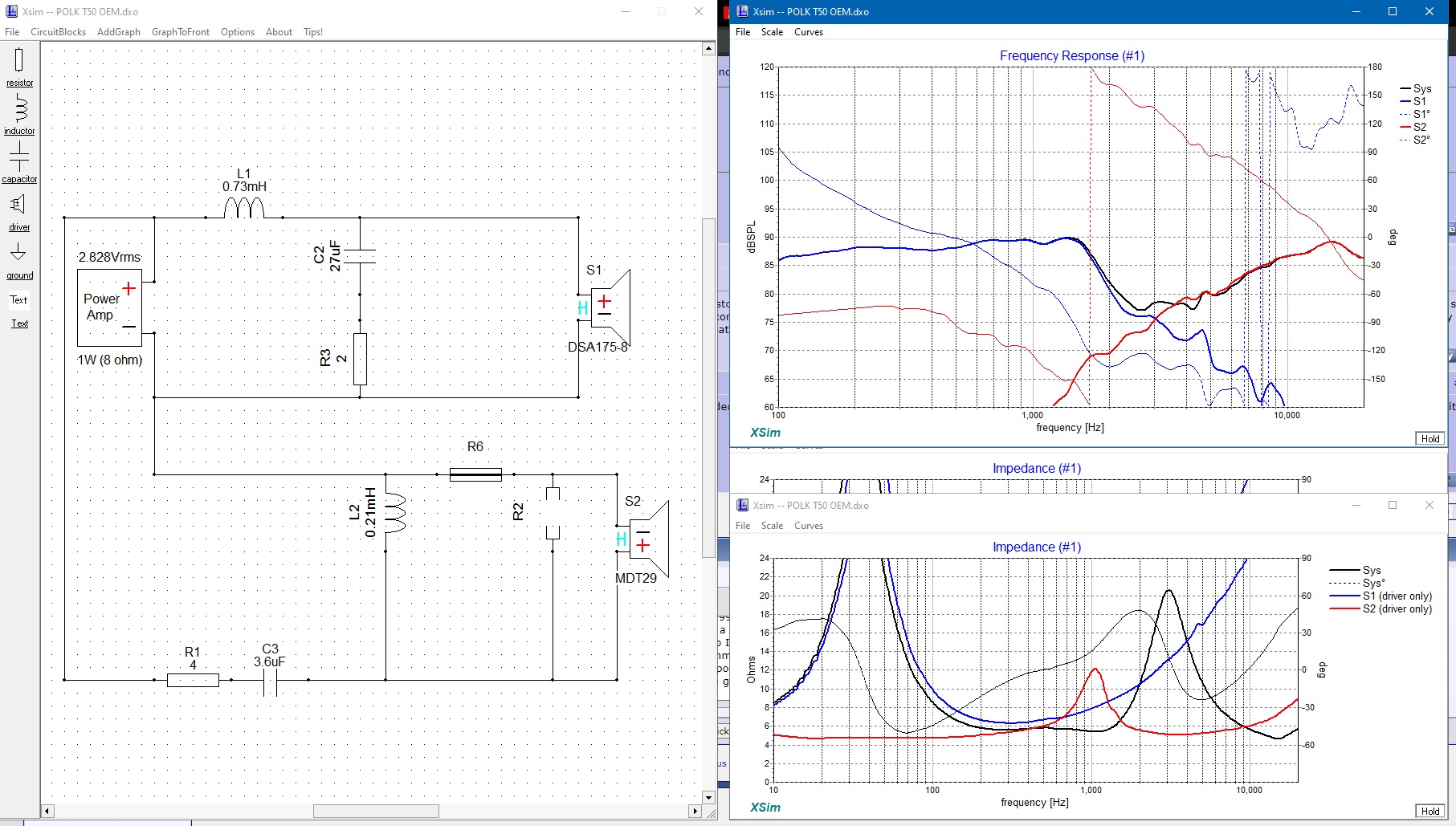

I have learned so much the last couple of weeks and I want to touch back on one of my original goals in working with these Polk T50 speaker systems. These can be bought all day long not only new for cheap but also you can find these with blown tweeters because well sorry Polk but these are some really weak *** cheesy tweeters. Best Buy often has these brand new on sale for 99$. Heck you can buy them new mod them and sell the original drivers on ebay to get a little coin back. You can not build a box and buy passive radiators at that price level. So I want to share with you all my reverse engineer of the OEM Xovr in the following attachments. With only 2 Xovr components changed you could be darn close excepting for power handling of the modified Xovr. I only have gotten to this point with Allen's help in guiding me on a handbuilt Xovr so credit given there. The Morel MDT29 and Dayton DSA175-8 takes these boxes to a completely new level. I think if you did not intend to push power too much the modified original Xovr this path could be decent. With a proper built one and even the generic ones Im using these are LOUD and CLEAN. I like these as a project suggestion for those that do not have lots of tools nor wanting to build a box from scratch. A lot of research and thought has gone into this so far and Im getting there. I believe these fill a position with regards to size, and ease of mod that makes the project attractive. Flame away tell me your thoughts, I do know this though regardless of the extra cost of the MDT29 I am in Love with these tweeters, these will take more than my AVR has and that is WAY beyond the levels of listening DBs that are healthy anyway.

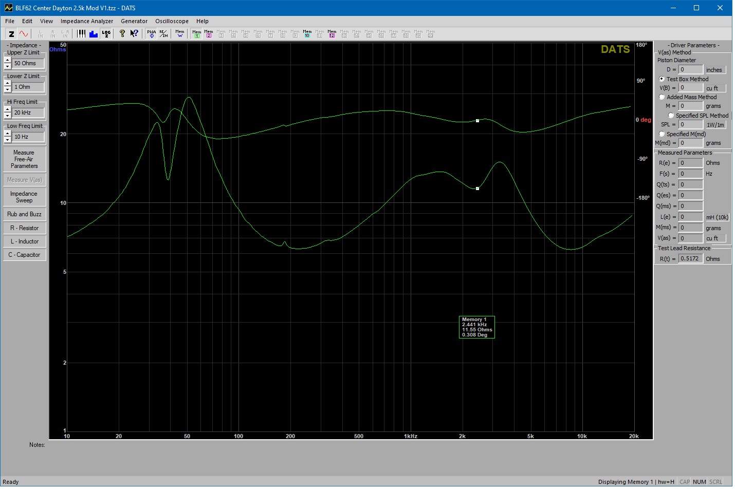

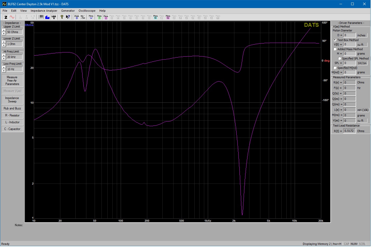

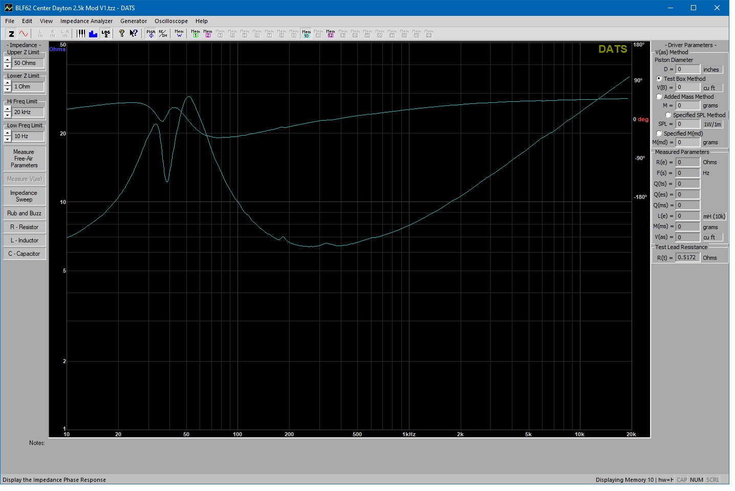

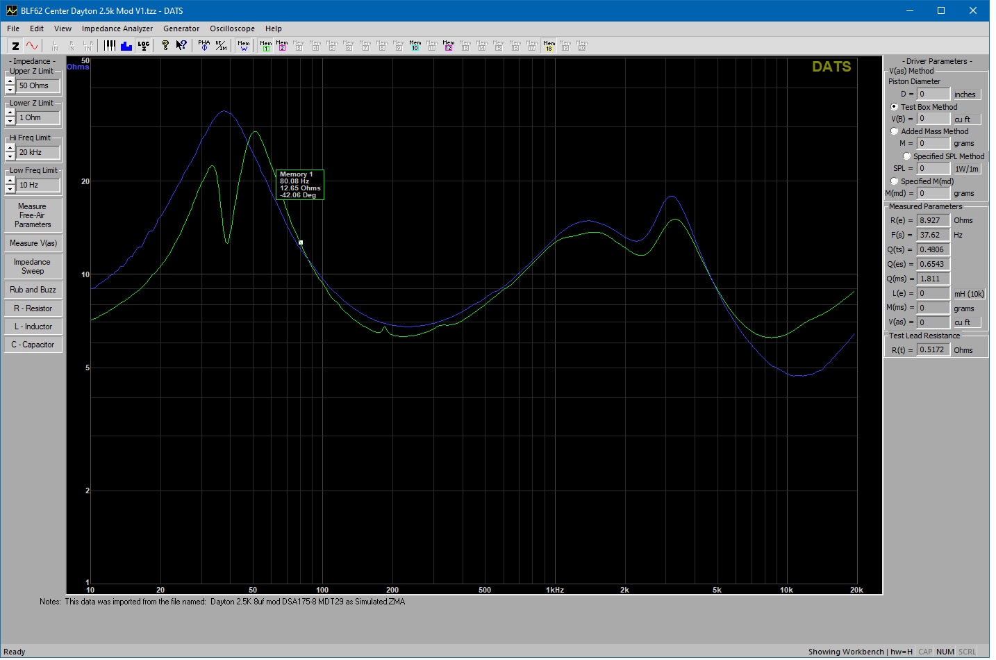

Ok got some measurements done on this existing modified Xovr. Im using the DATs V3. I simply love this tool. I have been able to reverse engineer circuits. I have been able to confirm good or dead vintage capacitors, measure inductors caps resistors. I love this device and it is so well made. Just very professional especially at the price point it is sold for. Kudos to Dayton and Parts Express. Just to reiterate this is not the crossover I intend to build this is the Dayton 2.5K that is modified some. But the Box measurements on the woofer are good to go or use.

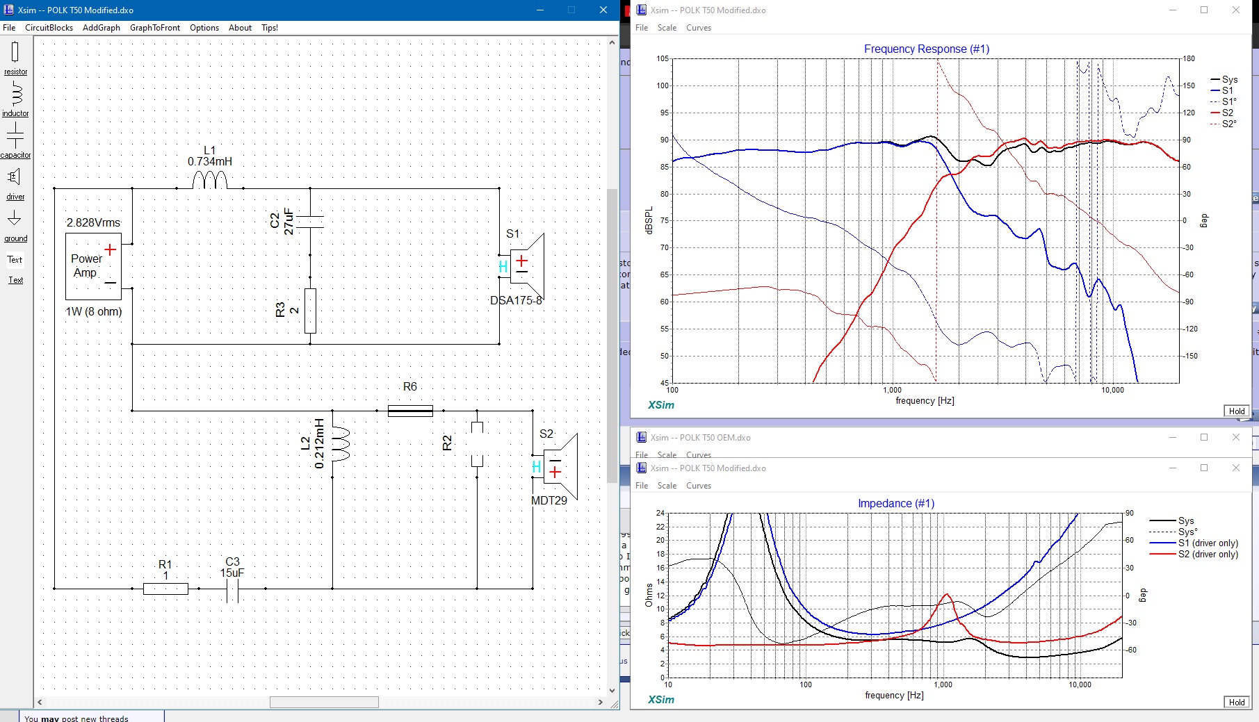

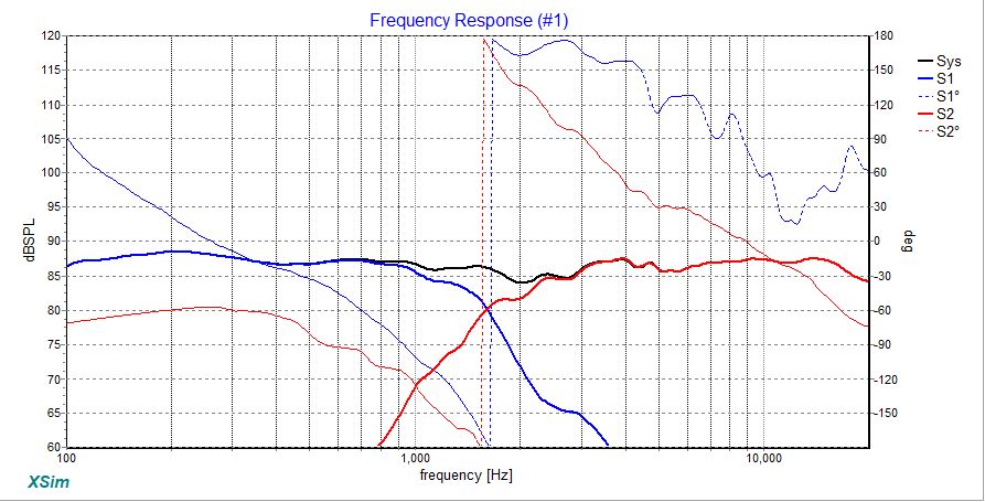

Ok this completely impressed me. I measured with the DATs V3. Then I loaded the exported data from Xsim where I measured the existing Xovr and put in the derived driver data. This really bolsters confidence in this tool. What you think Allen B?

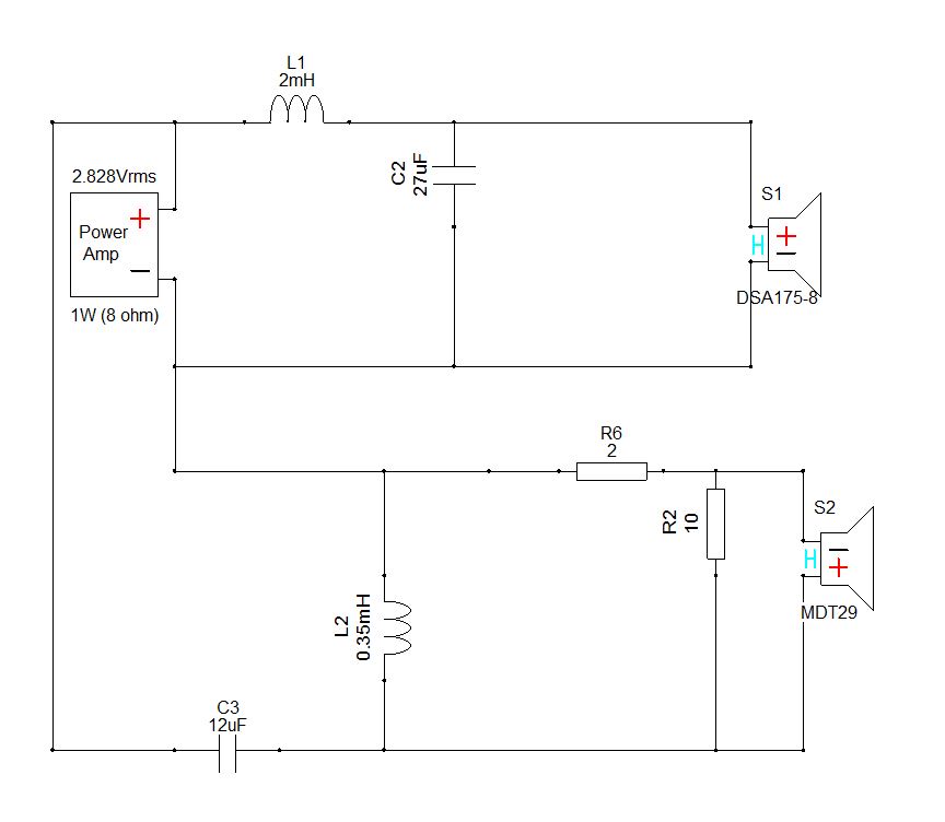

Simulators are surprisingly accurate at audio frequencies. Your biggest inconsistencies will probably happen in the sound measurements.
Allen I have a few questions.
1. What watt rating should I be getting for these resistors?
2. I see you have both drivers inverted and I also can see that changing those greatly changes the phase lines. Do these filters alter phase at each level, and this is necessary? I seem to remember that is the case with many of the tube circuits I was messing with in the past. That is each leg of filter changed phase 180 degrees, is that correct?
3. Your suggestion puts the transfer region much lower than I was shooting for. Can you explain that some, maybe I am still not understanding the transfer region? I thought for this tweeter 1800 was about as low as I could safely go.
1. Xsim will show you maximum power per frequency. It will help you guess which resistors need to be larger.
2. I invert both drivers only so it is easier to see phase on the plot. You don't really need to invert them.
3. I don't know these drivers and I'm not trying to give you a good crossover.. that would take a long time. I'm just showing you small techniques on the simulator.

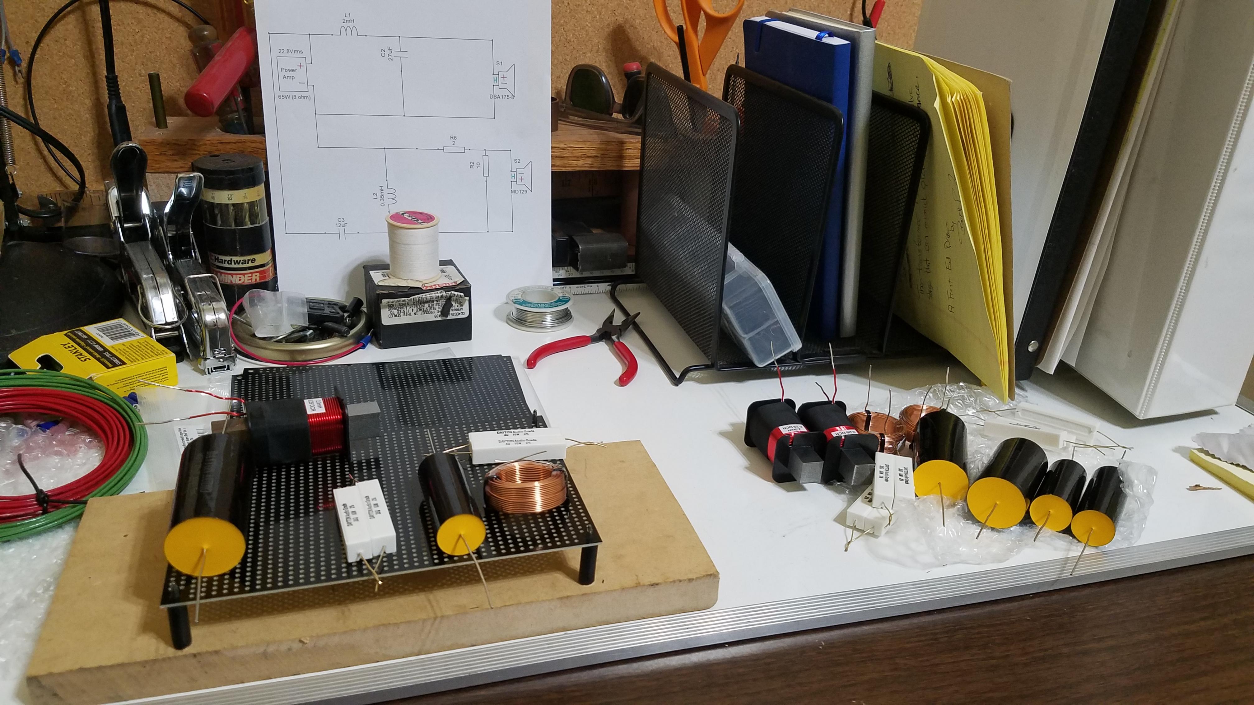

So this is what I decided on and I may have to add more series resistor to the tweeter. Really just lightly higher Xovr point than yours. The resistors I chose may need a higher rating.
You can look at your woofer. Where does it go narrow and breakup. This is the first thing to help you decide where to cross.

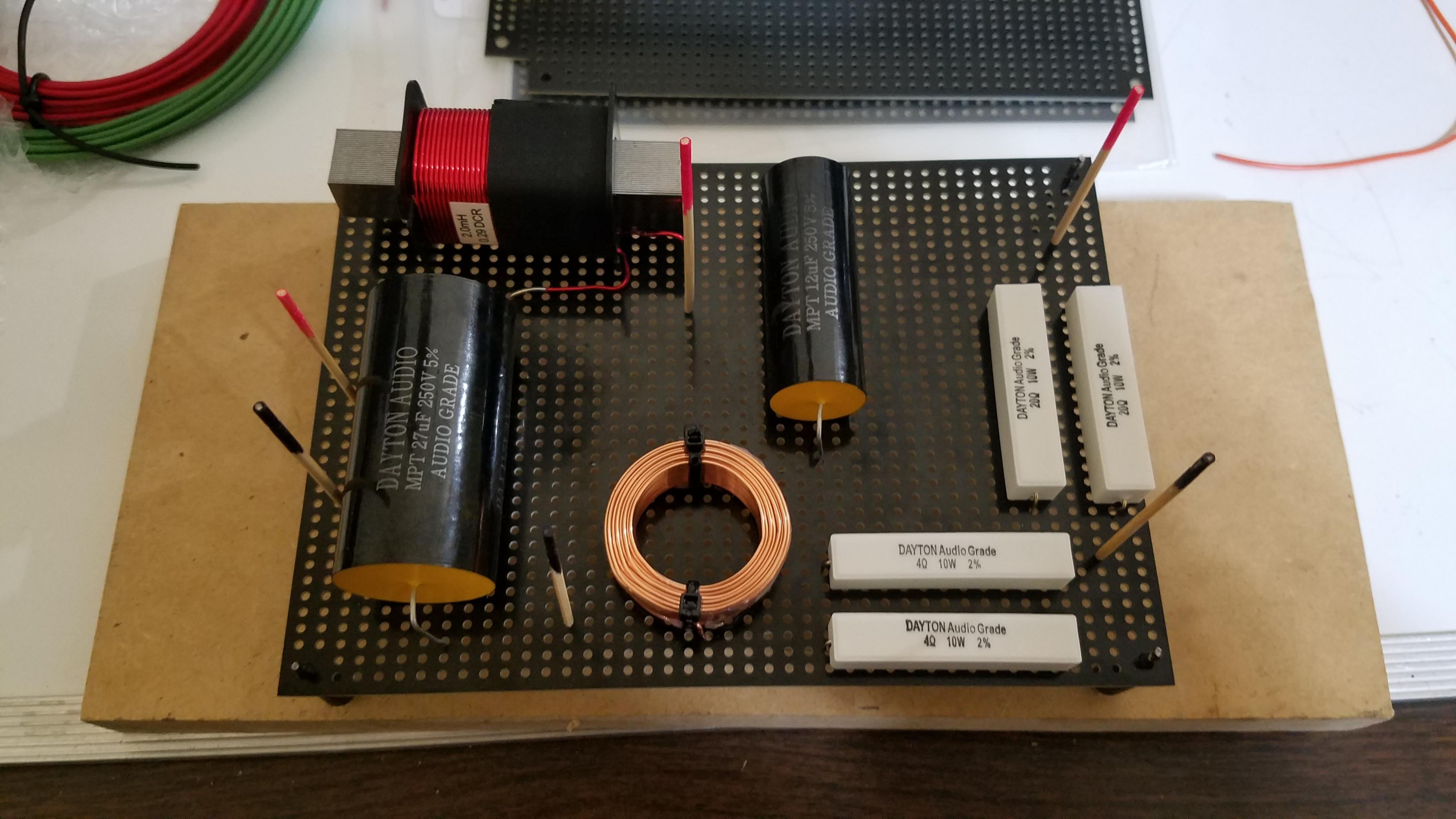

Component Layout & Xovr Board Stand

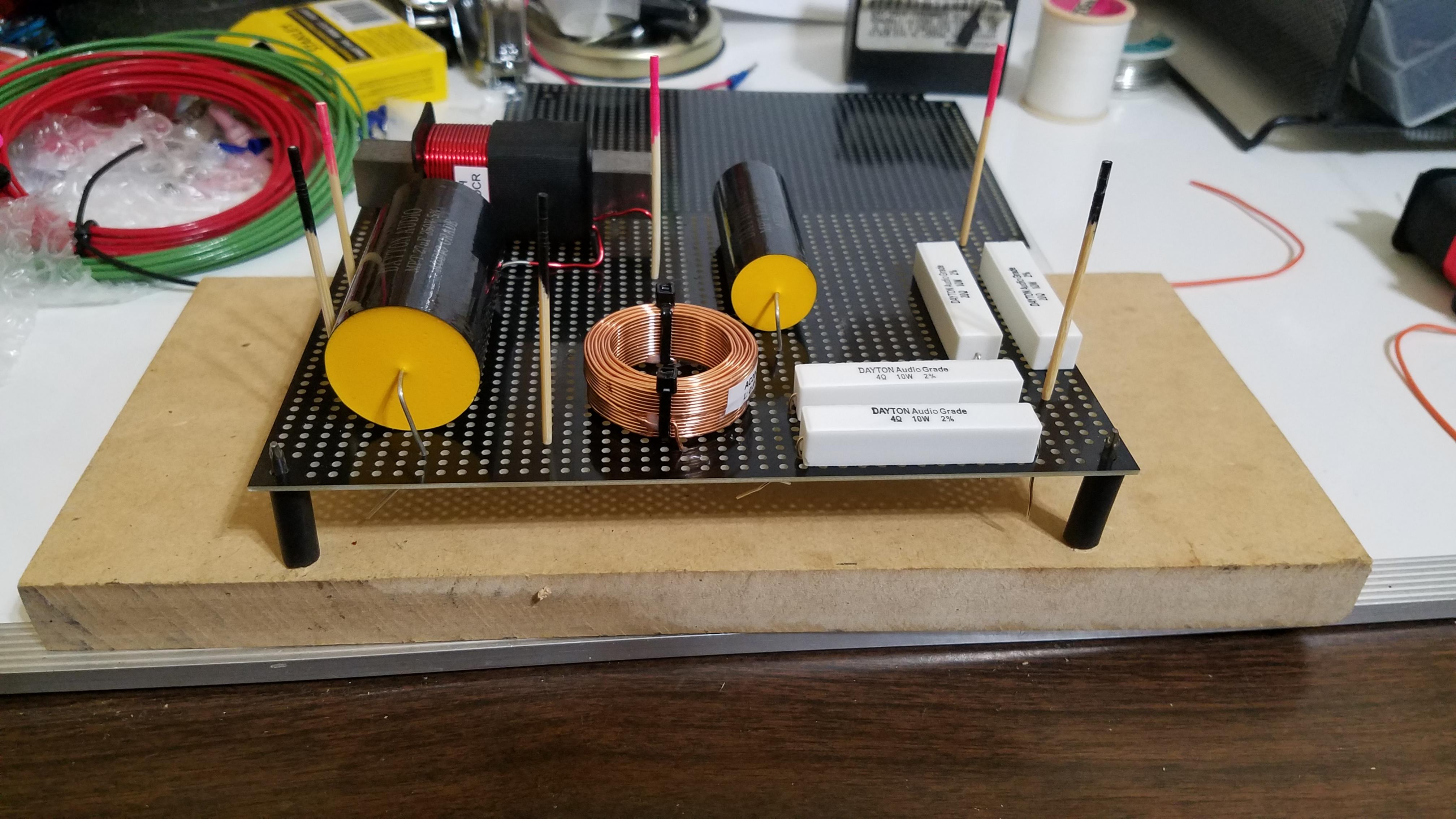

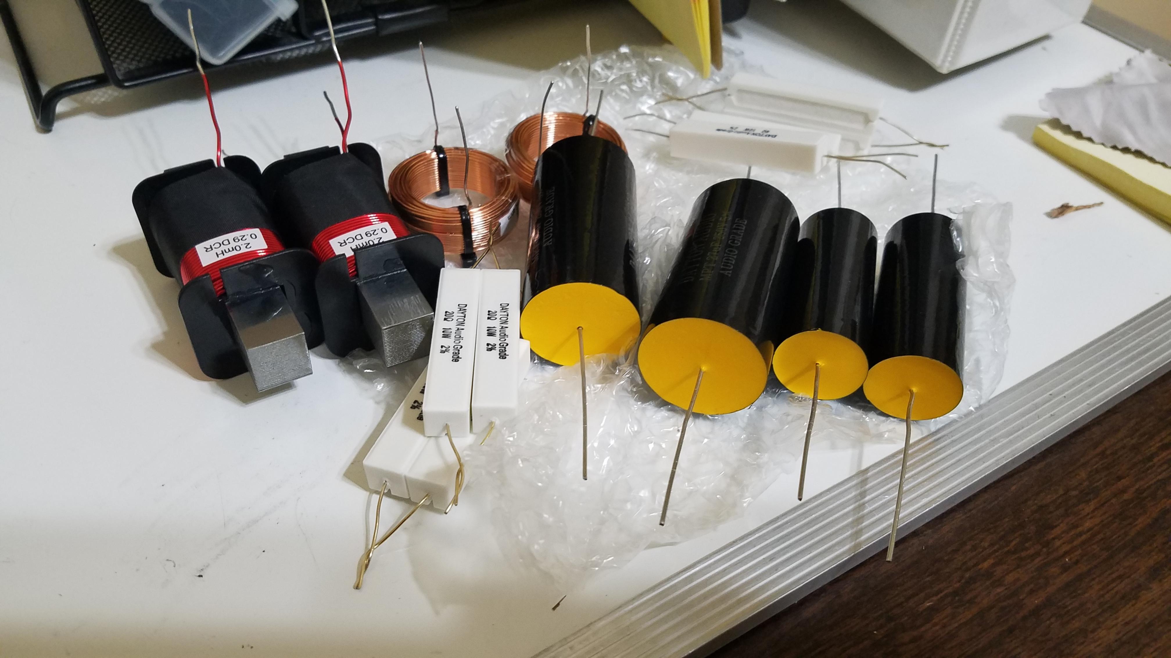

My parts came in today. I am so glad I purchased the DATs V3. I was able to verify the values of each part. I was also able to put the best matches together with 3 full sets I matched for the FL & FR and put the components that were a smidge different to the center crossover. I know the numbers are insignificant but Im a detail freak. I built a Xovr board stand with a single piece of MDF 4 nails & vacuum tube spacers. This allowed me to work on the component layout without mangling up the leads. The following pics are what I'm doing and it is time to break out the soldering iron and get these puppies put together.

I assembled my new Xovrs and did them up right. I used zip ties, high temp hot glue, some left over silver high grade wire. I paid attention to the inductor positioning and layout to avoid interactions with the magnetic fields. I spaced my resistors to allow the best cooling. I did everything I had learned or knew from working on Tube gear and lots of other device through the years.

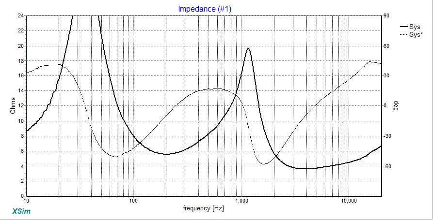

The Reward. I now have a system that is more flat and has better impedance matching. This reward includes a more balanced sound that is less harsh and brings yet another level of clarity out. I had no idea how harsh these actually sounded before these crossovers because it was so much better than what was replaced that it was still joy to my ears.
