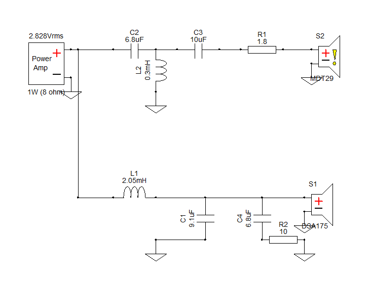

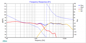

Hmm this little project is making me learn more and more. I think now after reading about cone materials that you are very right Geoff. My thinking above applies much more so to tweeters and the Aluminum cone Dayton could be faster and more accurate and I could crossover a little higher giving the tweeter less work. Does that sound right? Now I see what you're saying and that may just be the better choice.
Please take the attached as just IMHO, I'm only a beginner at this and what I don't know about crossovers would fill a book. I've made a simulation for you, and that's all it is, to give you an example of the sort of circuit which MIGHT work for you. DSA175 and Morel MDT29. This simulation does not take into account the acoustic response of the drivers when mounted in the baffle.
I'll have a bit of a play with the woofer inductor value (2.5 or 3.0mH might be better) and post a revised XO if it looks better: a higher value will provide more Baffle Step Compensation, which is less important if the speakers will be placed on/near your wall.
Your project really needs someone with much more expertise than I to work out a crossover, I can't stress that enough. This might be a start and should sound better than what you have already or something from a crossover calculator.
I wouldn't get too hung up about driver materials: yes, they will have a different sound, but any quality driver, made of anything, will sound poor if not handled properly in the crossover. There are many views about this, but. Many successful projects mix paper, metal or composite drivers with no problems.
Good luck!
Good luck!
Geoff
