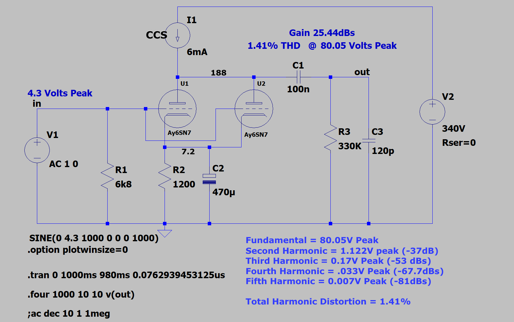

I have finally arrived at what I hope will be the final version of the driver section of my 300B SET. I did innumerable simulations with this great application to calculate a cathode resistor value that gave adequate driving voltage with minimum distortion, using the paralleled 6SN7s. I made some very interesting observations along the way, such as: 1) the combining of the two tubes makes no difference to the distortion figure worth talking about - using an idealized CCS model, but the dynamic resistance of the IXCP10M90S is as near as dammit to ideal. 2) the gain of two 6SN7s in parallel configuration was very slightly lower than using one half of the twin triode. 3) the combined plate voltage reduces considerably, but the way things worked out, it was just right for my purposes. 4) 6 mA shared plate current is indeed the sweet spot for minimum distortion with 80 Volts peak output. This was the biggest surprise.
So, it looks like the primary advantage of using 2 6SN7s in parallel is longer tube life, with the plate current shared between the two. All this is based on LTSpice simulations of course, but I will change the common Rk to 1200 Ω from the previous value of 910 Ω, to provide a new grid bias of 7.2 Volts The successful outcome of using the IXCP10M90S in the plate circuit is a worthwhile alternative to an interstage transformer, at least for the 6SN7 (in my view only, of course). With this circuit, an input of 3 Volts RMS is all that is needed to drive most 300B SET output stages to 8 Watts, and this surely is within the capability of most pre-amps

I've just done some more Spice simulations, and proved that that statement is incorrect. There is also a 25% reduction in THD with two paralleled tubes.So, it looks like the primary advantage of using 2 6SN7s in parallel is longer tube life, with the plate current shared between the two.

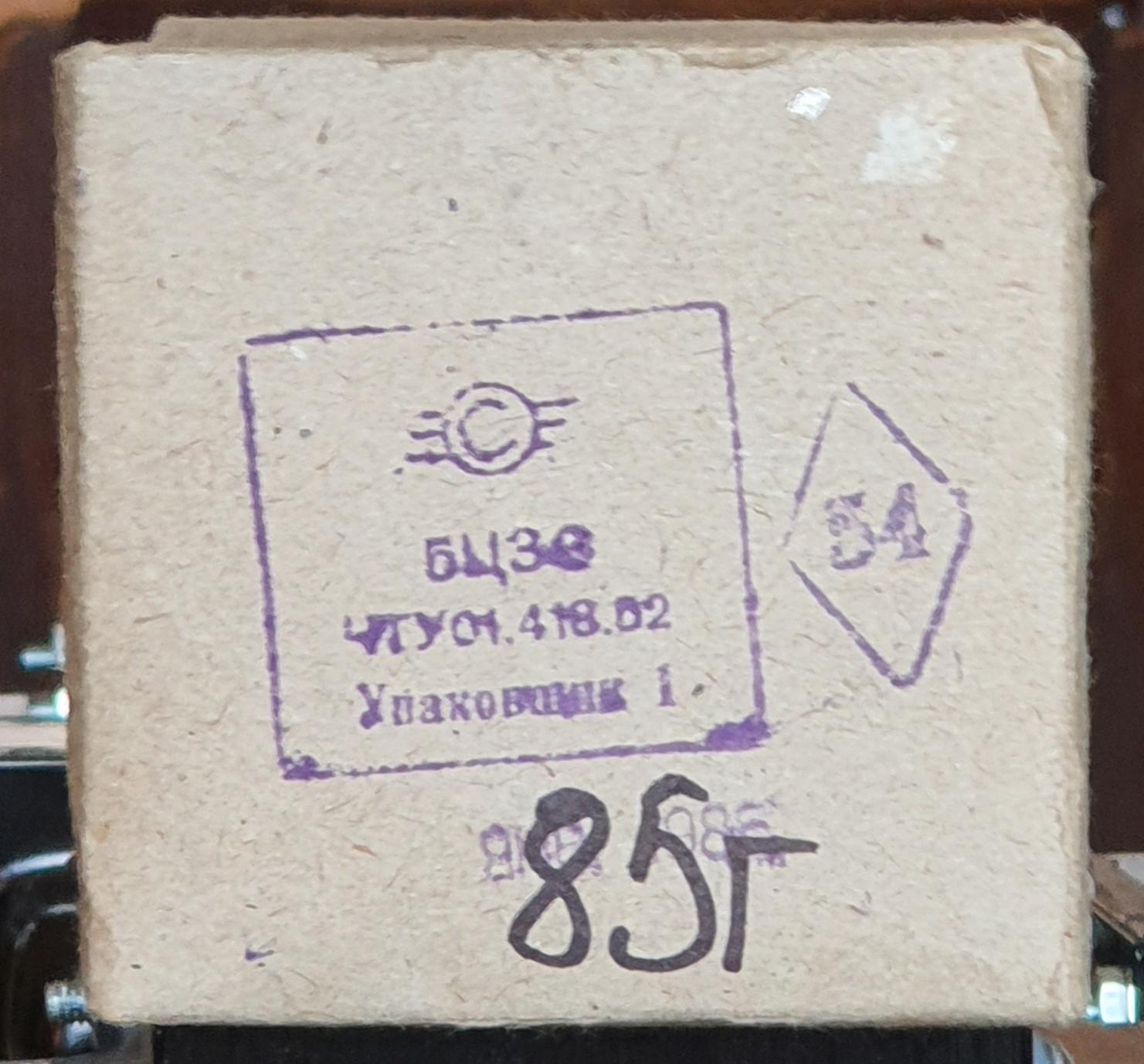

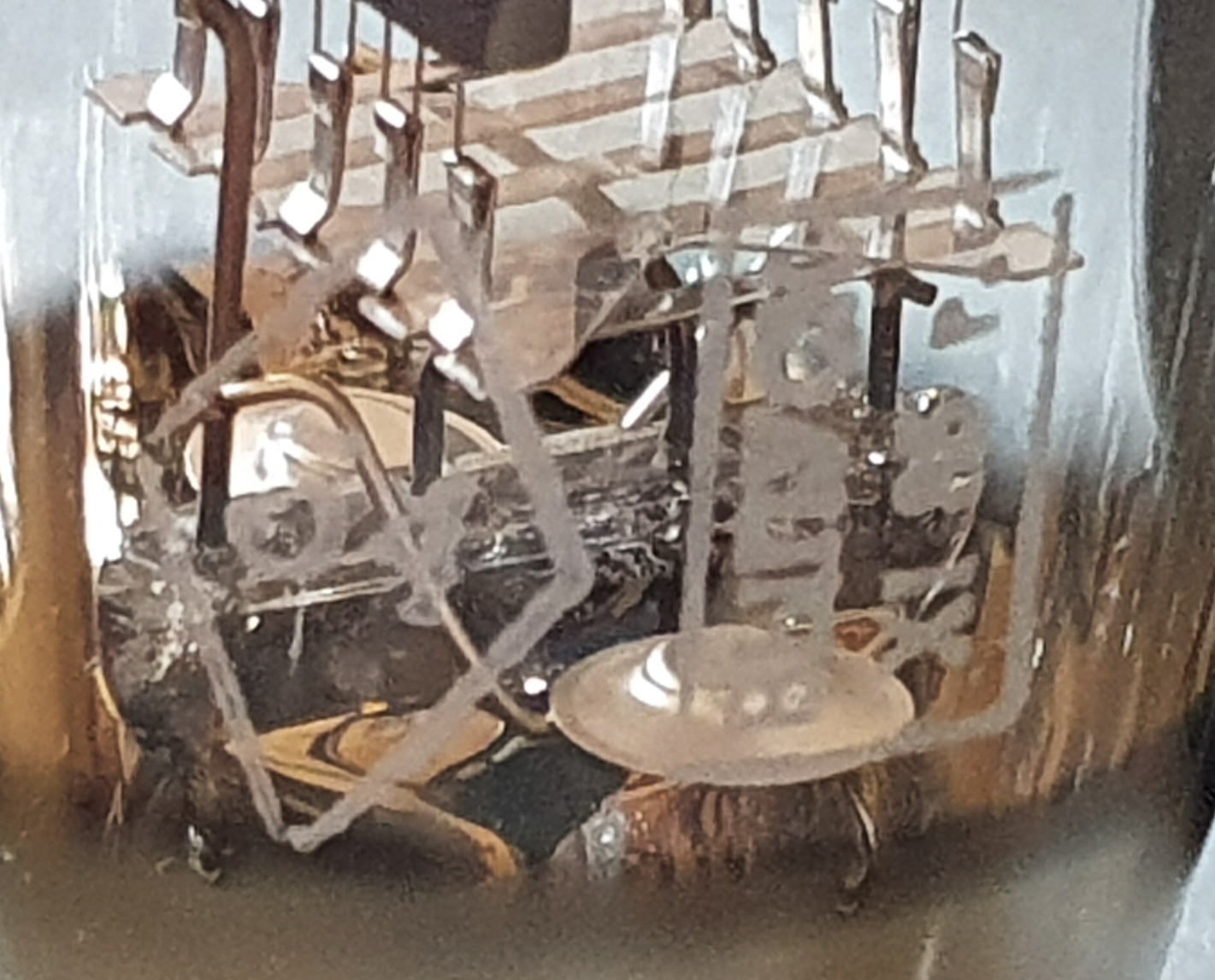

I have just received a nice NOS 5Ц3С in its original box from the Czech Republic. It's working well (so far). From your experience as a Military Developer, can you tell, from the photos, which grade is the tube. I know the bottom line in the square on the top of the box translates as "packer 1". But I can't tell anything else about the tube quality - but maybe you can. Many thanks.OTK sign does not mean, that this is made for military.
It's quality control sign.
"Отдел технического контроля" aka ОТК is mean Technical Control Departments.
This sing only guarantees, that this product fulfils for some technical conditions (tighter tolerance, extended temperature range, schoking etc.).
In the former "socialist" countries (in Hungary too) the QC -even is industry- was not very rigorous, so the parameter variance could be high.
The "worst" (but within tolerance) is "made" for commerce, the "middle" for manufacture, and the top ten percent for military.
Therefore in those factories, that made military product the preliminary QC department was responsible for "good" product purchase.
... if I remember correctly (forty years from now), as former military developer.

That diamond stamp is a sign of military acceptance. "54" is just the military inspector's personal code.I have just received a nice NOS 5Ц3С in its original box from the Czech Republic. It's working well (so far). From your experience as a Military Developer, can you tell, from the photos, which grade is the tube. I know the bottom line in the square on the top of the box translates as "packer 1". But I can't tell anything else about the tube quality - but maybe you can. Many thanks.
There may be some additional data, but it is always on the bulk box, never on the individual package or the tube itself.
It's good to know that I have a military grade rectifier. Many thanks for the info.That diamond stamp is a sign of military acceptance. "54" is just the military inspector's personal code.

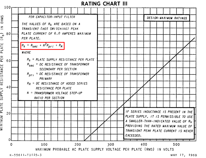

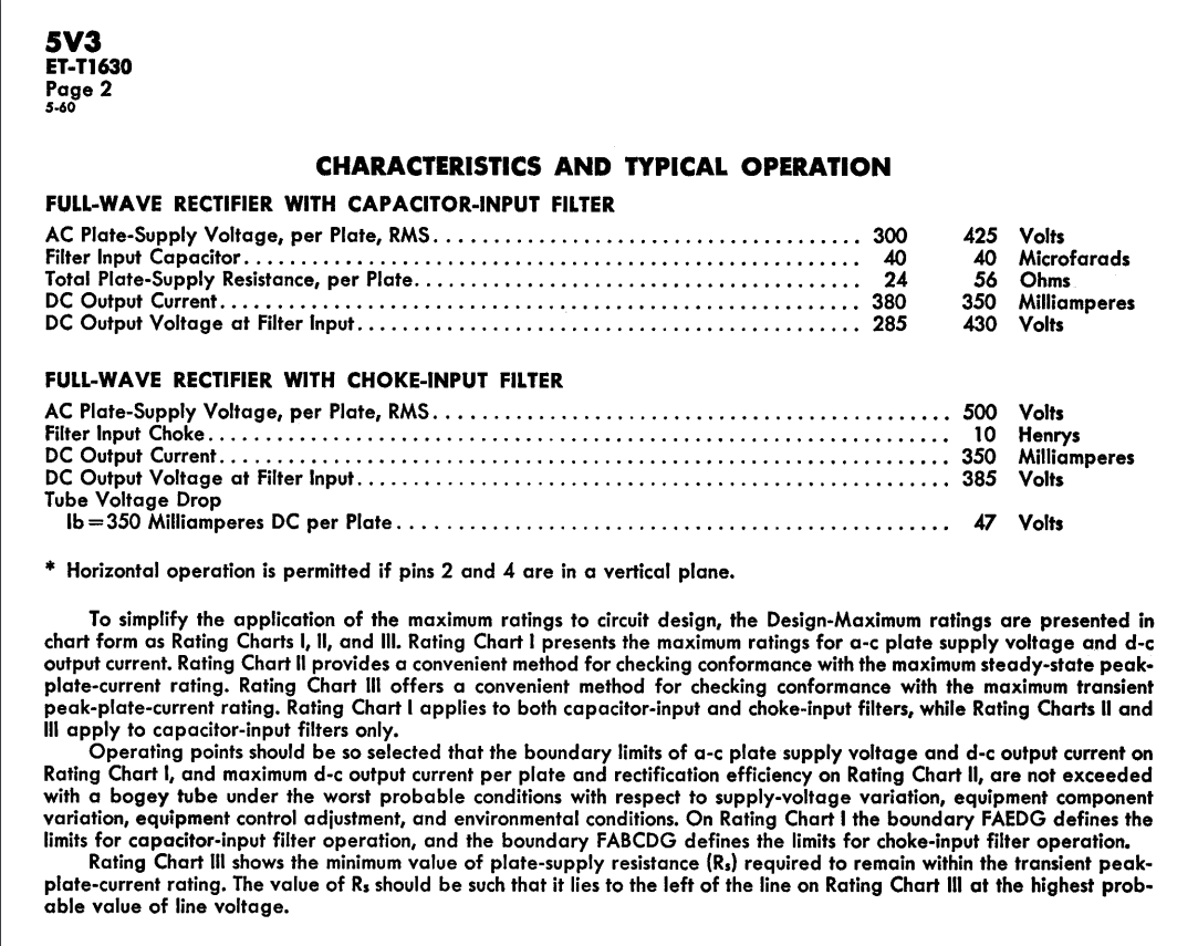

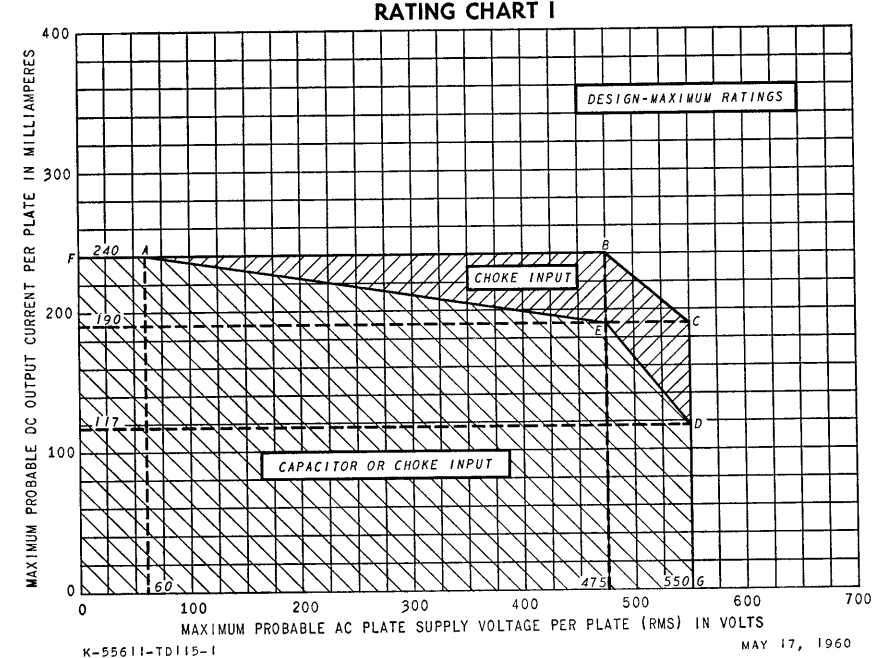

I got a used 5V3 TV rectifier ($8) from the US yesterday, and substituted it for the 5U4G/5Ц3С tubes. I had read the 5V3 spec and rating charts on the General Electric sheet from 1960 and I think (and hope) that I am well within the maximum ratings for this tube. I am determined to keep my HT at about 450 Volts, so I intend to stick with 40μF or thereabouts for the filter capacitance, which is allowed for the 5V3. The RMS voltage feeding each plate is 400V. The formula for resistance feeding the filter cap in relation to the other parameters is given in image 5V4_4. My transformer secondary DCR is 41.4Ω per plate, and for the primary winding is 5.58. The step-up ratio is 400/238 = 1.68. So square this and it becomes 2.82. So, 5.58 appears as 15.74Ω at the secondary. I am using no extra series resistor, so my DCR into each plate of the 5V3 is 15.74 + 41.4 = 57.4Ω. It looks as if I am home and dry - we'll see.I don't think so.
Secondary low DCR (BTW how many Ohms?) AND first capacitor larger that needed is the rectifier killer.
The 5V3 is a brute of a rectifier, capable of supplying way more milliamps than I need, but a slight down-side is that the filament draws 3.8 Amps, as opposed to 3 Amps for the 5U4G/5Ц3С. So, I get a little extra voltage drop from the filament supply winding, which is rated only at 3 Amps. However, I'm still within about 4% of its voltage supply requirement.
That should be "feeding each plate".

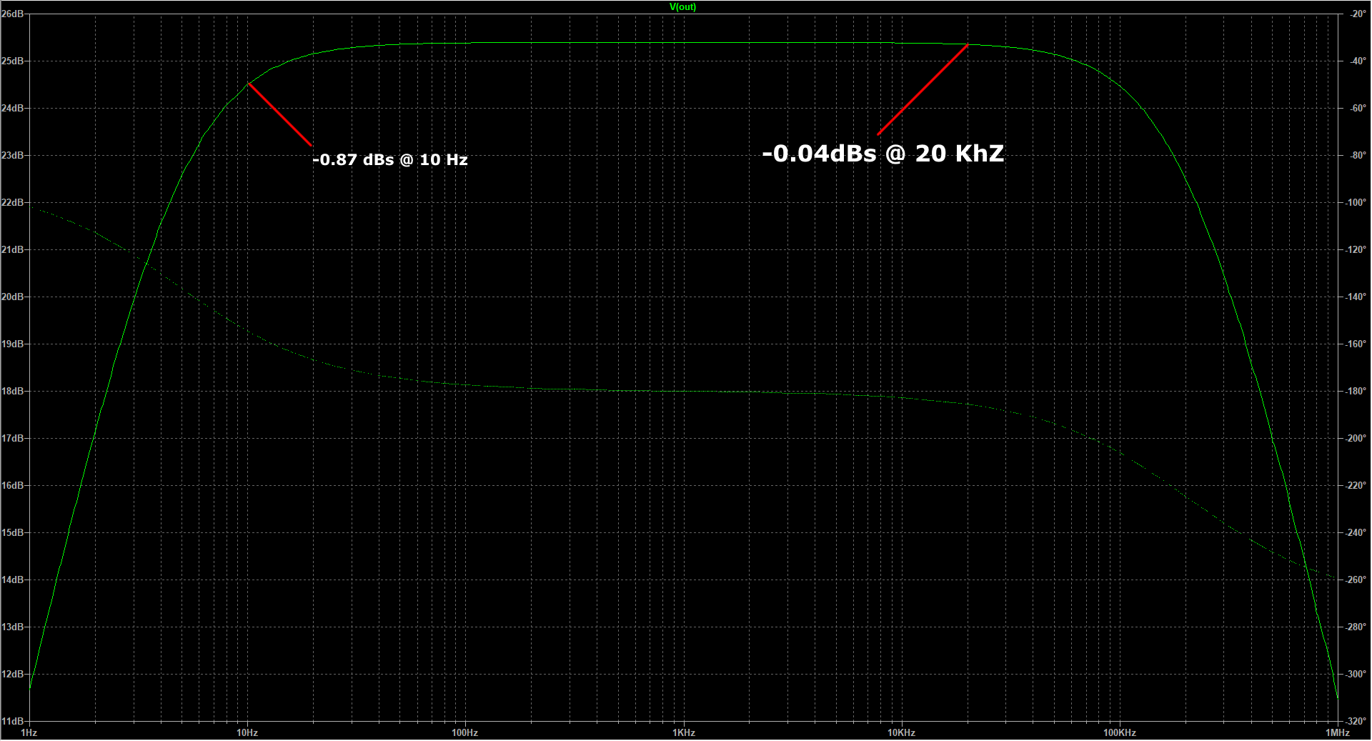

Anyway, in the end I decided on this version of the 300B SET without transformer coupling, instead using a IXCP10M90S CCS as the plate load for the driver tube. I decided to put one in the Cathode/Filament of the 300B also. I built a completely new amplifier, and used the Russian version of the 6J5 (6H8C) as the driver. With only the single driver tube, it takes 2.8 V RMS input for full power.
Using JJ output tubes, I get a full 8 Watts before I see flattening of the waveform, albeit with quite a bit of distortion at full power.
The frequency response is as follows (both channels)?
10 Hz -0.32 dBs
20 KHz -0.5 dBs
30 KHz -1.28 dBs.

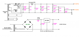

Thanks for the compliment. No problems so far with oscillation. I'm including the complete schematic, with some notes, as well as the PSU schematic for anyone that wants to build it. I have replaced the power transformer with the Hammond 379X. I get about 9½ watts with the increased HT of 475 V.
I think it's a really good design, after trying many similar versions. All thanks to you who introduced me to the IXCP10M90S, for which I am eternally grateful.
