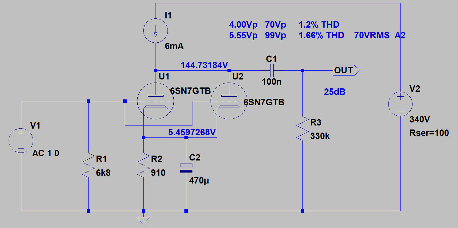

goddlediddles,
6SN7:
Your post # 106 schematic already shows the 2 halves of the 6SN7 paralleled.
You do not have to re-do a load line.
The current in each plate should already be at or near to 1/2 of the plate current source.
The total current is going through the 910 Ohms self bias resistor.
The bias voltage is the total current x 910 Ohms.
If you use individual self bias resistors of 1820 Ohms (and individual bypass caps), then the bias voltage will be nearly the same, 1/2 current source current x 1820 Ohms.
If the bias voltage in the two 1820 Ohm resistors does not match, that indicates the amount of unequal balance of the two triode sections.
Does that make sense?

Yes it does. But when I combined the two sections, the voltage across the combination dropped to 150 Volts from 180 Volts across the single tube, thus leaving less voltage swing in the direction of grid current. I think this can be fixed by increasing the value of the combined cathode resistor, thereby increasing the bias to a higher value (negatively)
I think i did not understand the circuit values when you started with one triode section.
I assumed you had already paralleled the triode sections, and that it was already working with a single 910 Ohm combined self bias resistor.
If you started with a single triode, and one 910 Ohm self bias resistor, then in order to parallel two triodes you need to do this:
Set your current source to 2X the current that it was for one triode (if it can dissipate that 2X current x the original voltage drop).
Use individual 910 self bias resistors for each cathode.
Use individual bypass caps across each of the 910 self bias resistors.
Done.

Thanks for that, but I think the CCS is already feeling the heat with 6mA. The combined Plate Resistance curves should straighten up considerably, allowing the voltage to swing more towards the grid current end. This will compensate for the decrease in the voltage on the plate. I will disconnect the driver from the 300B and add a resistor of the same value as the 300B grid resistor and then measure the available drive voltage, keeping a 'scope on it to monitor when the waveform begins to distort.
I've just realized that I have already done the above test. I said earlier that I was getting 70 Volts RMS drive from the combination. But I'll do the test again to be sure.
A 300k resistor across the current source will increase the 6SN7 plate voltage slightly.
Connect the 300B grid to ground. It will self bias to the same current, and keep B+ at its normal value.
Disconnect the 300k and coupling cap from the 300B grid, but leave the 300k connected to the coupling cap.
That will retain the same 6SN7 plate voltage, but present the 300k load to the 6SN7 plate and current source.
Or, just use one section of the 6SN7, and the original circuit.
With the current modification of two 1820 Ohm self bias resistors (or strapped cathodes with 910 Ohm self bias resistor):
3mA per 6SN7 does not sound like where I would want to operate it; the plate resistance, rp, is higher at that low current; and two higher rp in parallel is not going to lower the stage output impedance by much.
And the linearity of the 6SN7 tends to be lower at only 3mA, than at 6mA.
Perhaps the only saving grace there is the high impedance of the current source, in parallel with the high impedance of the 300k resistor. That helps somewhat to retain the linearity of two 6SN7 triodes in parallel, even though they each only get 3mA.

6SN7 sections have a common heater supply. The thing is that the combination at 3mA each sounds better than a single tube at 6mA. I am not imagining it - it really does.
Then you may have found a sweet spot.
More 2nd harmonic distortion in the 6SN7, tends to partially cancel the 2nd harmonic distortion in the 300B.
Could that be it?

I'm not sure, that this is the most decent driver for 300B.
Single stage 6SN7 has no enough gain -even with CCS load-, thus at higher input level this stage is the limiting factor.

goddlediddles,
In Post # 118 you asked how you could draw the load lines for parallel operation. Use that set of curves.
Draw a horizontal line across the curves at 3mA (each triode gets 3mA, for 6mA total).
910 Ohms x 6 mA = 5.46V 5.46V is the bias (about 3/4 of the way from the 4V grid line and the 6V grid line. Draw a circle around the 3mA line at that grid voltage.
Perhaps the current source impedance is 600k Ohms, I am not sure.
600k Ohms in parallel with the 300B's grid resistor of 300k = 200k
But each 1/2 of the 6SN7 'sees' 400k, because the other 1/2 is driving the same 200k load too (they are aiding each other).
So draw a 400k load line, and now you see the result of signal that causes grid voltage change, and the resultant plate voltage change.
Does that help?

Many thanks for doing the simulation. It corresponds almost perfectly with the real situation, as measured, except for the distortion figure, which I am unable to measure, but looks like what I expected. I am driving the amp with a small professional mixer, which can deliver +24 dBU (17.36 Peak) of drive for the 6SN7 - way more than is needed to reach sufficient drive for the 300B with lots of voltage swing on the 300B grid. BTW, what simulation software are you using?

That's great, thanks. I'm very happy with euro21's simulation. I think that has copper-fastened the final design for me. I'm now going to painstakingly attempt to draw out a combination Ia- Va set of curves for the paralleled 6SN7s, using half its plate resistance and different values of voltage and current on the X and Y axes. I might need lots of graph paper.
At 3mA plate current, the 6SN7 rp is much higher than the 7700 Ohm spec.
You can estimate the rp at that current by measuring the slope of a single grid curve when the plate current is 3 mA (How much does the plate voltage vary as the plate current is varied from 2 mA to 4 mA). delta plate voltage / delta plate current
delta plate voltage / 0.002A
