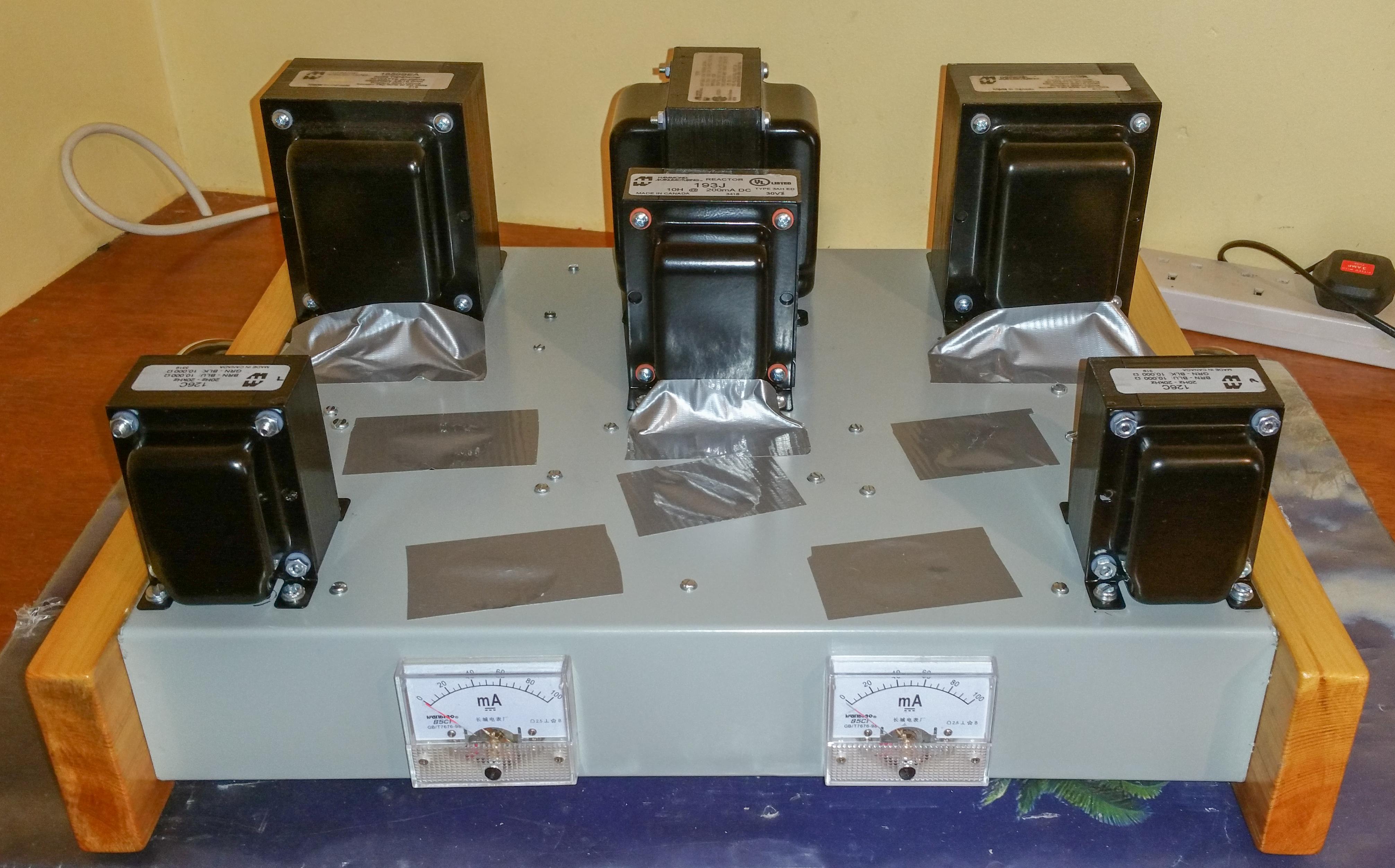

Internal wiring.
Some folks baulk at the idea of using connection blocks in the wiring. It was another experiment that has given no trouble so far. They are not the ordinary electrical connection blocks that can be bought at the hardware store. They were more expensive, and have a flat plate below the screw, so as not to crush the wires, and to ensure a good connection to all wires and components.
Link to photos.
goddlediddles,
I admit, I never built a good looking amplifier.
All of my amplifiers are ugly.
I start with an old amplifier that had missing parts, and then I use the old chassis and original power transformers. No other parts are from the original amplifier.
And, I try lots of different configurations on that chassis, so there are lots of extra holes, etc.
Here is an example of one of my amplifiers. You can see the meter on the front, and the handle on the back.
A Simple Low Power 7591 Push Pull Amplifier
Perhaps I will take some photos of other amplifiers later, and post them.

I decided as I went along. I had no plan for the connexions, but I made sure to use as many terminal points as possible, thereby providing maximum flexibility. If I were building the same amp again, I would use tag strips and solder. As I said earlier, it was an experiment that seems to have worked out OK. "Eyeball Engineering" is what I remember a friend of mine from the US calling it. Leave plenty of room by using a large chassis. Mine is 17 X 14 X 3 inches. It's a Hammond part with the part number 1441-38. The matching bottom panel is part number 1431-38.
