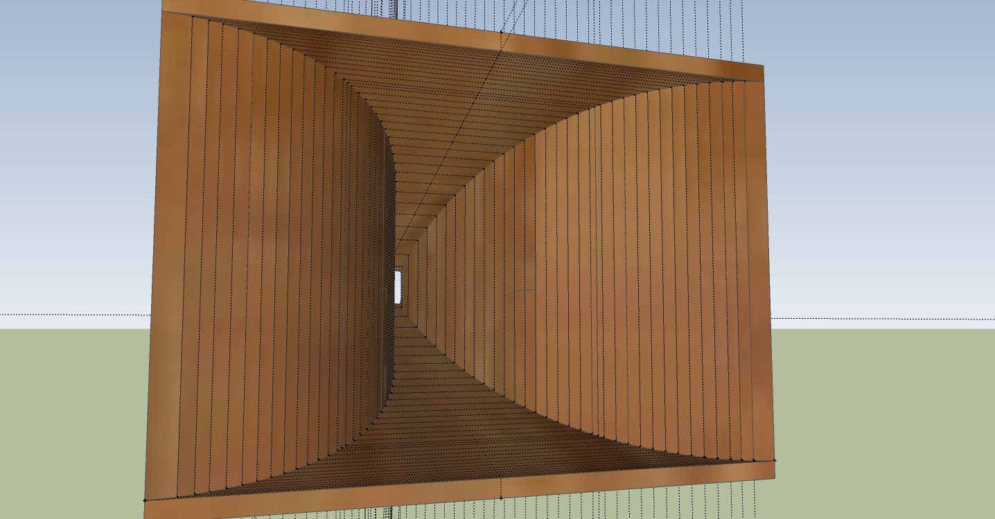

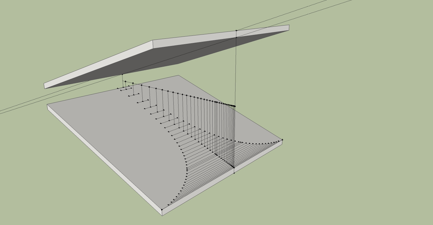

Wellllllll I have tryed in sketchup the outcome of the tractrix sheet from volvotreter, but I just did something wrong because I get no two sides who are conic and the width stractrix, tractrix I did see but the conic one is not conic.
Your horn has two sides who are conic, I have use the square output, yes it needs some practice I see, so it is not bad to do my own one to learn.
The distance steps from sheet has to be in center of horn I presume, and the output I have to devide x 2 to get proper horn otherwise I get strange things, So in the evening I go try again think I am right devide it..
regards
kees
You have to plot the spreadsheet output vs axial distance to see which side is straight linear and which side is curved. I recall that it is opposite of what you think, that is, the vertical dimension is curved and the horiz is straight. The axial distance is indeed centerline distance, not distance along the horn wall. You will figure it out...
Thanks I have it, just plot and I see what happens, I do this in sketchup so I have 3d.

Now I understand why you say to me just use my design, it is a lot lot lot of work to draw it, special when more steps is used, in my case it is now 35 steps.
Further I did get wrong every time, until I discover I have to use always the same origine now things fits nicely.
I have to devide all the stuff but the conical part just mouth and throat.
regards
e
The horn get some model already, making faults is also very easy with all this numbers.
with sketchup it is also a challence this software has sometimes it own will, but hee it is google right? stealing info and such,.

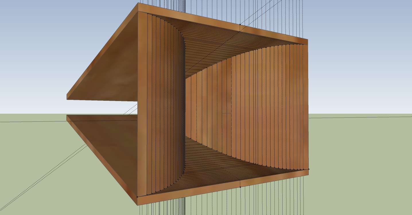

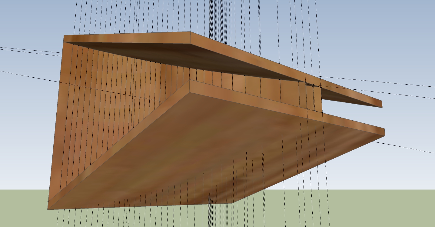

Kees,
That looks good but sure looks like it was a lot of work. What is the angle between the two flat walls?
It was not as much work I did think, however sketchup is not really a good program to make horns, it is such a pain in the *** to move things or delete without get hollow walls.
Find a substitute for sketchup I go search for. If a program writer did write such drawn program for horns, special for horns it will be great.
Panels are 18 degree so far that I see, it is preciese with volvotreter program drawn. horn is shorter as yours 46.7 cm.
How width and high is your horn?

I have done the rest also, now I can see how it works, it is more easy.
However sketchup is dificult sometimes to get things closed like the horn itselfs between the steps, sometimes it refuse to do so except when draw two extra lines in the middle. So if there is someone here to can explane me how I am very pleased.
