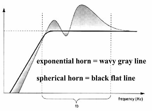

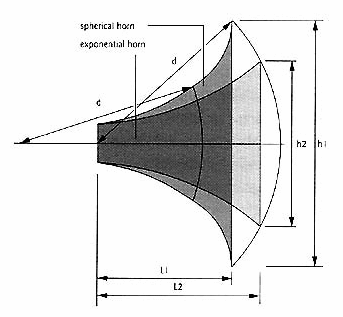

The sims of the tractrix do show a smooth response. Is tractrix same as spherical? I think they are different.
I do not know, but see it and thought place it here, I have never play with it but maybe it is interesting to try, now you but maybe me, you have enough work here.
But spherical is maybe the grandpa of the tractrix, a lot experimentation was going on long ago where amps are give just 1 watt at most.
A lot of respect for the people who did it without computer and more respect that in these modern days more then 100 years later still people are exited.

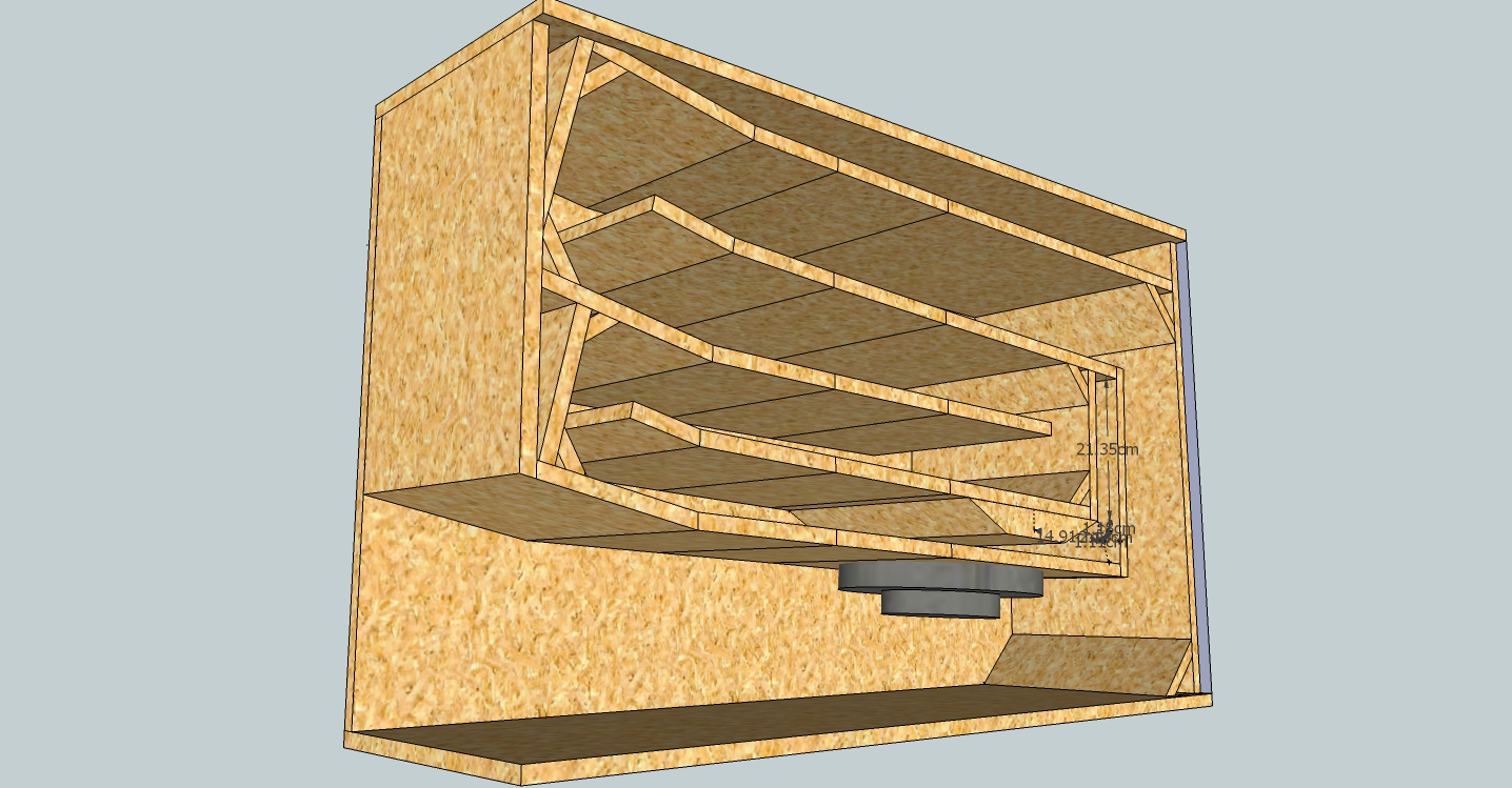

Kees,
No need for all those segmented curves in there - the TH won't know the difference and you will have an easier and more sturdy build. The first section at drivers is critical as it controls compression ratio. After that you can have more slop and no idea horn angles and it's not a big difference. I use a folded bass horn with mine and they sound great together.

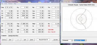

I already did discover that, I did sim a exp horn therefore I did this because of better sim, but it is of not much use making thing only more complicated, now hornresp can also sim damping making it useable, hornresp can also sim tractrix however without the wizard.
This is only model, I make one who are standing so I have more room like in corners. I do not now if I have to make two or one, because she are quite efficient.

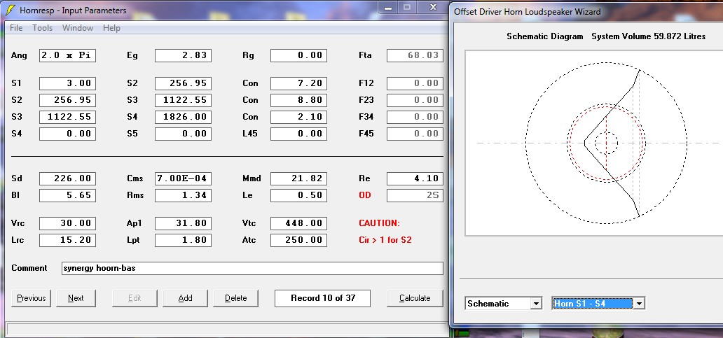

How can I change in akabak inches to mm/cm? just remove *0.00254?

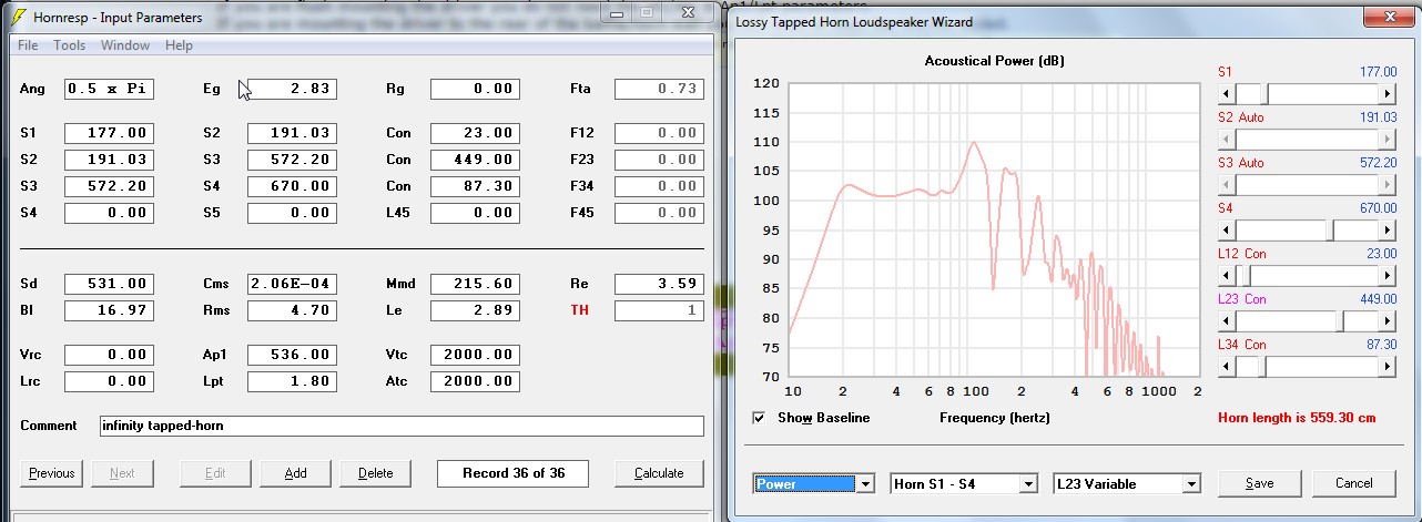

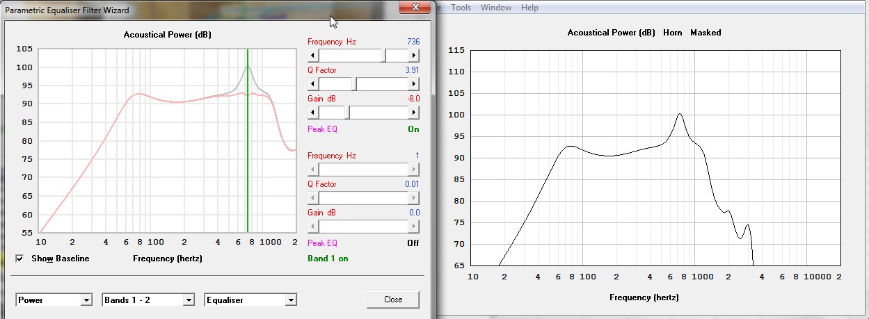

here the sim of a long standing TH. also a sim of a passive eq because I go analog, will go work, except TH these needs a own amp (high damping amp)..
regards

If defining variables with the Def_const block then units are assumed to be meters. This to convert you inches to meter multiply by 0.0254. However, in actual statements where a dimension is expected like a vent length Len=3.5cm (add unit). Can also be m, mm, in, ft, etc.
Little shortcoming of akabak then if rest can be mm cm etc, but here I can use 0.010 for 10 cm, inches are difficult here in holland als wood is mm/cm like thickness.

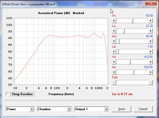

I have just sim the very old phillips woofers do quote oke in a synergie horn making 2 way possible, afcourse only with compression driver, and I like a normal speaker like you did, and so go try that way.
thanks.
kees

You misunderstand - akabak is natively metric. It is smart and can accept either metric or English units in statements defining elements. Up to you which to use. In global variables it only accepts metric which is why I convert inches to meter.

I go drawn the horn.

I need to make a new because I use different speaker, I use two bass not four like you.
I go try phillips with horn, have 4 of them, old 1976 types
regards
kees
Yes, I believe the scaled akabak script with 2in throat is posted earlier and you may have used it. I used the 3FE22 and TC9FD with it. One thing I am learning with woofers is if you place them too close to throat, the pressure they generate feeds back and modulates the full range. May be do what Danley does - add a shorting inductor across fullrange to stiffen its suspension at low freq coupling from woofer.
