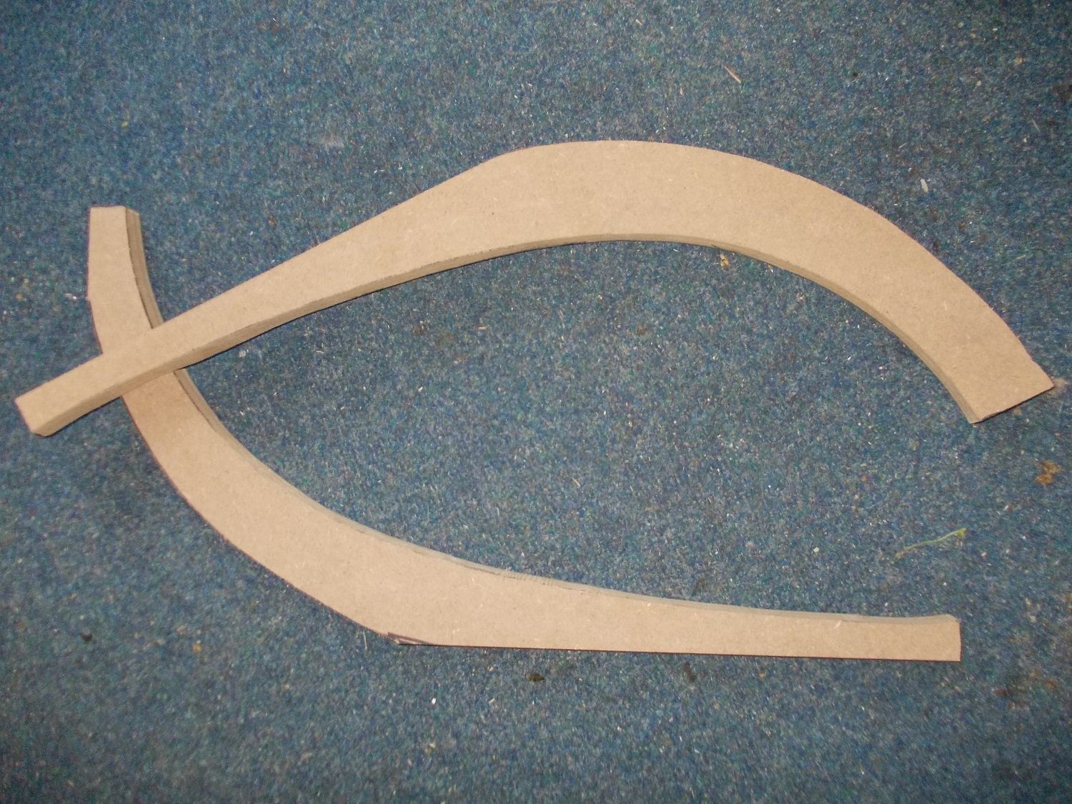

Well, did make the template for the wooden horn flare who go be mdf with saw cut-in's.
then she can bend quite nice glue it en I have what i want.
For the akabak area table I use the volvotreter recheck area who is on paper, just recalc to

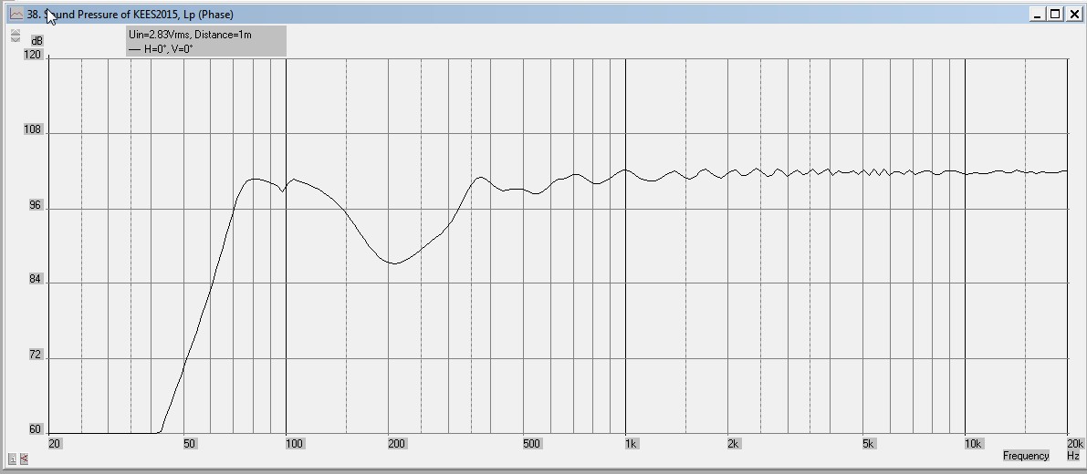

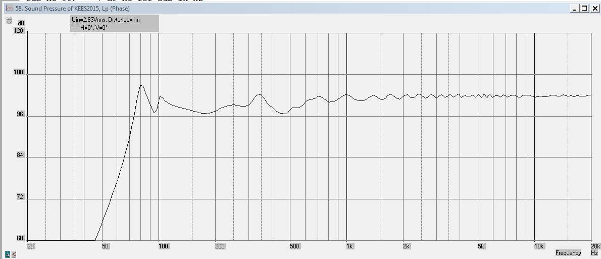

Afcourse just one man can give a look at it, I have put it in akabak, I have use the cm2 from the list from volvotreter, did not like you to calculate full with distance but just width and height of the horn like in my cas mouth is 34.8 x 52.21= 1817.1 cm2 = 0.18171 m2.
I need to do more, just play and see what happens, but where is your BR port? I do see only a big one, and also, I use two speakers of 8 inch under and above, not four, so the ports need smaller to let cover it with the speaker cone.
The high freq portion has quite high efficienty if i see right.

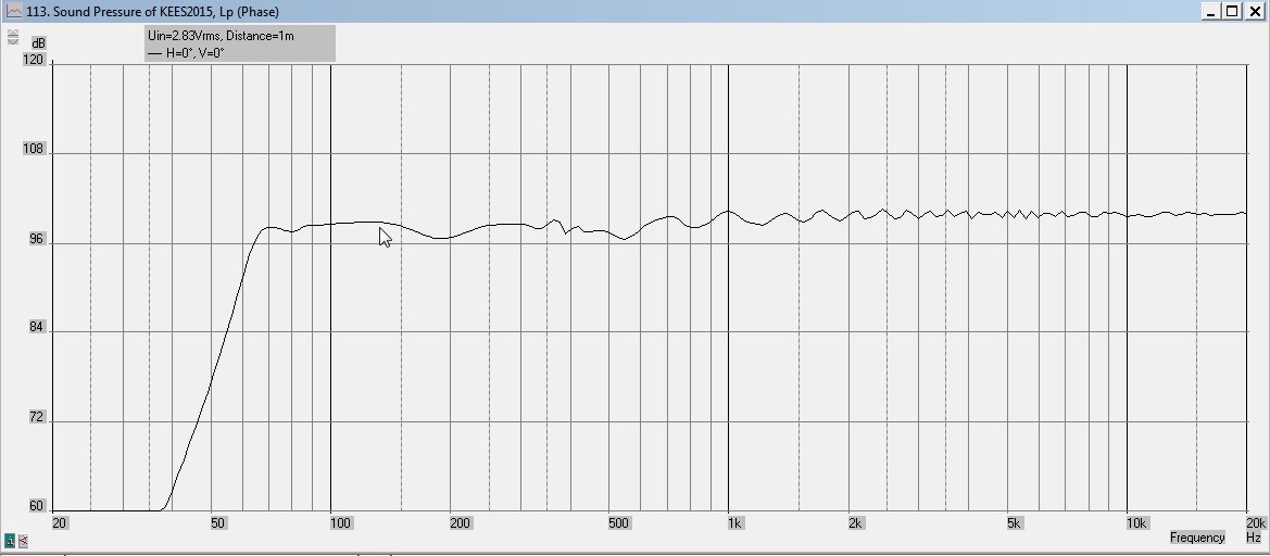

One picture has a dip, this was because of the crossover frequenty, I did rise it to 250 hz high pas give a better plot see pictures.
So look at it with a quick look and say if I am on the good track with akabak. and some tips, I did find the port duct and now how to use now, I can just move them easely and look at plot.
When I use 12 inch like you did this baby go loud.
The plot is not oke yet, some dips and such but it is a start. when I do put 2.83 volts in the little wideband speaker it go to 108 dB, i have to damp it 0.5 for the other two woofers coming in line with a amplification of 3 in your akabak script..

Hi I am here again, I have now did change things in akabak like port ducs, etc,
I like to have it metric, can you help me how to change that, thanks.
here the outcome of that horn, the mid/high is very sensitive, much more then the bass unit, who needs more power, maybe it is because of the woofers, need more sensitive woofers? see script attachment. On the other hand, high need less power and can give very high details/very low distortion in the area what is most important.
I think you like the akabak sim.

Kees,
I don't have my Akabak computer back yet but may be able to run on an old computer that I have to dig out. But yes, the Tractrix is super sensitive - it will blow your away with it's clean but high SPL capability. Get some earplugs for testing - even at very low drive levels, you can hurt your ears. It is tough to find a woofer with 108dB sensitivity - so maybe using four 99dB sensitivity woofers can get you 105dB.

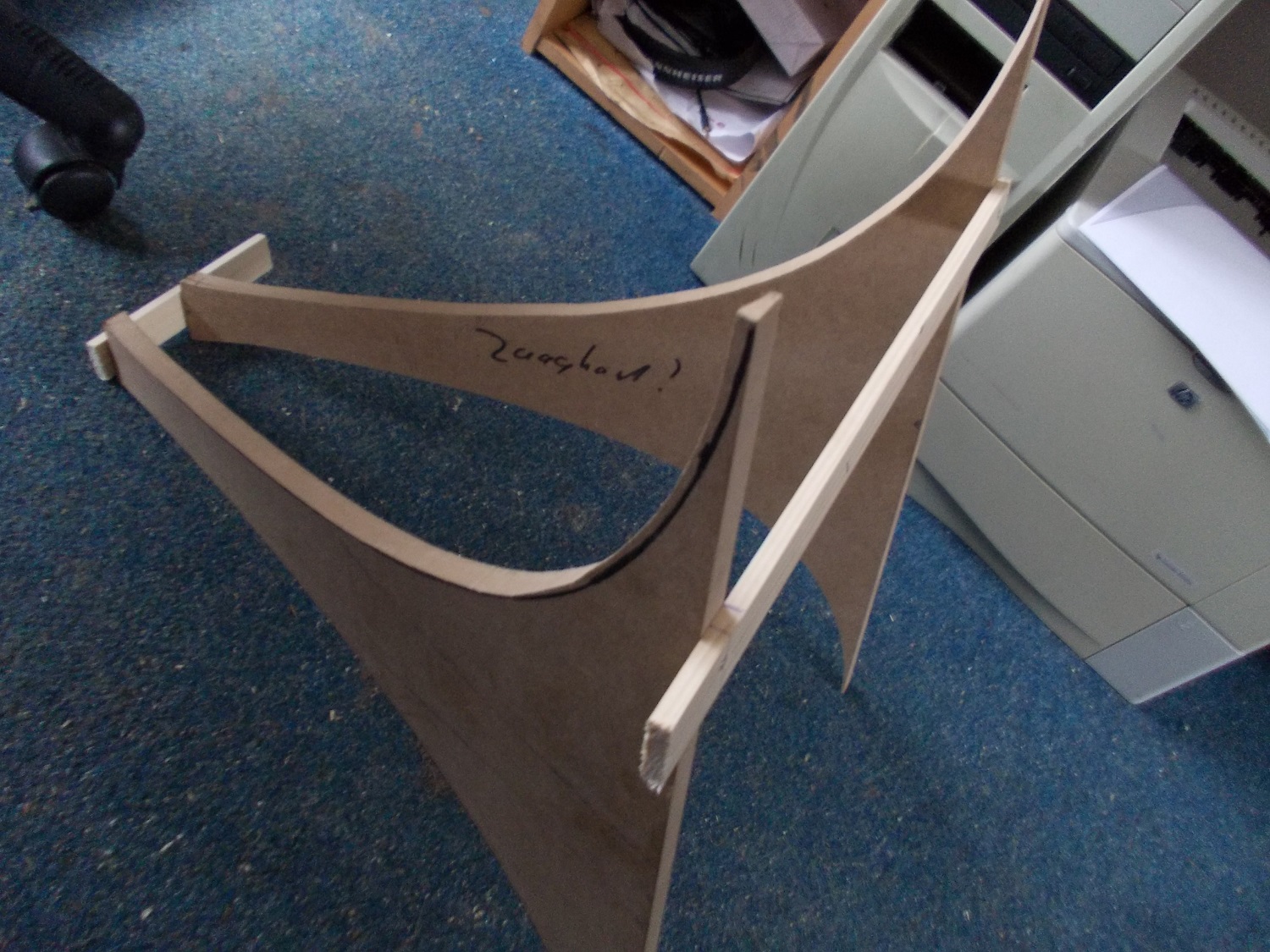

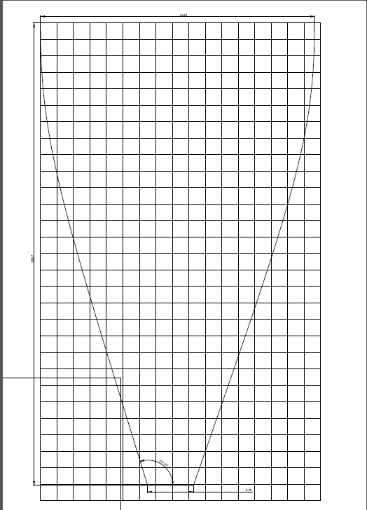

Oke I have desided to make horn different then first planned, I go your way folding the
horn in the conical side panels, glu it on them, make first the horn bend of thin plywood or mdf glu on each other make it stiff and thicker..
But I have seen your drawn you use for scaling, I did see mine is more straight then yours who go a little rounding, if I am clear enough, difficult to explane in english, but I try.
picture of mine is made with table of sheet from volvotreter, I did see yours do round up to mouth this is because of the bend who is needed to form horn, I did just saw form and want glu horn in it to get form see picture three only the point of the wood are fragile, here I need a cm extra who do not give problems with sound..
regards

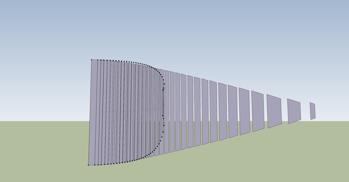

hehehe yes now I now why you advise me to use your template.:headbash:

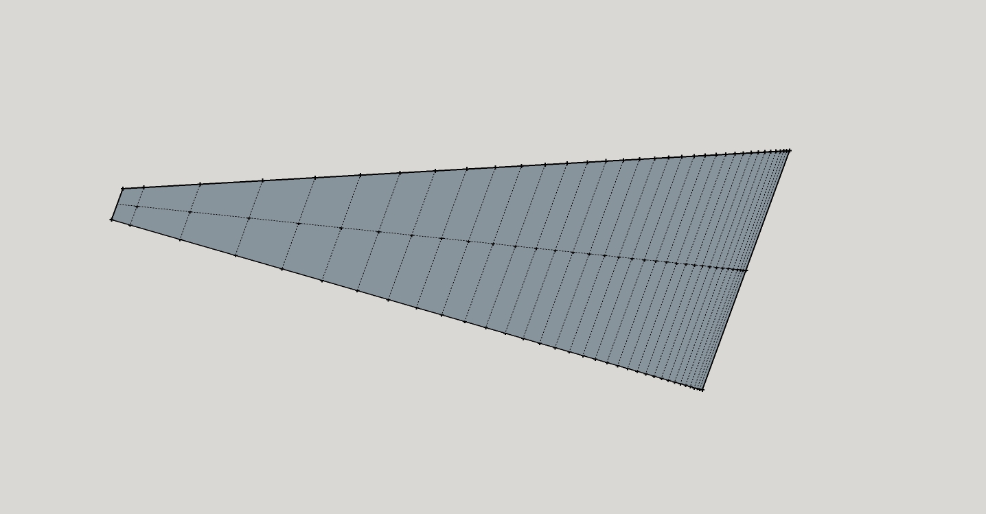

flattening the horn bend to get proper flare your way needs some cad experience, I do this with sketchup and a flattening plugin, so I go look for it, taking it from volvotreter did not work that way, except afcourse if i do use the way in post 477 mounting flare on sides of conical panels.
I am now enough educated to go on, it is just need the hang on it and then we can sawdusting.
Ohh I did find already the tool, see the movie, for others here who want to do, looks so easy, watch after 2,32 minute.

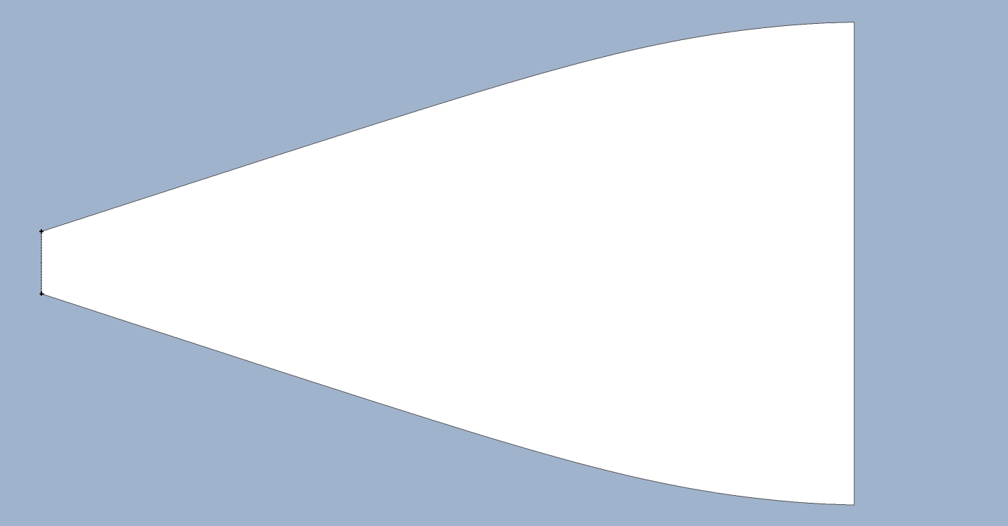

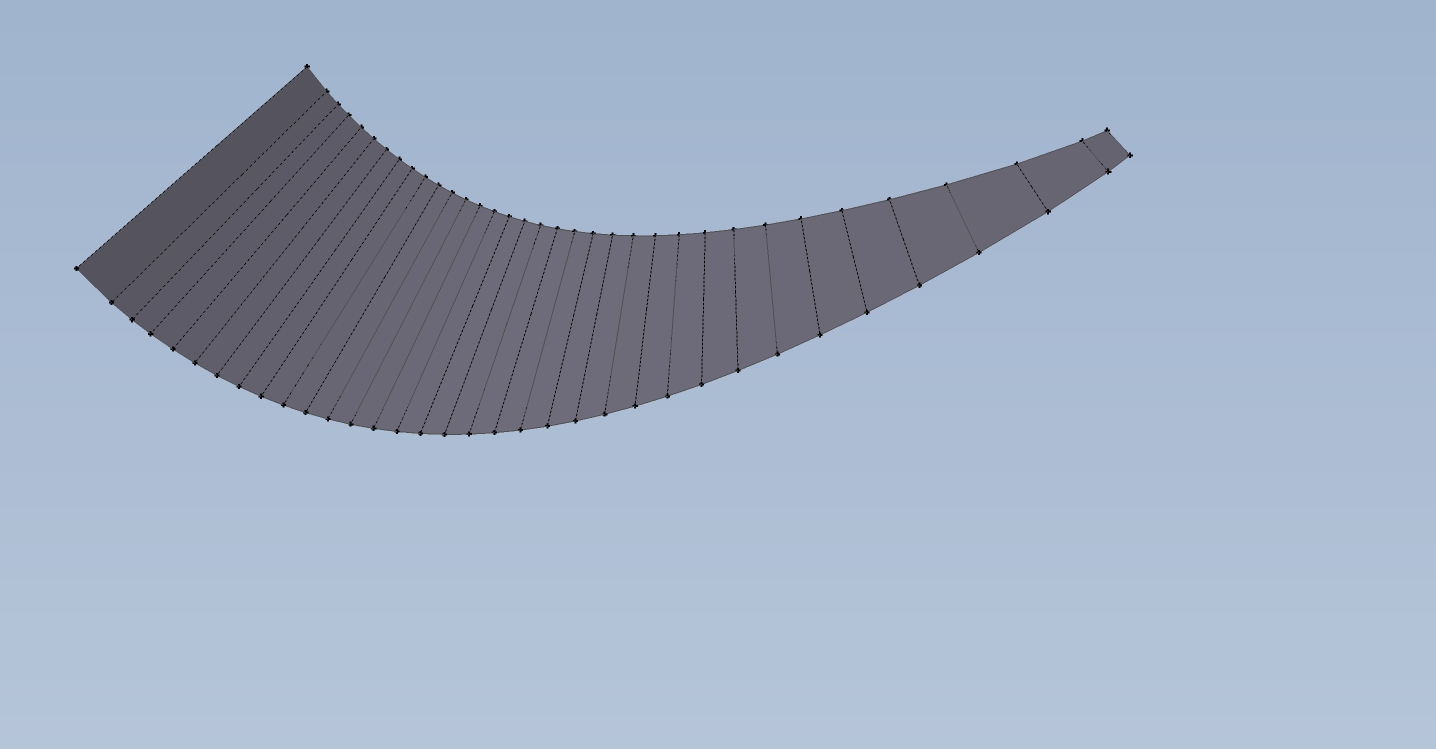

Great that you are learning all about flattening a sheet metal operation. It was one of those things that after I did it, seems not hard but looking at all steps involved - not for someone who was not handy with 3d cad. Great progress.
Really it is not difficult with sketchup.
Only when flatten the length is 2,3 cm to short.
see pictures what I did, it works fine I go ask that people why it is shorter, I need precision. In foto two you see when flattening it get appart from each other, I can move them back to closing again but then I get to short, and if all closed to long, only width is oke on both ends.
regards and thanks for support.
