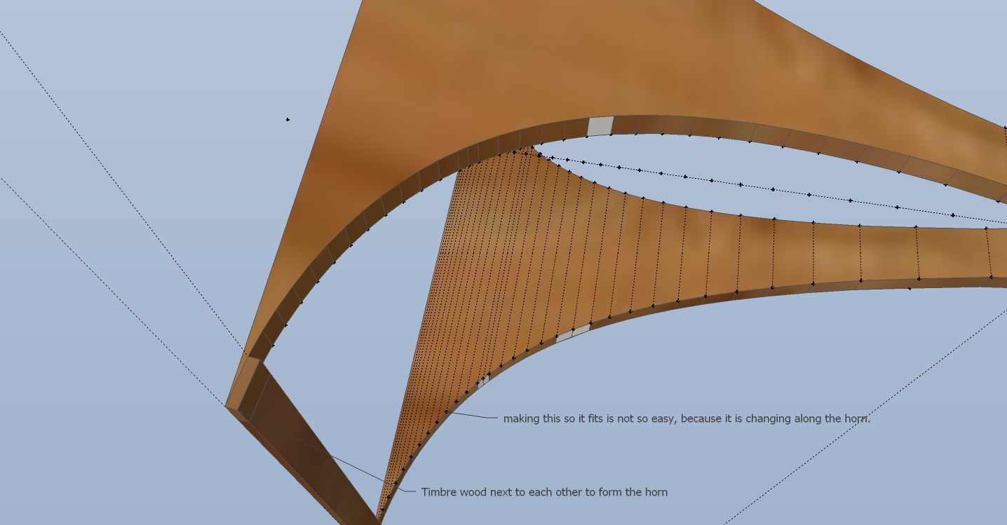

I have get some wood and look at how to do it, it is not so easy because along the horn dimensions change in degree.
I think build some day a cnc router 3 meter by 2 meter for this kind of things.
Now I have to file it. but maybe some here has some more beautifull ideas.

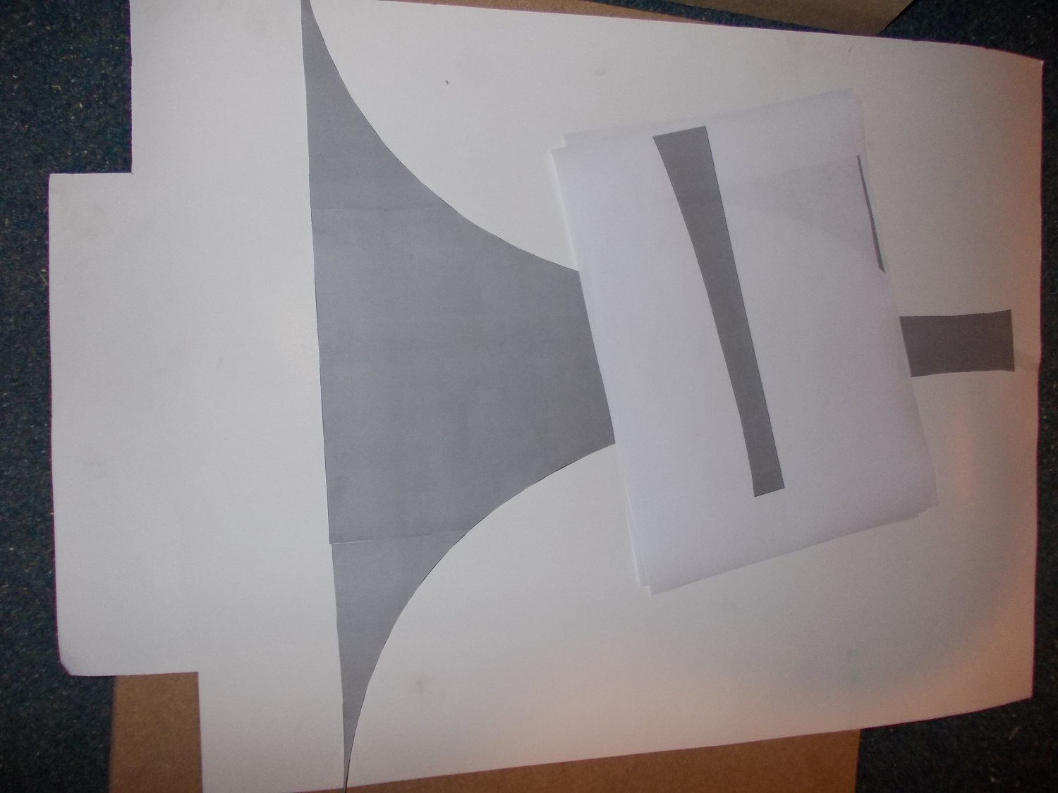

I have tryed to print the design on paper for further work but do this with sketchup on the right size is remarkable complicated and not preciese.
who have experience with it, export to autocad did also not work, also here measurements are way out of line.

It is not problem for me to make from scratch it's also fun, I did that already completely in sketchup, but problem was the draw program who print things wrong dimensions, thought that pc was more precise but for I need a apple. the rest is not so difficult to do, I do try some others also.
I download slodworks to see what it does, I have no autocad. and I go look at te printer it looks it has own scale function activated hp 4100 TN postcript.
Thanks for your help so far,
regards

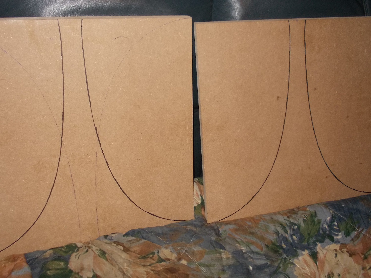

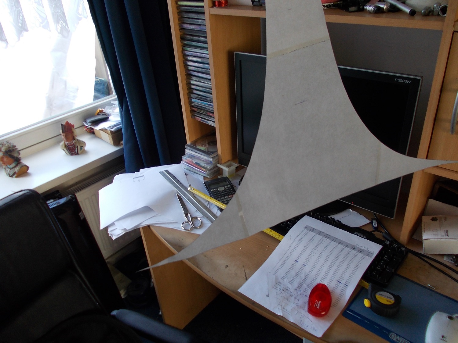

Welll after a evening of if not succeed try try try again I did have succes
to find out why sketchup did not print well, now I have 5 pages with parts of the horn
exact 45 mm throat and such, now I can draw the horn on the panels.
What a problem making it so difficult in sketchup, the printer itself was not the cause
these bulkprinter do wel for his age..
Drawn the horn with sketchup take me one hour 26 minutes with 34 steps..
regards
I hope I did not hijjack this threat? it is so quit, but oke I have make the drawns and can sawdust them and form the horn itself also with a template of strong wood and very thin mdf or plywood.
