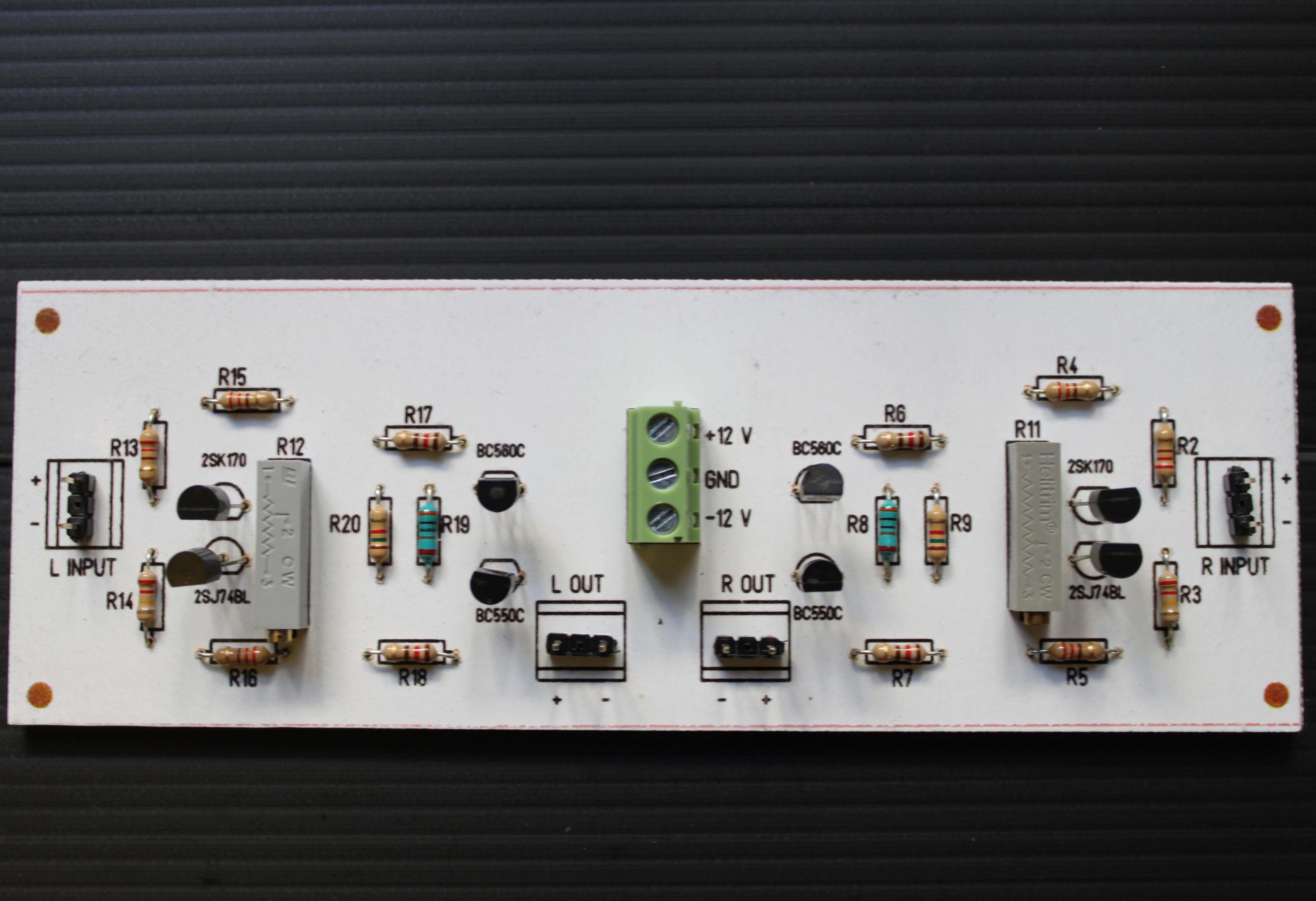

I am building a Juma's pre (post 53 schematics).
Question about DC offset .... which is the acceptable value ??? I am able to adjust ch right to 0,0mV, but not able to go under 87,2 mV on Ch left. RGDS

0mV is what we aim for, but couple of mV up or down due to thermal drift is OK.
87mv is not acceptable - you have wrong value resistor soldered or, more probably, input JFETs are badly mismatched...

Yesterday I forgot to say that BC560 is B (not C). Is the BC560B/BC550C couple an issue ?
After several JFET/transistors swap (tried many combination i am actually at:
- CH left drifting from -8mV to +6mV (pot P1 is in the middle of the run)
- CH right drifting from +1mV to +18mV (pot P1 is at the end of the run)
............... better but not good enough i think

I guess you should be able to change that with a resistor on the adjust pot
wouldn't +/-10mV be ok ?
Ideally, BJTs should be matched as well as JFETs. P1 can adjust for some level of differences but it's not all-mighty. Also, to minimize offset drift, thermal coupling should be implemented (posts #54 and #82)

It explains the thermal drift......This is a picture of my current layout
You have pictures of good working layout in posts #54, #82 and #90. I suppose that you know why did you choose to ignore it ... 😕
looks like your jfets could still be pushed to touch each other
and the BC's ? maybe 'join' them with something heat sensitive
I started considering the layout in suggested posts. But later i wanted to try my own way only for the fun of learn a PCB design program and play around.
As i am a novice i didn't know/considered that FETs need to be thermally coupled. Thanks for help
