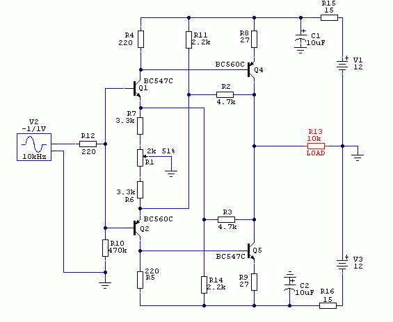

BJTs as direct replacement - no way !
But if BJT is your weapon of choice, this can fit the bill (Zin is about 300k, gain about 3.5 V/V, Zout less than 300 Ohms):
Thanks Juma!, I will try this one.
