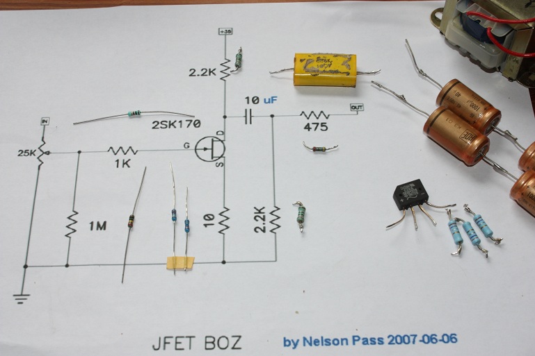

so its rubbish and not F5, and what then ?
or the whole schematic is rubbish and wont work at all ?

output Jfets are overbiased and will go puff , either with current and with voltage
ah, ok, I would use +/-20V
would that help ?
a few missing resistors maybe ?
ofcourse
do you have any possible size in mind ?
I can just as well admit its not for F5, just to make that clear

another silly basshead question 😀 is it possible to go high Z (1Mohm) with that one ?
yup
considering that cable capacity influence will not harm your thick wires frequencies

high-Z input with a little gain(6-12db), and running on +/-20V

you'll probably get more bone with simple Jfet BOZ
ah, I see, have that one in my bass preamp file already, from google
but high 0/+ voltage 😱
but you are right
from reading jfet boz thread, it really is tempting for bass input
simpler, and very well documented
and seems Nelson actually found lower distorting with lower voltage, so taking the positive rail of the +/-20V ought to work ok
