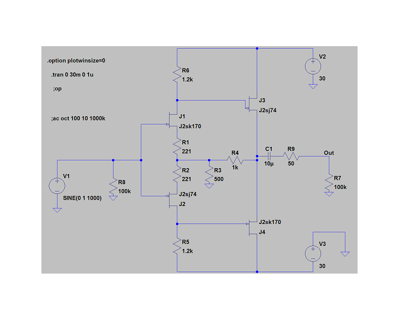

Anyway I made a better version of that preamp:
MOSFET-trioda Mju folover verzija - Solid State - diyaudio.rs
Is it possible to let the two 1M resistors (one from each channel) share a common bias voltage (like in B1)?
Absolutely. Just take care with the layout.Is it possible to let the two 1M resistors (one from each channel) share a common bias voltage (like in B1)?
The definition of a voltage source amp can be a grey area. The output Z of a TCA need not be a very high value like >100 Ohms. For example, the several F-type TCAs in www.firstwatt.com have an output impedance ranging from 15-80 Ohms. The definition of a voltage source amp in my book is straightforward. The output is taken out of transistors connected in the common drain configuration; meaning opposed emitters; with, and without an attendant loop feedback. This is a classical definition. Another example in ACA#1. Its output transistors are opposed drains of MOSFETs; meaning an operating common source configuration. It has an output impedance of 10 Ohms in the abscence of loop feedback, and thus is a pure TCA in my book. Loop feedback lowers this TCA's output impedance a bit further; but not enough where it is <0.1 Ohm like a true voltage source amp. In my book, ACA#1 is a hybrid TCA-VSA. It embodies the best of both worlds to express its magic.
My apology flg. I mispoke [miswrote] regarding the underlined above. The output stage MOSFETs in ACA#1 are not opposed drains.
After few months of experimenting here is the circuit that sounds best to me - it's the same topology as the first one in this thread but with BJTs in output and higher Id through JFETs (6ma).
It takes the +/- 24V from F5 (they are both in the same case - F5 as integrated amp) and preamp's OUT is connected directly to F5's input.
I used the PCB from the post #3 of this thread but with some diferent components and values.
What is it about the sound of this pre - that you prefer over the differential pair version ?
Does adding a current mirror, to the differential pair, help with the matching of the jFET's ?
I'm wondering about how much audible noise those carbon variable resistors add.
If the 10K volume control is at the front of the pre, the noise would get amplified by the pre and power.
So I'm wondering if the volume control should be placed between the pre and power amp.

You said that you've spent a months experimenting and here is the circuit that sounds best to me
So I legitimately ask you what it is you like this version, over the differential pair version, and you just about soil yourself.
The questions about the current mirror and location of the volume pot were pretty reasonable too.
Don't f**king bother.
Uu, it was years ago and I've built more than a dozen of different preamps since then. You can't expect me to remember all of the details how it sounded to me in that time - what was true to me then still stays written.
P.S. No need for harsh language, I'm not your employee - what I had, I gave. What's your contribution here ?
