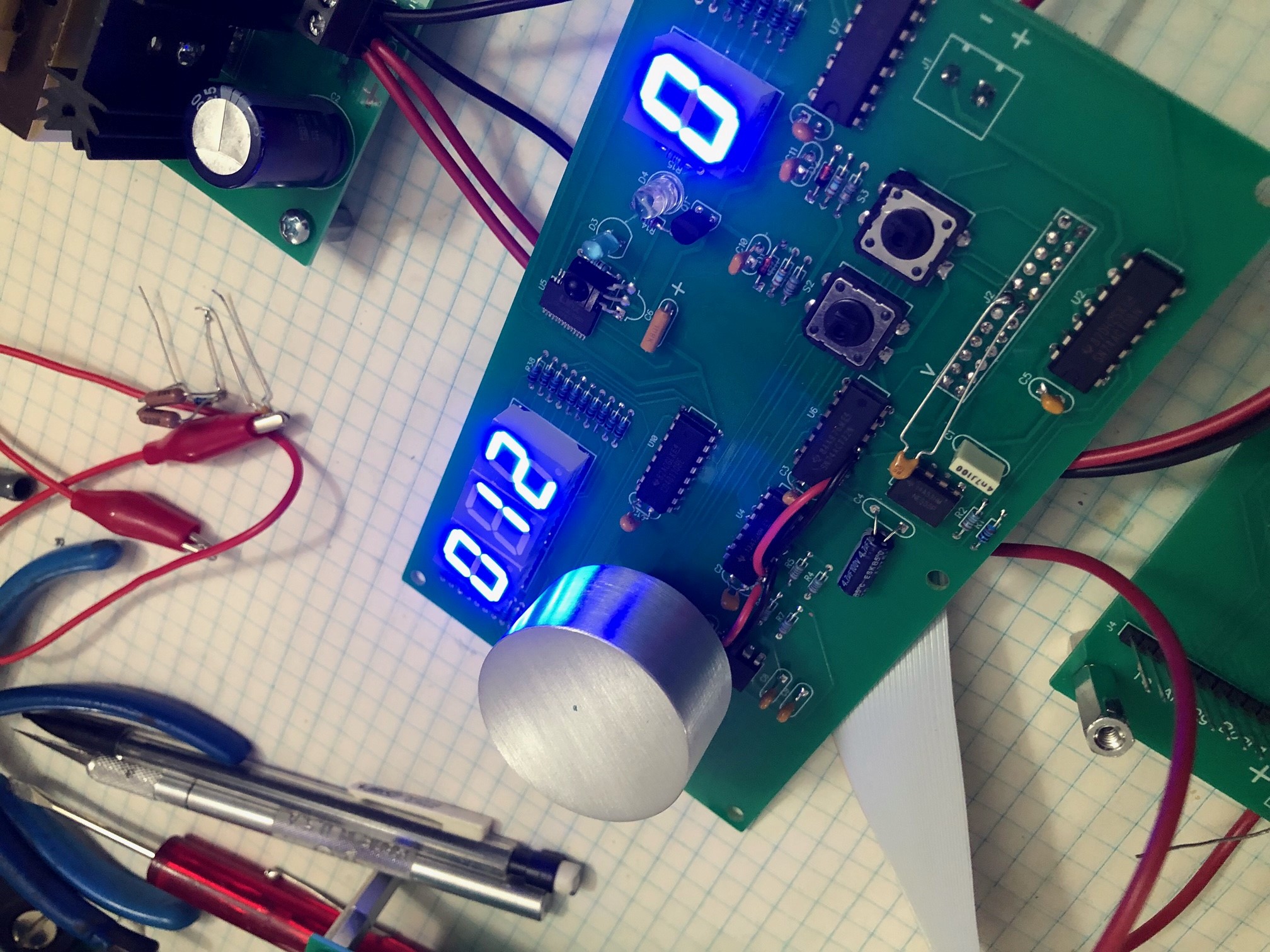

And here is a couple Pics of the boards. The rotary encoder is under the home made knob. I used 32mm aluminum round stock and cut off about 18mm long, drilled, sand, clear coated. $1 knob instead of $15.

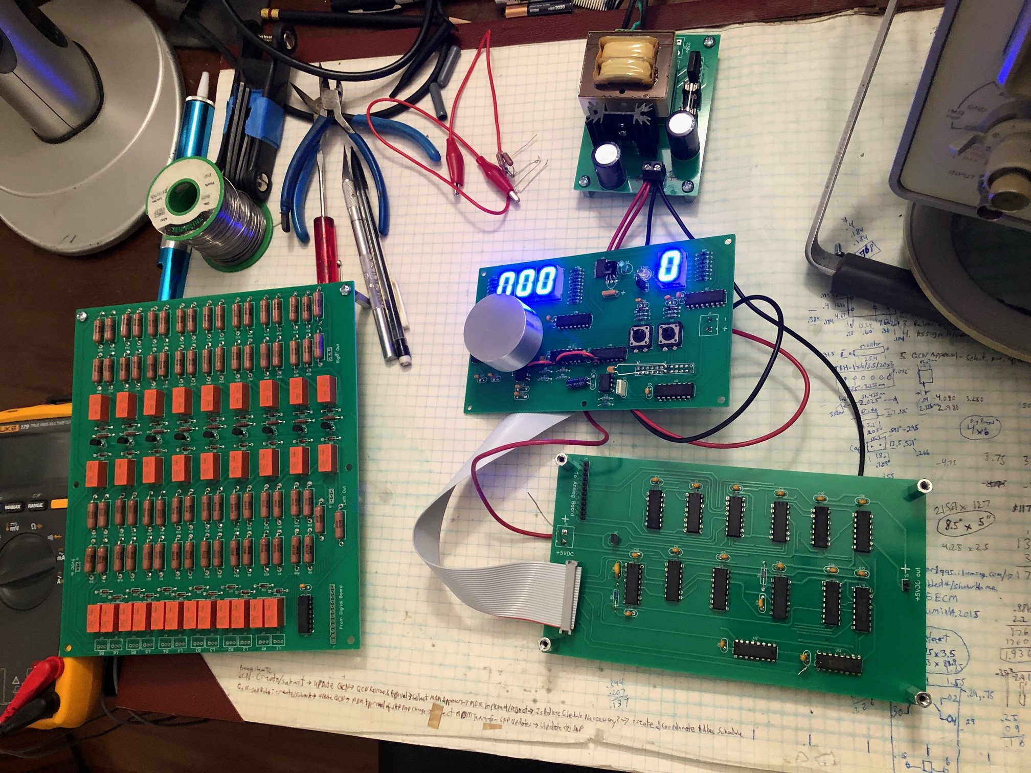

As you can see in the photo there are four boards, a power supply, display, digital, and analog. There are two versions of the analog board, the larger one is for two channels of balanced signal and a smaller board, essentially half of the balanced board, where the positive signal is used for left channel and the negative signal is used for right channel in a single ended system. I guess you could use the balanced analog board for a 4 channel single ended system if you wanted to.
The picture shows the analog board just set aside while I was using the oscilloscope and multimeter to kill a bug in the design, in actual use it stacks over the digital board using 3/4" standoffs saving a small amount of space inside the preamp chassis. I will post a picture of the boards together under listening test conditions.
