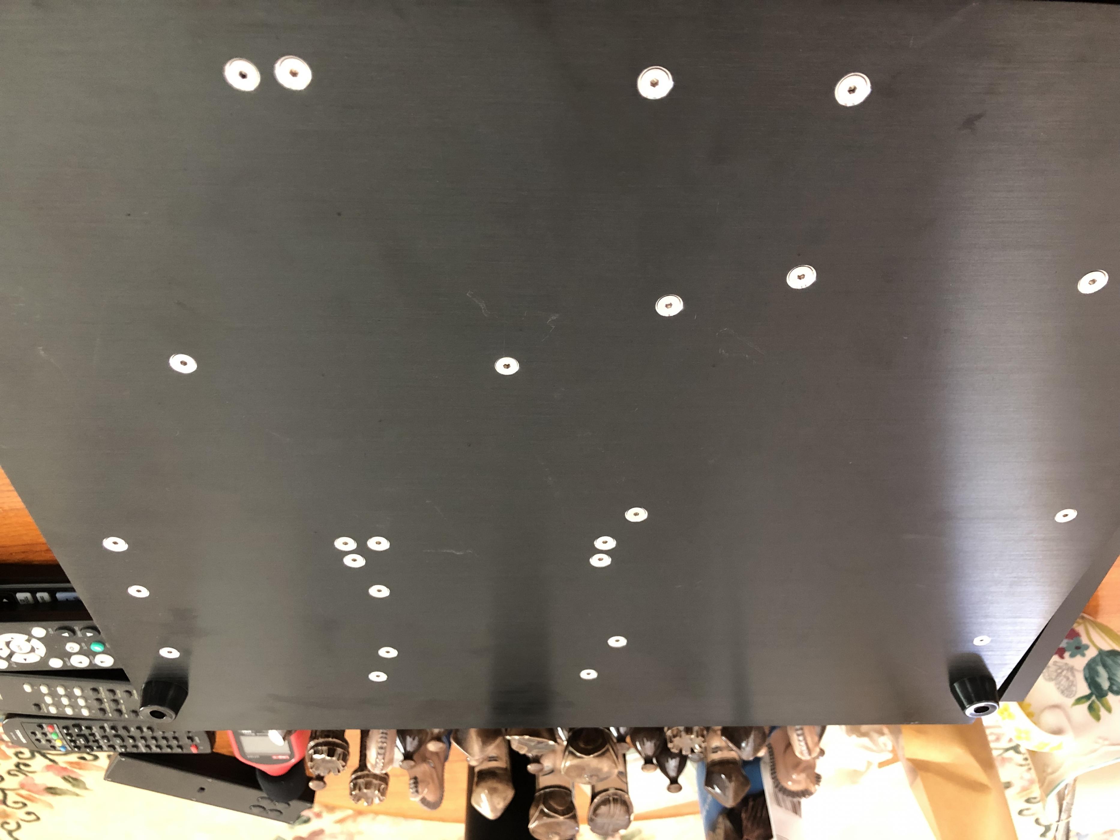

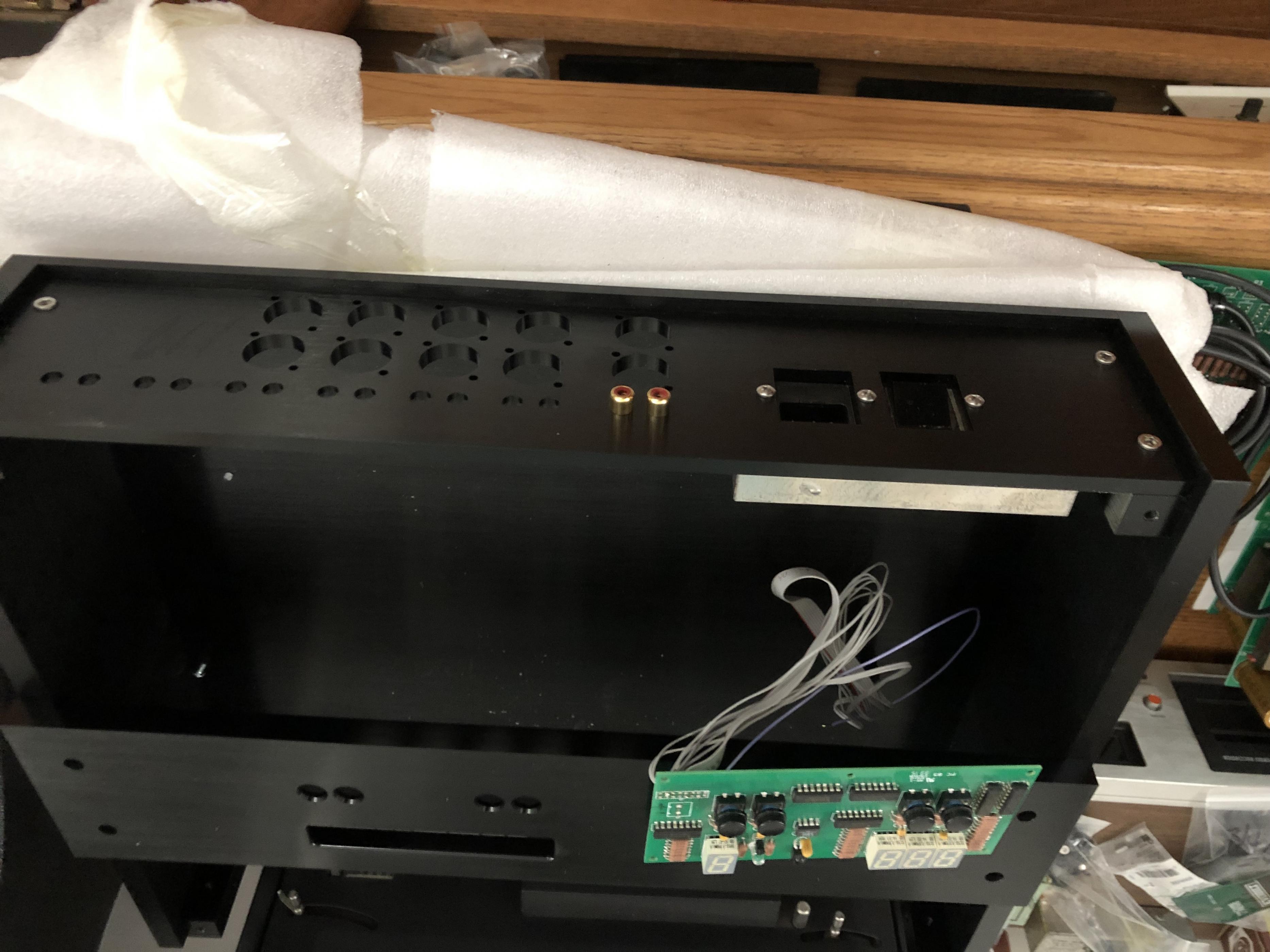

On another note, the CAD files for the chassis that I sent to a machine shop in China arrived Wednesday, they produced some very good quality parts for the preamp chassis. With 1/2" thick faceplate and side panels and 1/4" thick top, bottom, and back panel this will be a substantial feeling preamp. With a fine brushed finish and black hard anodizing the parts are beautiful. Once assembled I will weigh it and post pics. The parts cost me half of what a USA machine shop that I usually use quoted me, even with shipping heavy packages express from China. I highly recommend the shop. You can check them out online at Runson.com.

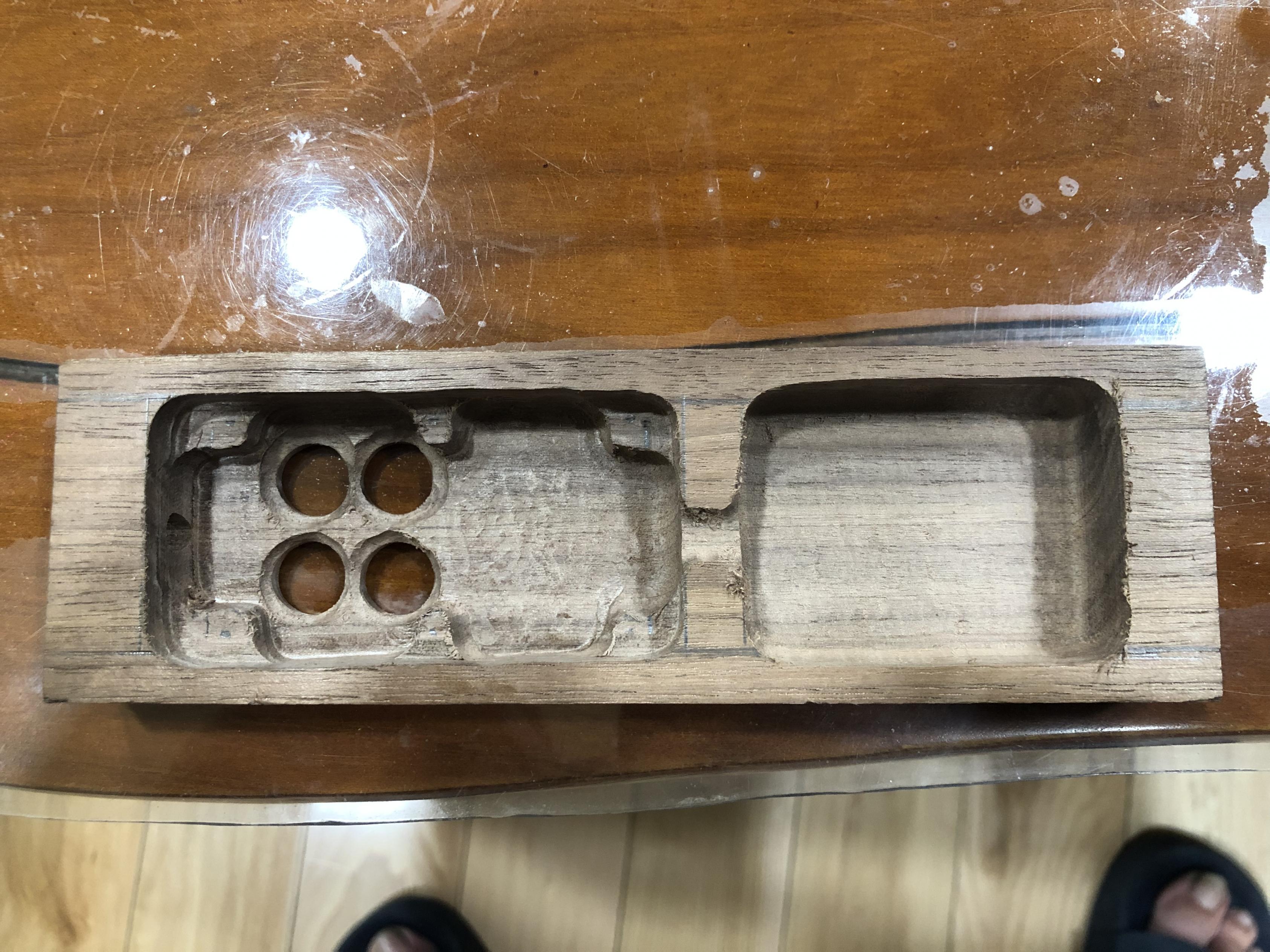

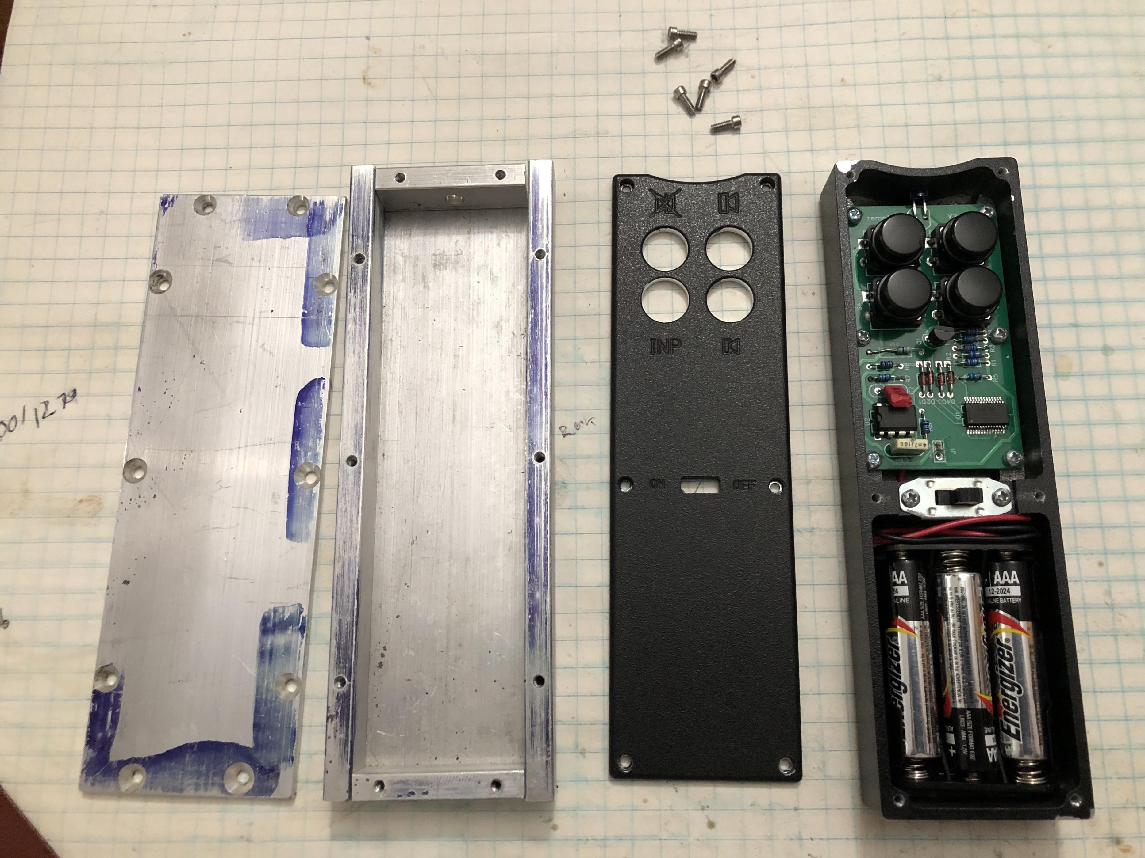

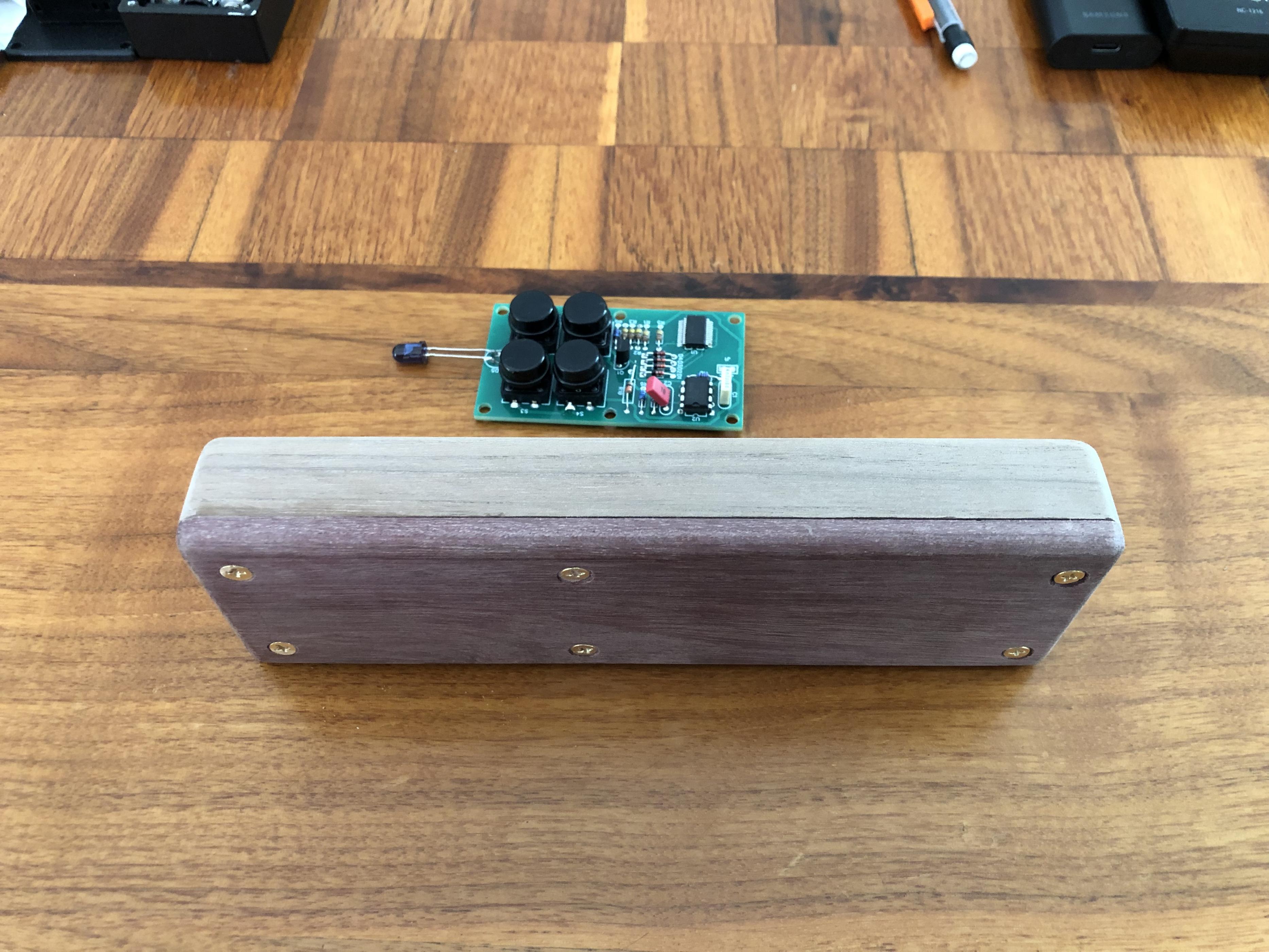

For the remote, as well as other boards, I will have to supply the hole dimensions so people can create enclosures. I can also post a pic of a commercial enclosure for the remote and one I started with just plate aluminum and bar. I had one friend who is a wood worker and made one from Walnut, was beautiful.
I have a CAD drawing for the faceplate of the preamp enclosure that I can supply. Still need to take pics and post.

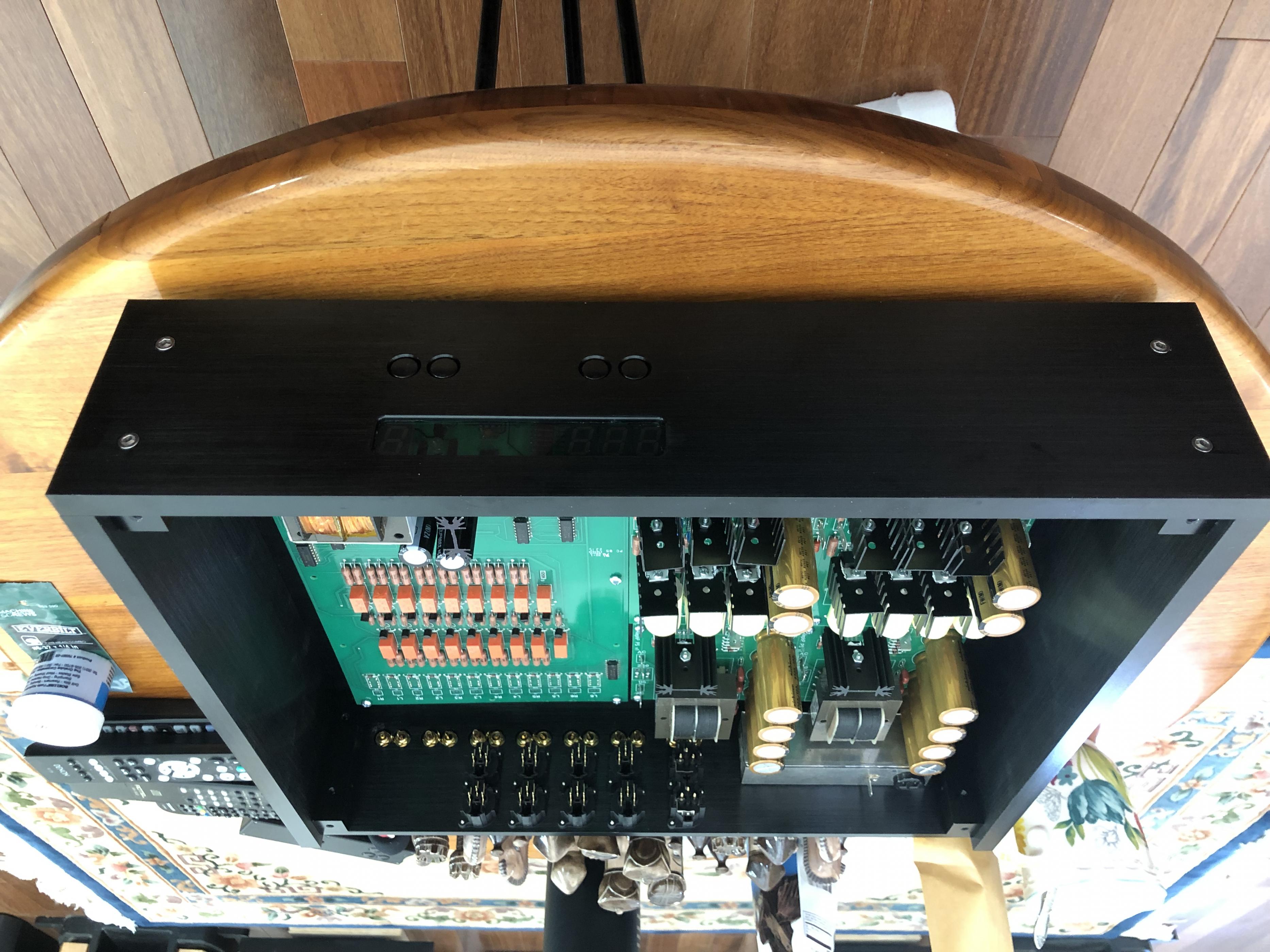

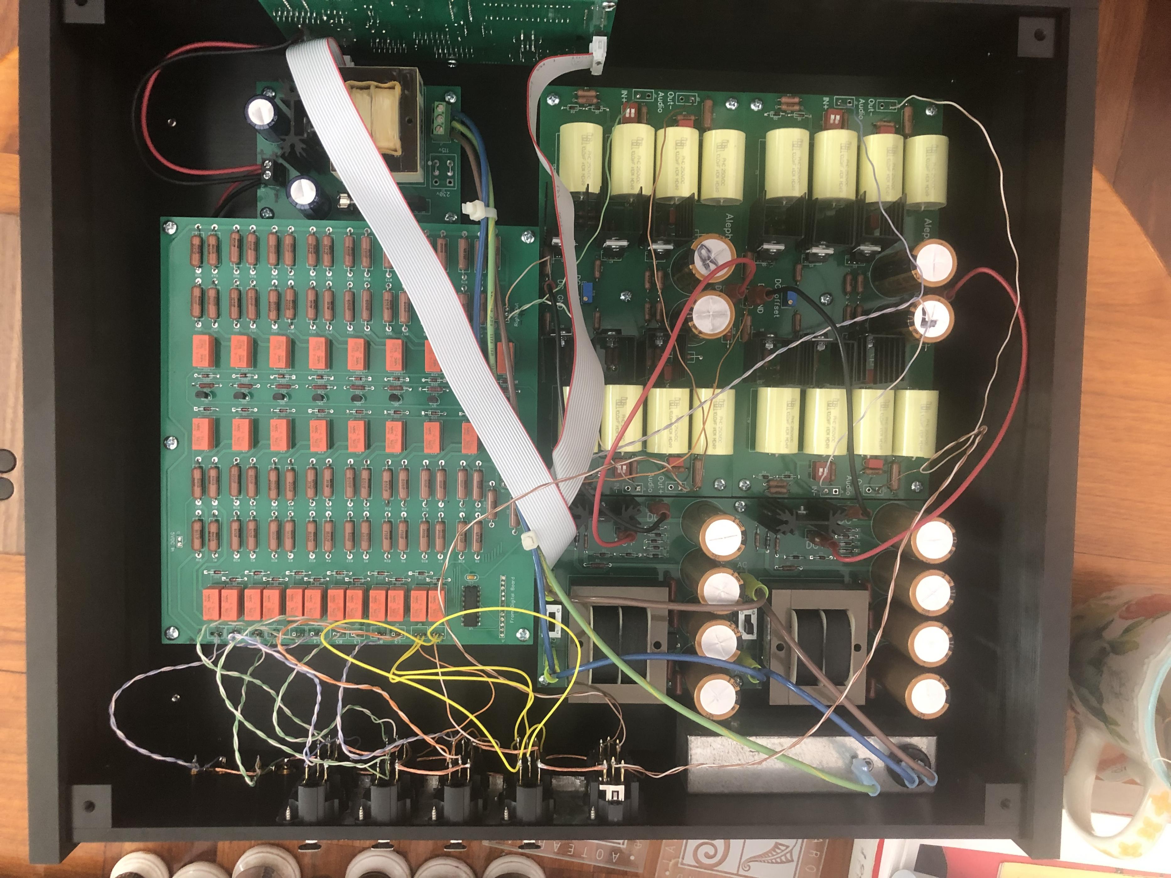

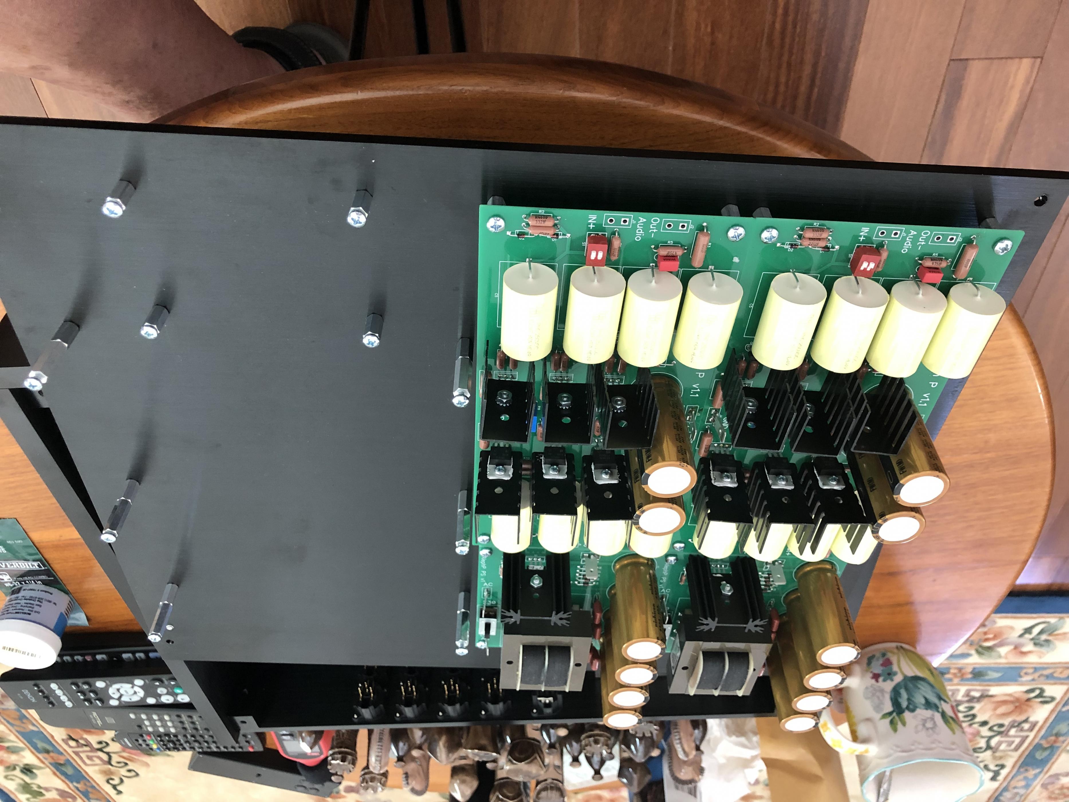

And some pics of the preamps I am building, one with the old design volume board with the updated resistor values, and one ready for the new volume boards when ready. These chassis I had machined based on the Pass Aleph P are heavy duty. The preamp section is based on the Aleph P which I own so I have a constant for comparison.

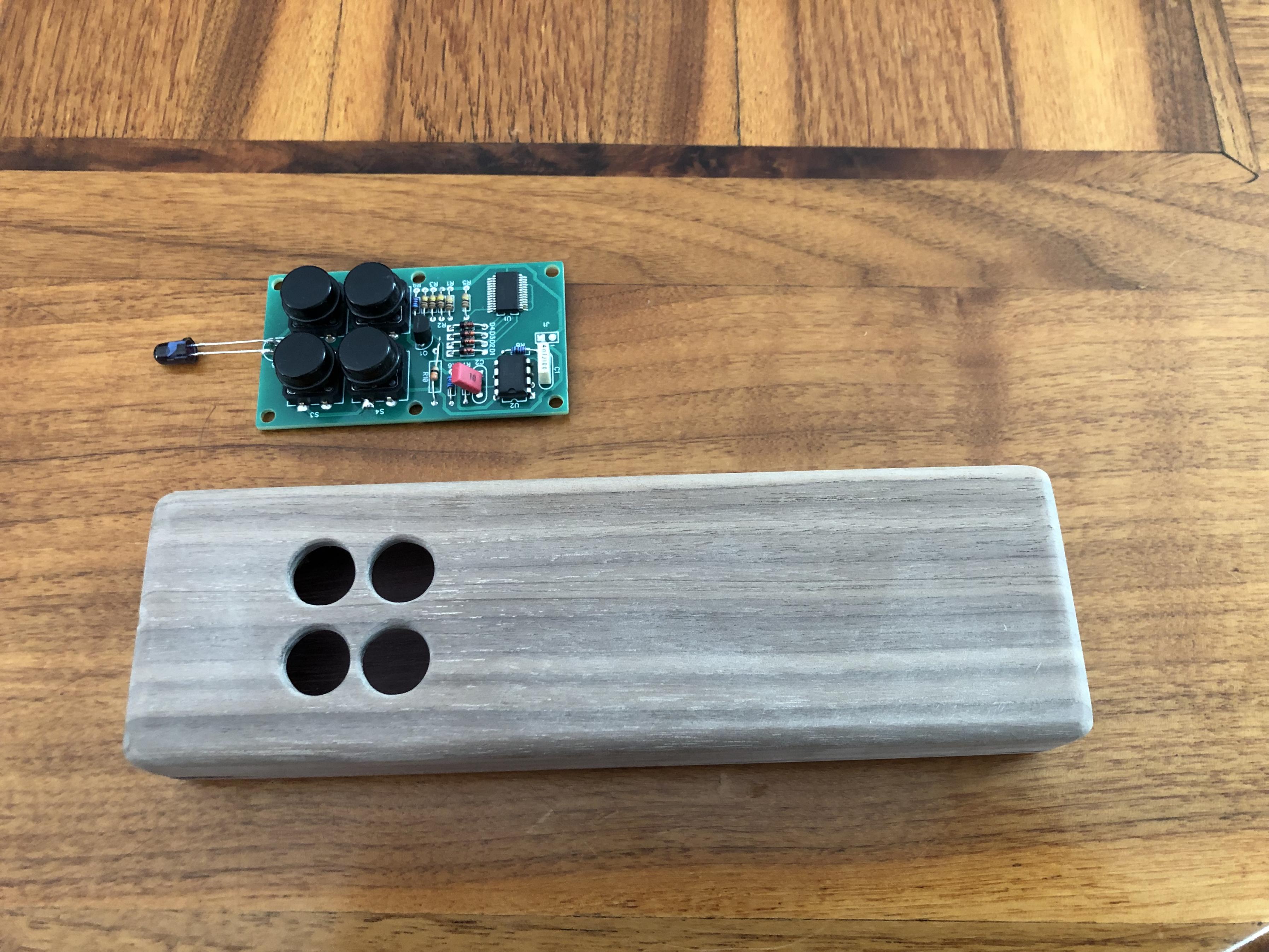

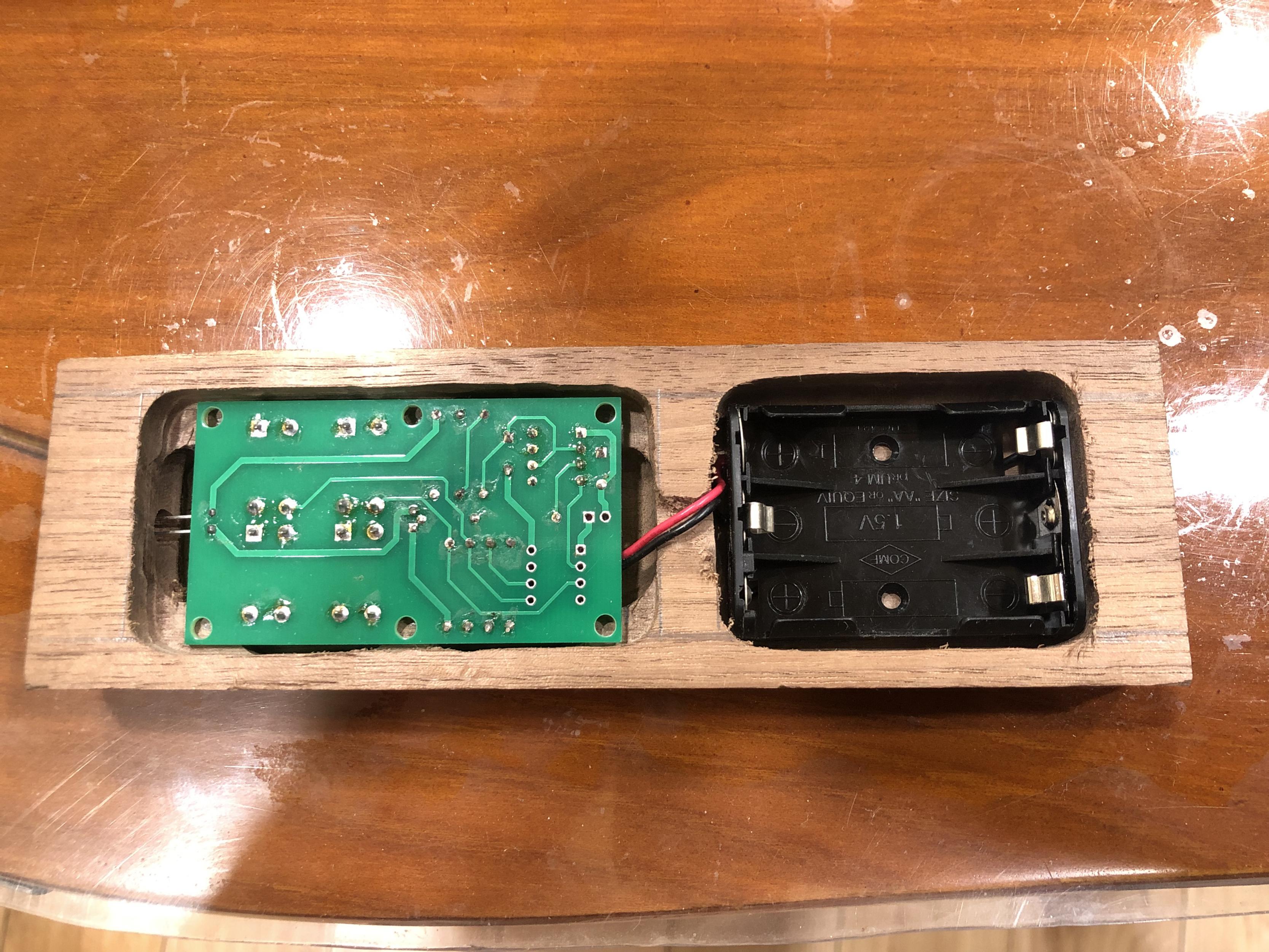

But in the mean time I have been working on a Walnut case for the remote which will be a nice touch. I will post pics of it when done.
I did finish building the first preamp with the original volume control board, with the updated resistor value which doesn't load the input sources too much, and the Aleph P preamp section. I was so impressed with everything about the sound, bass extension, extended smooth highs, pin point focus and natural timber, that I played music disk after disk for three hours. Nelson Pass design of Zen, fewer parts and simple circuits really works. I have the Pass Labs Aleph P preamp but I used a few different parts in my build and it actually sounds better, I was just amazed. I was even more amazed that it started up and worked properly first time. 🙂

I am trying to attach pics of the walnut case for the remote but the system is giving me problems. Will try again soon.
Here is a couple pics of the remote.

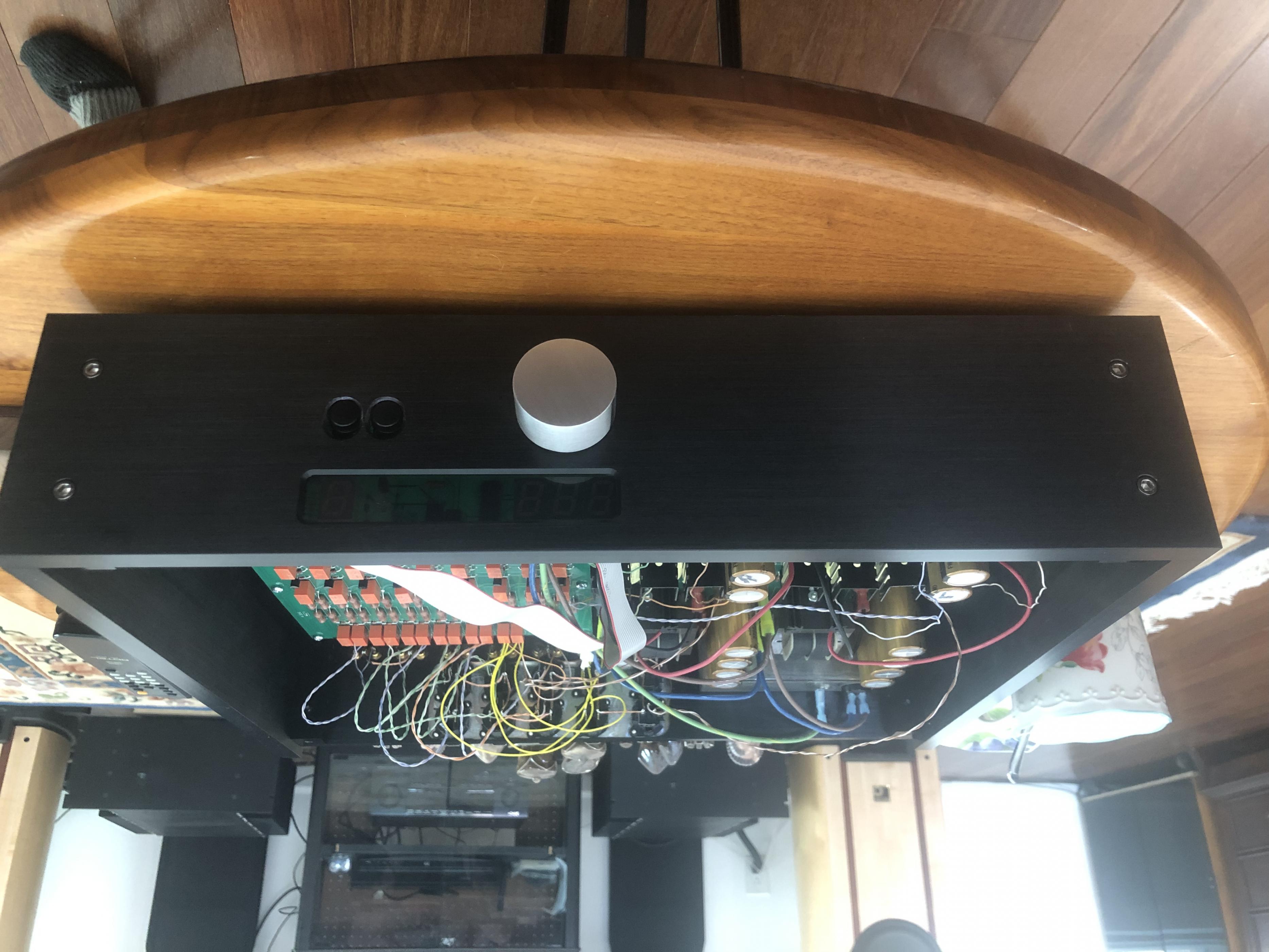

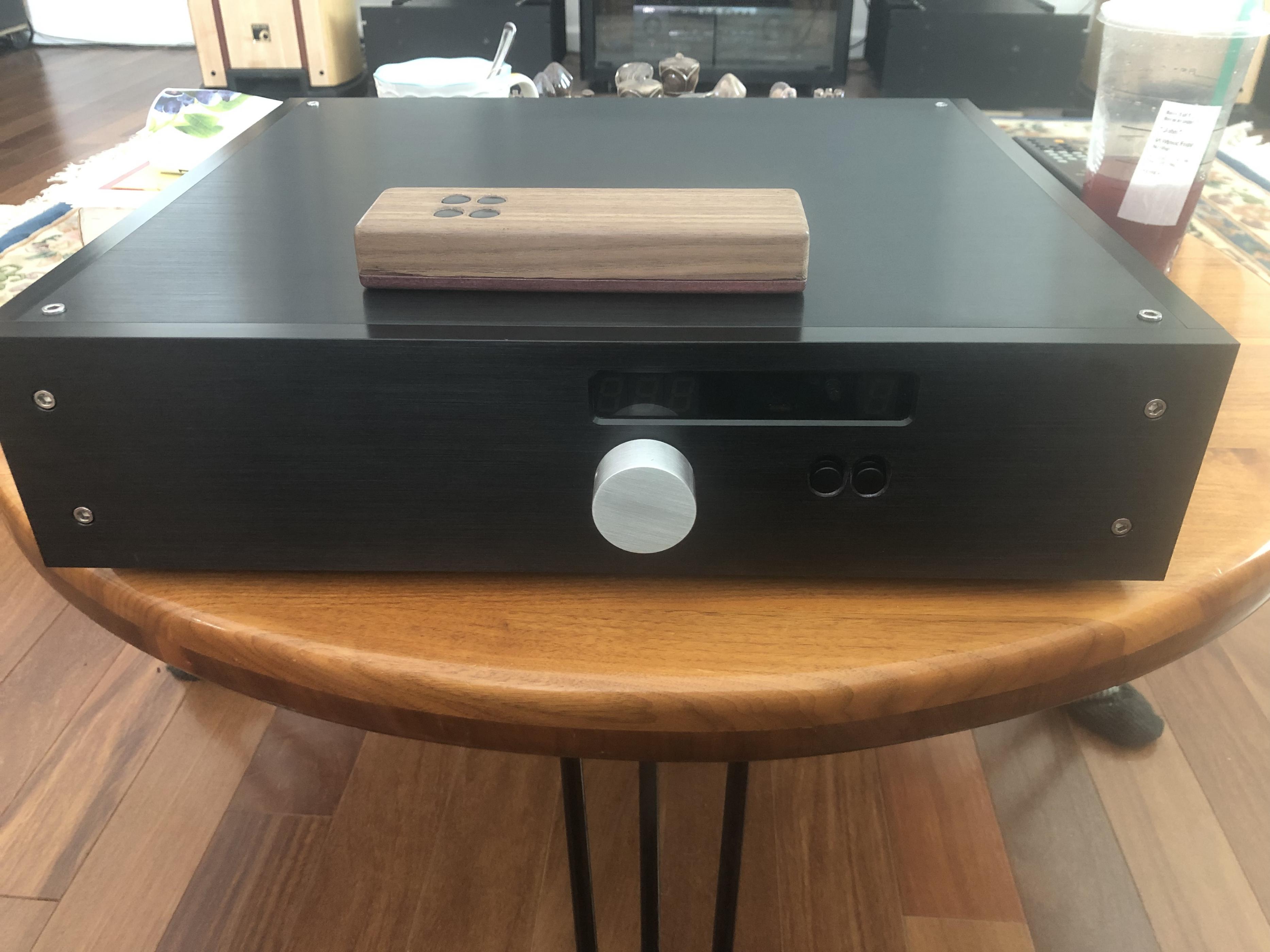

Today I finished putting together my new preamp using the new volume control board and I have been listening to it all evening. It sounds pretty good, with good source material it is as transparent as I have heard. In a couple days I will take it to my audio business friend and let him listen to it for a couple weeks to get his opinion then I can release the new BOM and gerbers. It is an easy and straight forward build but I will write a quick build guide for it as well. I will take some pics of the boards in the preamp and preamp itself.
And here is a couple pics of the preamp. Unfortunately when I made the display board larger I moved the mounting holes and enlarged the pocket in the front to hold it but forgot to move the push button holes down. I will fix the CAD file before posting it.
