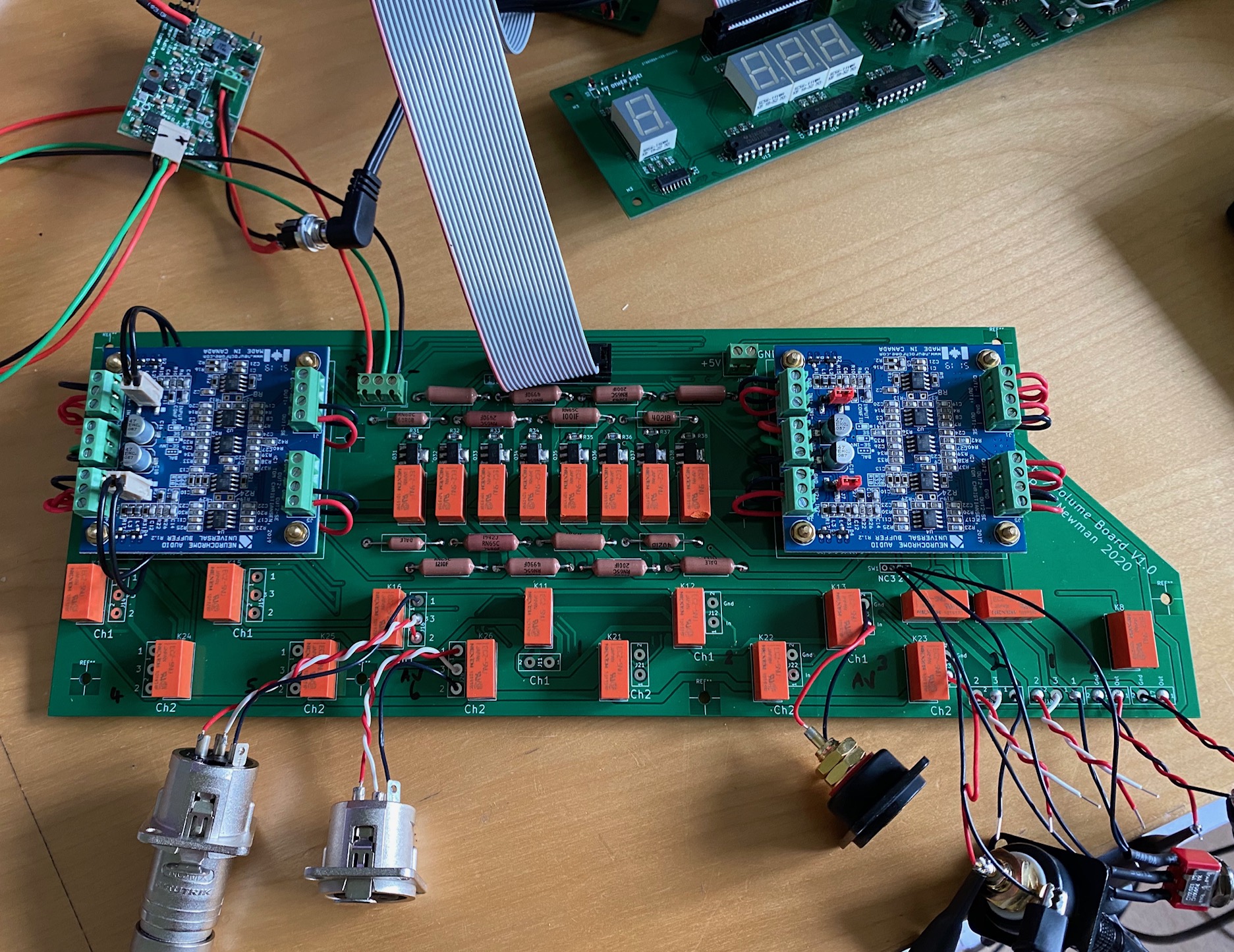

I also designed the input selection / volume board which I'll build first as the existing boards should work with this regardless of the issues. This uses two of Tom Christiansen's universal buffer boards that will mount on the board I've designed. This allows me to have balanced and single-ended inputs and outputs with the volume section being purely single-ended. Half the resistors and relays needed!
It's going to take me a few days to get all this built up, I'll update with some pictures in due course.

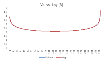

So I've now got a complete system up and running on the bench as I've built up the relay / selection board. It works after I discovered a fundamental error - I reversed the order of the 8 bits that control the volume relays! Fortunately there's an easy fix for this - reverse the order of the resistors so I got a bit lucky really.
Before I discovered the cause of the error I was puzzling over why I was getting strange reading for the resistor network when changing the volume values, whilst doing this I noticed something about the circuit I'd not realised before - at all volume values over 0 the signal is connected to ground via the resistors whose relays are off. So at vol=0 the input effectively sees infinite impedance but as soon as that's advanced to 1 it's connected to the output via the 8K LSB resistor BUT it's also connected to ground via the 7 other resistors. In parallel these make a 31R resistor. Obviously this changes for each volume value but it's clear that the input is going to be quite heavily loaded. After debating an R2R circuit I'd effectively copied the original circuit and wondered if I'd made a mistake somewhere. I checked your original circuit and see it follows the same principal - was this intentional? Or have I missed something?
Compared to an R2R or a simple volume pot which both present a near constant impedance to the source this circuit presents a constantly changing impedance from infinite to as low as around 124R and back to something approximating the impedance of the connected output. The graph attached shows the change in (the log of) impedance as volume changes.
So ignoring how hard a load this might present to an input this causes me an issue as I'd added an AV bypass circuit. This simply bypasses the volume resistors BUT, as I now realise the signal will still be connected to ground via whichever combination of resistors do not have their relays active. So, at low volume settings this resistance is low enough to cause the buffer to go into clipping at levels of around 2.5V pk to pk. Therefore if I select AV bypass and the volume is set low enough the output could be clipped which i guess shows the buffer I'm using has reached its limit. I need to do some more thinking on this as I'm concerned I may have to do a redesign of the relay board.

Ah, it’s not really your source equipment that’s untroubled by the low impedance it’s the input circuit in the Aleph P that can drive such low loads. On reflection I think the this volume control is not really suited for general use unless the circuit driving it is intended for such a purpose. I’ll look at modifying it to suit my need better, I’m very close to a fully functional preamp, I may actually try it as is just to see how it sounds!
The more I think about this the more I'm annoyed with myself for not looking at the volume circuit in more detail before using it. This is not a dig at the OP but the circuit is not suitable for general preamp use as there's pretty much nothing that drive a line level into 30R without, at the very least, a big jump in distortion levels. It might very well work within the context of the Aleph P circuitry but it doesn't really have an application outside of that unless you use a very specific buffer to drive it that's designed to drive such a low load. I'd advise anyone contemplating using this to consider very carefully the system it will integrate into.
FWIW the Nurochrome buffer I'm using in my design has a good go at driving it but Tom advises that anything much below 1k will lead to rising distortion so it won't be giving its best.
At least with this circuit it is a simple matter to change the resistor values. I am working on a spreadsheet to calculate possible better values that most source outputs can drive. It may take a while as there are 256 steps.
That’s true, there’s room for manoeuvre but the issue with increasing the values maybe be that, ironically, if you aim for, say, 1K as a minimum load you may end up with too much impedance at low volume settings!
Another alternative might be to increase the values and settle for just 64 volume steps. This would take out the two resistors with the lowest value and that immediately increases the lowest impedance by a factor of about 4. Obviously strange things would happen at volume settings above 64 without a design change in the logic section.
