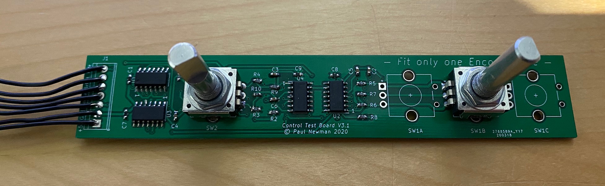

As I mentioned some time ago I was looking at the possibility of modifying the original design here to use rotary encoders to provide something more 'analogue' as a control interface. I very quickly came up with this circuit to debounce and detect the direction of rotation. This provides nice clean pulses for volume input up/down plus a mute on/off using the push button function of one of the decoders:
The schematic for that is attached below.

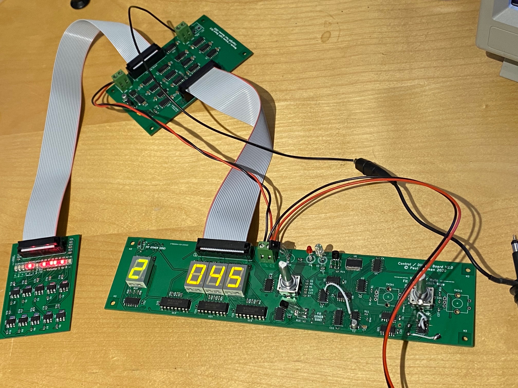

I've completed the design and build of the display board and main logic board together with a small test board that imitates the relays by indicating the status of the outputs and it's largely functional but I have a few issues I'm struggling with. This is what the boards look like:
The display board was always going to be a prototype hence the positions of certain components are sub-optimal. Also you'll note some hacking where I had to resolve some daft schematic errors that got translated into the PCB. The schematics are attached below for the two larger boards.
Essentially the system works but there are some issues:
  • Using the rotary encoders causes the volume / input to go up or down in steps of more than one.
  • When the volume level reaches 000 the display flickers as though it's cycling through several values. it also starts in this state.
  • Sometimes the volume display shows the correct values but segments of the display that should not be on flicker at somewhere around 12Hz
Those said when the system has an input and volume selected it's rock solid stable and will stay in that state indefinitely.
I've been on a steep curve with this as digital electronics is not really my thing and these are pretty much the first PCBs I've designed so I had to learn KiCad as well to get to this point. It's frustrating as it's a case of close but yet so far. I've run out of ideas to resolve these problems. It could be that my board layout is causing the issues but my digital skills are limited in that respect.
The one issue that is really bugging me is the first in the list. Using my scope I can see nice clean pulses coming from the circuit that debounces etc. the encoders those same clean pulses arrive at the logic board. Why a single pulse from this causes multiple steps is a mystery, it doesn't happen when using the remote.
In the meantime I've started work on a revised display board that has the positions of various components corrected to allow the board to be mounted to a front panel and also corrects my original errors. I've also started the relay board but I can't get either of these sent for production until I figure out the issues I've currently got. Any ideas gratefully received!
