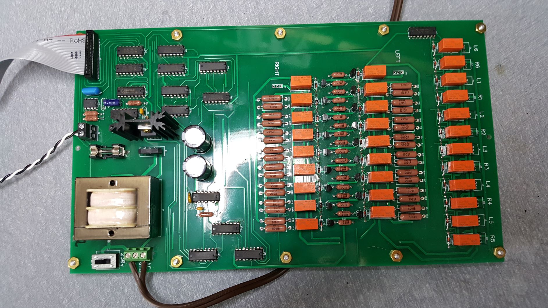

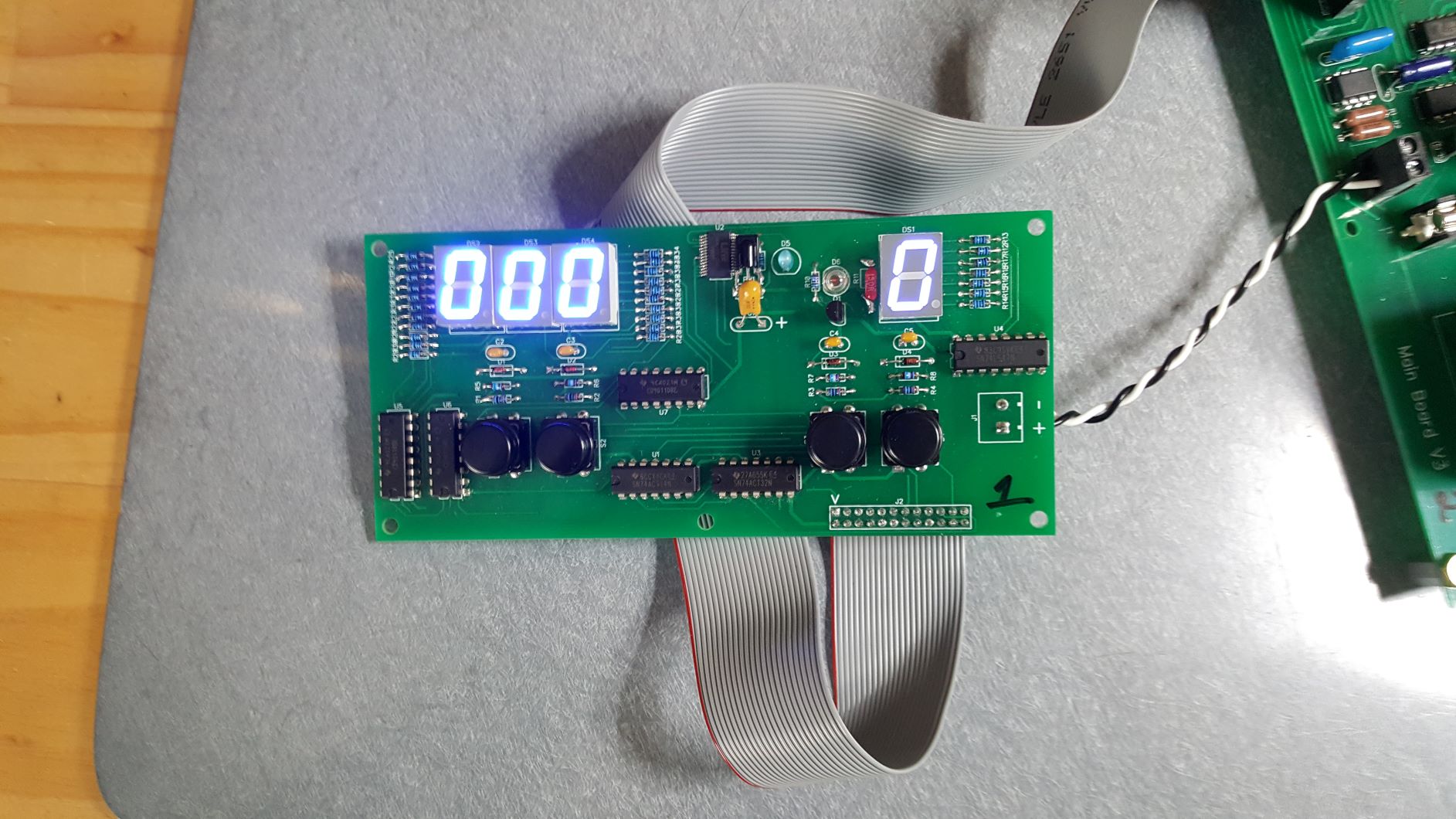

Here are pictures of the three boards installed and operating properly. Note that the main board is attached to the display board with a ribbon cable. The display boards power connector and ribbon cable header are both soldered to the back of the display board, which is designed to be attached to the front panel. The controls will not operate if the ribbon header in attached to the top of the display board. Also note the initial position of the display at startup. Volume is "000" and no input is selected "0". The red mute light that will turn on if the mute control is pressed. Also, the display board's blue LED will light when a remote control is pressed.
If the ribbon cable is correctly made there should not be any consistent relay clicks when the main board is powered up. I will still get a few clicks occasionally on power up, but they are fairly rare. When building the boards I would first test that the buttons on the display board are operating correctly before testing the remote. If the display board controls are working correctly but the remote control has problems it is most likely the surface mount chip on either the display board or the remote.

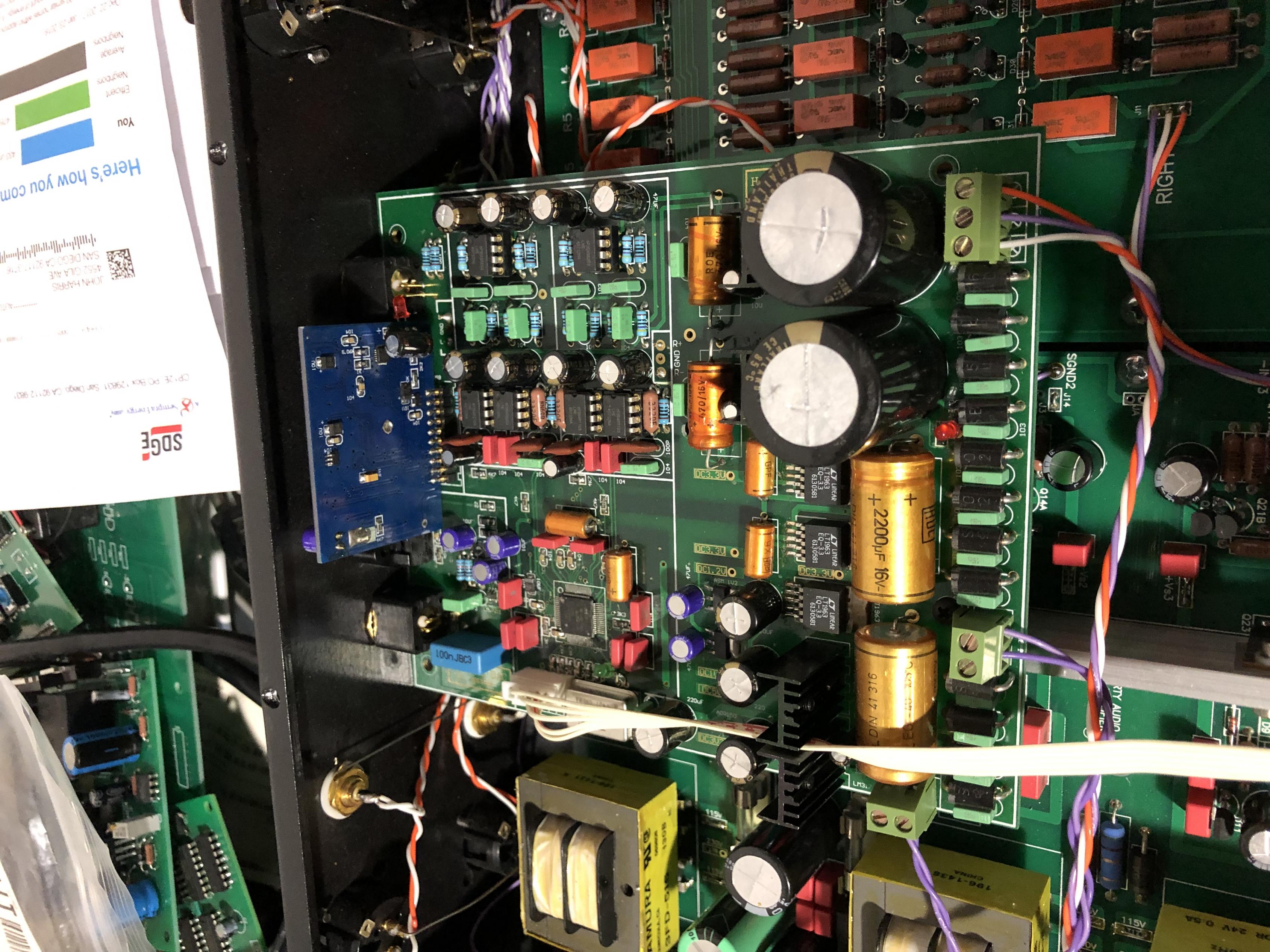

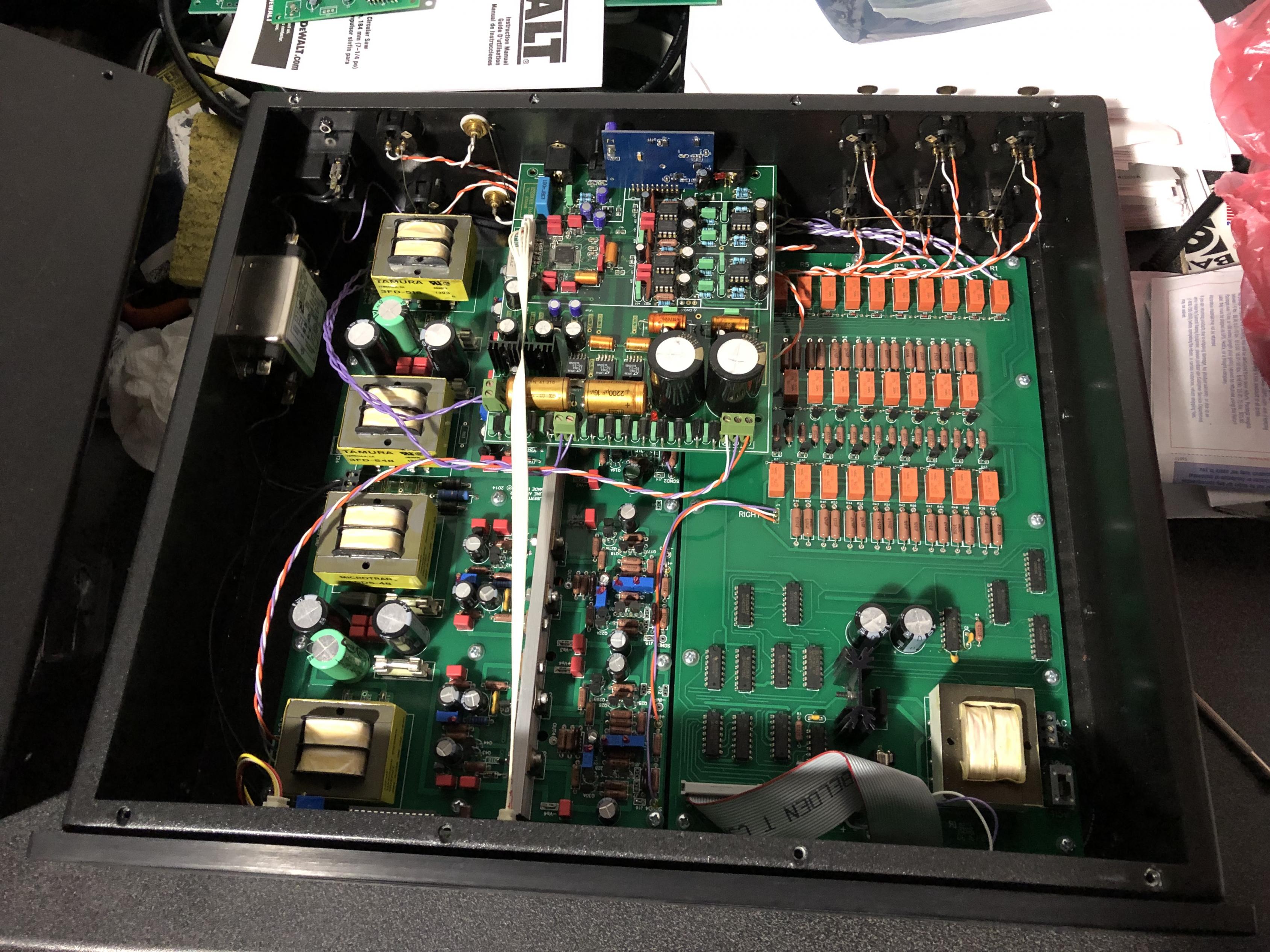

And adding pics of my preamp. Inside the preamp the board on the left is the gain stage line preamp, fully balanced, on the right is the control board, and the little board mounted to the upper back of the chassis is the DAC.

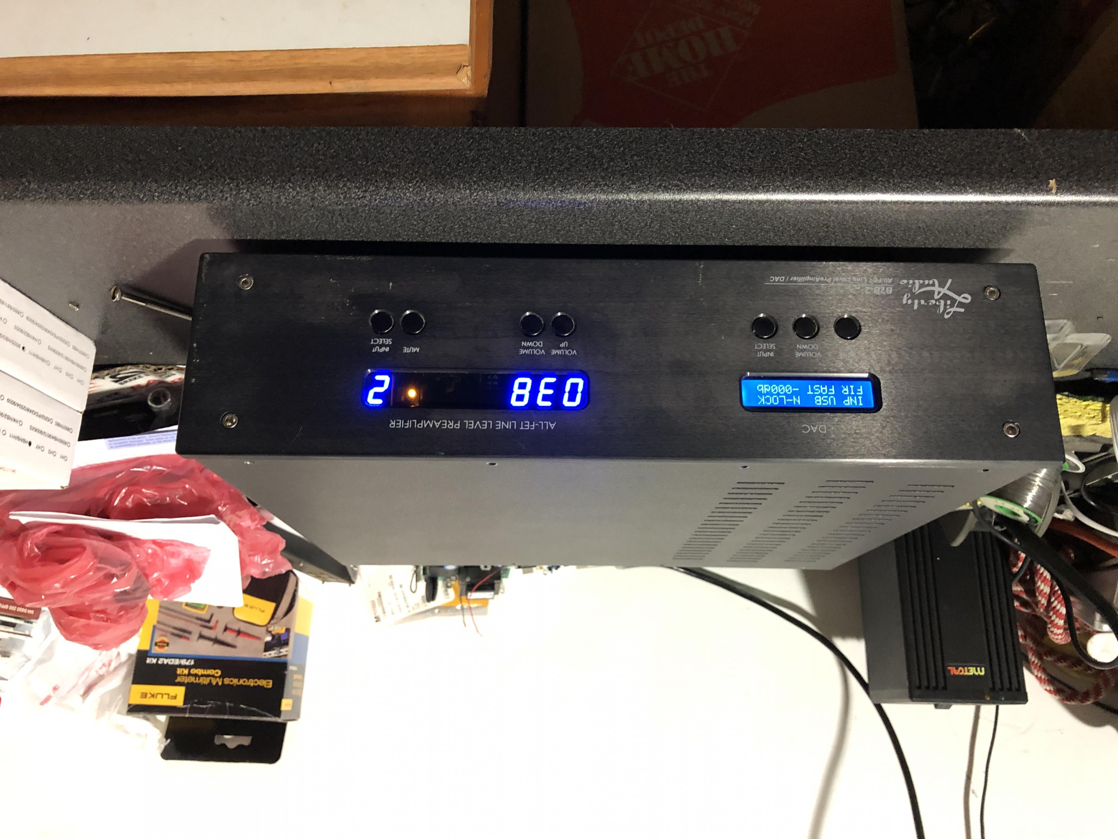

Looks at the very dusty faceplate you can see the preamp controls on the right and the DAC controls on the left.

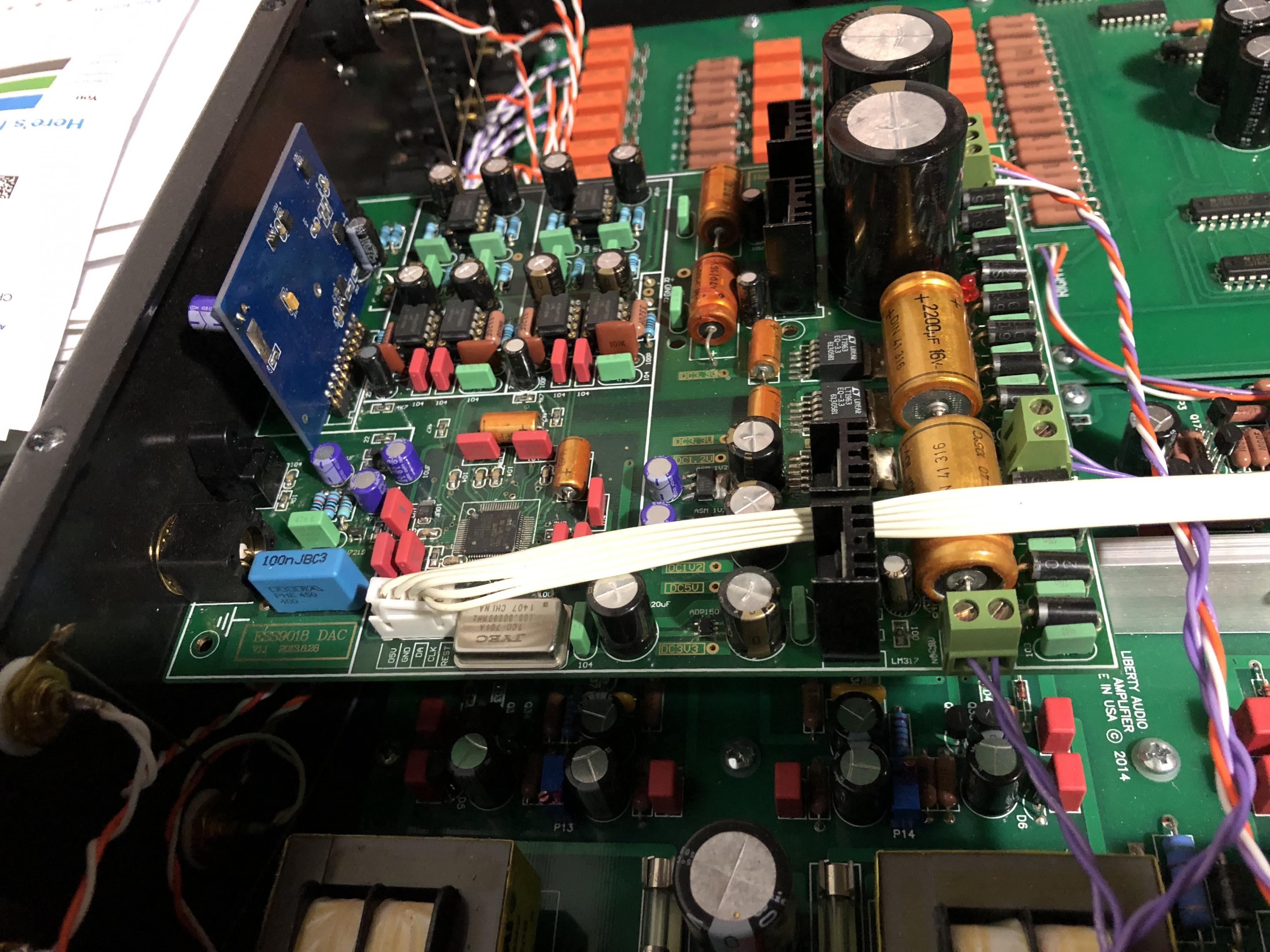

Hi John, what are the yellow cap in this pic?? Jensen??
Hi Hicoco,
If you are referring to the Gold caps on the small DAC board the only name I find on them is RUE. The DAC is a purchased board so I do not have a BOM for it.

Thanks John, when you have a change, no rush, could you take a close pic..thanksHi Hicoco,
