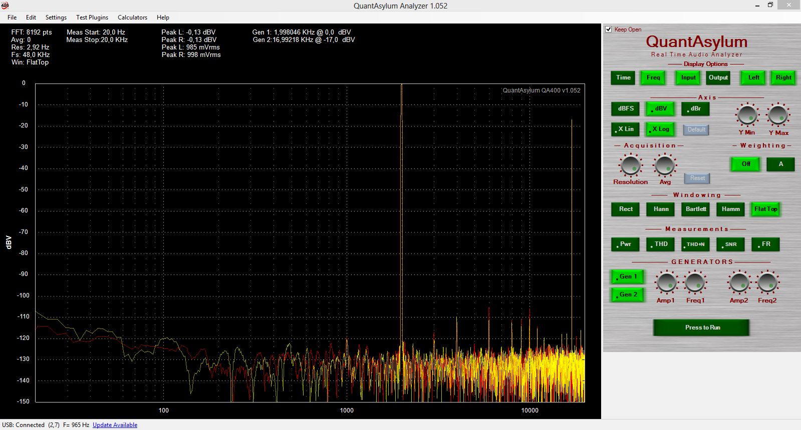

Here is the distortion measurement with 100 Ohm loading. Again under my maesurement threshold. Yellow is the buffer and red the loop back.
This could also be a great head phone driver.
I will now try to push it out of class A. Asuming that the buffer can push 100mA i have to use a resistor with less than 40 Ohm. I will use a really taxing 15 Ohm.

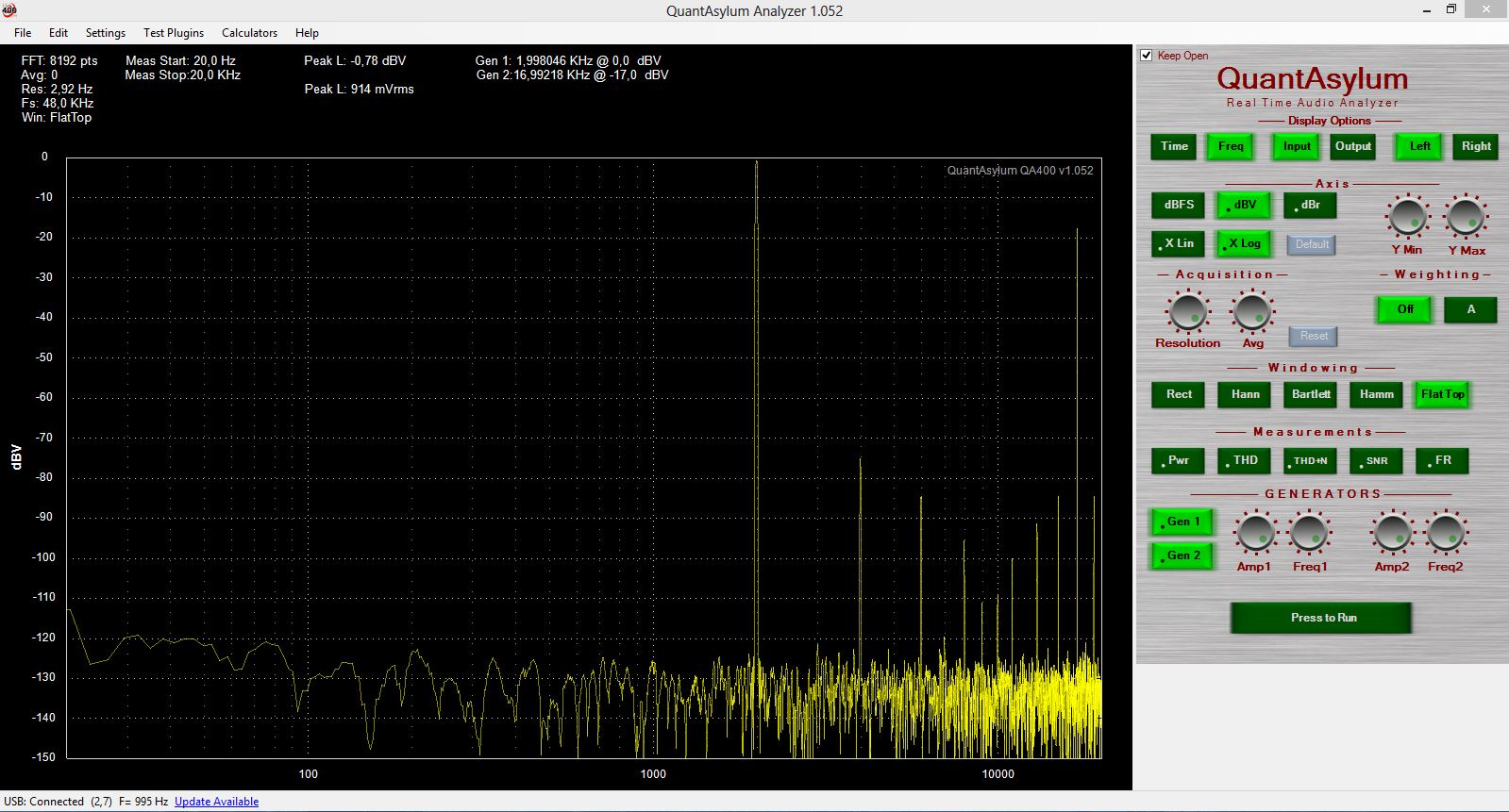

OK; now we are talking. The plot reveals the real nature of the beast.
Distortion is still low with second the highest at -75dB. There is a really nice progression of the higher harmoincs being lower and lower the higher the order. Intermodulation shows classical " children "
We are talking now 4V P-P into 15 Ohm that is nearly 0.3W.

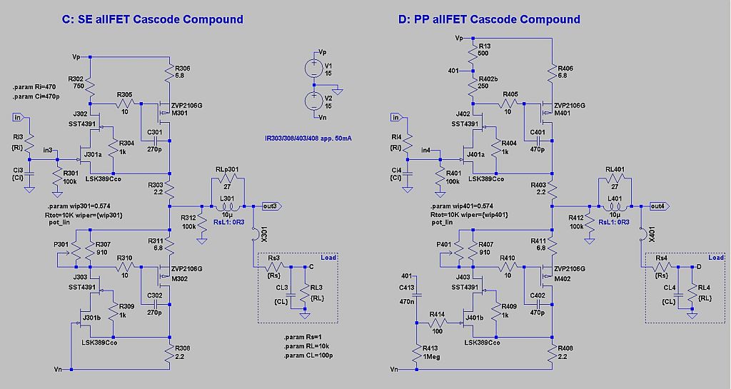

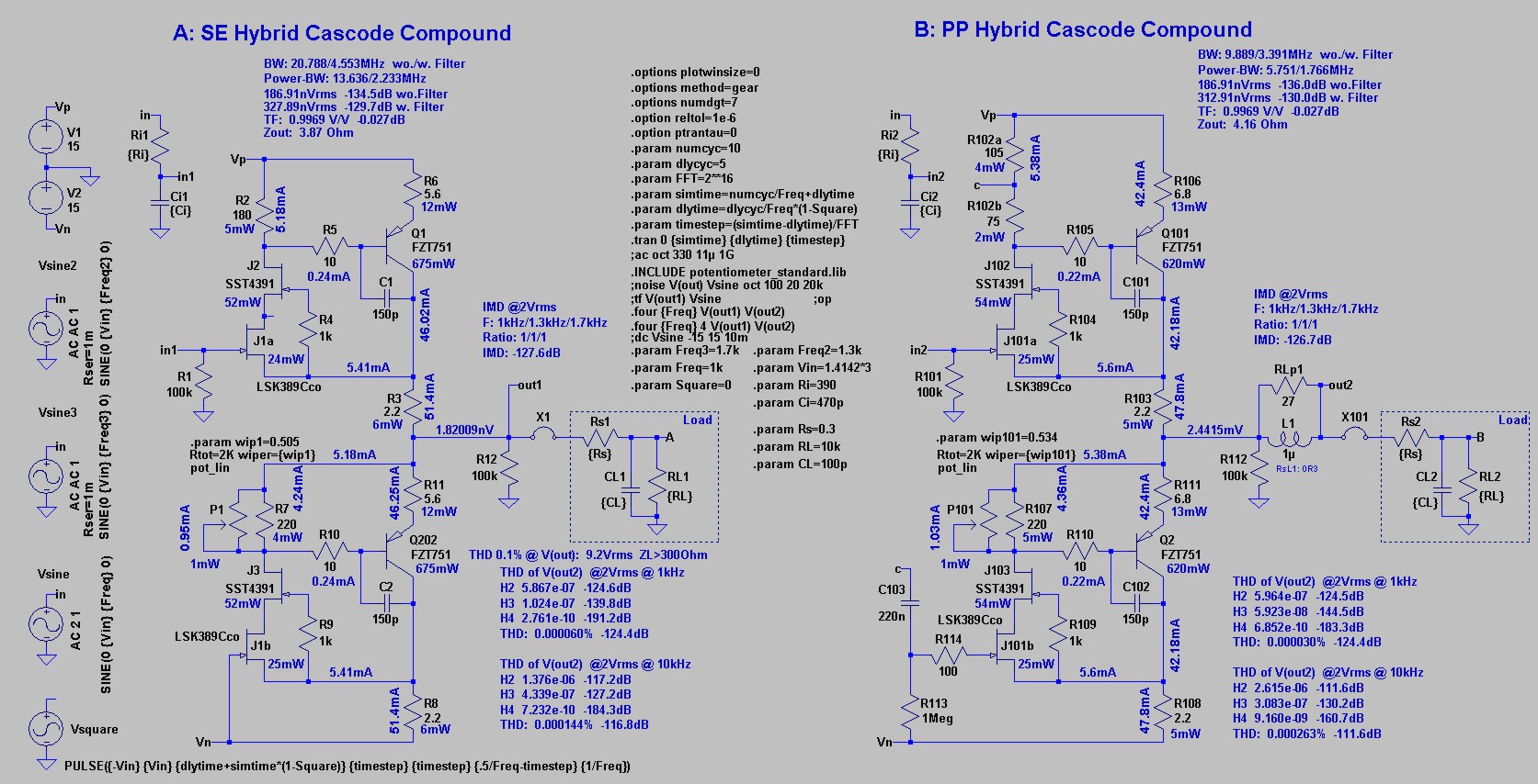

Andrew, here´s #52 again.
I only changed the 180R R102 into two resistors R102a (105R) and R102b (75R) to achieve symmetrical current swing in the upper and lower half of the circuit.
Joachim, of course may You use the Buffer. I just liked to keep the discussion about it here in its original thread. 😉
The modulated Buffer simmed also well into loads as low as 16R and 2Vrms with increased idle current and reduced emitter- and output resistors. The output transistors might need to be doubled to handle power dissipation though.

the ZVP3306A has a similar Vtreshold as the ZVP2106G after Fairchild DS.
It has lower capacitance and probabely higher Transconductance at the chosen current. So the overall values of the cascode Drain resistors (750R) should work fine. At least in the Sim there´s no significant change in Isource of the MOSFETs. But due to the different transconductance the combination of 500R + 250R will give too much modulation of the negative side. You may try with 120R + 630R instead (the 120R towards Vp!).
The output inductance may be smaller, around 2.2µH.

Joachim, are those figures measured at the bias current?
Unfortunately is the resolution in Fairchilds DS too low for the desired bias point.
But the higher transconductance of the 2106 comes to effect at higher drain currents. Around 50mA both the 2106 and the 3306 seem close, the 3306 maybe even higher.
In our case the only proof of the pudding would be to measure the signal current swings through the source resistors R406/411 or the 2.2R resistors R403/408 and to trim till symmetry is achieved.
Increasing R13/decreasing R402b accordingly increases the modulation and the current swing of the negative part. The opposite will increase the upper parts current swing.
A hint may also to trim V(out) to THD-minimum at the treshold of class-A to class-AB. The closer to symmetry the currents are, the higher the treshold to class-AB will be.
