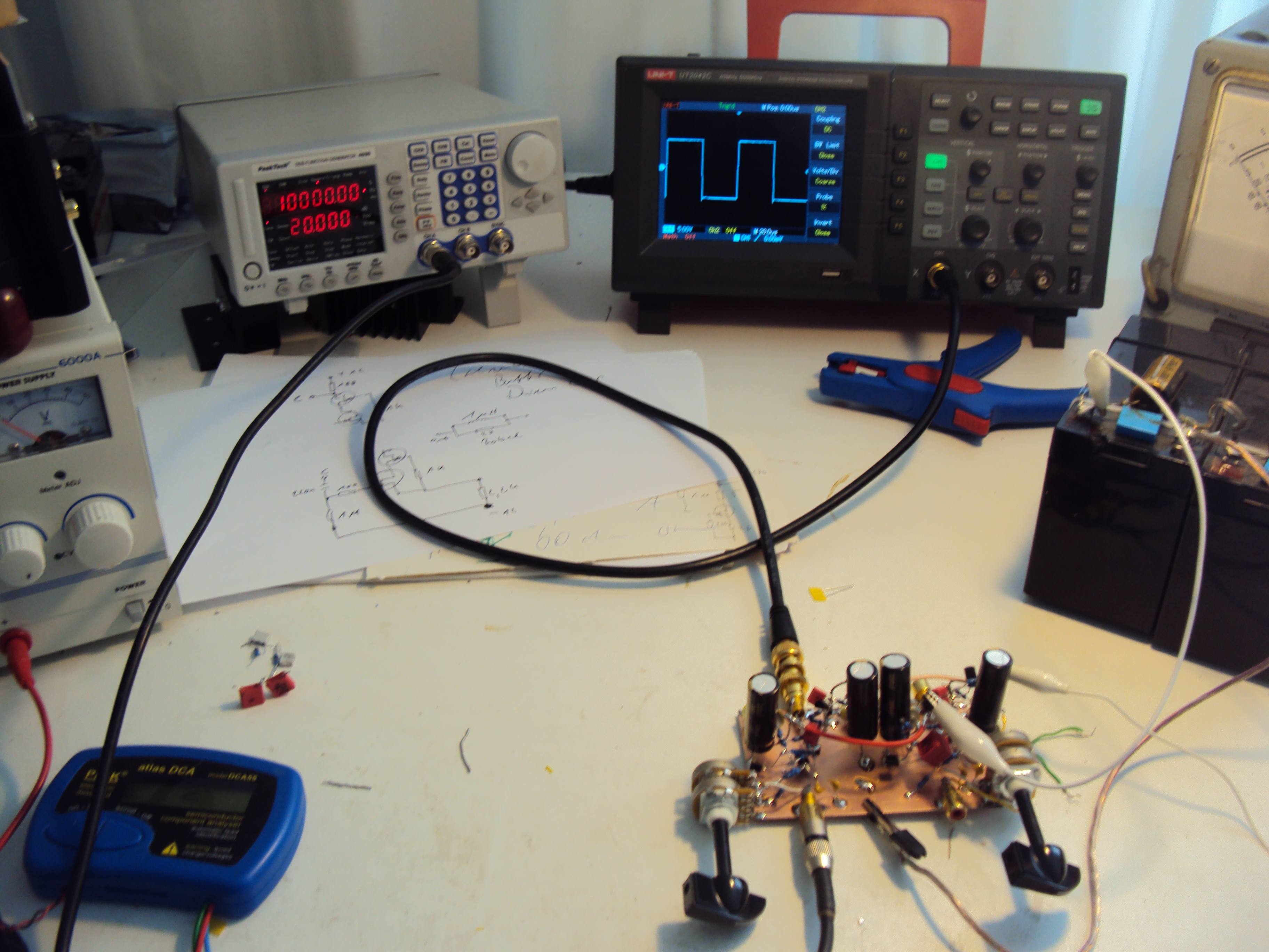

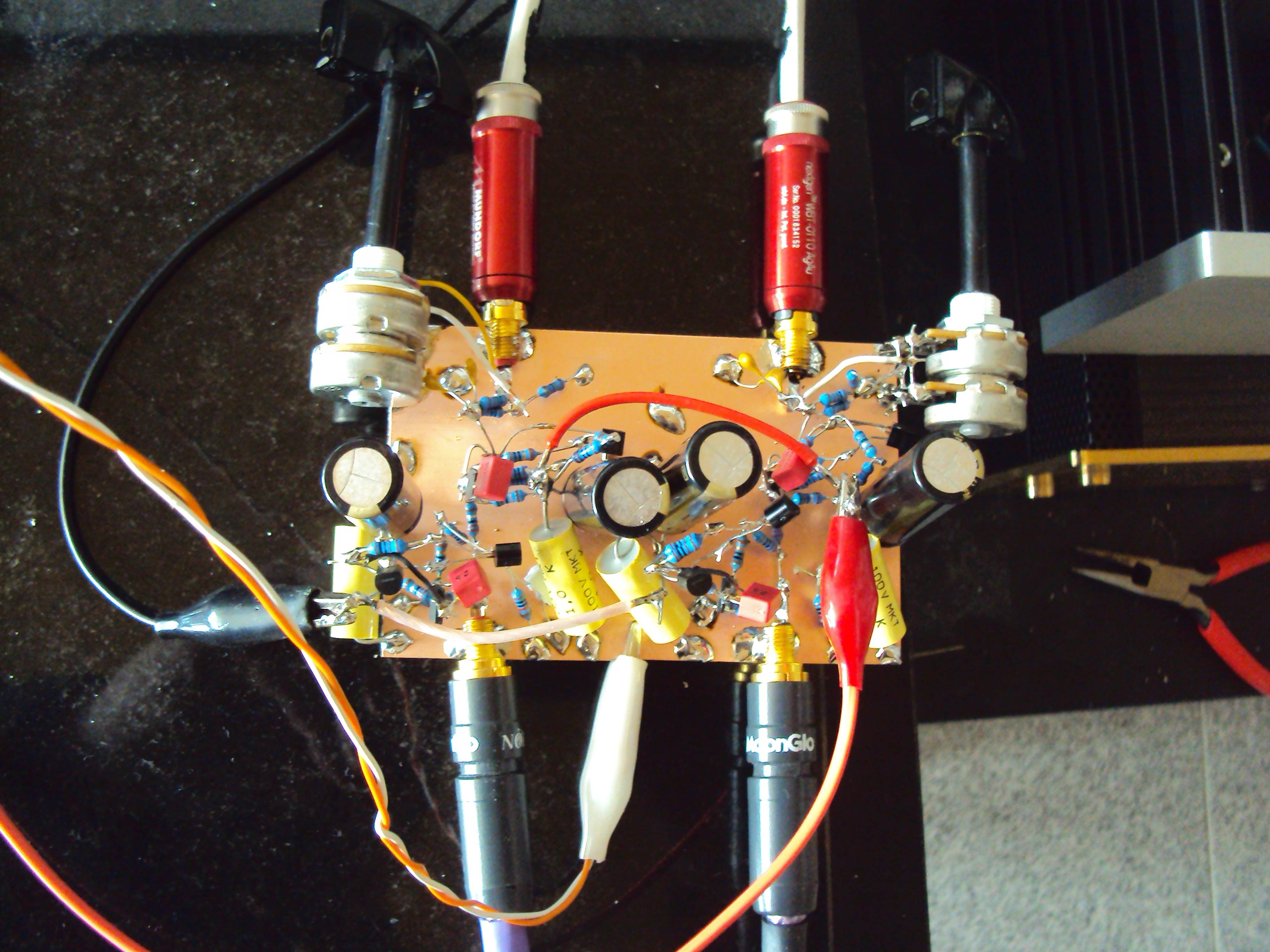

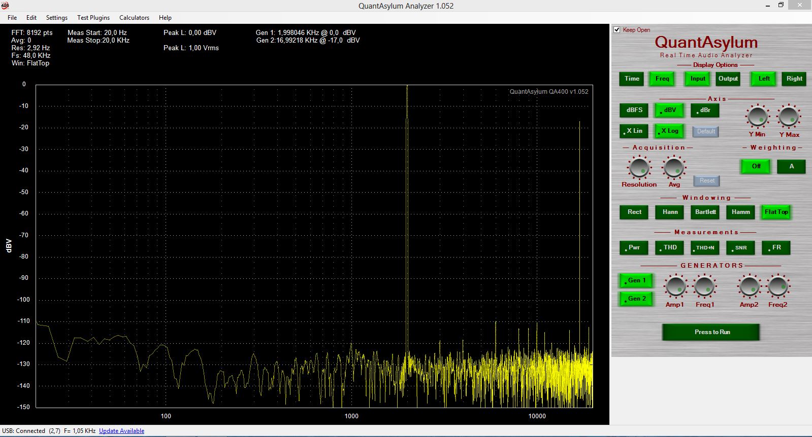

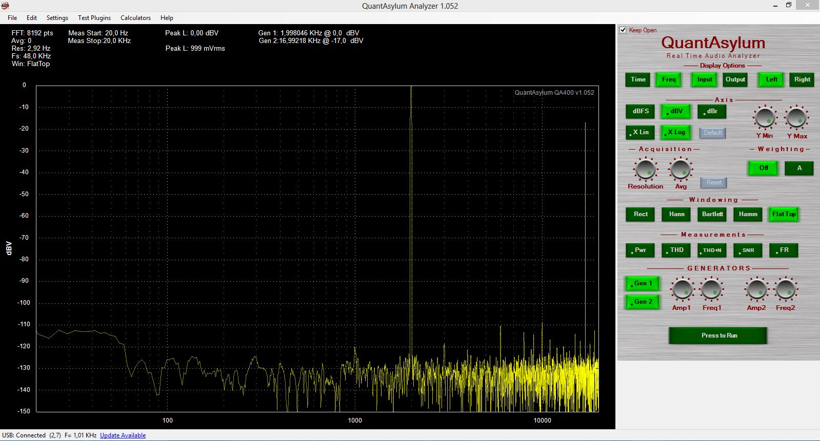

I build the modulated CCS version and it worked right away.
Distortion is even lower then the non driven version. I am a bit at a loss to explain why this distortion readings are even lower then the loop back.
Did you audition the circuit?

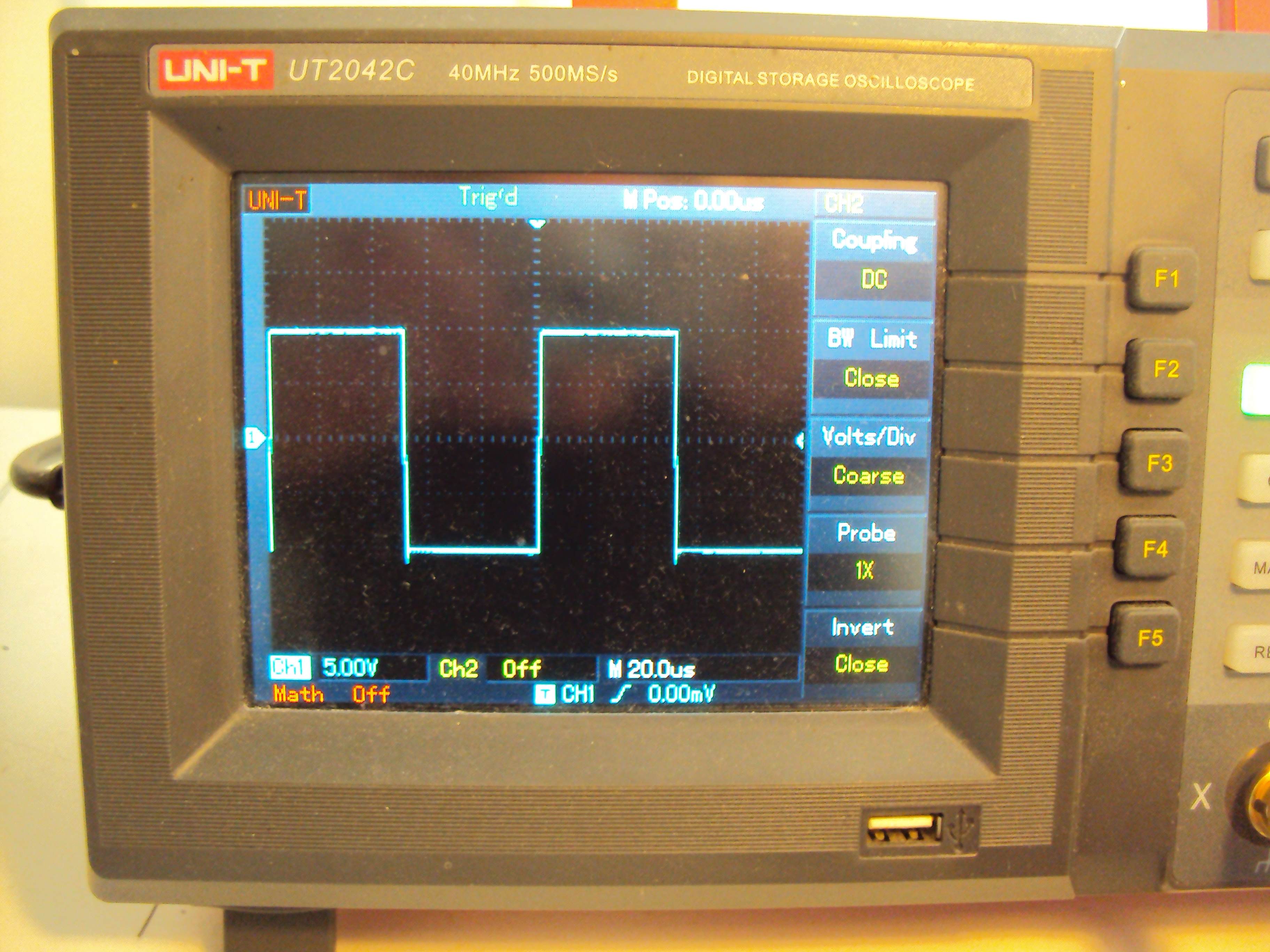

Here are pictures of my build and a 20V P-P 10.000kHz square.
Here is the prognoses undershot. It only appears with more then 16V P-P though.
Later i will try the zobel.
I have the driven CCS buffer with split resistors in the system.
