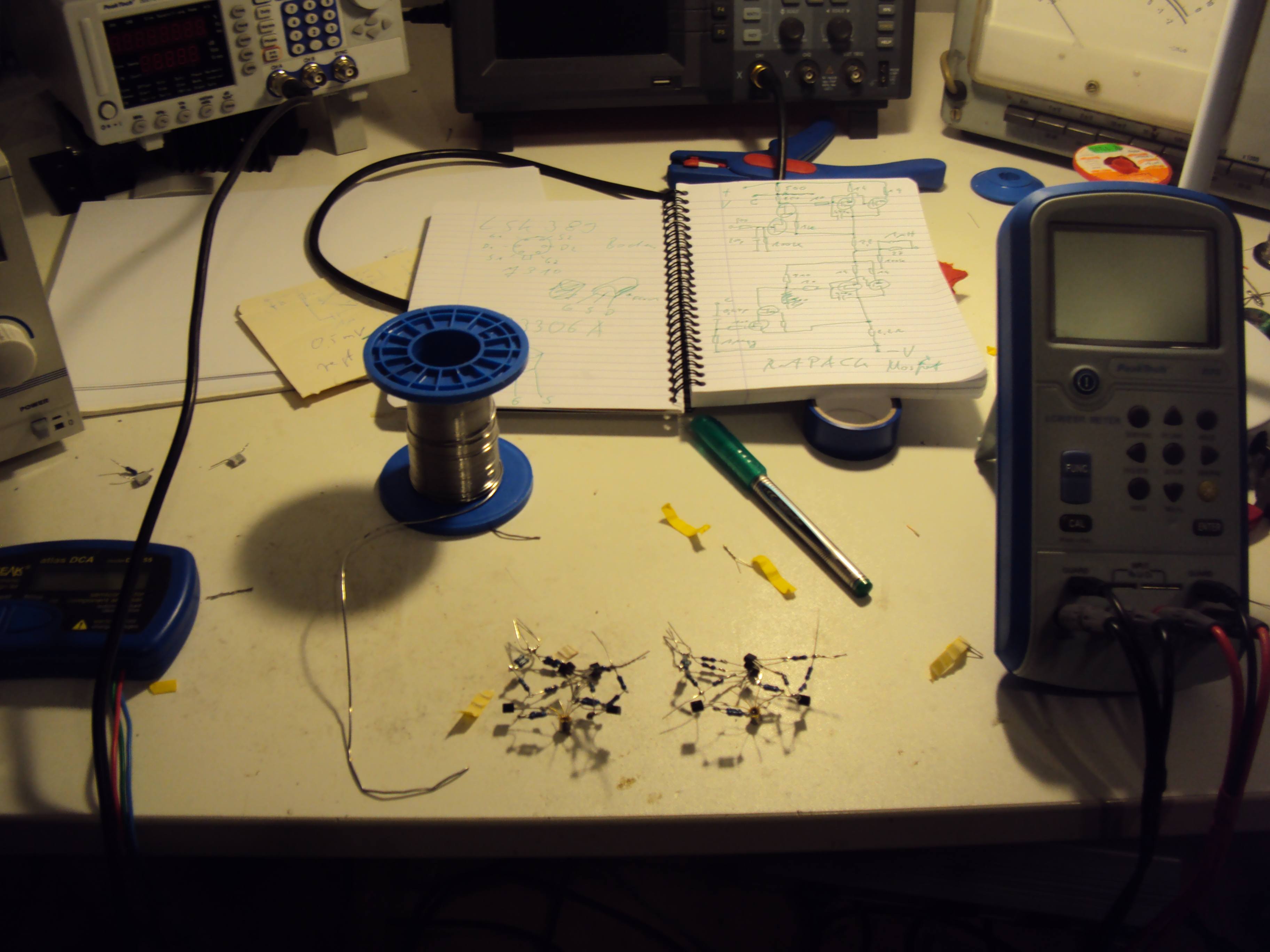

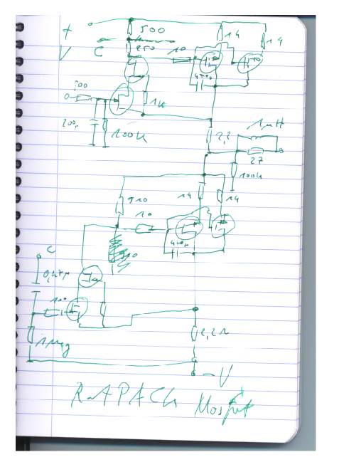

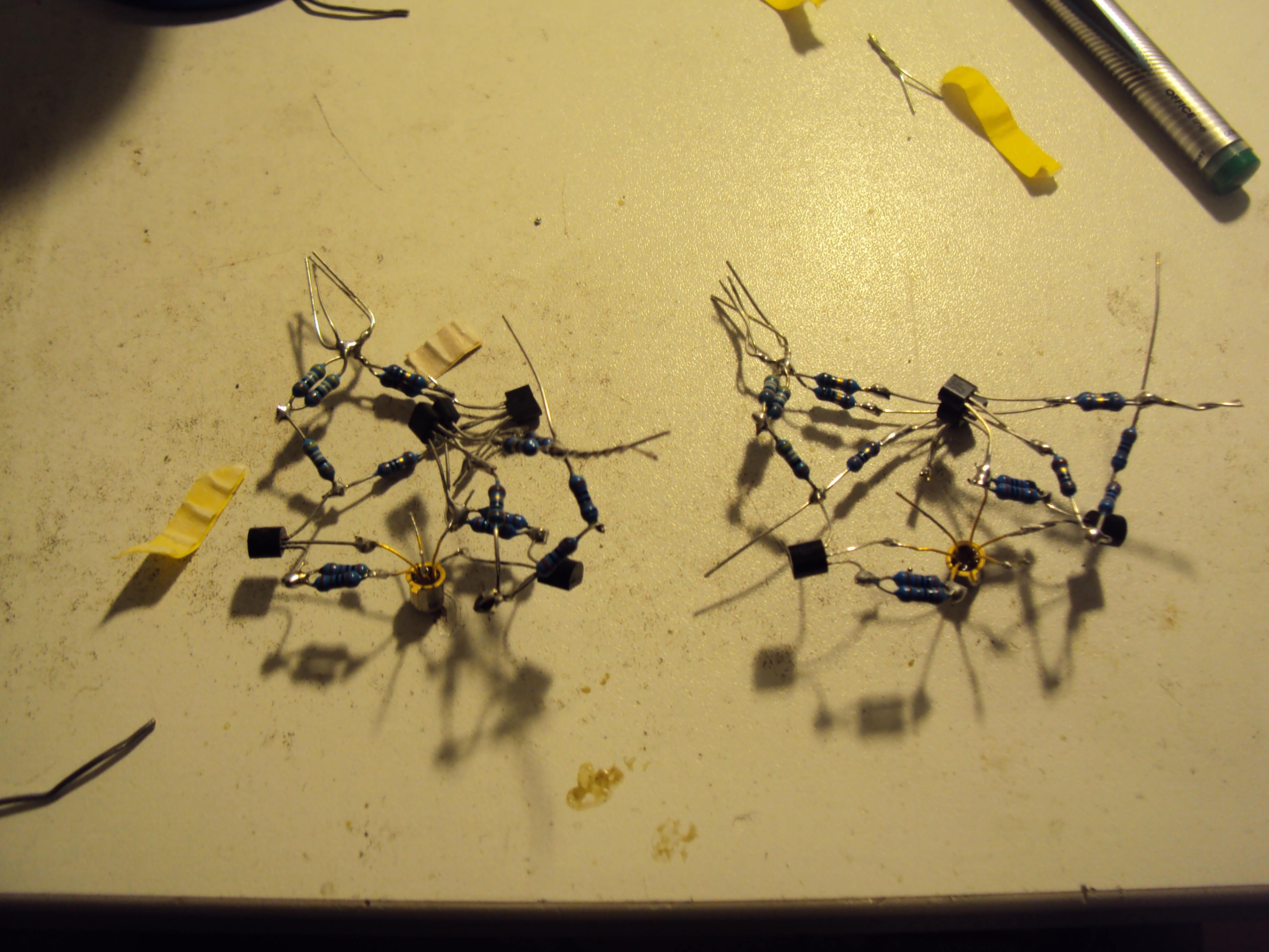

I have build one channel of the MosFet buffer but it does not work. The MosFets get extremely hot. Maybe the biasing resistors are too big in size.
Have you simulated distortion , say 10K source impedance (like when tou have pot on the input)?
I can do that, the buffer has pots on the input. The worst case is then with the pots in the middle position and with a 10kOhm pot that is less then 10kOhm. I could of cause simply use a resistor.
I have measured the buffer though with 15 Ohm loading and that is a real torture test.
I have now reduced the bias resistors to 2/3rd and still the MosFets get extremely warm.
Maybe i need separate gate stoppers or another compensation scheme.
I already like the bipolar version better it is easier to stabilize.
I will post a picture of my build and the current circuit diagram. Maybe somebody has an idea.

Joachim, the resistor values in the upper and lower cascode should be identical.
If there are just 910R (wo. the paralleled poti) the lower parts MOSFET will open up too much. The resistor value could be 750R maybe less.

At the moment i am working with 166 Ohm, 330 Ohm on top and 580 Ohm on down.
I measure much to high and different idle. Yes the down side draws much more.
I post the schema in a minute.
