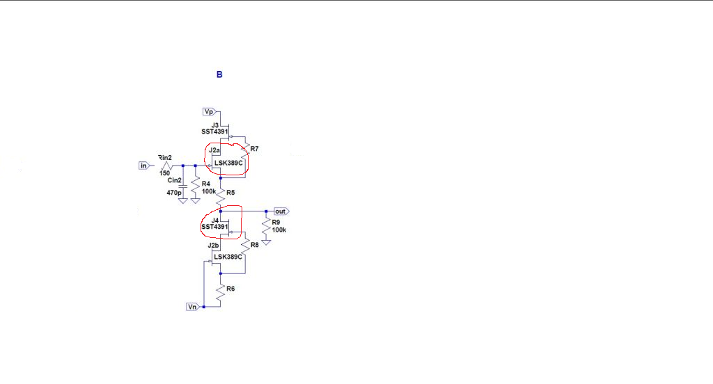

Are these red marked the lower devices?
No
Do you know what a jFET wired as a CCS looks like?
Do you know what a cascode added to a jFET looks like?
Before you delve into these projects you need to have some background understanding.
Read Borbely, then formulate your questions.
as I posted earlier
The cascodes are shown in post397
j2/j1a are a cascode pair as are j3/j1b & j102/j101a & j103/j101b
Which part of that don't you understand. ASK !
J2 has the full voltage applied to it. It is the cascode device.
Do you understand that?

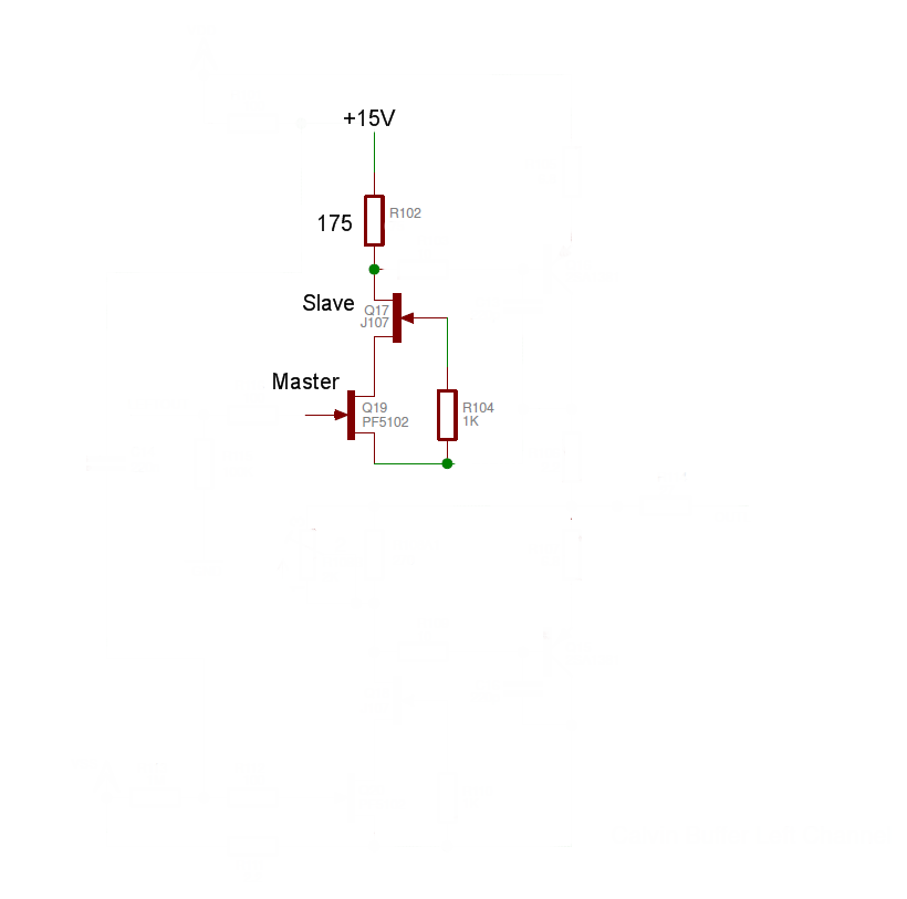

I'm using the simple circuit Andrew suggested below.
Are you saying it's better to match the Master devices by measuring the voltage drop across the 175 ohm resistor for Id, or can I just measure their Vds(using the same Slave device) and match them like Andrew suggested?
proceed as Andrew suggested.
Then You will have two matched Masters and two matched Slaves.
Measuring the voltage drop over over their common drain resistor (175R) is then just a final control.
If You only match the Master-Slave pairs for same voltage drop over the 175R, then the following could happen:
- say, the Masters differ in Idss and the Slaves differ in Vgs
- a combination of the first Master having a slightly higher Idss with a first Slave having slightly less Vgs, and the second Master with lower Idss beeing cascoded with a second Slave with more Vgs (mean value, neglecting the minus sign in Vgs).
- both combinations may lead to equal Id values through and equal voltage drops across their drain resistors, but may be slightly misatched 'internally'.
Varying the source resistor of the Master has a much greater effect on the Id than varying its drain-source voltage (which is at the same the Slave's gate-source voltage).
So, if one measures equal voltage drops over the common 175R drain resistors this would mean a sufficient close Id matching of the Masters and Vgs matching of the Slaves for this Application.
If your application requires more precision You need to match Masters and Slaves separately.
This could be the case if You want to optimize THD and/or temperature behaviour.
