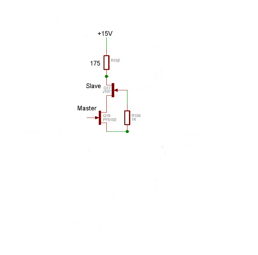

So using the circuit below that Andrew suggested isn't any good for matching the "master" JFETs?
Then will it work for matching the "slave" devices by measuring their Vgs while using one of a matched pair(by Idss using some other method) of "master" devices?
The circuit you posted is a partial circuit. Where is the -15V?
I cannot relate to a partial circuit.
Should you build the entire buffer circuit and have there a socket so that you'll be able to swap one of the slave JFETs, you'll be able to measure the Vgs of the JFET and match slaves for Vgs.

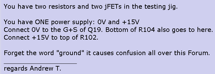

Joshua, if you'll look back at posts #314 and #315, Andrew doesn't say anything about needing -15V to measure the Vgs of the "slave" FETs.
In fact, I'll save you the trouble of going back by posting what he stated in the attachment below.
Personally...I've found the method of measuring Idss, by measuring the voltage drop across a 100 ohm resistor in series with the drain(like in the Forssell jig you posted), gives somewhat inconsistent and varying voltage readings...especially with higher Idss FETs where the FET heats up quickly.
Perhaps if you're "quick on the draw" as to reading the voltage before the FET heats up too much, you'll get a pretty good estimate of Idss.
Perhaps Andrew or Calvin can chime in because at this point since I don't really know what to do as far as "matching" these transistors.🙁

I can only repeat myself: either make the matching with a jig like the one I posted, or in the actual circuit, with the correct resistors values and voltages.
BTW, in my post #471 there was an error on my part.
When matching the slaves Vgs, the source resistor of the JFET in position 2 of the rotary switch should be higher than 2.2 Ohm, since in the actual buffer the BJTs current also pass through it.
Taking the current values in Calvin's simulation, in one circuit option there is 51.4mA flowing through the 2.2 source resistors, which is a voltage drop of 113.08mV. Since in that simulation through the JFETs flow 4.41mA, to get the same Id in the jig, the source resistor has to be about 25 Ohm (actually about 25.6 Ohm, which is probably nonexistent).
Since in my buffer the master JFETs' Idss may be different than in Calvin's simulation, I'd rather match the slave JFETs for Vgs in the actual circuit, temporarily placing a socket in place of the slave JFETs.
The -ve voltage is needed for the Vp measurement, not for the Idss measurement.
If post473 sch is used as a testing jig for checking Id of the master inside the cascoding voltage of the Slave, then it works. But there is a condition.
select all your near identical Idss high gm devices into batches.
Swap between these pre-selected devices and when you find any that have the same current Id and thus the same Vds, you know that they have changed by the same amount from the Idss test. That confirms they have the same gm (slope).
Matching requires Idss and gm to be the same. It's the starting point at the Y axis and the slope from that starting point that gets one to the operating point. At the operating point we expect the Id and the Vgs and the slope all to be "matched".
