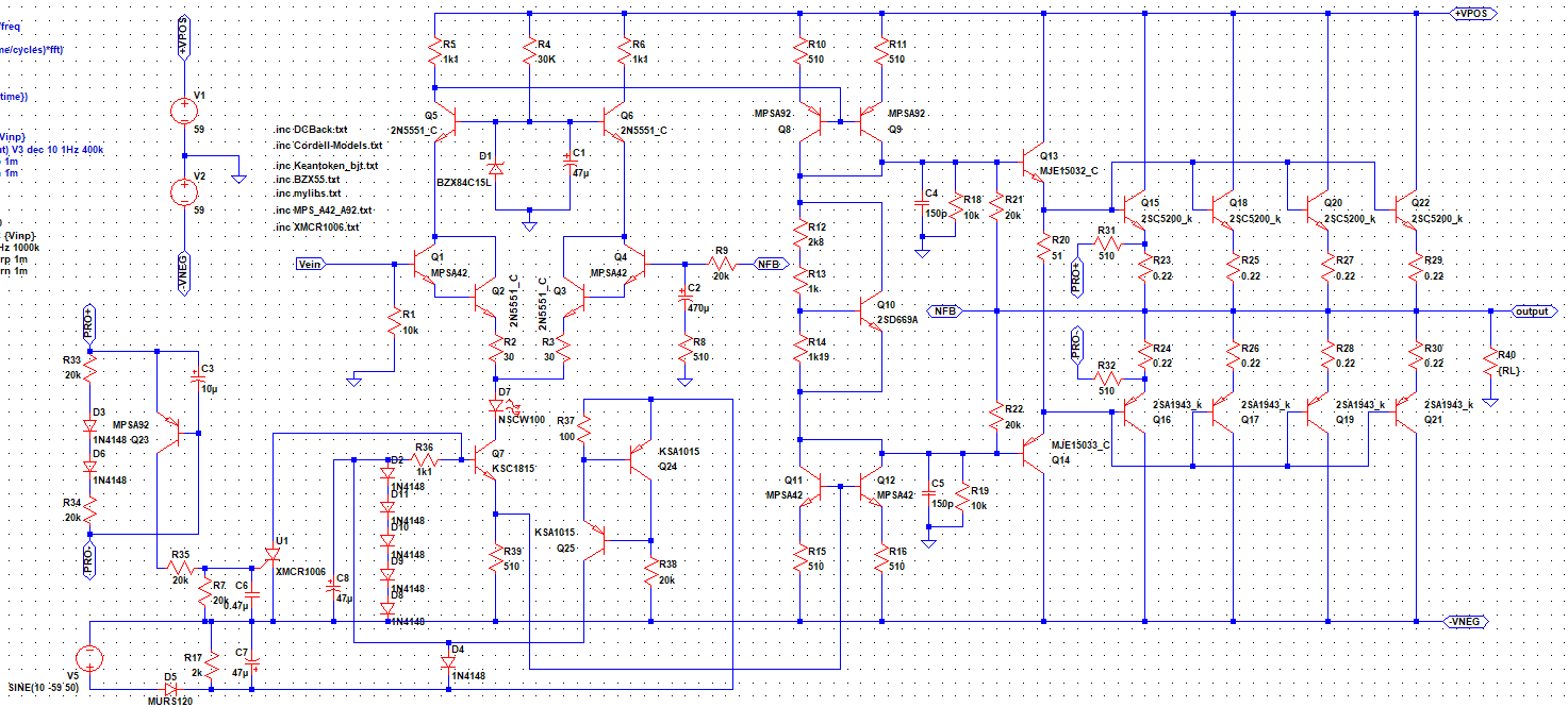

Diagram of this pr-800Here's the picture.

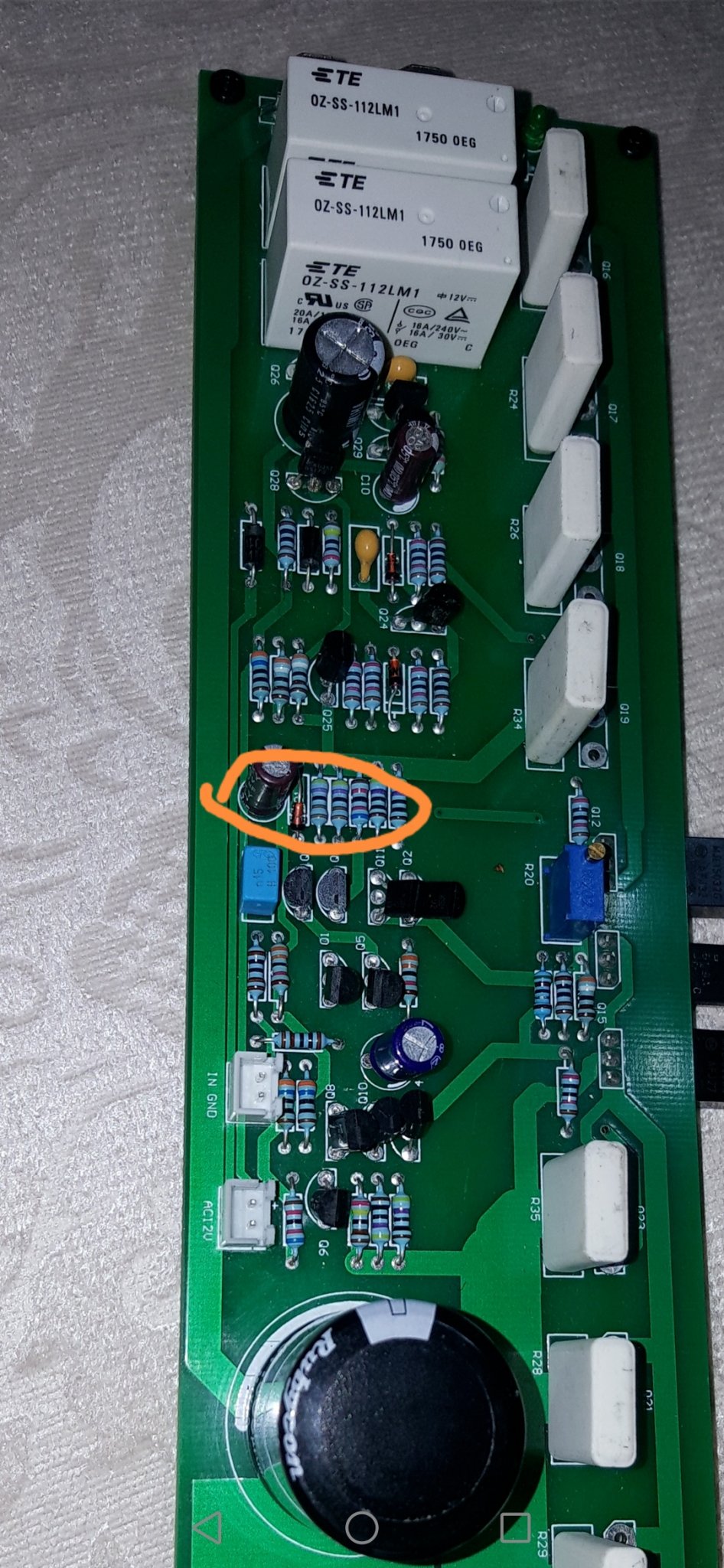

The diode I markedZenner'ın 15v olduğundan oldukça eminim - sadece bu başlıkta yayınlanan devrelerden birindeki parça numarasına gidiyor.

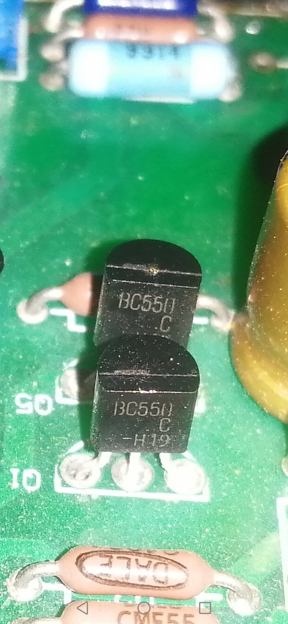

Green pcb circuit used at the input bc550cI'm fairly sure that the Zenner is 15v - just going on the part number in one of the circuits posted in this thread.
Q1 Q5 bc550c

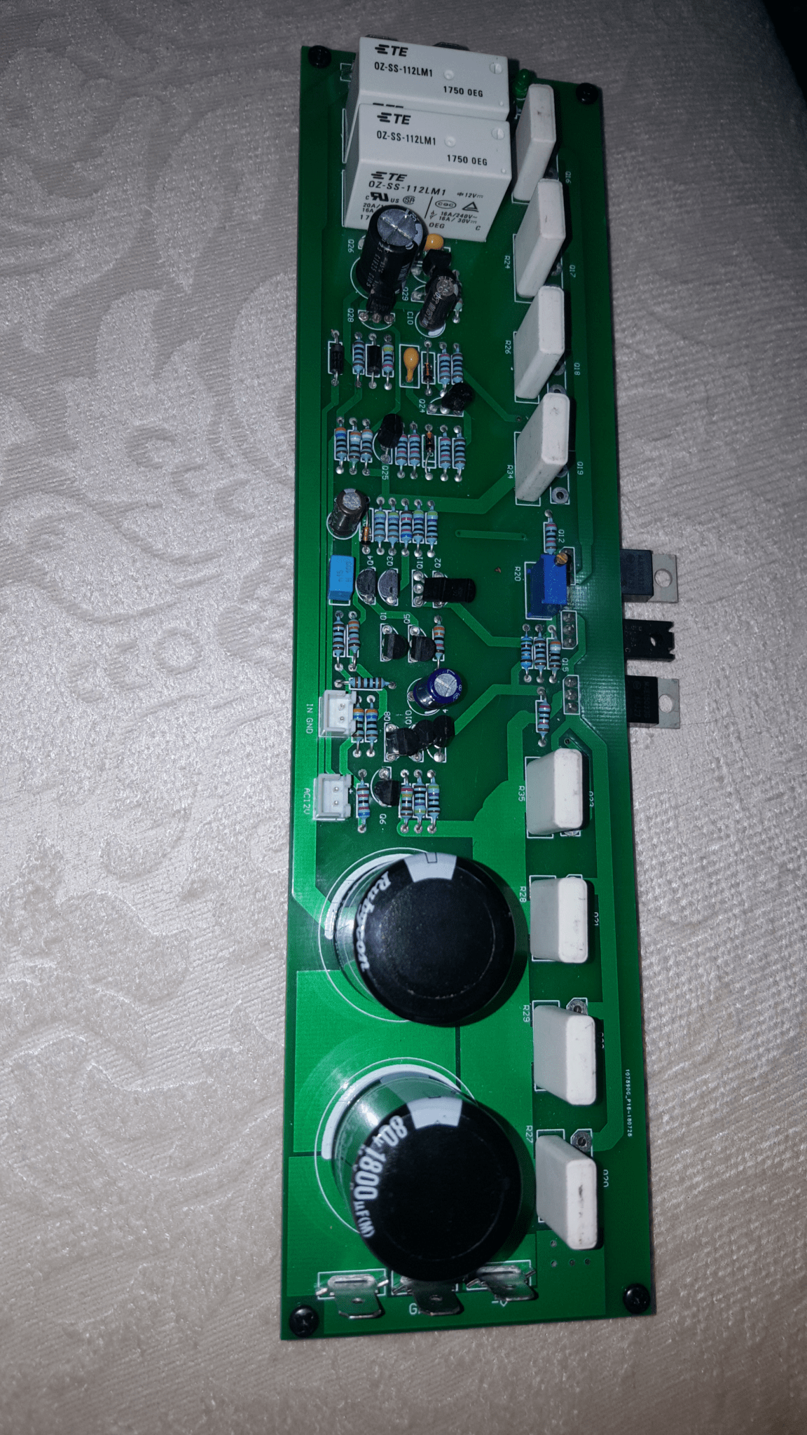

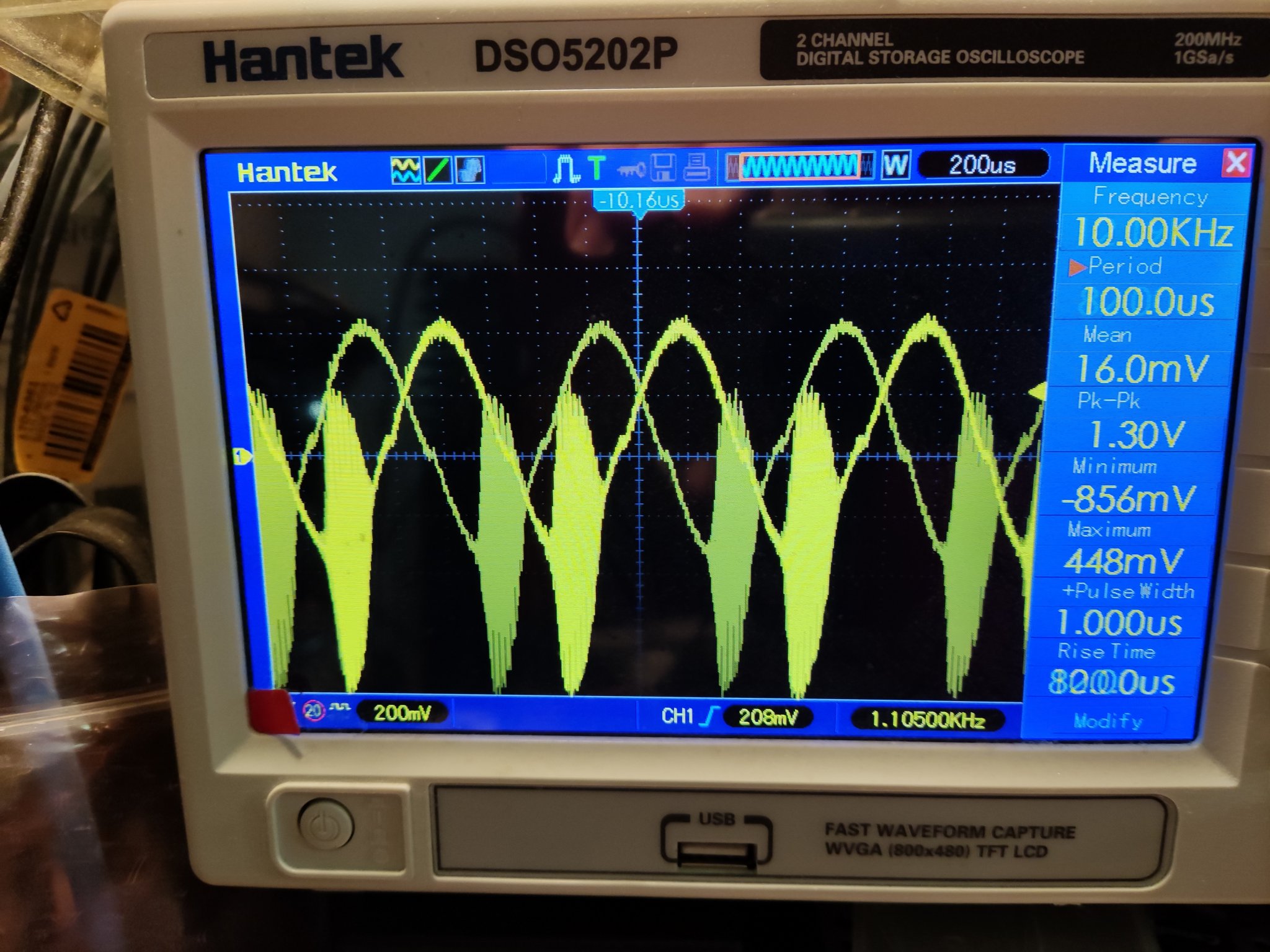

Self ocillations on a Chinese PR-800 kit,
I mounted power transistors MJL21193G and MJL21196G from Farnell. The driver transistors are MJE15033G and MJE15032G of Chinese origin, those that came with the kit.
For the start-up tests I use a symmetrical 2 x 32V lab power supply limited in current to avoid any problems. Self ocillations occurs by increasing the input signal and also occurs earlier if the supply voltage is lowered to 2 x 20V for example.
I do not have the diagram of this kit of course but an earlier version exists the difference is the protection of the loudspeakers which is different on the first versions. On the one I have, the protection is limited to DC output protection.
Knowing that in the end this amplifier will be powered by a symmetrical voltage of 2 x 80V.
Which way do I have to look to remove this Self ocillations ?
Thanks for your help.

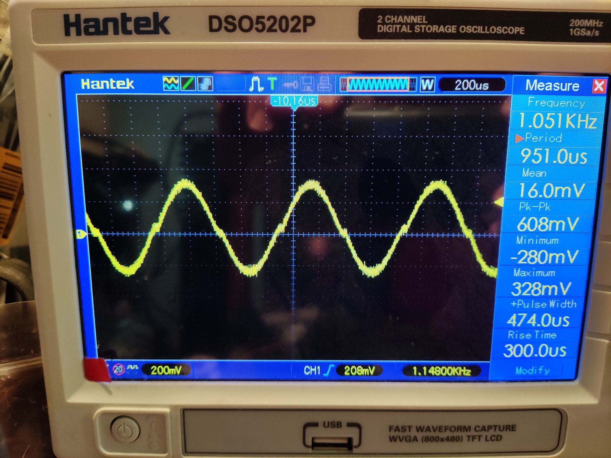

Total noob here. I am assuming the oscilloscope is the output, For one, it looks like crossover distortion. I would check Q10 for orientation. And measure across R20 with the input shorted and maybe load the output a little with a small-ish resistor, like 100ohms. Assuming its not oscillating, I would guess V at R20 >1.4V
EDIT: What is the second graph?
Yes it is indeed the output on the oscillograms the amp is loaded with a resistor of 8 Ohms for the tests. There is no ocillations without a signal at the input.Total noob here. I am assuming the oscilloscope is the output, For one, it looks like crossover distortion. I would check Q10 for orientation. And measure across R20 with the input shorted and maybe load the output a little with a small-ish resistor, like 100ohms. Assuming its not oscillating, I would guess V at R20 >1.4V
Well, the low side (PNP) gain is asymmetrical. And the distortion occurs at ~ -0.6V peak. I would still bet a few small value coins that its at the driver or output, and its not really oscillation, it is a semiconductor dud or connected the wrong way round. Maybe kill the protection by lifting R31 R32 first?Yes it is indeed the output on the oscillograms the amp is loaded with a resistor of 8 Ohms for the tests. There is no ocillations without a signal at the input.
The second graph is when the input level rise.Total noob here. I am assuming the oscilloscope is the output, For one, it looks like crossover distortion. I would check Q10 for orientation. And measure across R20 with the input shorted and maybe load the output a little with a small-ish resistor, like 100ohms. Assuming its not oscillating, I would guess V at R20 >1.4V

this schematic has nothing to do with the green pcb circuitSelf ocillations on a Chinese PR-800 kit,

The amplifier part is the same only the protection part is different on that of the green printed circuit! On the green circuit only DC output voltage protection is implemented! It does not advance me in my troubleshooting thank you!this schematic has nothing to do with the green pcb circuit

r31 r32 resistor is not used on green pcb boardWell, the low side (PNP) gain is asymmetrical. And the distortion occurs at ~ -0.6V peak. I would still bet a few small value coins that its at the driver or output, and its not really oscillation, it is a semiconductor dud or connected the wrong way round. Maybe kill the protection by lifting R31 R32 first?

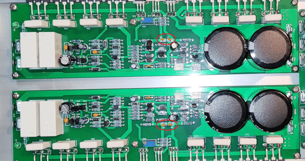

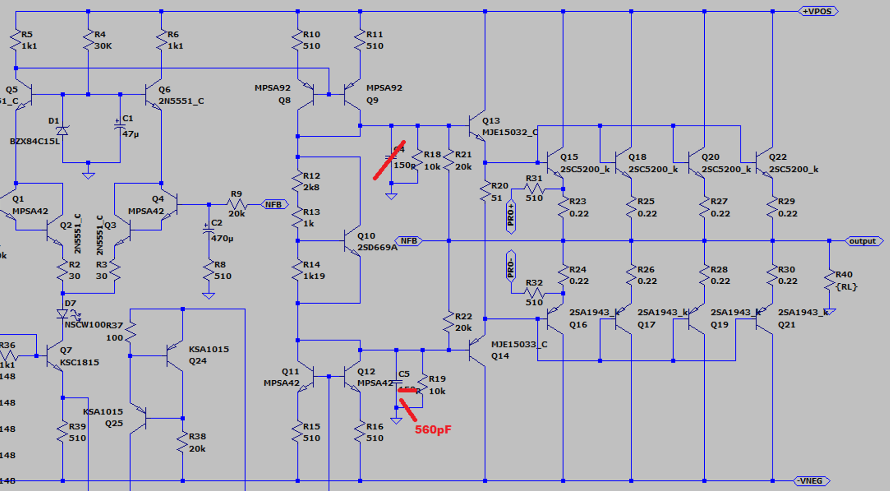

OK you were right, I think it's the drivers transistors that have crappy parameters! So surely fakes because when I remove the 150pF on the base of the MJE15032 and I put a 560pF on the base of the MJE15033 the oscillation disappears even when I increase the input level!Well, the low side (PNP) gain is asymmetrical. And the distortion occurs at ~ -0.6V peak. I would still bet a few small value coins that its at the driver or output, and its not really oscillation, it is a semiconductor dud or connected the wrong way round. Maybe kill the protection by lifting R31 R32 first?
Do you think it is preferable to change the drivers for safe sources or can have to be satisfied with this device with these capacities?
where are the 150pf?The amplifier part is the same only the protection part is different on that of the green printed circuit! On the green circuit only DC output voltage protection is implemented! It does not advance me in my troubleshooting thank you!
here in red circles
