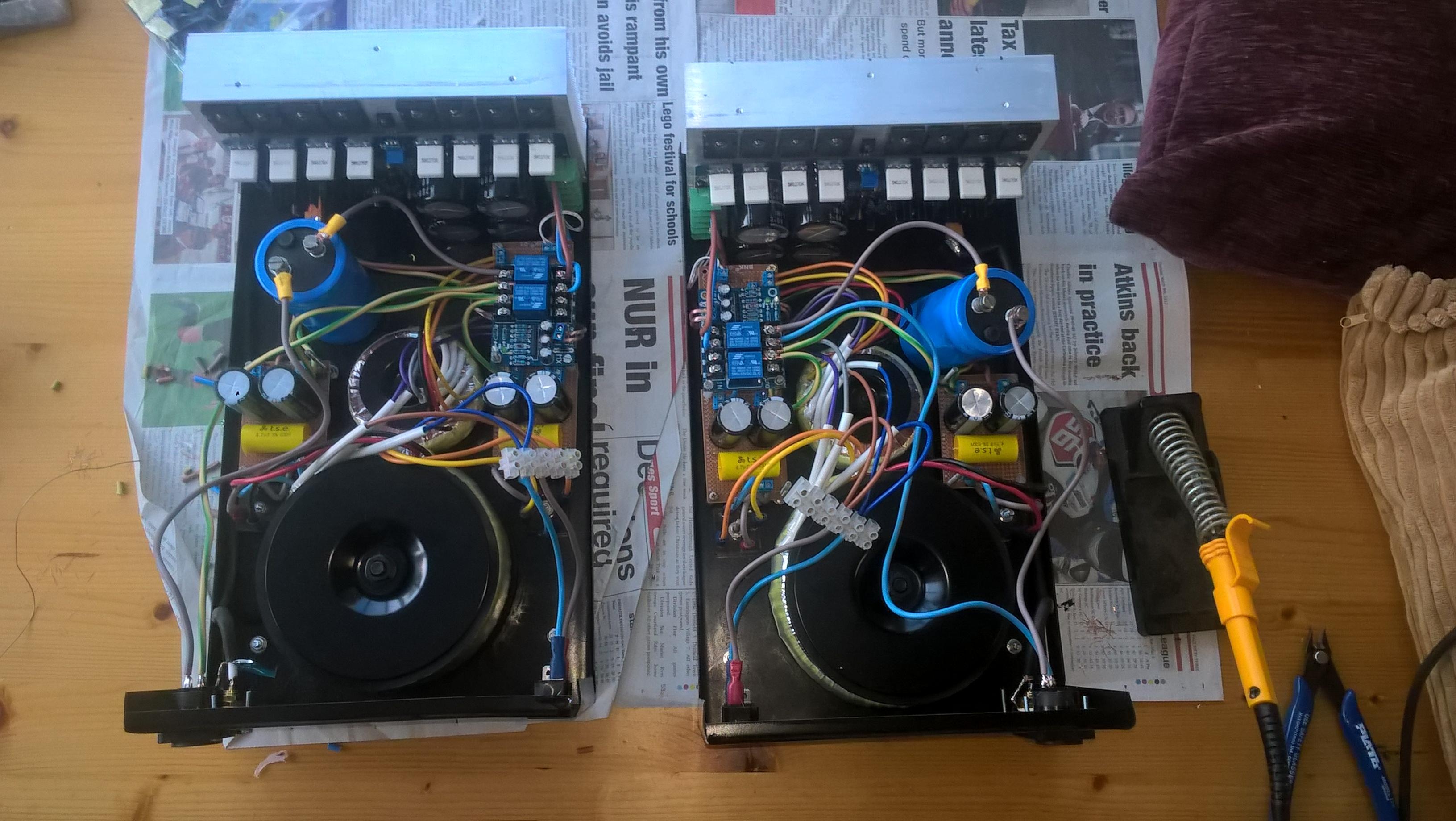

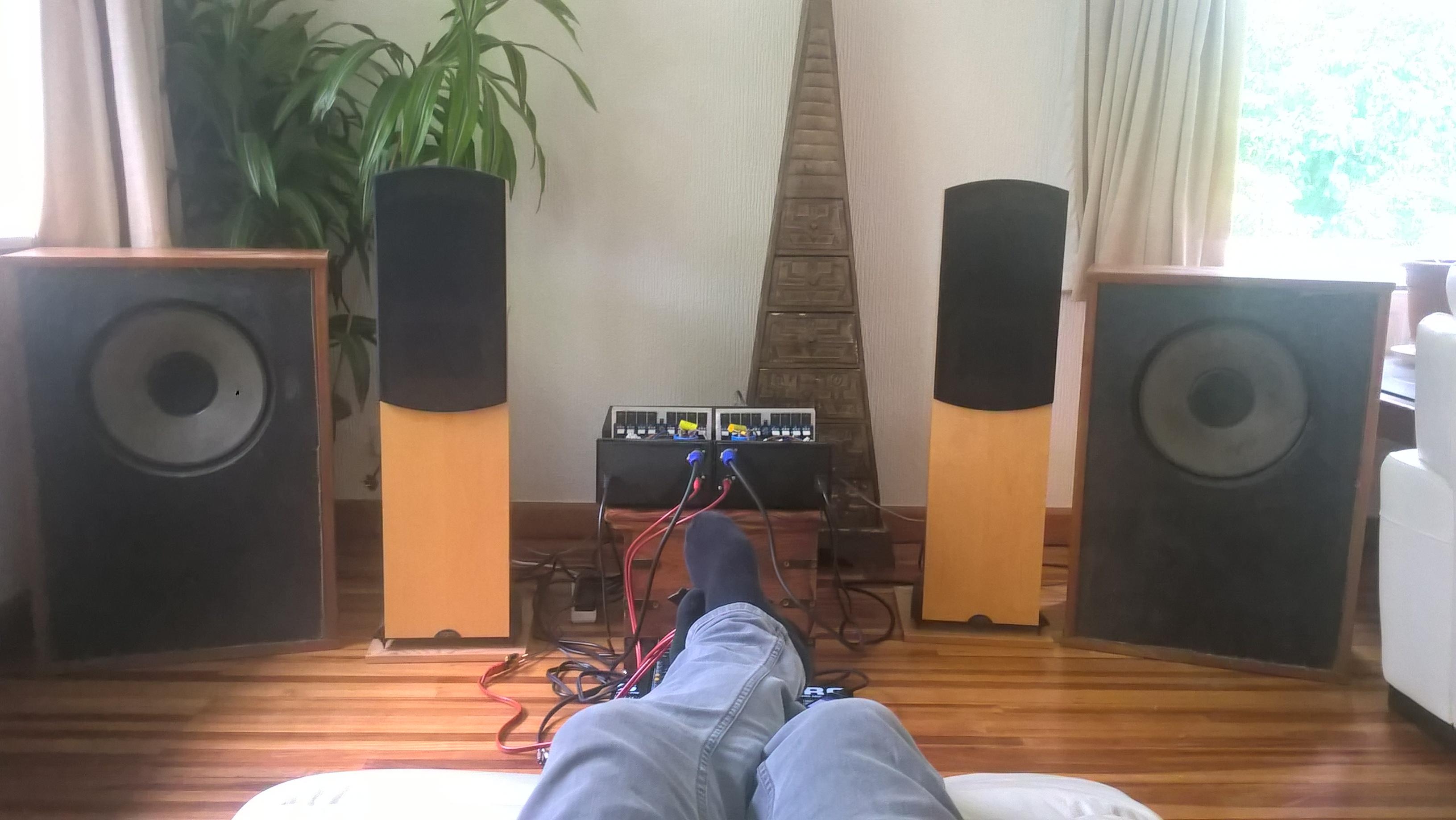

Finished project PR-800
Used 500VA 35-0 35-0 transformers to build 2 x monoblocks using these bad boys. They're not ultra hifi but sound great all the same. I'm having the opposite problem to others in this thread; in getting the input correct, I think i'm going to need a pre-amp stage as the standard pre-out from my system doesn't seem to drive them at full whack. I'm running them into 8ohm with +/- 55v supply rails and they should be deafening me but they're not.
I'm currently using both a speaker protection board and a huge output cap. I dare not directly couple my nice speakers just yet. i need to make sure that they'll behave. Left them playing quietly for 48 hours and they're still ok so they seem stable enough.
Easy project for beginners. Folding steel into DIY clam-shell case was the hardest part.

I'm very interested in building an amplifier for a sound system I'm going to put together the next couple months or so. Would you be willing to provide a parts list of what is needed in addition to the PR-800? i'll be doing the same set up, a pair for 2 channels to 2 speakers. Thanks!
Additional components
In addition to the amplifier modules themselves (one per channel);
You'll need a +- 55v power supply.
Speaker protection boards (ebay <£5)
Output capacitors 10,000 uf 300v (one per channel)
A 12v power supply for the bias input
For the power supplies i used:
35-0 35-0 torroid 300VA
2 x bridge rectifier
2 x 10,000 uf 100v capacitors for smoothing
4 x 4uf capacitors for smoothinh
2 x 100nf capacitors for smoothing
12-0 12-0 torroid 15w for the bias and speaker protection
