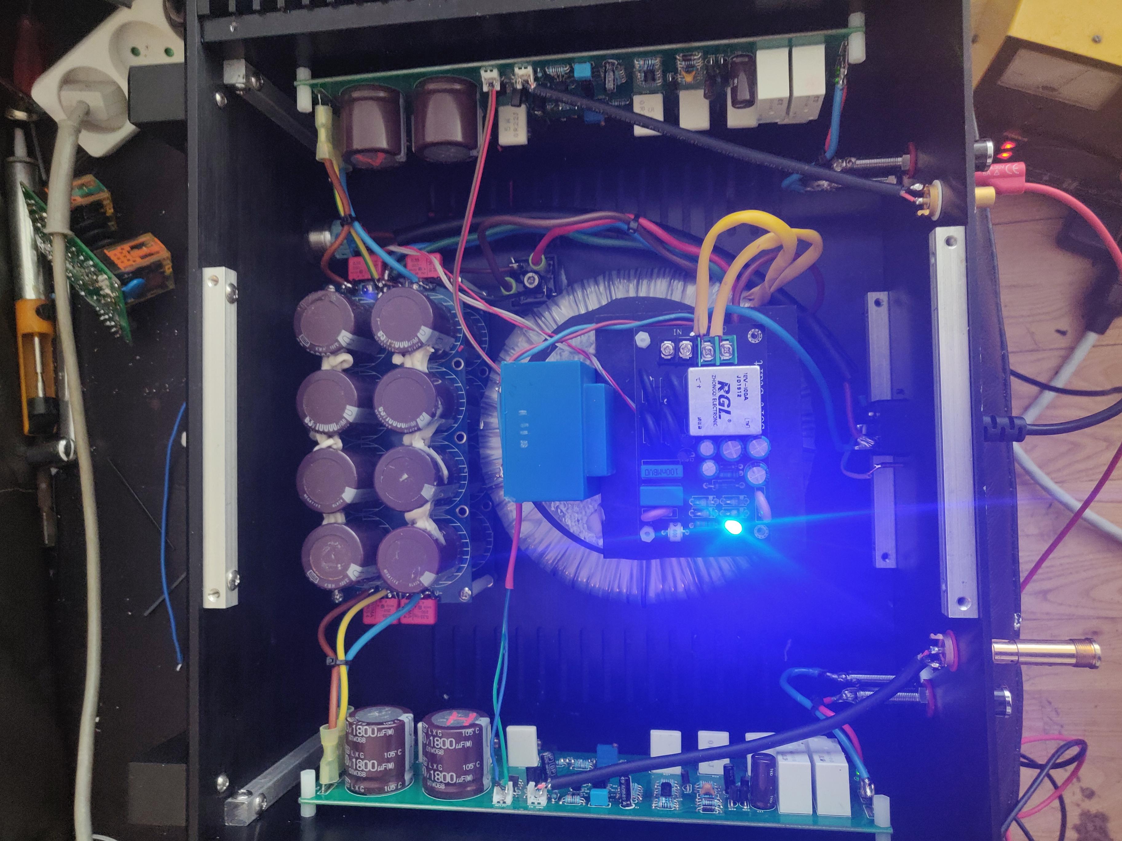

Here, almost finished. It was left in the case to install ...
HI roclite ,
Thank you for your reply , But I'm still not sure whether this amp have a short circuit protection , Meaning if I accidentally shorted the output wires , The Amp won't burn , That's what I wanted to know without learning the hard way 🙂
BTW , This is my amplifier , It is an updated version with 2 x 10,000uf elna caps. instead of the 4 caps in the original version of the pr-800 board, I use my old Onkyo M504 chassis and transformers , I just finished it and playing some tunes in my test music system as of this writing.
