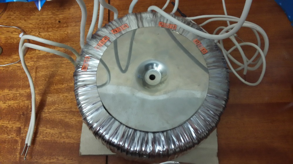

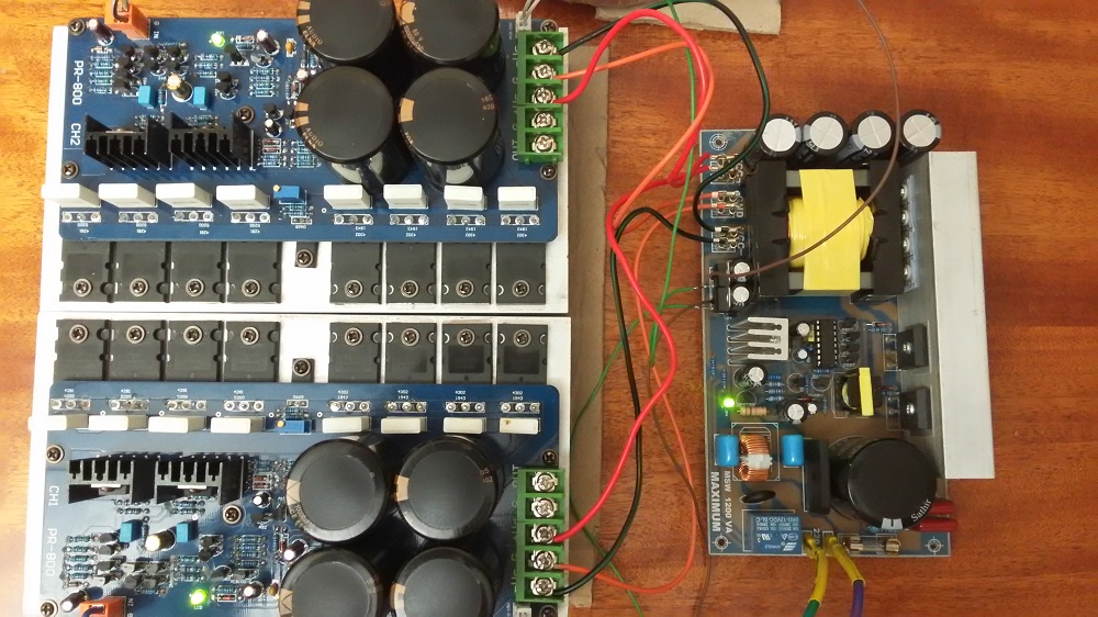

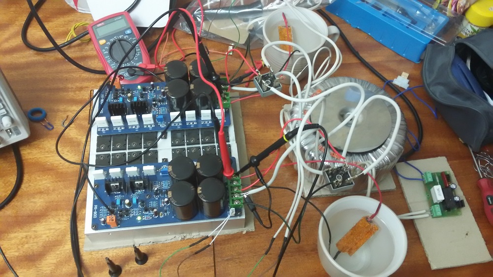

Launched today, the Chinese miracle ... Supply voltage +-60 volts. The bias current set about 55 mA (15 mV to 0.27 ohm resistors). heatsinks idle half an hour later warmed up to 50 degrees is 60. Prompt, and this temperature should be?
Hi Sergio, as a minimum mod you should replace the 51R 1/4 Watt resistor immediately in front of the heatsinked driver transistor MJE15033 for one of higher power rating, at least 1W but 2W even better. If you are running the PR-800 at high bias, this resistor will cook and eventually fail.
Nice set up, switching power supply a bit unusual in an audio amplifier but if you are happy....😉 I hand-drew the circuit diagram for my own reference but don't want to publish online. The 6 -12VAC supply feeds the SCR over-current protection circuit and generates a supply rail about 8 -16V below the negative rail voltage, as it is referenced to the negative rail. Lots of users have problems with the SCR crowbar circuit being too sensitive so hopefully you will be lucky.
That should sound good though I would have been tempted to just use a much smaller (cheaper) transformer to provide 6 - 12VAC supply, as it is really low power requirement. But not a problem.
Great, let us know how it sounds. I never powered up my PR-800 boards for listening tests but I am in process of re-designing the circuit to my own version. It will be interesting to get some opinions.

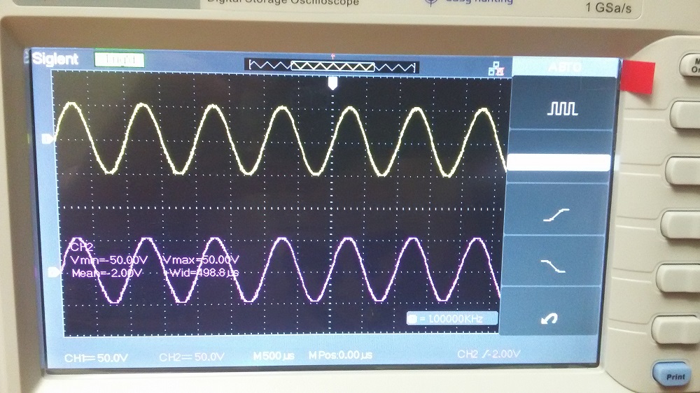

At 4 ohms and 25 volts at the amplifier's output turns on protection...How to disable protection?
It's hard to tell without schematic, and, - of course -, not recommended!
