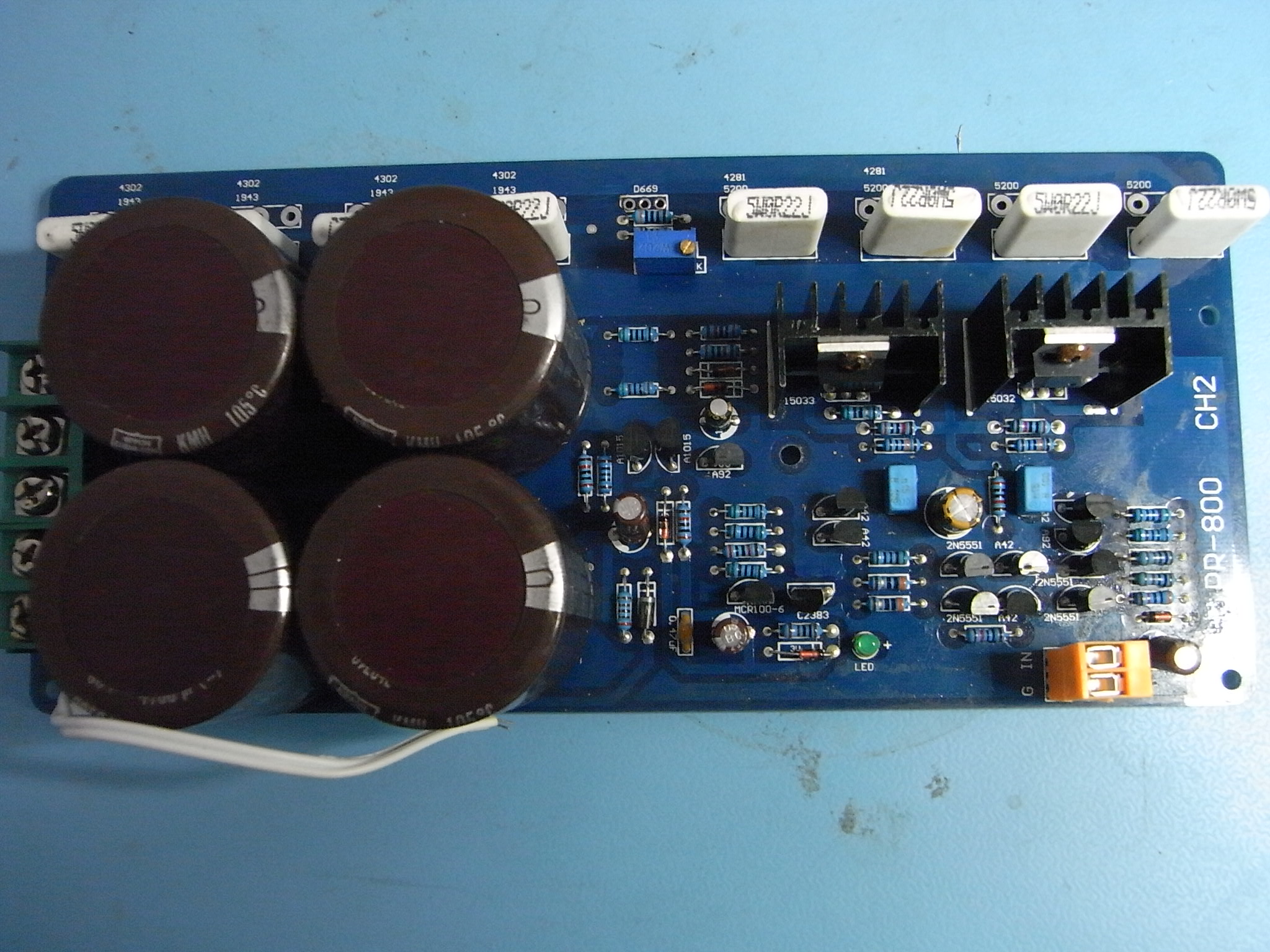

A first look at the PR-800 ClassA/AB design and layout revealed some interesting "features"😀
1) The IPS has MPSA42/2N5551 NPN Darlington input pair with a 2N5551 cascode in each collector arm.
2) In spite of 2 x 4700uF/rail PSU capacitors on-board next to the connection terminal block, there are no other localised decoupling electrolytics elsewhere.
3) There are no base stopper resistors on the output Toshiba power transistors.
4) No output Zobel network.
5) A large number of components are used in a SOA/fault current output protection circuit which has a latching SCR device, requiring a separate 6 - 15 VAC supply.
I have not come across a Darlington IPS before and there seems to be very little documentation about them - not a great start. I would be keen to remove/disable the protection circuit to avoid the need for a separate transformer or a low voltage winding on the mains transformer. As discussed, I will be using +/- 55 V DC supplies so the circuit is probably an overkill. The other things are easy to resolve by hacking a few pcb tracks and adding additional components but beginning to wonder if this is a good audio design to start with. Anyone out there with any relevant experience with this particular amplifier?

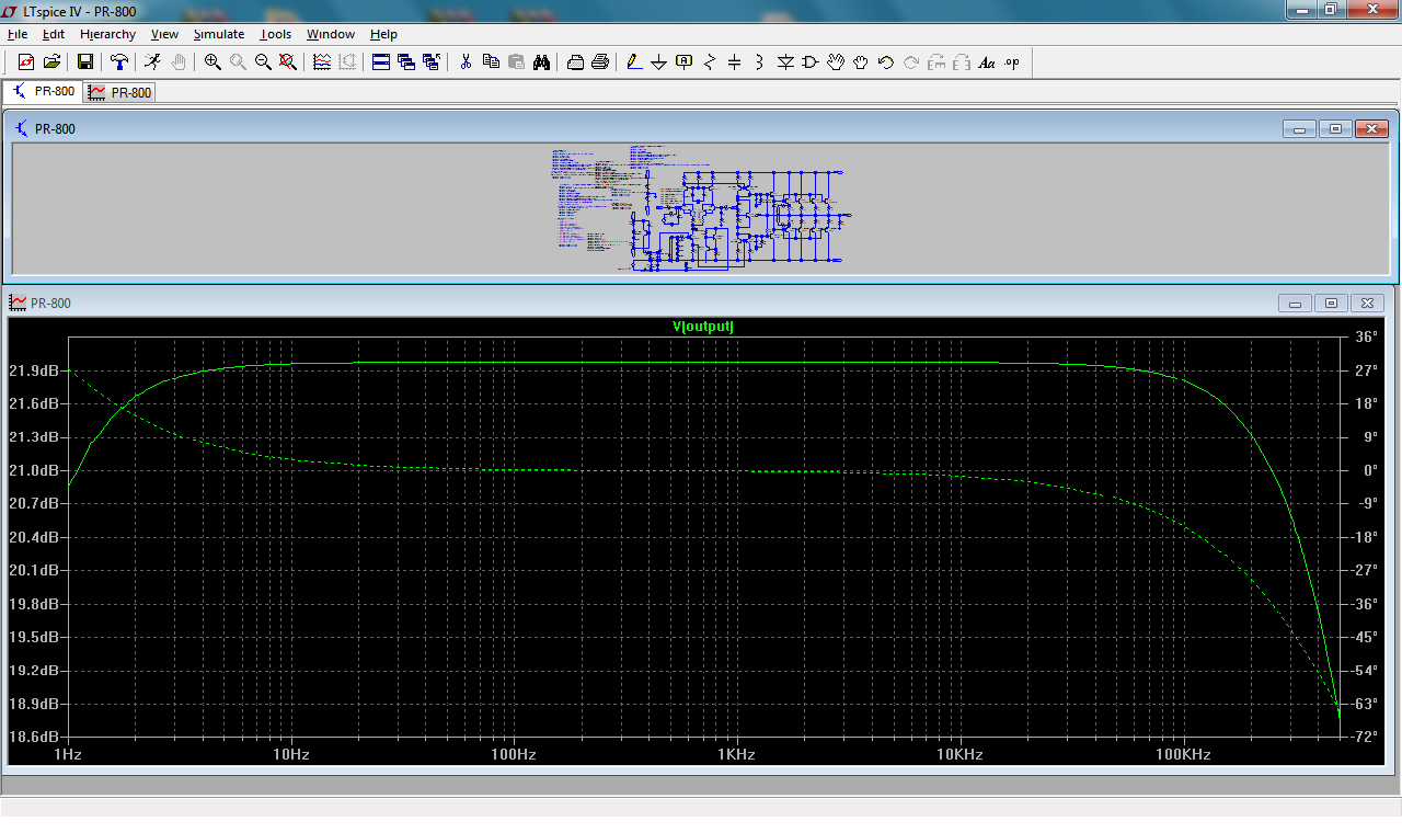

Before I started hacking the PR-800 boards, I thought it would be a good idea to sketch the circuit design from the board to review the design and map how the components were interconnected. At the same time, I learned to use LTspice as this would be useful to check the performance of the original PR-800 and any subsequent design changes I implemented. The performance "specifications" provided by the eBay seller listing were incomplete with no test conditions against any of the performance figures. I used LTspice to try simulate the Harmonic Distortion and Frequency response measurements against the claimed performance figures:
Harmonic Distortion: <0.01 10W/8 Ohm
Frequency Response: 1Hz - 160KHz (-3dB)

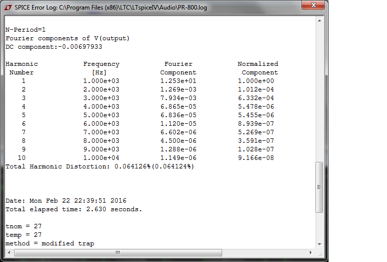

In my simulated amplifier, I set the supply rails to +/- 45 VDC and adjusted the input 1 KHz test signal to deliver 10W into 8 Ohm resistive load. I adjusted the output stage bias to the optimum class AB, approx. 120mA per transistor pair (4 parallel pairs) which should have given low distortion. The results screenshots are attached and the simulated performance figures:
Harmonic Distortion: <0.065% 10W/8 Ohm (10th order?) 10KHz bandwidth
Frequency Response: 1Hz - 500KHz (-3dB)
Unless I am using inaccurate component models or my understanding of LTspice is not up to scratch (very likely😀), these performance figures seem way off. If they are accurate, at least I know my starting point🙂

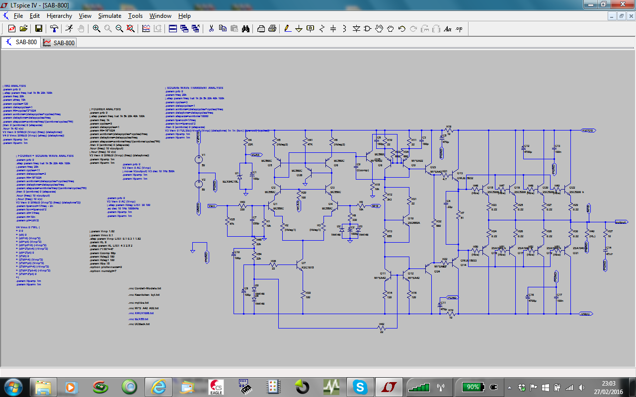

I managed to get up to speed with LTspice and spent more hours than was really healthy tweaking the original PR-800 Class A/AB design into something much better. I was very grateful to astx and other diyaudio members for their brilliant work on this thread:
http://www.diyaudio.com/forums/soli...ormance-class-ab-power-amp-200w8r-400w4r.html
which was basically a master-class tutorial in how to use LTspice to design, test and evaluate a class AB amplifier. This work was even more relevant to mine because the PR-800 circuit design was quite similar and could be modified fairly easily using the same configuration in the 2-stage class AB amplifier.
But first, I revisited the original PR-800 design to re-evaluate using the same DC supplies and input signal conditions as the simulated new design. The results were much worse than before because now it appeared that the PR-800 displayed asymmetrical clipping at +46/-34V levels on +/- 59V DC supplies, probably due to the protection circuit or bad biasing. I had not seen that during previous simulations at 10W into 8 ohm. It didn't look good, that protection circuit really had to go🙁
Since the new design is now quite different from the original PR-800, I have no issues with sharing the LTspice files and component models for the new amplifier now renamed to SAB-800🙂. I copied over as much of the 2-stage class AB design as I could bearing in mind that I was implementing this on an existing amplifier layout, so could not make it identical. Nevertheless, from the results, the THD figures are now orders of magnitude less than before and there is no evidence of premature asymmetrical clipping behaviour. The biggest reduction in simulated THD figures was when I copied over the Q9/Q12/Q13 VAS driver stage (Q8/Q9/Q25 on SAB-800). Of course, these are only LTspice simulated performance figures so actual implementation could be significantly different. There may be further component tweaks to improve performance even more but the issue here is that I will always be constrained by implementing the final circuit on the existing PR-800 amplifier board.

Thanks Andrew, don't think I can take much credit for other members hard work but it does show that it might be possible to make a "silk purse out of a sow's ear"😉. A definite thumbs-up for cut'n'paste audio design. All I need to do now is implement onto the PR-800 board. Luckily, by removing the dubious protection circuit, I have plenty of free PTH for the extra components and have also become very adept with my Dremel. It wont look pretty but you don't listen with your eyes, after all.
Dear roclite,
increase OPS bias to oliver point and you will get even better distortion figures. Currently you have biased one OPS bjt pair with about 25mA - increase it to e.g. 90mA and you will get better distortion figures (asc file: reduce R13 from 655R to 625R). If you want to keep lower BIAS current you have to increase the emitter resistors up to 0.47R.
Try to add "TianProbe()" parts to check the NFB loop stability.
Have fun, Toni
Hi Toni
Thanks for your advice and many thanks for sharing your 2 Stage Class AB amplifier design, I learned a lot reading about the design steps you took during the development.
I keep the OPS bias quite low to reduce quiescent power dissipation in the output stage and driver transistors, mostly TO-92. The SAB-800 boards will be installed into an old amplifier case re-using switches, output terminals, heatsinks etc so usually the heatsinks are not optimum size. Replacing the 0.22R emitter resistors is likely to damage the boards so I would keep as is. Apart from that, there are 16 of them😉. I will try the Tianprobe before I implement the changes. I did notice what looks like a bit of frequency ripple/instability on the square-wave trailing edge that meant I had to increase my base stopper resistors from 4.7 to 15 Ohm, probably higher than I would like.
