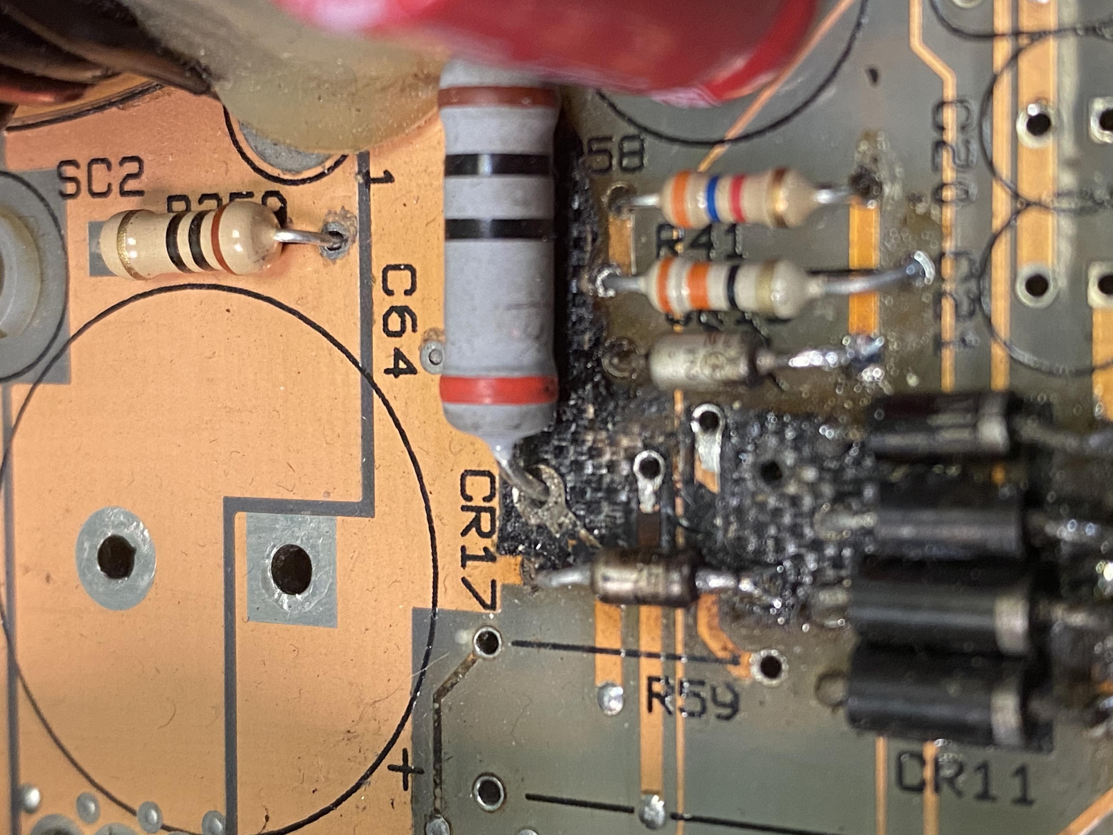

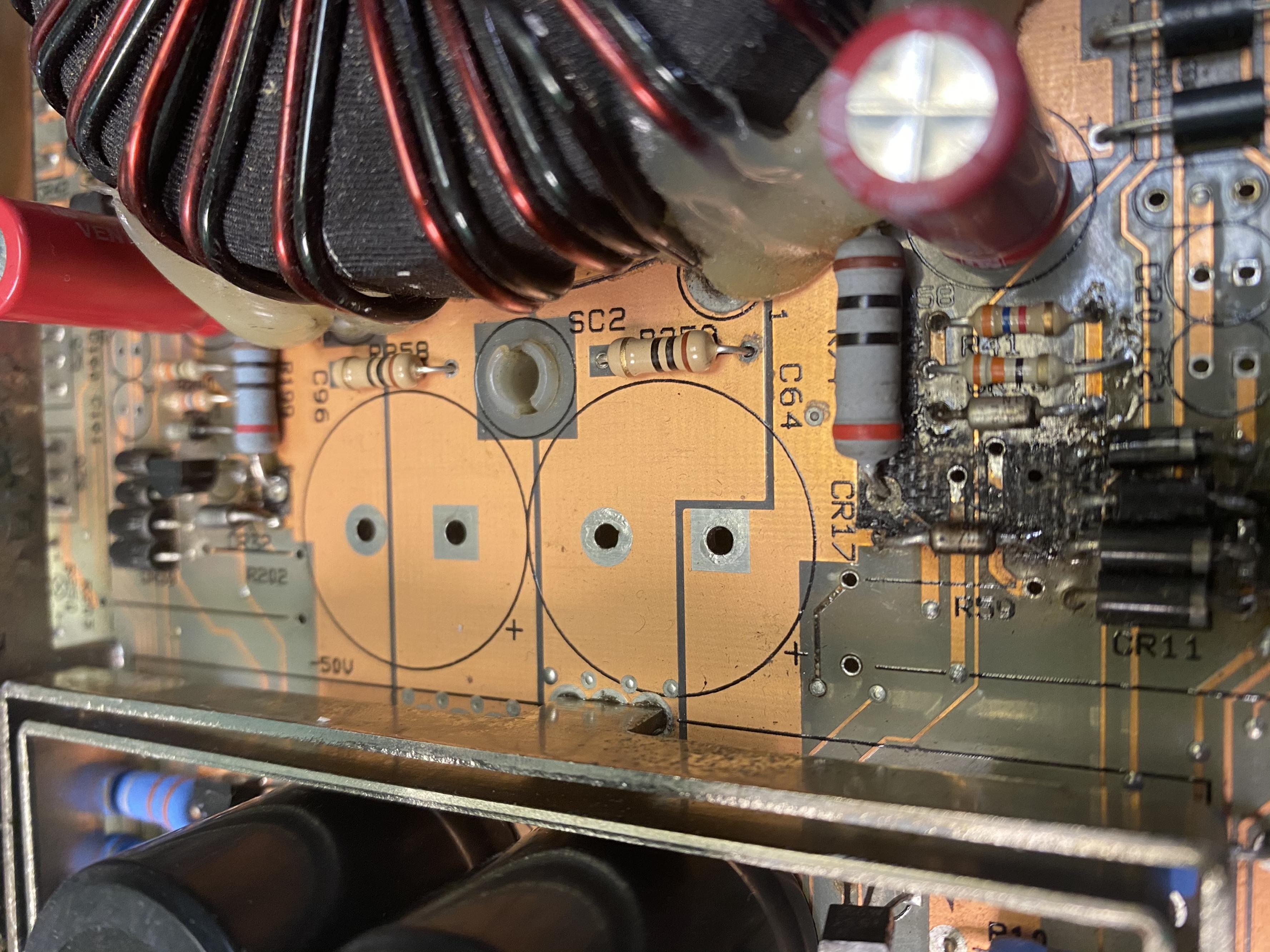

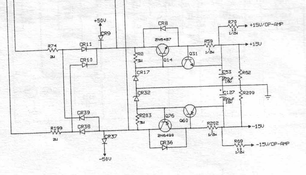

I figured out the problem .
I have problems in the regulator circuit still and is causing the power supply to go crazy .
I will rebuild the regulator circuit again double checking all connections and got from there .
So far I found a shorted diode 1N4744
The diode will work for testing but if someone is paying you to repair this amp or you intend to sell it, order and install the right part before it leaves your shop.

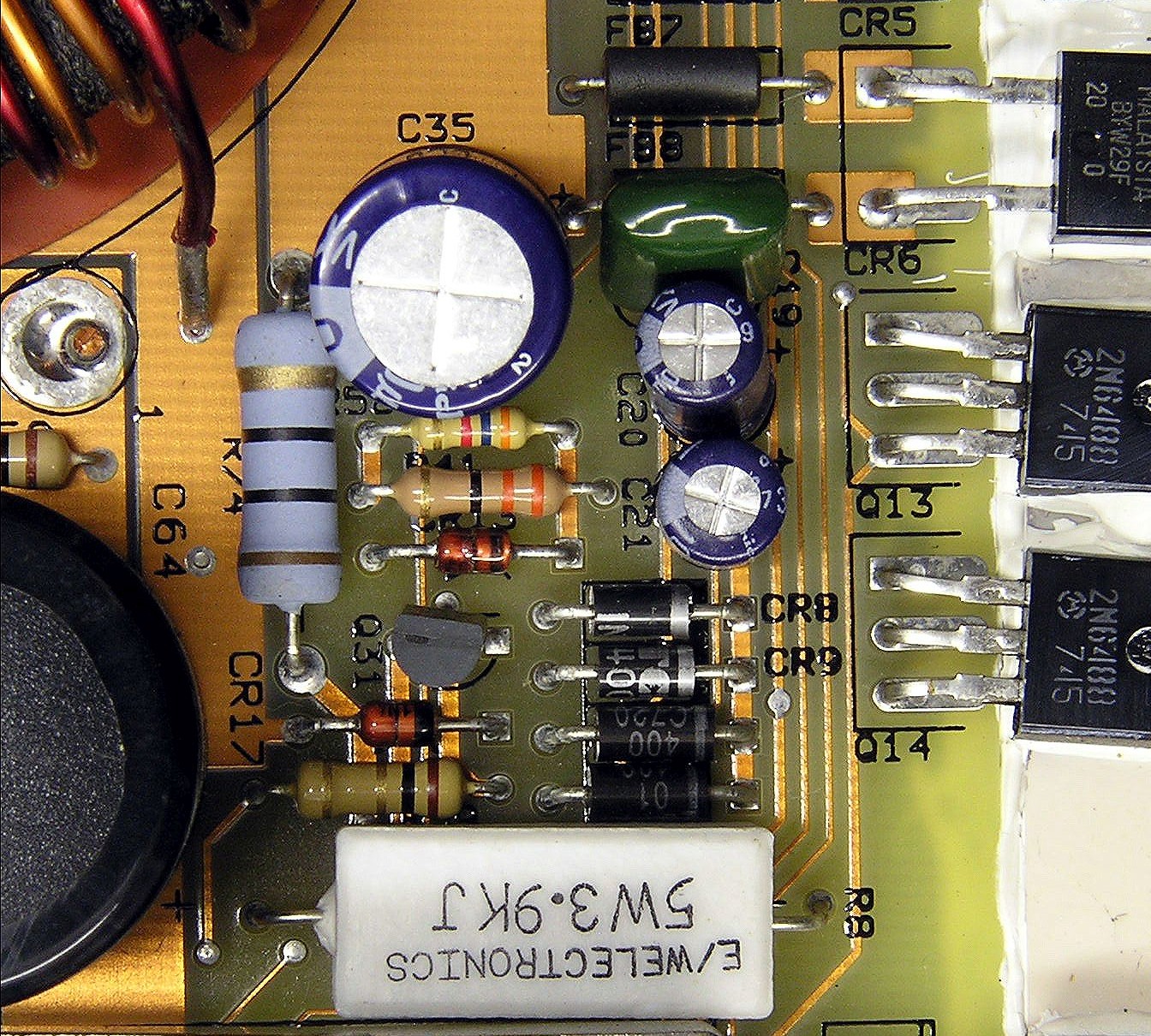

1 last question before I test for drive again .
Do the 2N6488’s and 6491’s have to be in circuit in order to test the drive for the power supply fets ?
Board locations Q13,14. Q75,76
