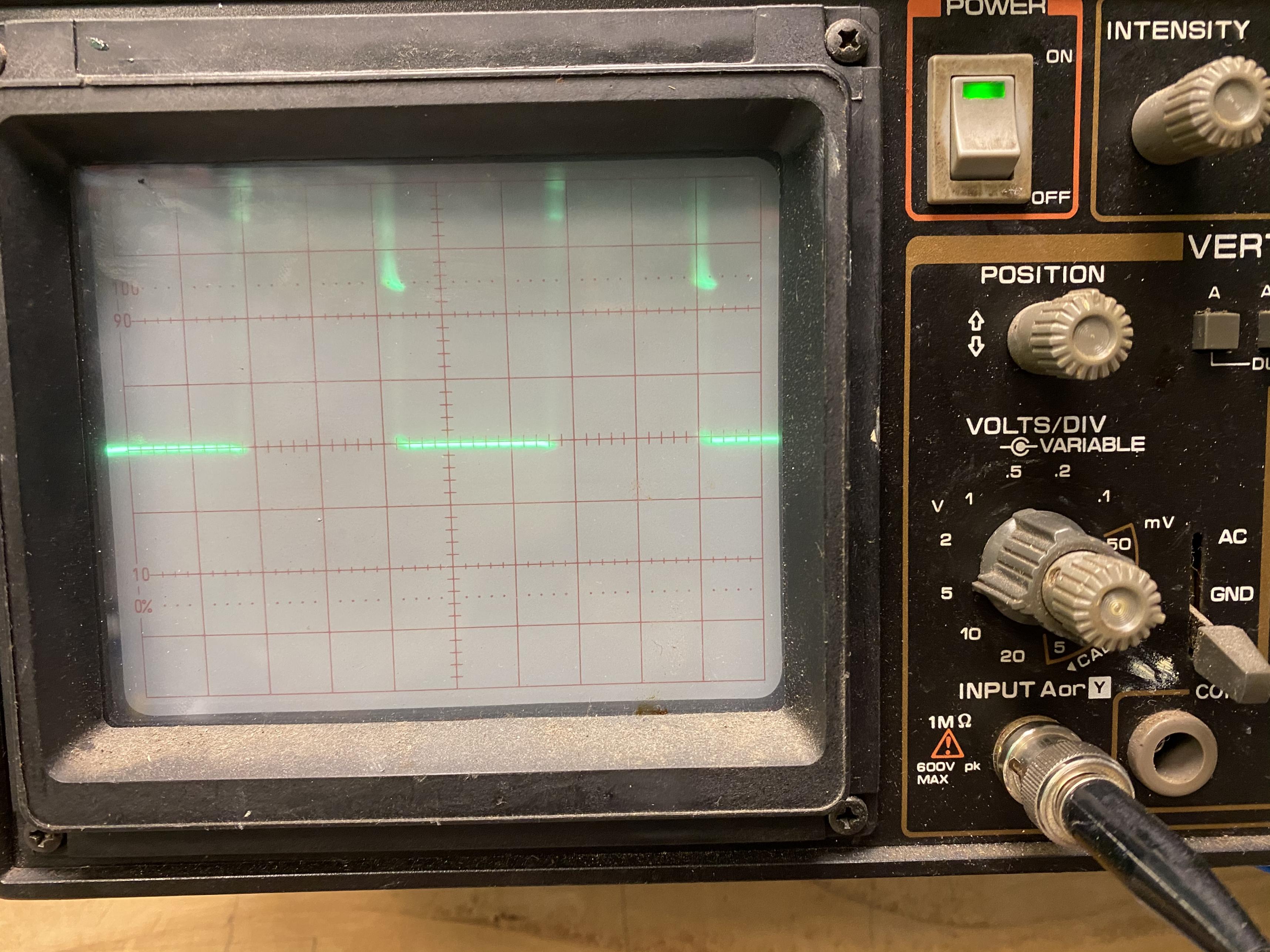

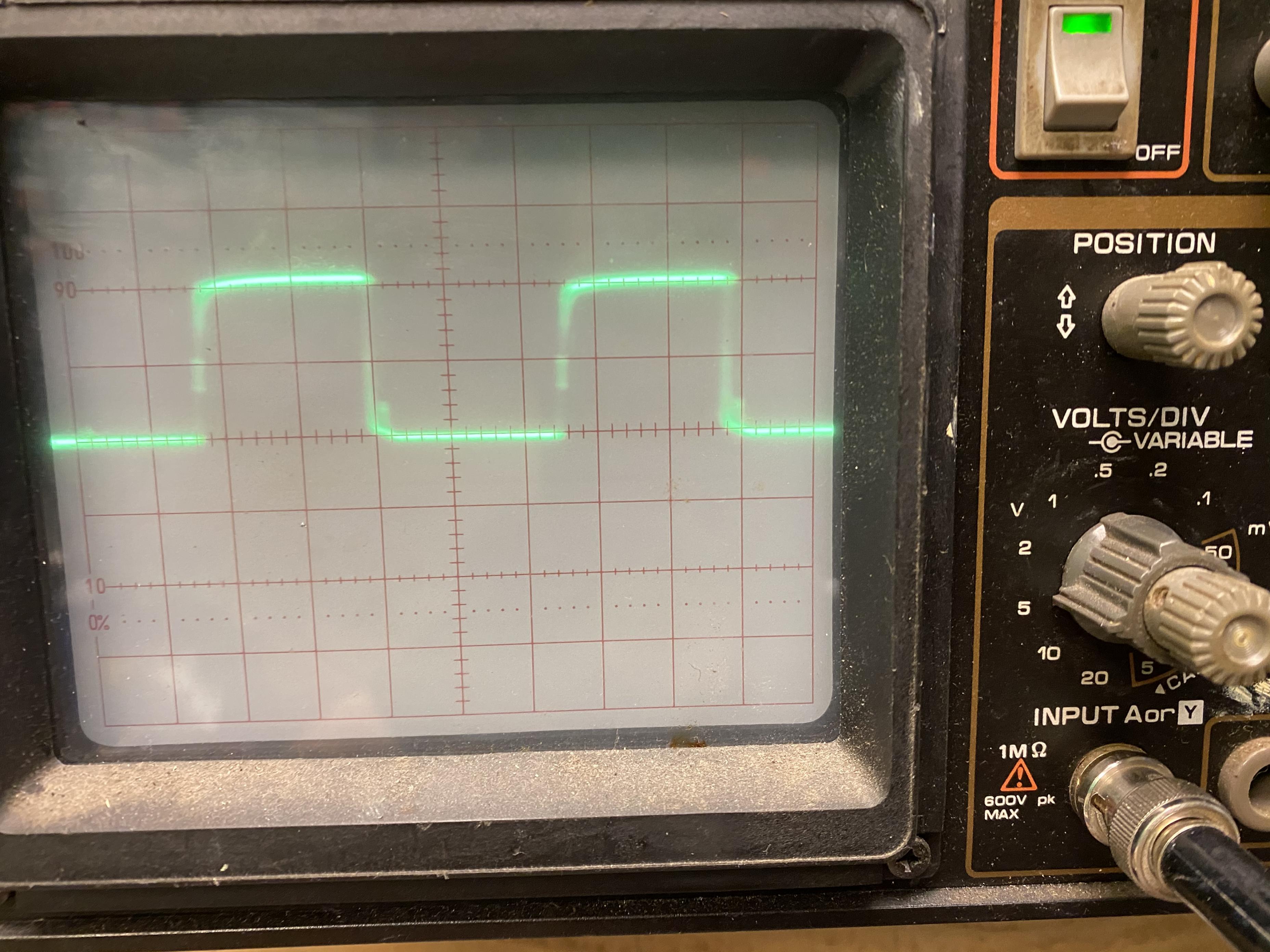

Replaced the 3525 .
Still have drive issues .
This is Q1 first pic Q2 second pic .
Scope settings are 5us 5votls/div in both pics
If I put a fet in locations Q7 or Q8 the fets get to hot to touch within 2 secs and amp draws excessive current
