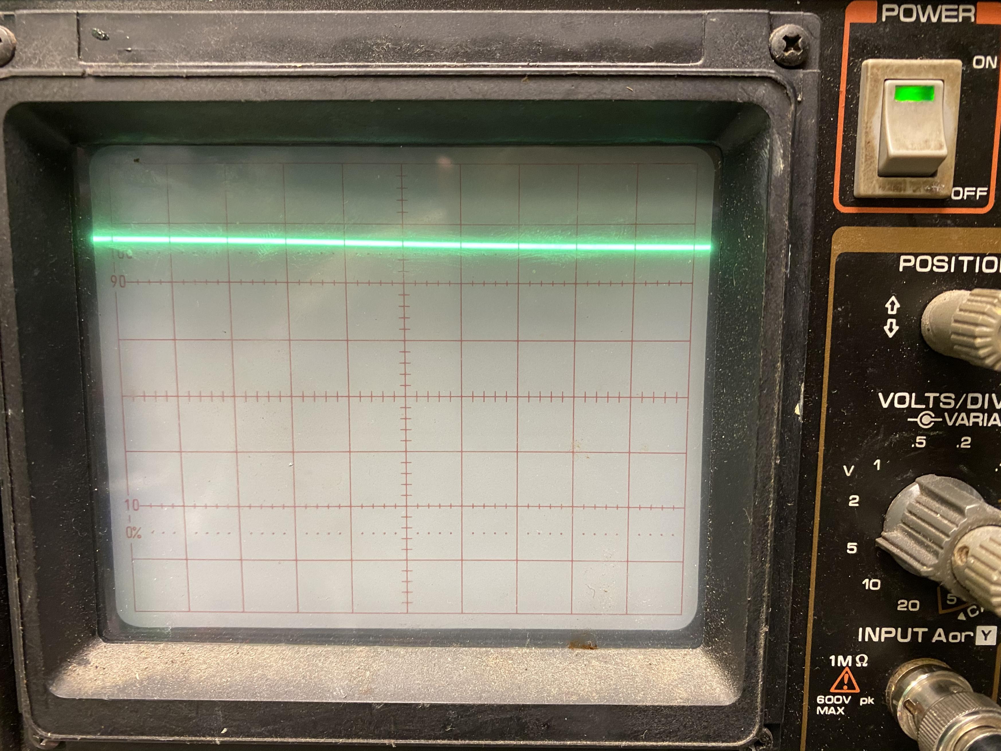

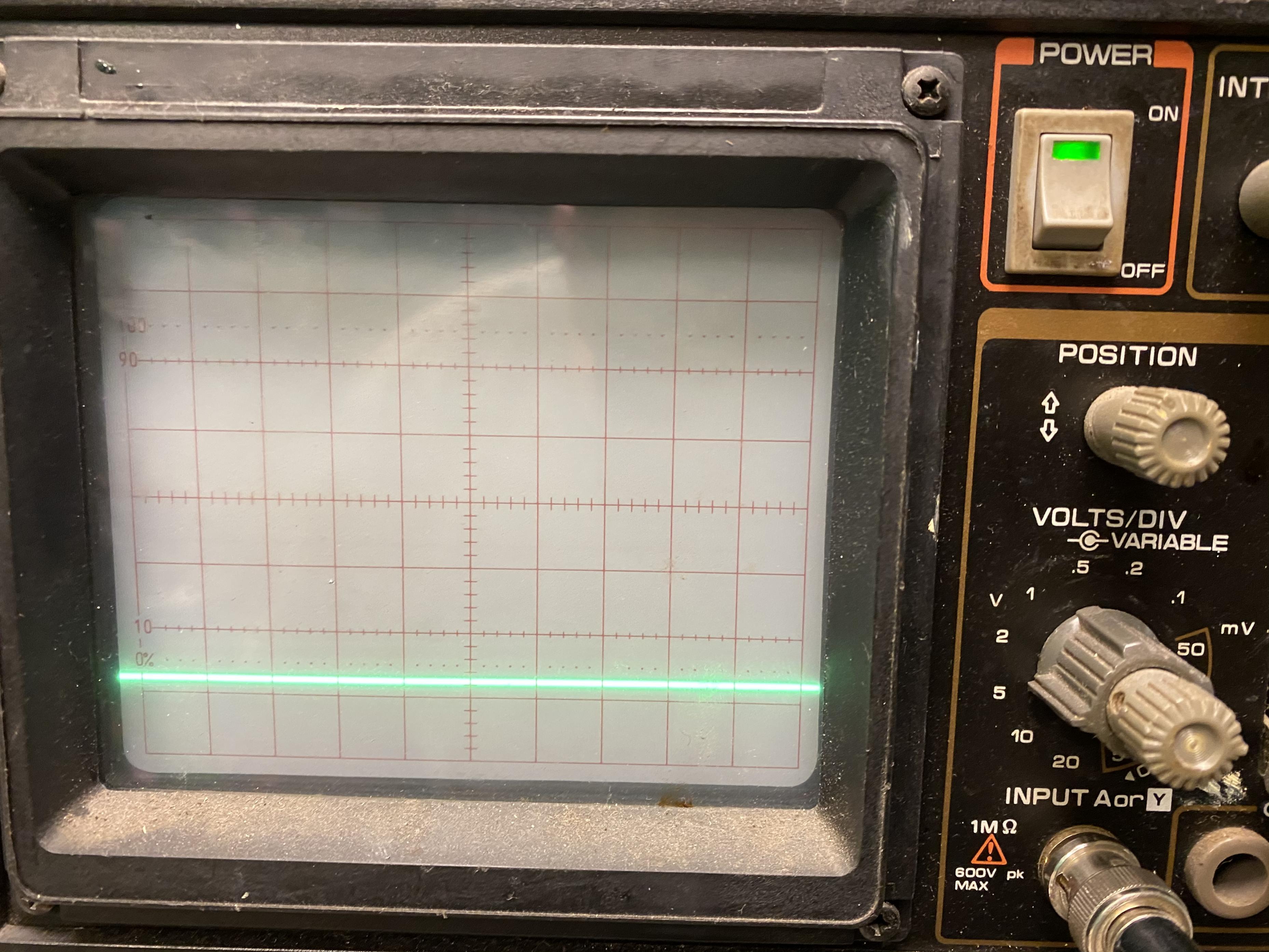

Would the driver ic’s cause this or should I look for something else that’s messing the drive up
Q4,75 the source legs are grounded .
Not sure why Q2 doesn’t show loading since the cap is soldered between gate and source .
For those 2 FETs, bridge legs 2 and 3 and re-check the drive signals on the 2 FETs that didn't show their loaded signals as expected.

I replaced the HIP4081’s put them in sockets this time .
I still get no drive on Q2 and Q12 the trace just deflects
Any ideas what might cause this
