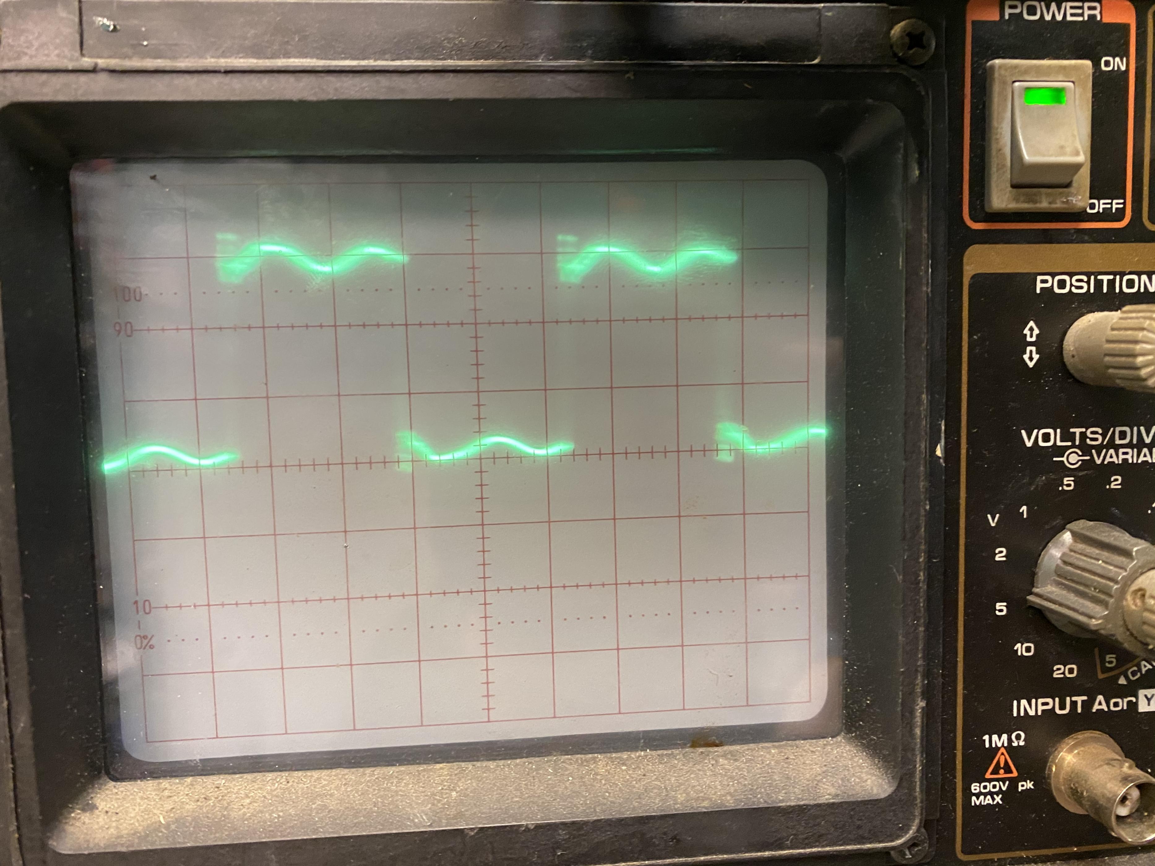

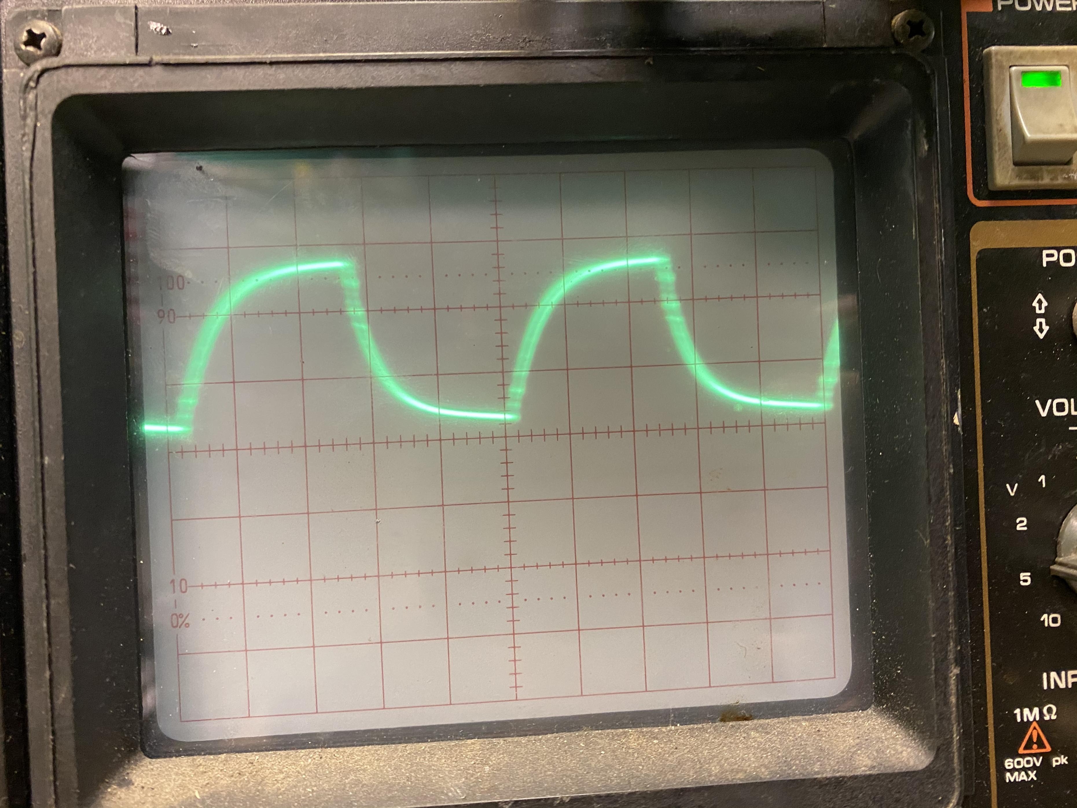

Do you have drive signals on all 4 inputs (2, 5, 6, 7) to the IC?
Here are the drive signals on pins2,5,6,7
Scope settings are 5us 5volts/div

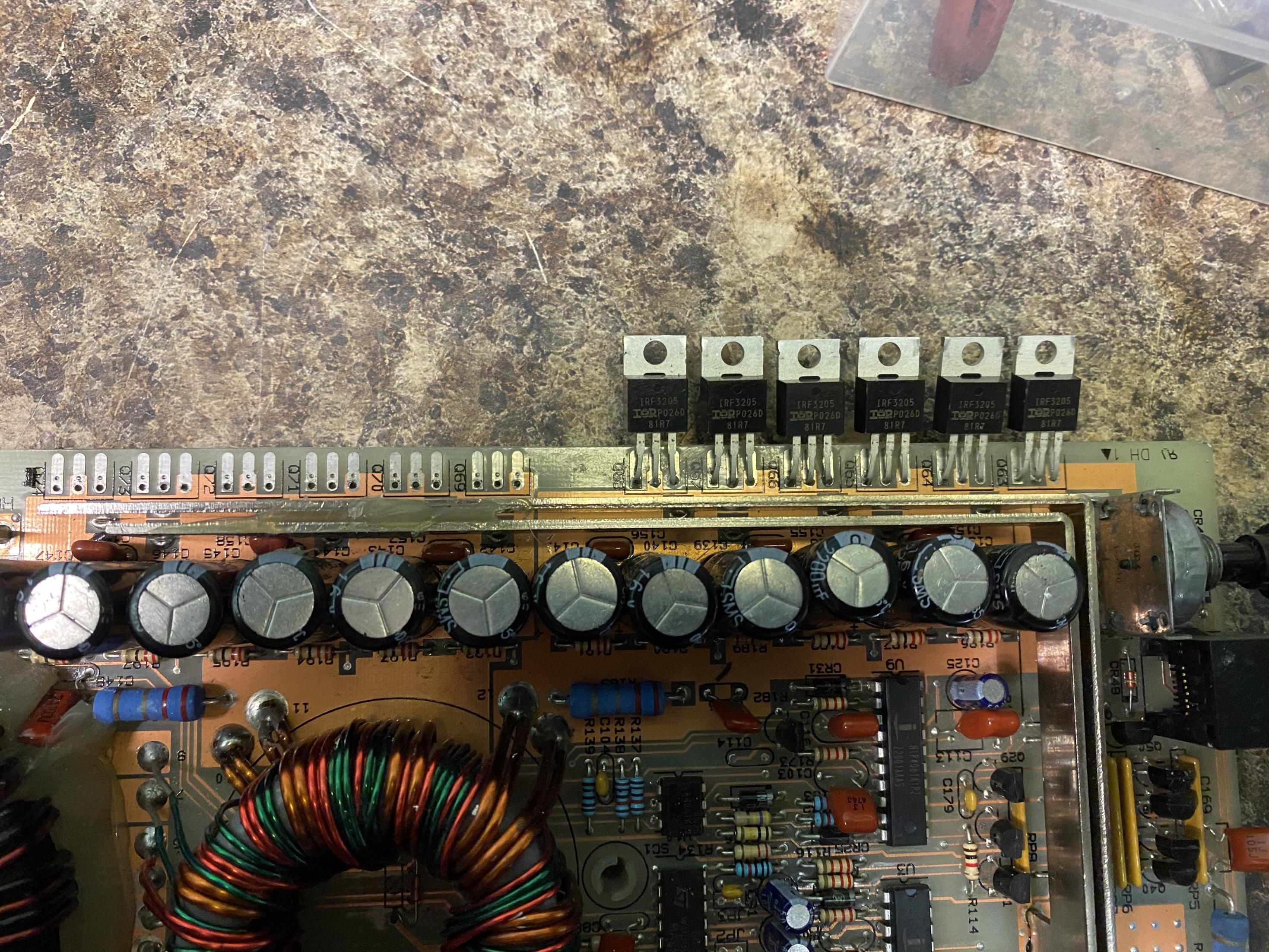

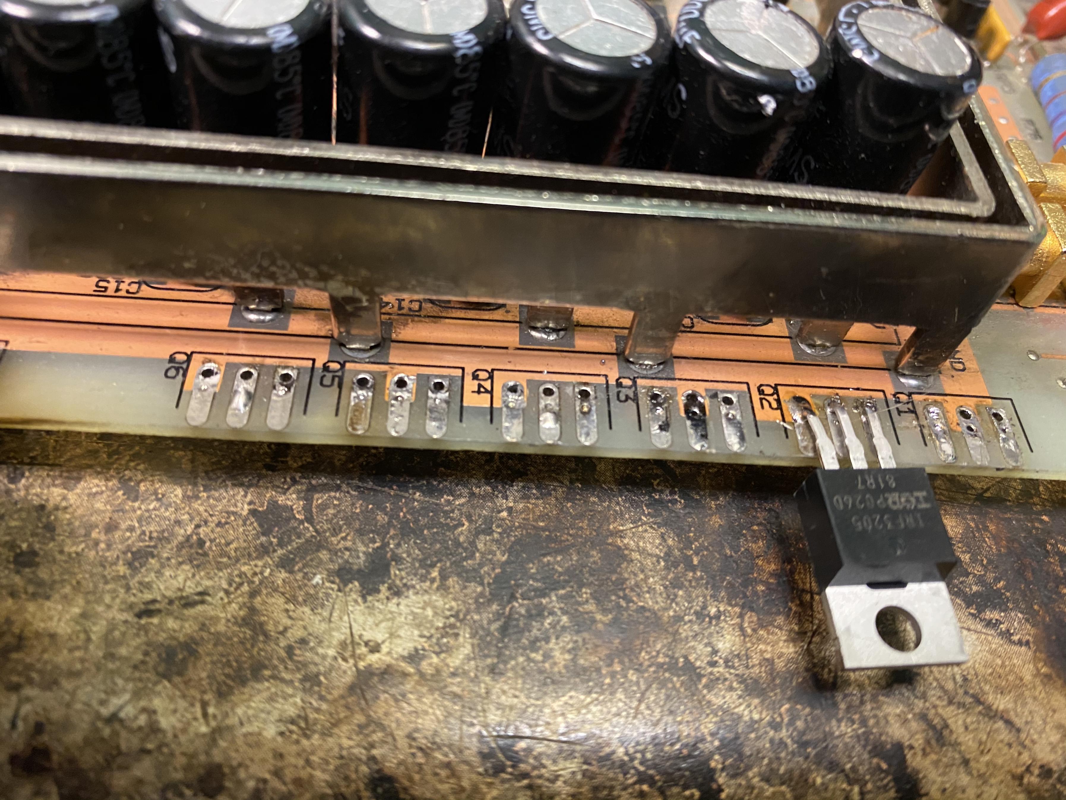

No fets are in the 2 banks causing issues .
I will put a fet in the bank and take pics of the drive

Ok I replaced the 3525 and it blew the fet I had in 1 bank instantly.

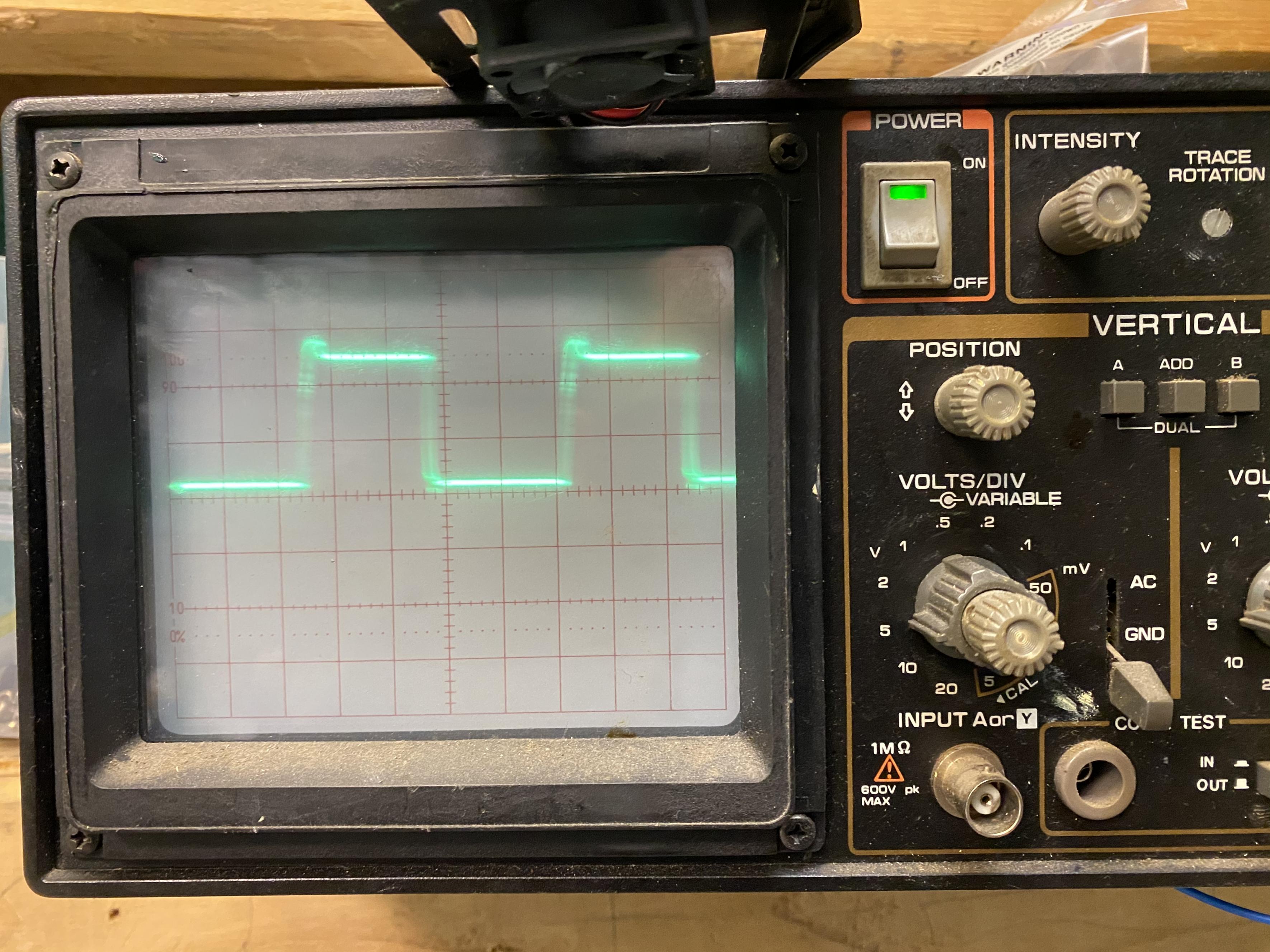

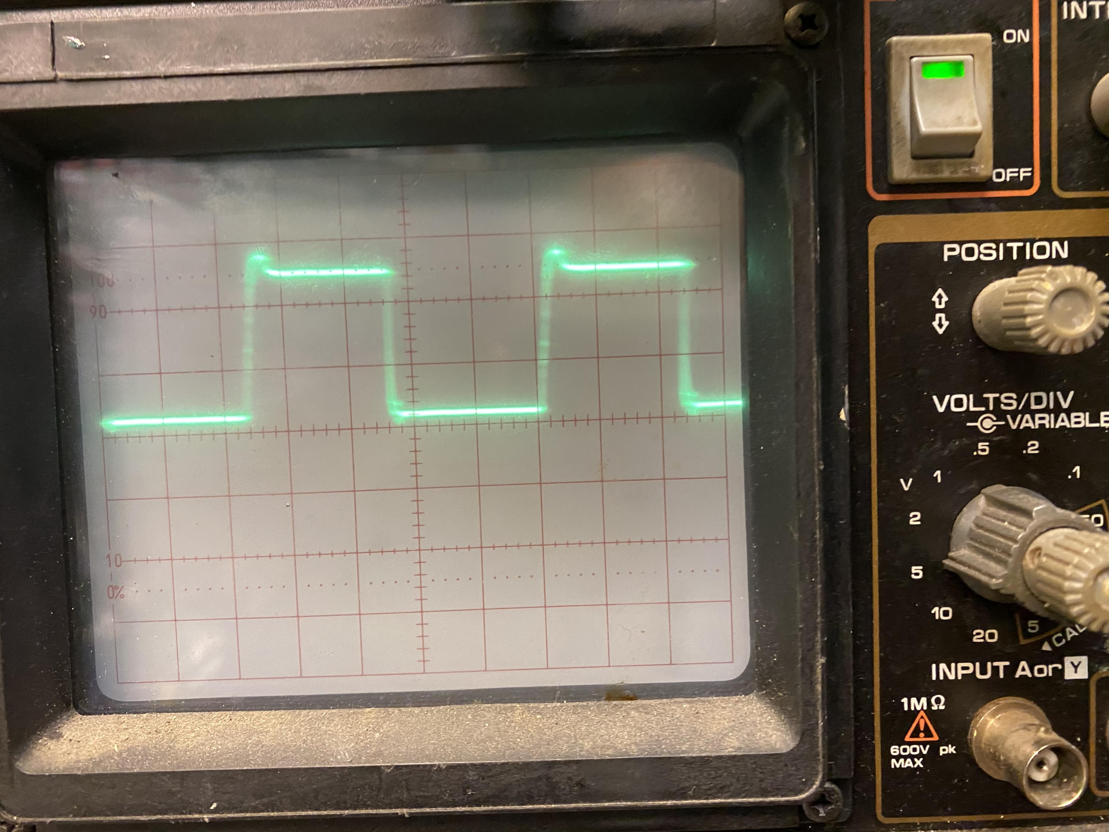

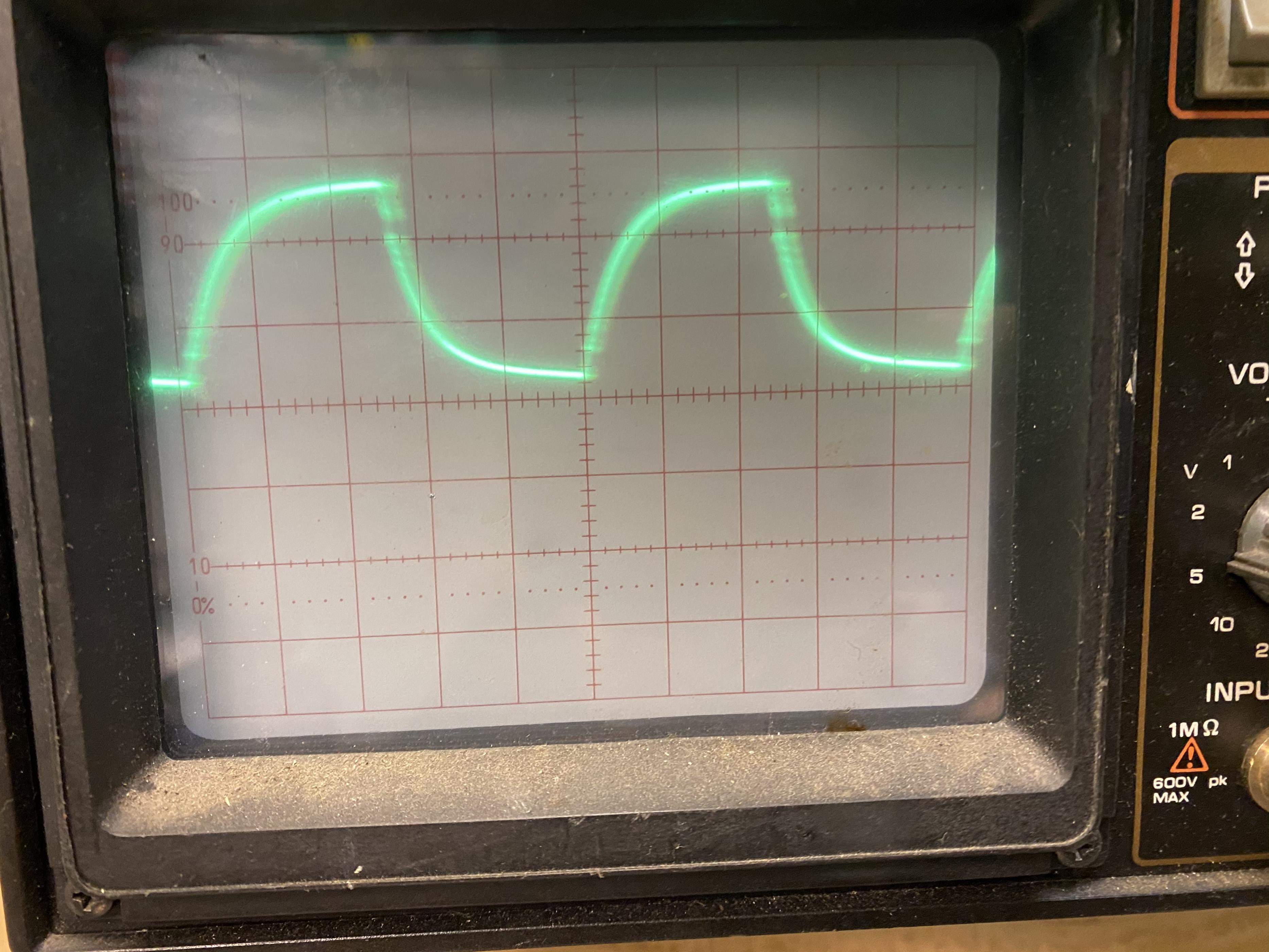

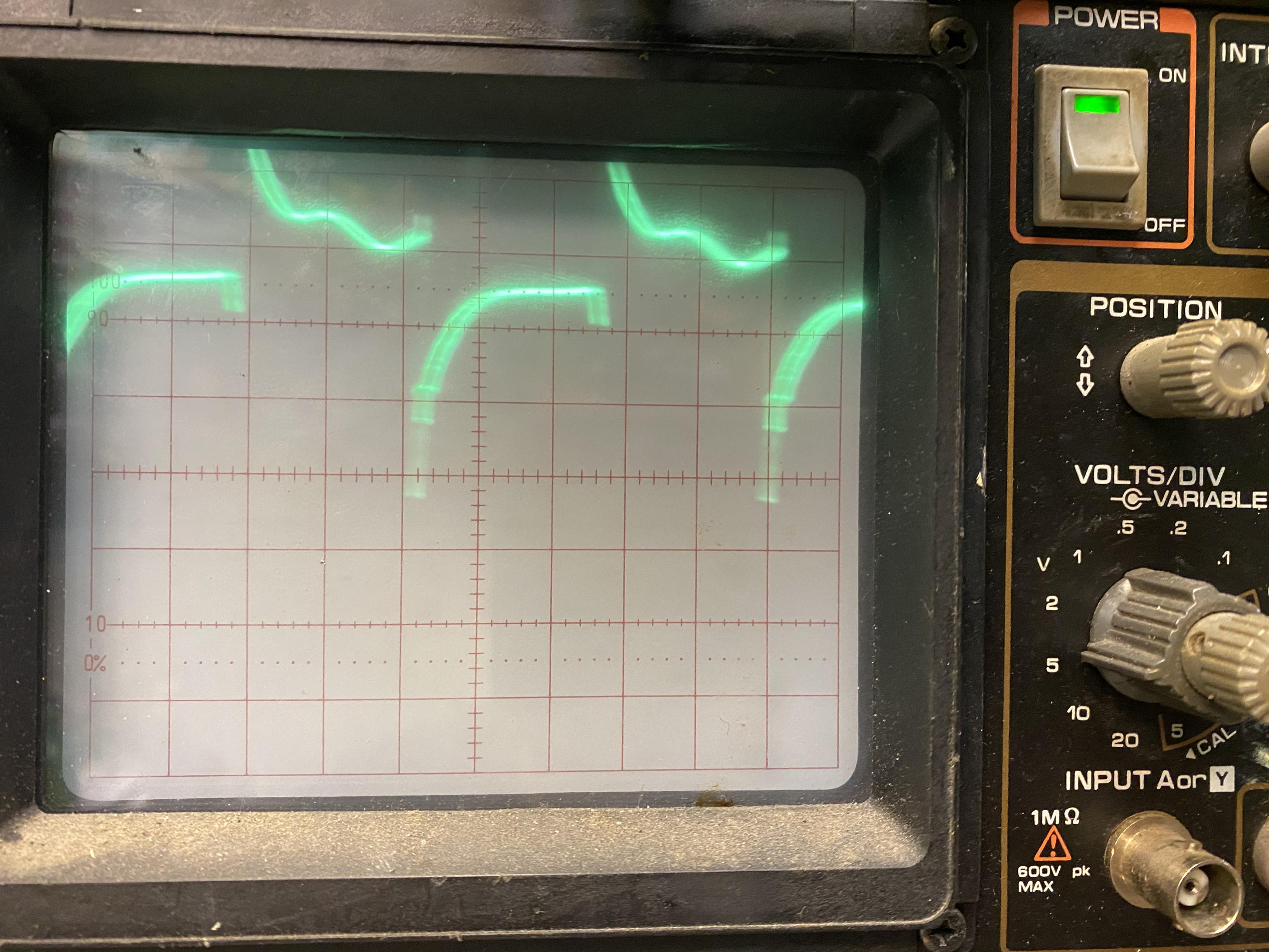

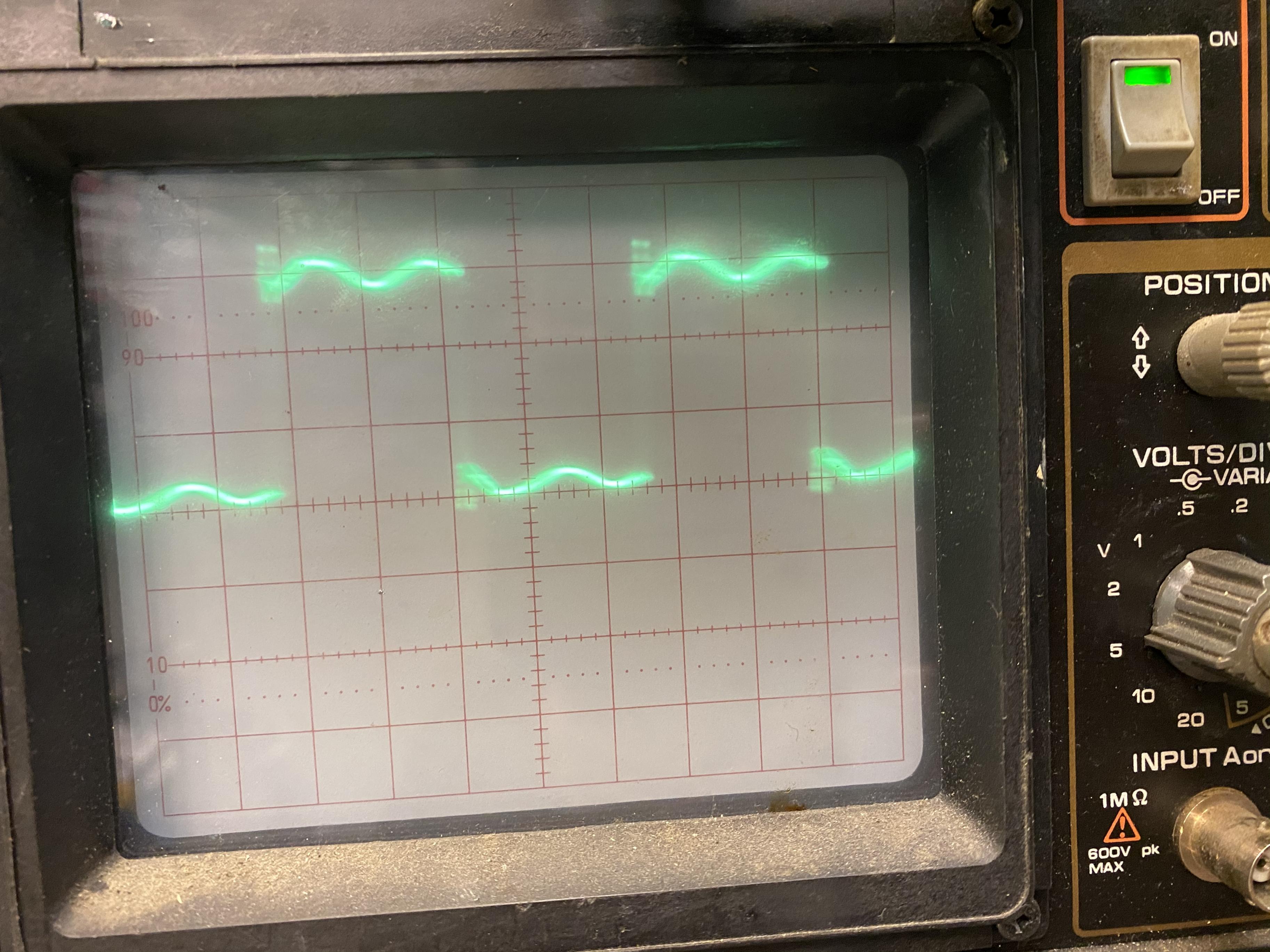

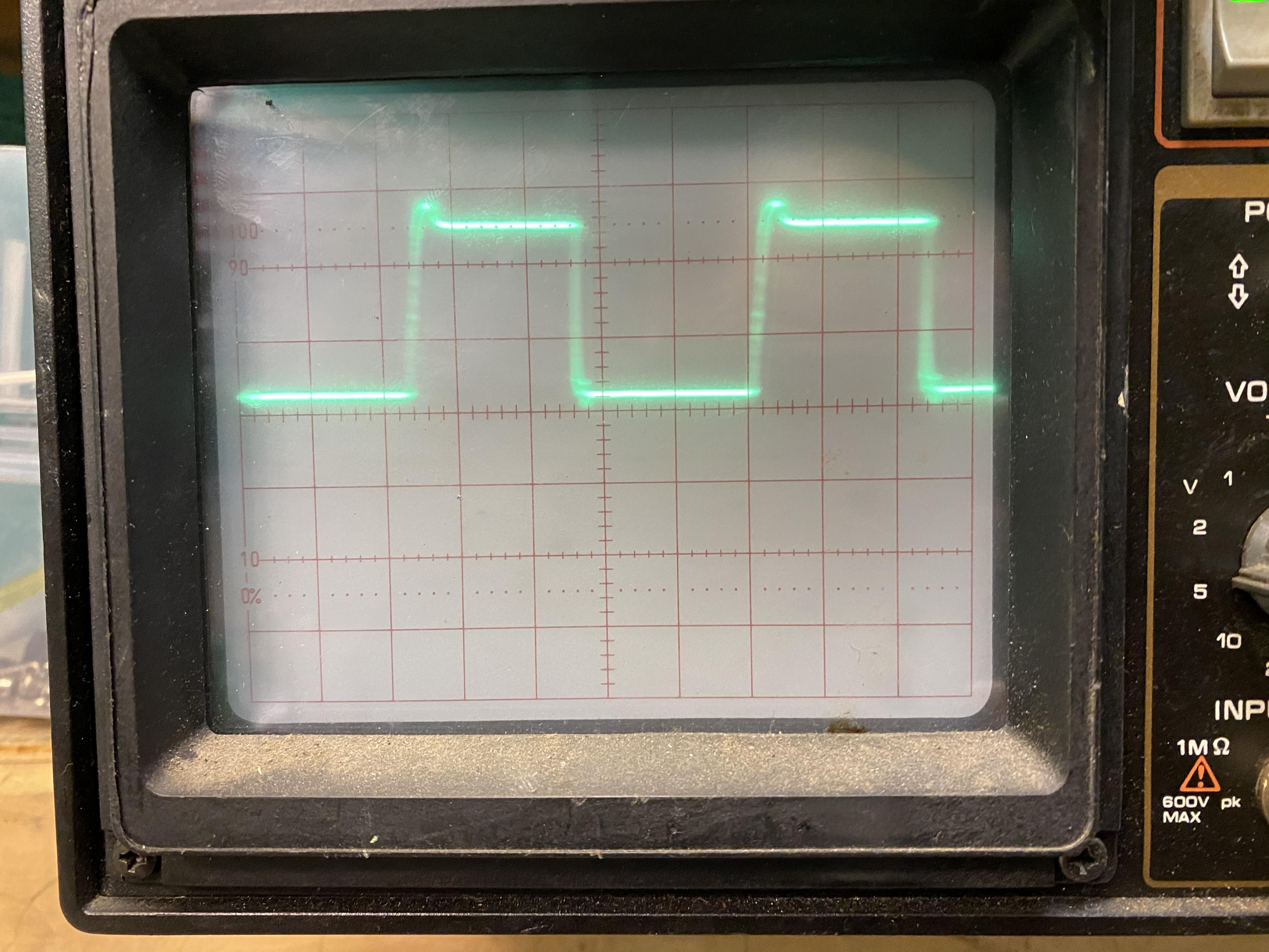

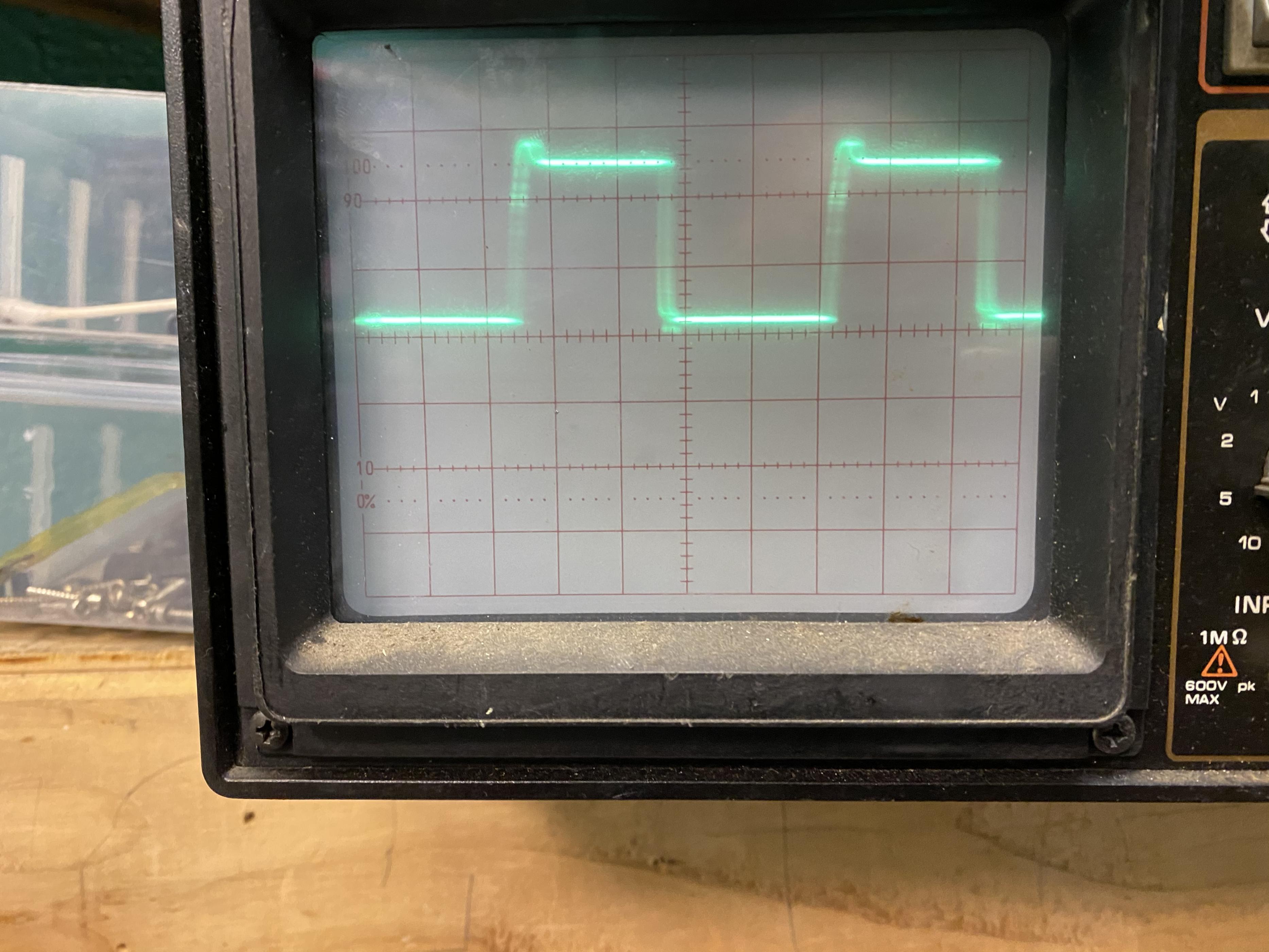

Here is what I get on all 4 banks of fets
Did any have FETs installed?
Which FET locations were each of these taken from?
2 and 4 look OK. The first doesn't look like it has any load.
The 3rd may be due to having no reference.
