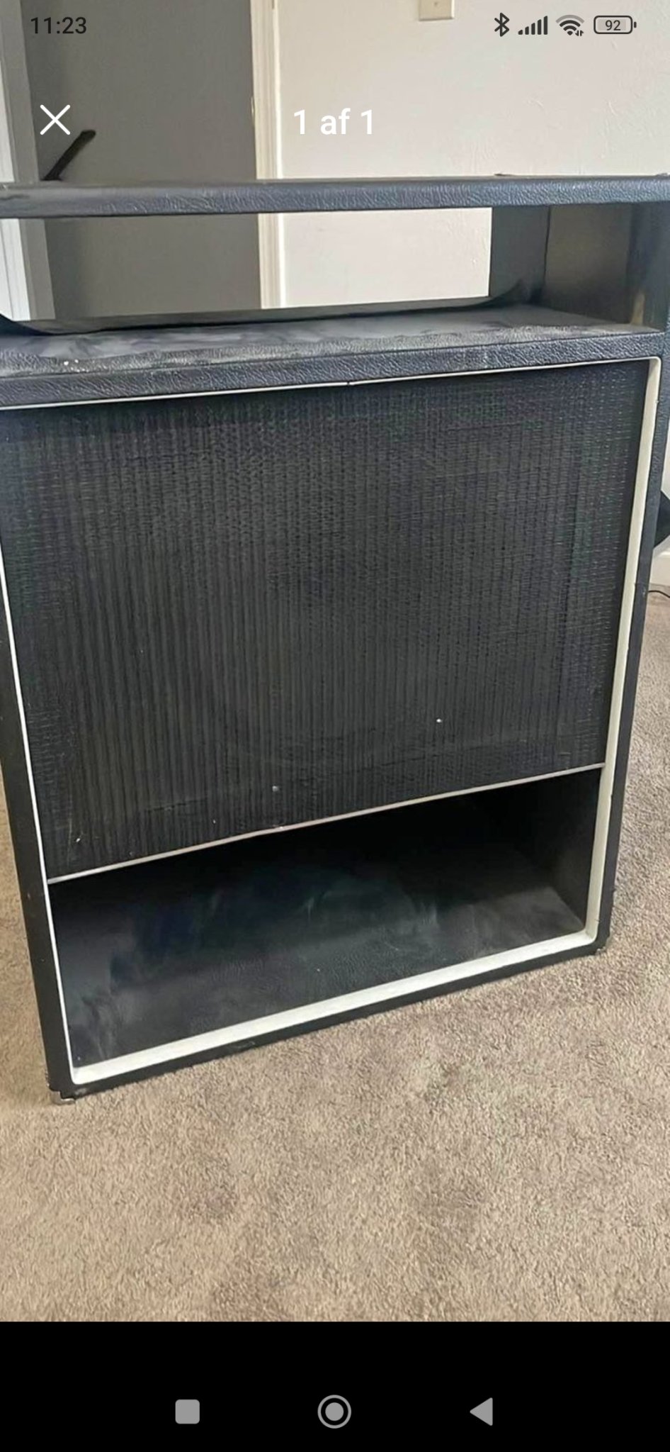

How does people feel about this? 50 Dollars. Is it a bass combo that has been gutted for its amp part? The amp part of @Crocobar 's Frontman could be put in the vacant space and drive the speaker to loud. Guitar in high impedance instrument input and bass board into aux input. Then cabinet simulation should be turned of on the Flamma. To me it should sound great for both Guitar and Bass:
https://www.facebook.com/marketplace/item/1755887921544172/
Reactions: 1 user

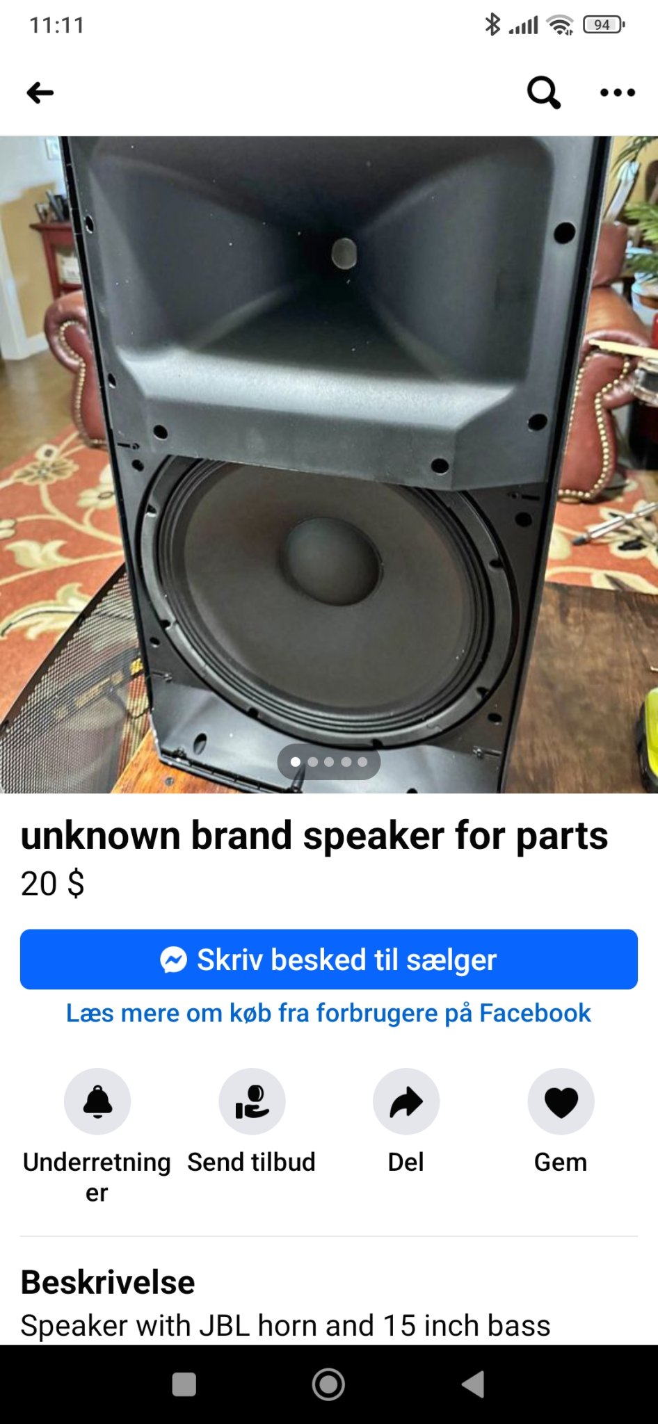

And what about this:
Put cool cloth on front of the mesh doesnt exist anymore. Or put cool/pretty cloth on the mesh.
Its a 15 inch organ tipe driver so should be perfect for both guitar and bass.
Tweeter is blown but should be bypassed anyhow. JBL horn can stay or be salvaged for a future super quality outdoor speaker.
Seal cabinet after maybe dampening with asphalt or something.
Should sound just as a good sealed guitar/bass amp.
Both suggestions are local pickup so delivery charge wont eat into the deal.
Cheers!
