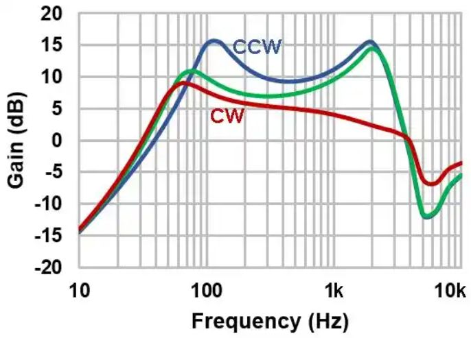

Unless the Flamma is using good internal impulses and IR cab simulation and is only EQ, it is more like 80-90% of tone. I find all EQ based cab stimulator lame. An IR loader will get you really close to a miked amp sound - I cannot tell the difference. In any case, the Flamma cab sim will be a good enough start.
Not sure what Flamma uses, but everybody praises them, so they must be doing something right.Won't the Flamma give 99%? What is an IR-loader?

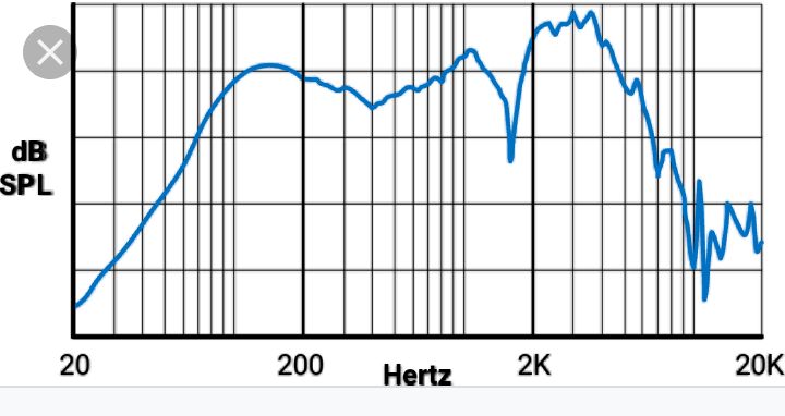

Regular cabinet simulators twist and restrict frequency response to approach Guitar speakers driven by tube amp curves.
IRs actually capture the full curve of a real speaker, which is way more complex, tons of tiny peaks and dips here and there, and digitally apply those to your sound.
Notice both curves have roughly same shape, but think analog simulators are Tang "breakfast beverage" or instant Coffee while IRs are just pressed fruit juice or just brewed coffee.

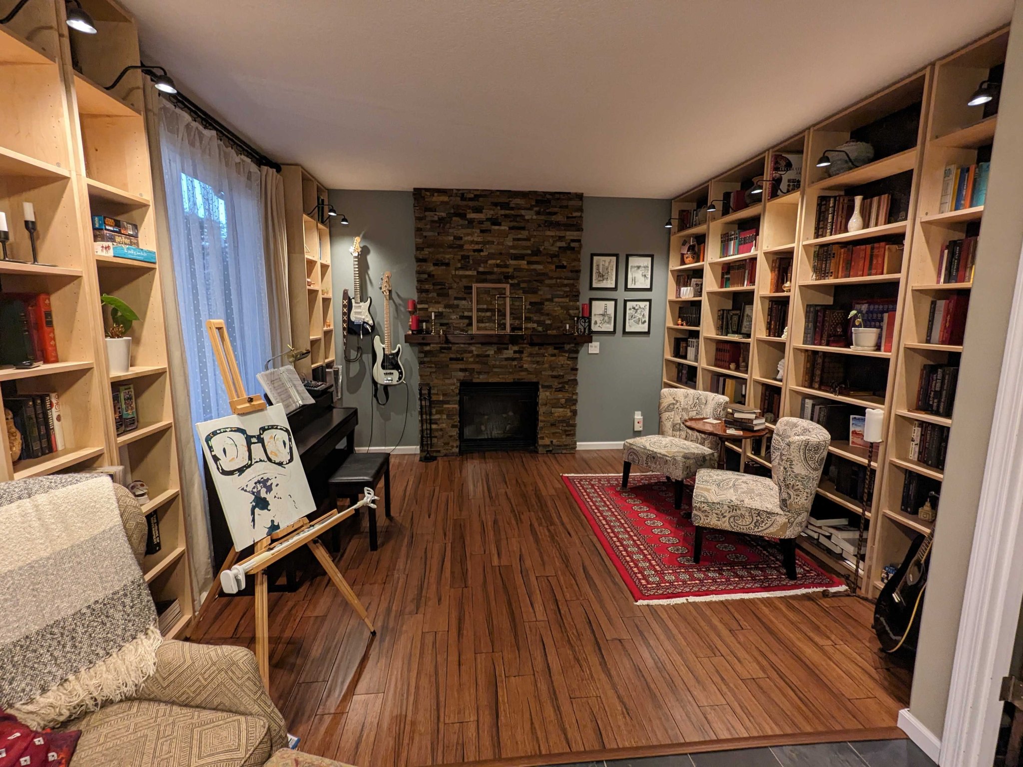

Folks, my use case is as much about keeping the family happy as about the setup quality. In addition, I record a little - just getting a hang of it at the moment, and I want to use the computer plugins occasionally.
All playing happens in the family room/library, which is also the main room in the house, so putting in a lot of stuff there is not a good option: even if there was room, it would drive my wife crazy. You know how cables multiply even with a small number of devices, and my wife meticulously cleans the house every week, and there is no way to make the cables not to annoy her, which is understandable.
And I don't want the kids to go away to play: it is kinda nice to have everyone occasionally play and practice where we live, not in far room behind closed doors.
We also do not have a stereo there. I am planning to put in a pair of decent - small - bookshelf speakers there, and a turntable soon. (At the moment, we just use a large portable bluetooth speaker for music.) I think it'd be silly to use these tiny things for bass.
