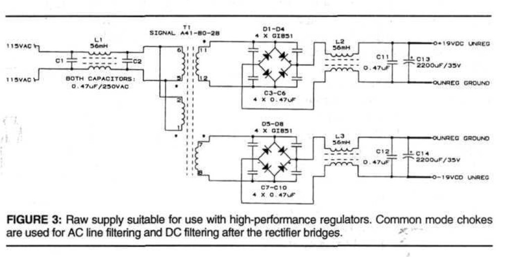

I have a suggestion: Publish the design of the power supply that is fed by the subject power cord -- in the location where a difference is detectable -- and lets see if your critics have a meaningful analysis of how and why it is "incompetent"... and how to fix it.
Incidentally, do you think these Triad transformers are a good choice?
https://catalog.triadmagnetics.com/...mount-split-pack-class-2-3-power-transformers
And chaps, is this Galo power supply competent or incompetent?

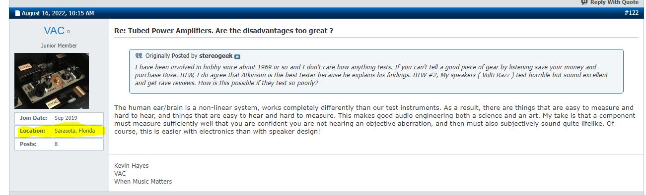

I like this quote,
"The human ear/brain is a non-linear system, works completely differently than our test instruments. As a result, there are things that are easy to measure and hard to hear, and things that are easy to hear and hard to measure. This makes good audio engineering both a science and an art. My take is that a component must measure sufficiently well that you are confident you are not hearing an objective aberration, and then must also subjectively sound quite lifelike."

Alternatively, as tombo56 suggested, Rick has an incompetently-designed power supply or a grounding issue.
Rather than pigeonhole him as delusional, perhaps y'all might make one of these threads productive for the rest of us and see if tom is right?
Encourage Rick to let us see his system and then look for the rational reason he's hearing things. I see useful troubleshooting help all over this forum.
It was in that vein that I put up the Galo PSU from TAA 1995 which took inspiration from Rick's work/opinion. Is it incompetent? Why and how could it be fixed so that power cords will behave as they should.
Of course Rick would have to participate. Rick?
