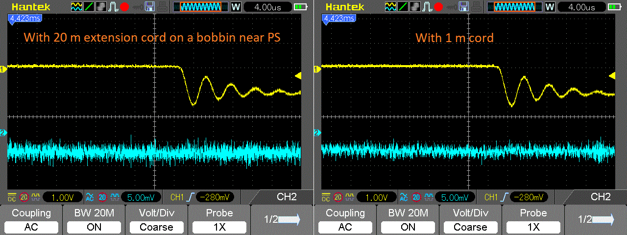

Here are measurements taken on so far used PS, with 1 m power cord and with additional 20 m extension cord coiled on some 25 cm diameter bobbin and placed 30 cm apart from the power supply. That makes an excellent antenna (visible from slightly increased RF noise in MHz range).

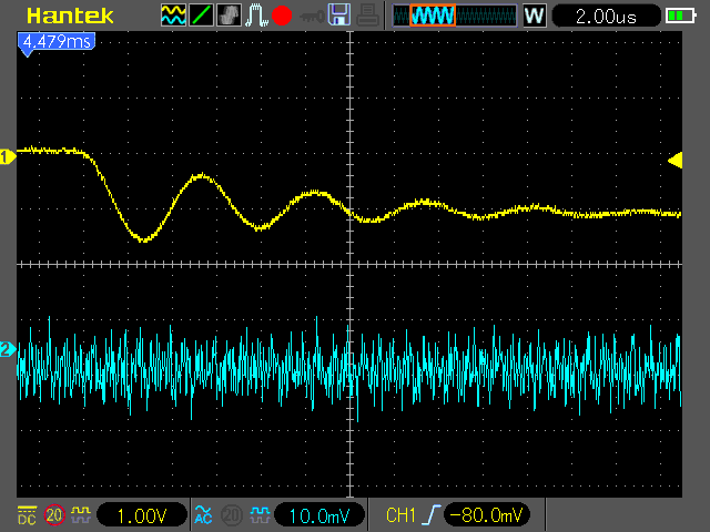

Where is that dreadful switching noise? It must be that I don’t have a clue how to take a measurement.
You are invited to show any measurement on your system that shows any difference with different power cords. Then, we can discuss what is the cause and how to rectify that.
What does it look like without the 20MHz bandlimit filter? Also, what is probe bandwidth in 1x mode? ...just wondering 🙂
EDIT: Where is the blue trace probe attached? Thanks!

Used CH2 probe had some 7 MHz bandwidth at 1x. Despite that, noise with 20 MHz bandwidth limiting is lower as noise is picked up by probe cable as well. Red dot depicts measurement STOP state. It is used to get clear measurement snapshot, as trigger point is unstable and point of interest is jumping more than 50 us back and forth.
Here is CH2 with another probe linear to 15 MHz at 1x ratio, no 20 MHz bandwidth limiter and time base which allows for higher HF resolution.
