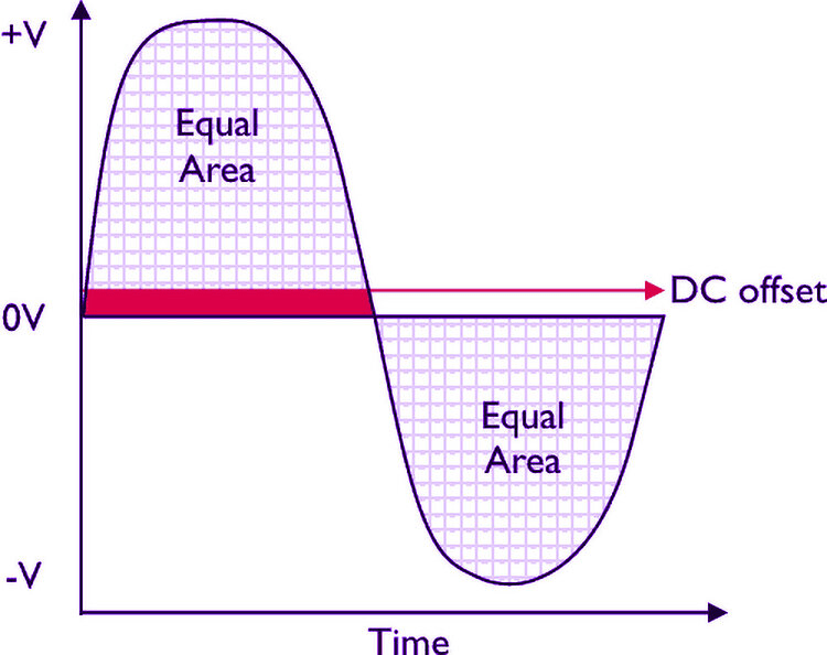

I've been reading about DC offset on the mains voltage supply caused by the likes of electronic dimmers and computer power supplies.
It is claimed that less that 500 mV of DC can be sufficient to cause toroidal transformers to become saturated, which adversely affects sonic performance and may cause audible mechanical vibration.
https://www.isol-8.co.uk/dc-on-the-mains
Is this a real phenomenon or just marketing hype?

If you are interested in finding out if you have DC on your mains, of course, be very careful as it can kill you. I have a multi-meter rated to 600V AC and DC. The thing is, you can just measure DC directly at your wall outlet, but you won't get the right answer. I tried that and measure between 100 and 200 mV DC. Wrong. Try something like the link below. I found that I had no measurable DC at all.
https://www.diyaudio.com/community/threads/how-to-measure-dc-offset-on-the-mains-voltage.350171/
Reactions: 1 user

Since you want to end up with DC the distortion on the AC line is 10000%

EDIT: Regarding sensitivity of torrid transforms to AC line DC imbalance, properly designed torroids don't have to be designed to be so close to saturation. Its just cheaper to make them that way, and happens to be possible to make them that way due to the geometry. Magnetic path length around a circle (torroid) tends to be rather short in relation to the winding window area. Standard E-cores, for example, IMHO have rectangular winding windows for a reason. It would be expected to help to keep from being wound in a way that could allow easy saturation. Magnetic path length is relatively long in relation to winding window area.
