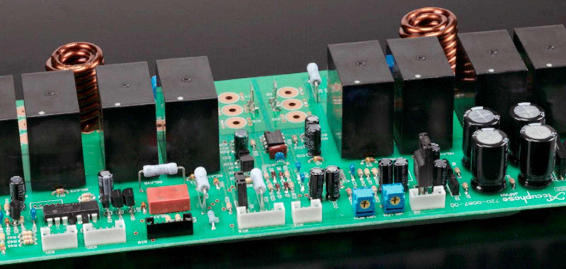

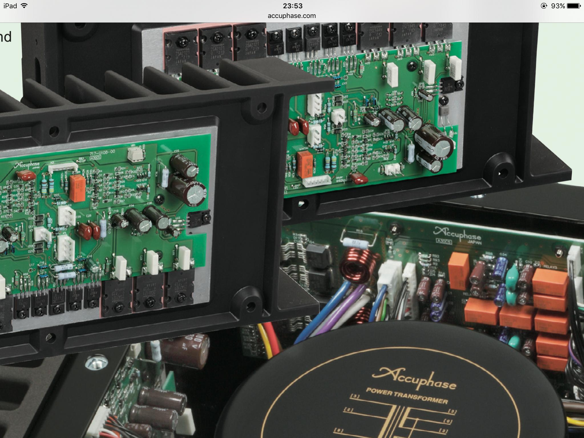

On the other hand Accuphase guys think it's OK
Wow, looks like they use really fat wire on these multi layer coils.
I am guessing it to be 2.4mm. Coil ID about 8mm, OD about 19.5mm and coil height seems to be about 34mm. Looks like 14 to 15 turns. My calculator, estimates this coil at 1uH.
Overall dimensions approx. 34 x 18 x 18 mm
That's pretty massive. Must be for really high power. But then, whats with the Mickey Mouse relay's ?

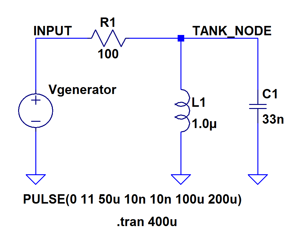

Here is the measurement setup that uses a signal generator + oscilloscope + precision capacitor, to measure an inductor.
I used a Bourns 1.0 uH, 10% inductor and an EPCOS 33nF, 5% capacitor. I connected them on my solderless breadboard, along with a 100 ohm isolation resistor. (You want Risolation to be much much greater than sqrt(L/C), so it doesn't damage the Q of the resonant circuit).

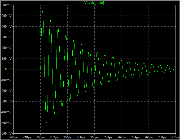

I set the signal generator to produce its largest amplitude square wave at 10 kHz. This should give slightly damped, sinusoidal ringing at the TANK_NODE and indeed, in LTSPICE simulation (2nd image), it does.

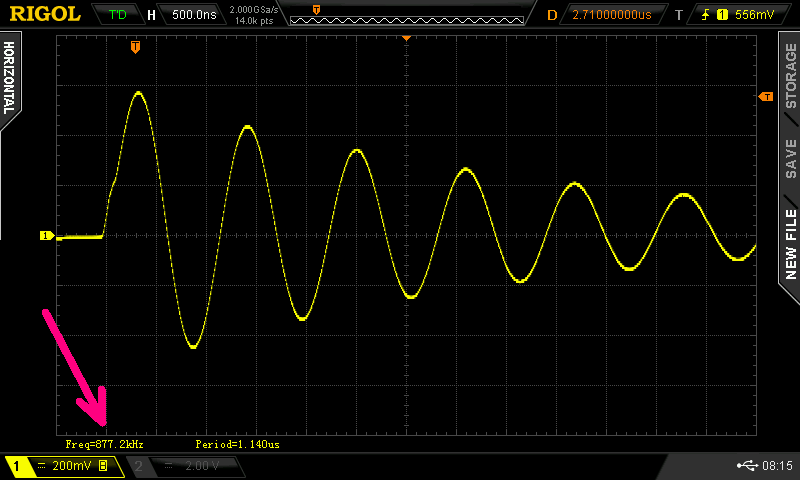

Connecting an oscilloscope between TANK_NODE and ground, I got the yellow trace shown below. In theory the frequency of oscillatory ringing should be
- fosc = (1 / (2*pi)) * 1 / sqrt(L*C)
- L = (1/C) * (1 / (4 * pi * pi * fosc * fosc))
