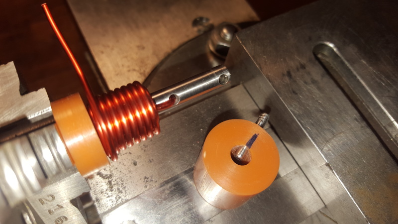

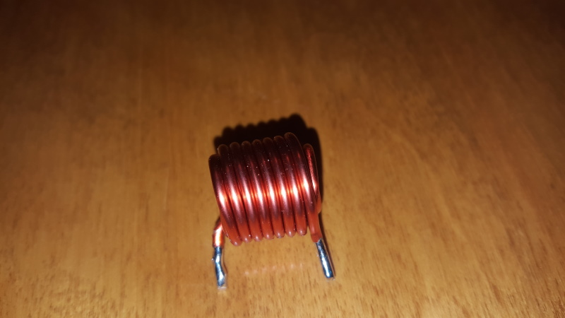

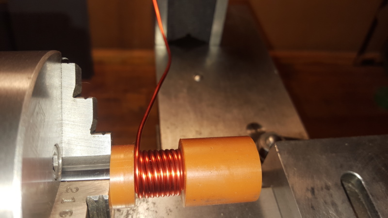

Hi Andrew,

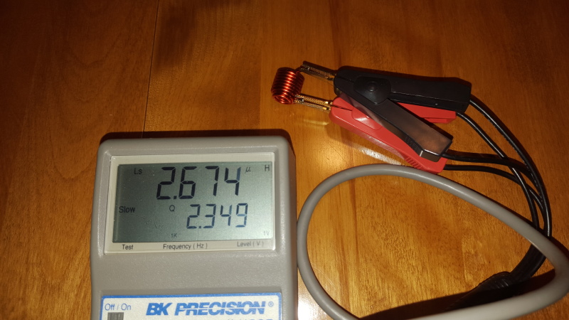

well I was bored and did some coil winding today. I opted for a triple layer coil which gives about 2.6uH right in line as for most application suggested.
Thanks everyone for the discussion. 🙂
Dear kct,
The final dimensions and winding details please !
--gannaji
Approx. dimensions are
15mm length
15mm OD
6mm ID
Wire: approx. 1.62mm (AWG14)
Approx. 24 turns (triple layer)
Enjoy. 🙂

I do understand John's point but really for most amplifier application with inductors of a few turns parasitic capacitance does not seem to matter much.
The triple layer coil I wound seems to resonate at about 10.5MHz, that gives about 90pF parasitic capacitance.
If an amp has the tendency and wants to oscillate at such high frequencies then something is majorly wrong with it that even such coil can't make up for and suppress, I'd say.
I also fabricated a two layer coil as LazyCat #11 suggested which gives 1uH and resonates at about 17MHz.

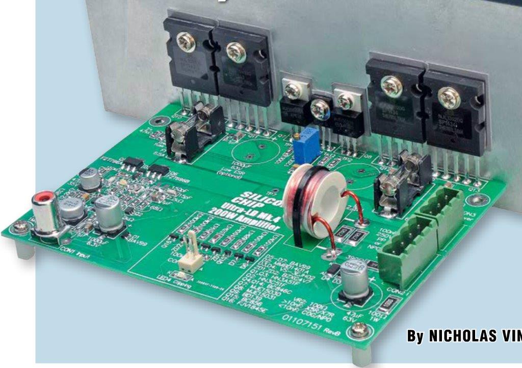

This is SC magazine's design using a standard bobbin.
ULD Mk. II used 6.8uH, then Mk. IV (pic) is 2.2uH keeping the B-field far from the front end and the right-angle gave lower distortion from unwanted mutual coupling.
I thought they also measured lower distortion with bigger 6.8uH value but I can't find that article.
