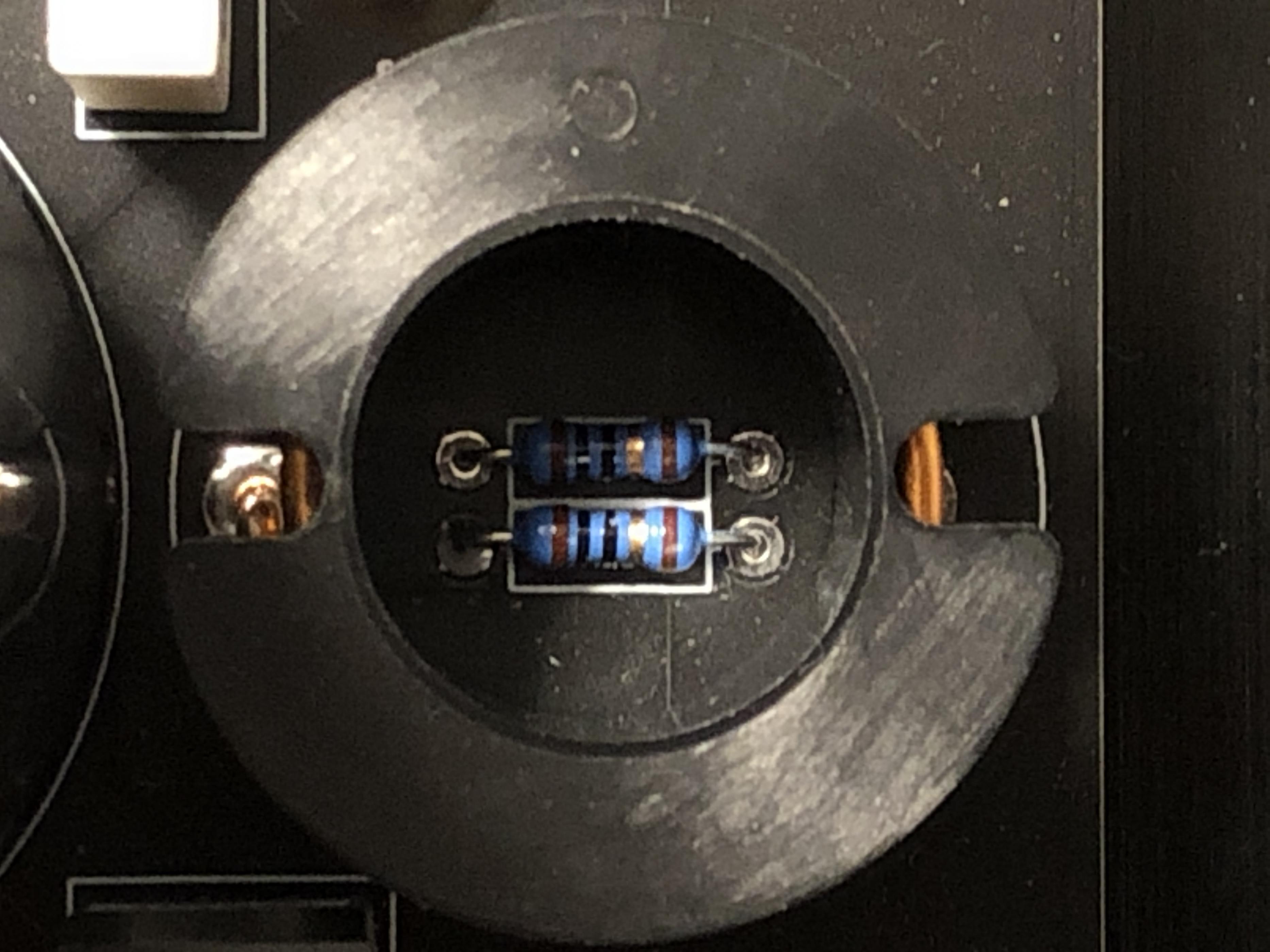

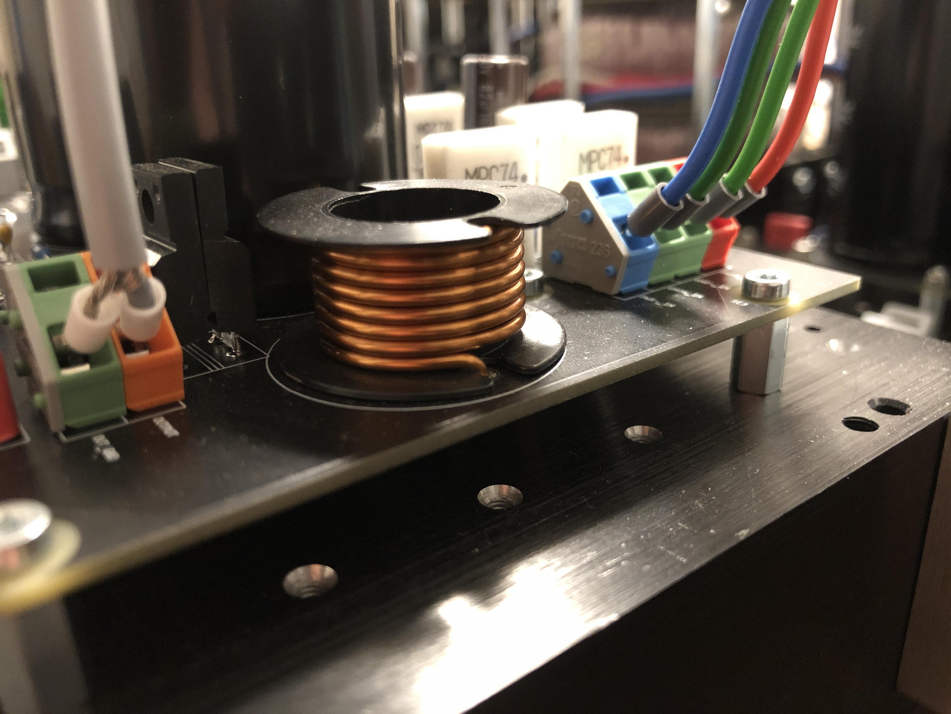

Here is how I did it. I used a plastic bobbin from Epcos B65612B0000T001 and found such a DIY inductor solution has many advantages:
Any number of turns can be realized.
The inductor is mechanically pretty stable and has the optimal form factor (square in side view).
The center may be used for placement of the parallel resistors.
The bobbin is not too expensive and the final inductor looks professional.
I found wiring the inductor challenging using 1.5mm diameter wire and partially broke some bobbins due to high force applied during manufacturing. The resulting inductors with broken bobbin work well but no longer look nice and professional.

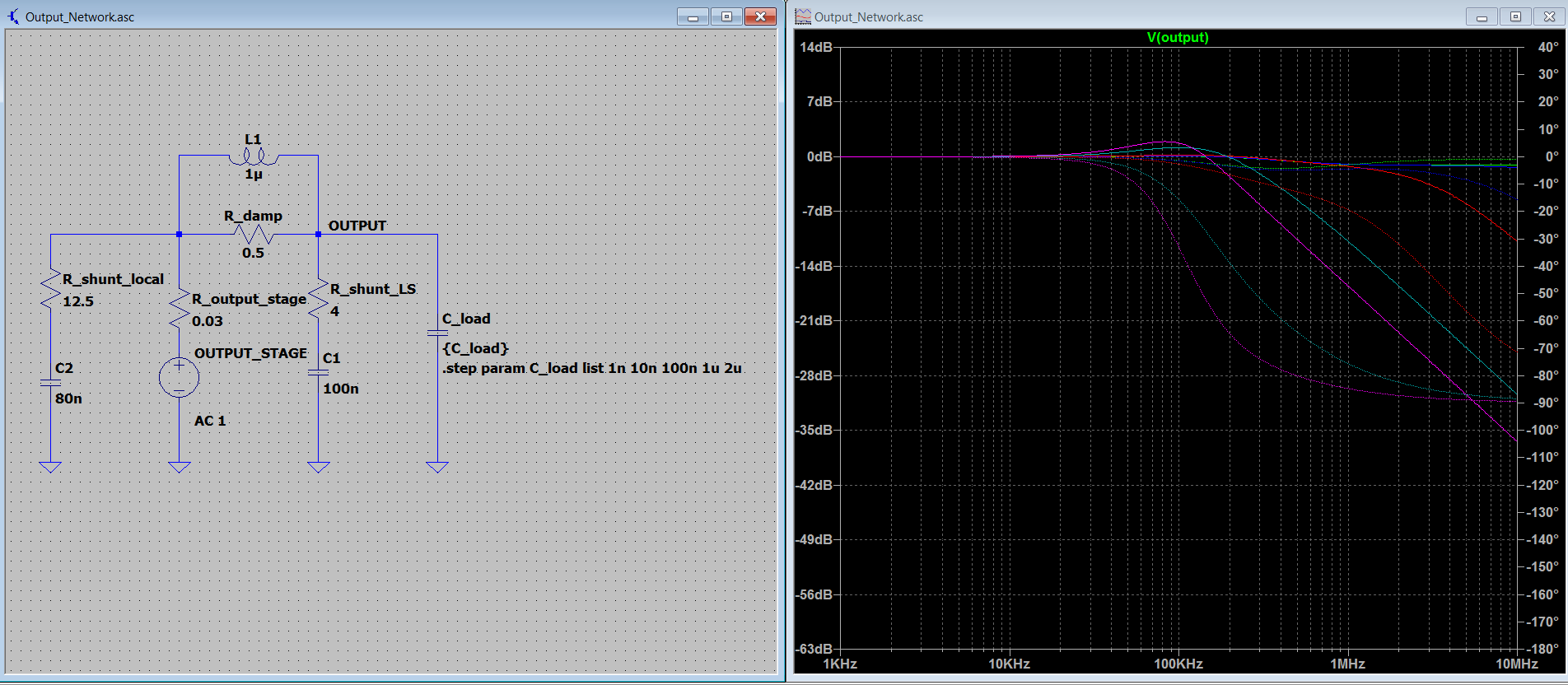

According to calculation, the inductance of the inductor I made should be 1uH.
In parallel to the inductor I have 5 Ohm.
Together with the R-C shunts at each output stage transistor and the loudspeaker output, the amplifier is surprisingly stable into pure capacitive loads up to 2uF.
BTW: I found an interesting article about output inductor damping: Output Inductors.
It seems to be a good idea to investigate the output network in detail in order to optimize it.
In my case, the damping resistor of 5 Ohms is just a random value, just like the other components. 🙂 Probably I should do a simulation to see whether this makes any sense.

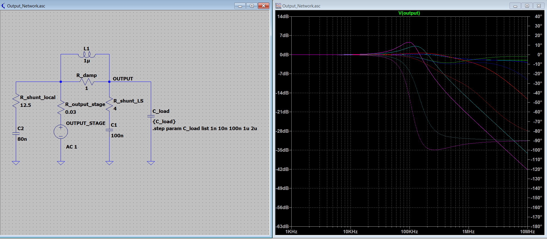

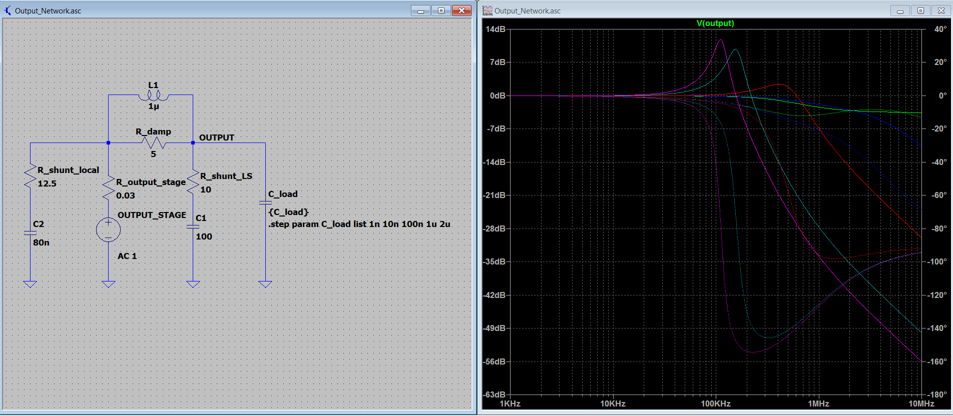

Trying to optimize inductors when using LTSpice is rather tricky because the inductors in LTS don't model 2nd-order effects. By which I mean skin effect and proximity effect. These effects increase the losses as the frequency goes up.
Lee - do you think it might be a better model if the speaker cable were included between the far side of the series L and the load capacitance? Admittedly one would need to guess about the length (and gauge) of the cable but I have the notion that resonance effects might be lower due to losses in the cable.
Yes, simulation is mostly an approximation and results likely not accurate. However, it is a coarse indicator and super convenient.
Speaker cables are highly complex on their own. I would not know any values to assume here. Cables both present an inductance and capacitance. Fancy audiophile cables may have substantial capacitance and may destabilize amps with sub-optimal output filters.
I placed another R-C shunt after the inductor in order to maybe mitigate the effect of fancy cables and loads a bit.
In simulation, this R-C shunt helps to tame resonance caused by the load capacitance a bit.

Here is how less resonant filters could look like.
I'm just not sure whether fighting the resonance is a good idea at all.
By lowering the damping resistor of the inductor, the amp get more exposed to the load capacitance.
Lowering the output R-C shunt resistor also subjects the amp to more capacitance at the output, especially with low dampening resistor at the inductor.

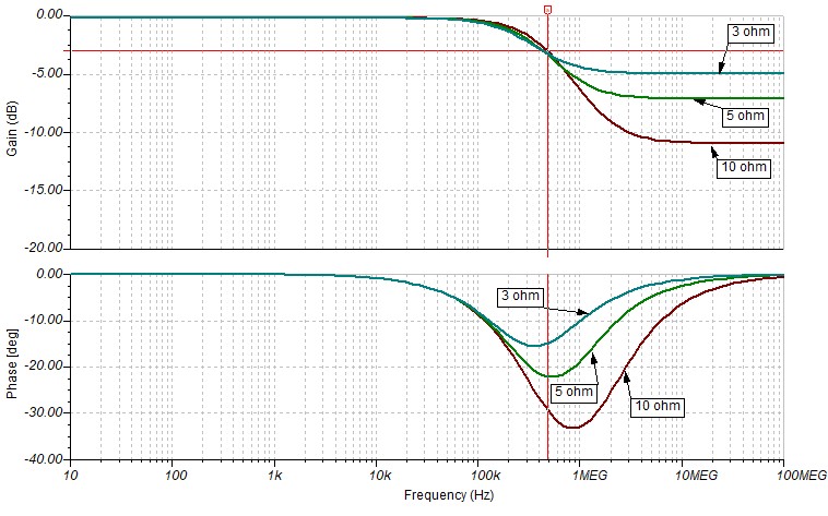

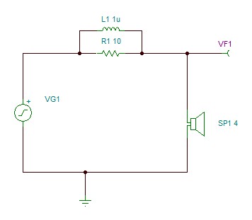

Series Inductor with Speaker load is Basic RL LowPass Filter.
Additional parallel resistor with L will change Slope and Phase.
Basic Model as Shown with R1 changed from 10R , 5R and 3R
Assuming a amp going unstable around 1 to 5 MHz
Seems the filter slope / phase shift of the Higher Resistor Value is more notable.

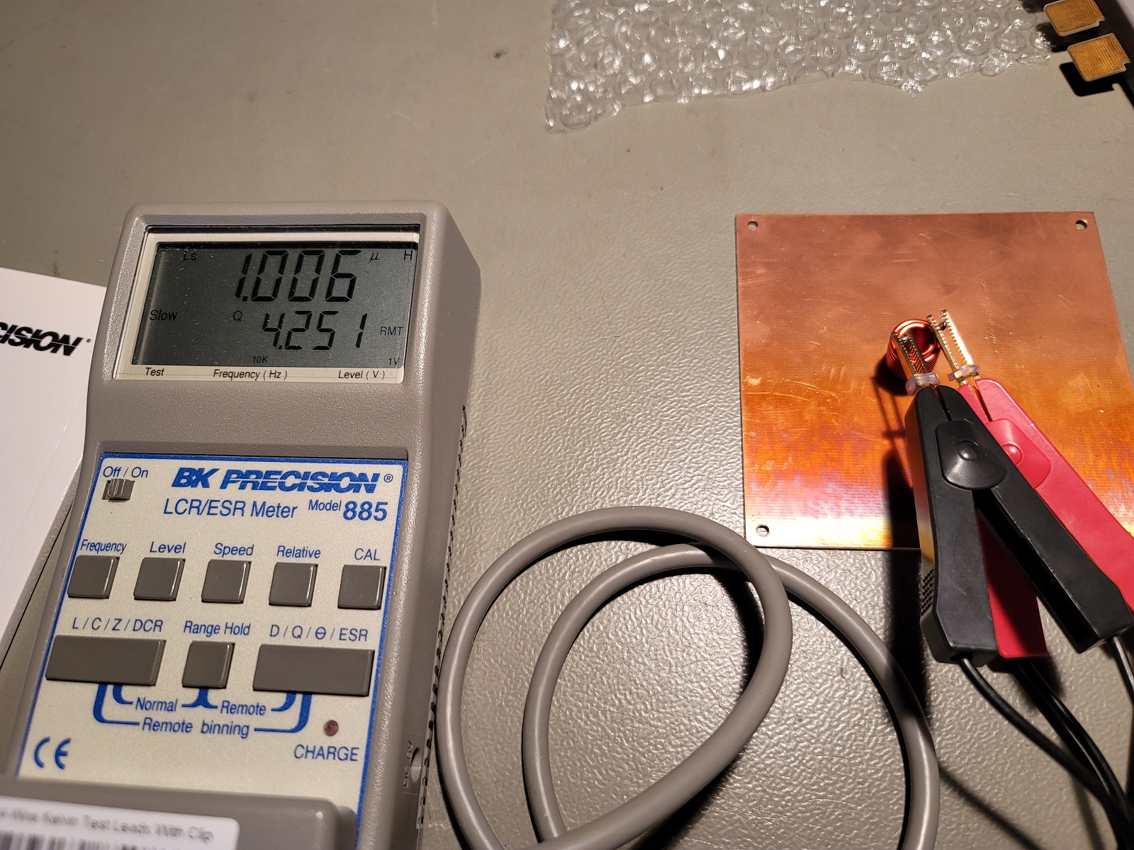

You have the end of the coil square against the PCB where is couples most strongly, inducing voltages in the traces under/near it to a maximal degree. If there's only groundplane underneath it forms a shorted turn coupled to the inductor changing he inductance and allowing large ground circulatory currents.The inductor is mechanically pretty stable and has the optimal form factor (square in side view).
Mount cylindrical inductors either on a separate board if you can, or else with the axis horizontal so that less flux cuts the PCB.
The good news is induced voltages and currents from the inductor are linear, the bad news is supply currents coupling direct into the inductor may be very non-linear and increase the distortion noticably.

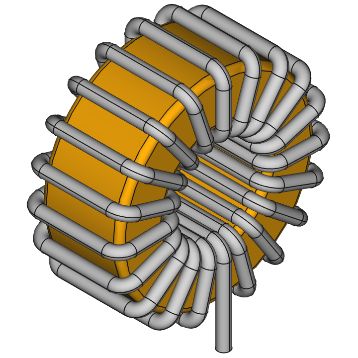

Attached is a CAD preview of the finished air core toroid inductor.

Main challenges would be adding fillets or chamfers to the edges of the toroid and to wind such a strong wire onto such a small toroid.
I haven't calculated inductance yet, but would guess that it takes less than 20 turns to reach 1uH inductance.

Mark has a point. I went ahead and did some superficial measurements.
The images show the difference with and without a ground plane beneath the coil.
Altho with a measurement frequency of 10kHz the effects are noticeable but perhaps insignificant enough to worry about in this application.
- Power Amplifier Output Inductor specification
