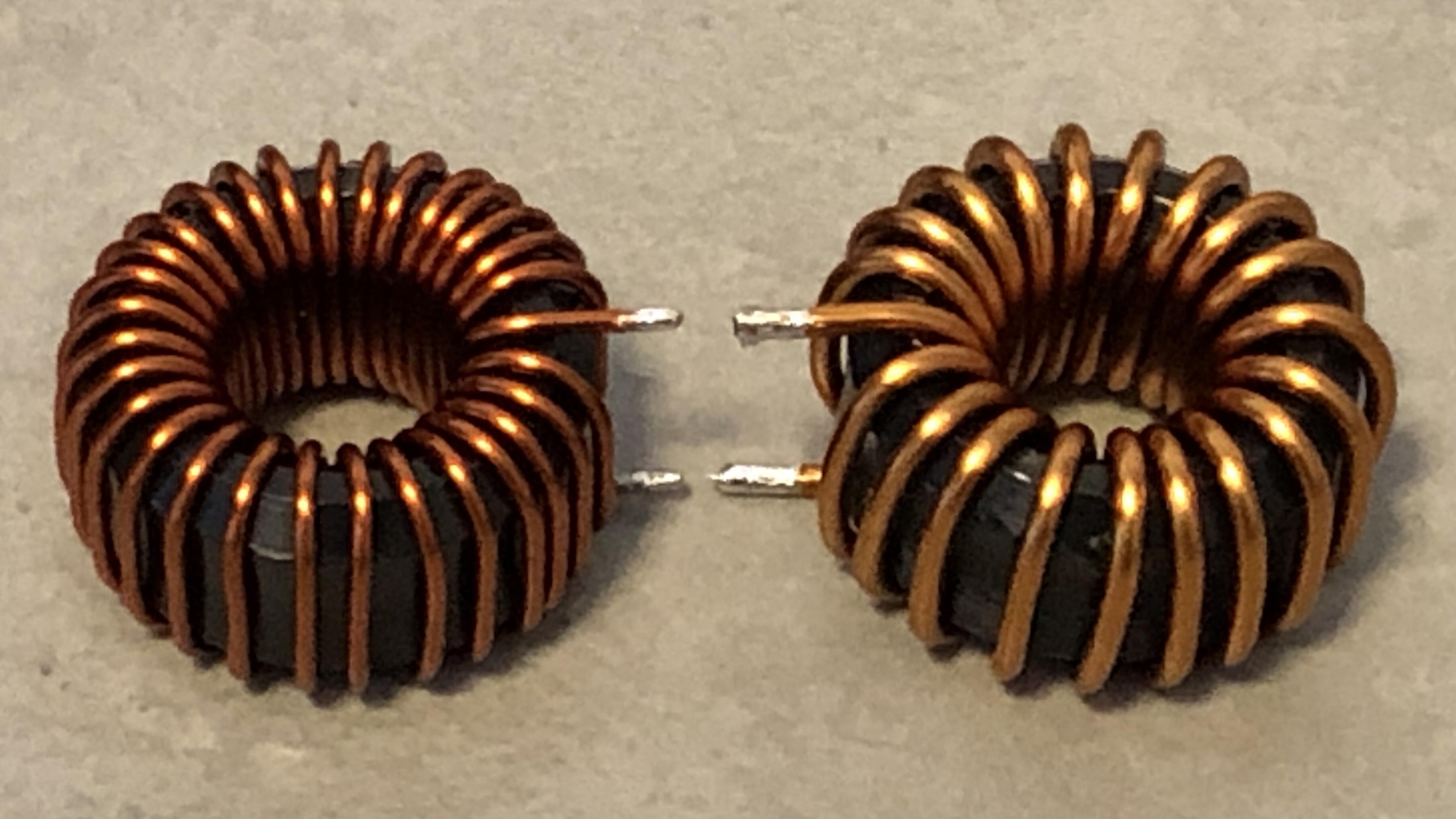

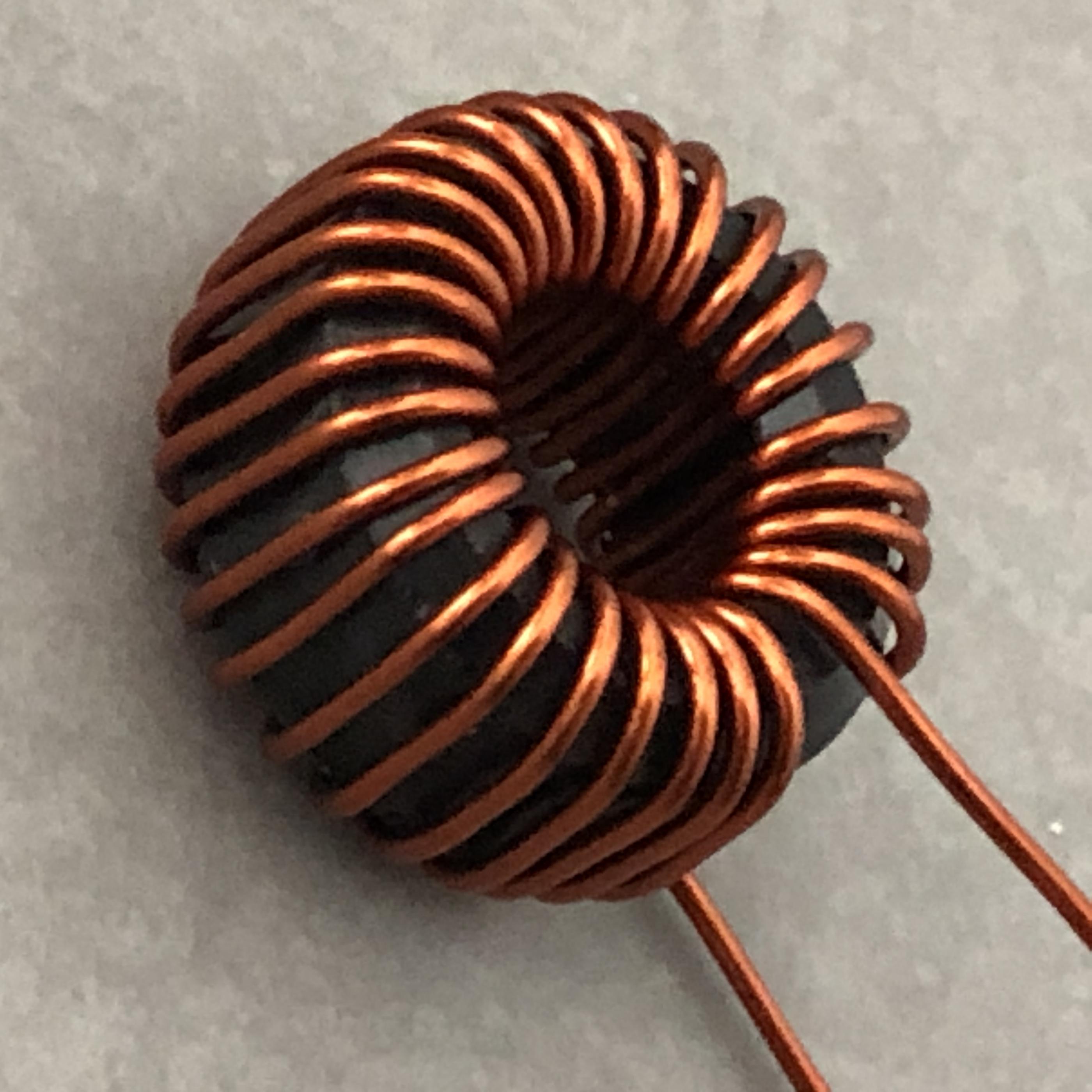

Meanwhile I figured out that the inductor I presented previously has much lower inductance than I thought. I just didn’t put as many turns on the core as planned and don’t see a chance to follow my initial plan. I added two more turns and believe the inductance is between 1.3uH and 1.5uH now.
And I made another inductor with 1.5mm diameter wire, which also has lower inductance than planned. This one was planned to have 1uH and I guess I achieved around 600nH maybe.
