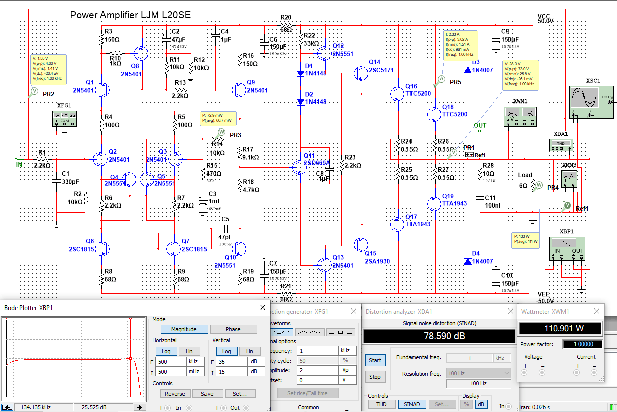

This is my MOD of the original L20SE (with the real Toshibas TTC5200 and TTA1943). The multisim file is attached to this post.

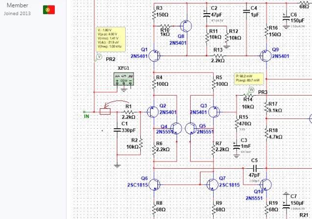

you have positioned the R1C1 input filter incorrectly

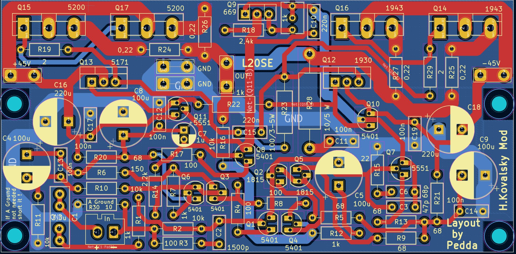

the L20SE kits had been delivered from china. I measured the output transistor holes and the mechanical holes to get them similar to the original pcb. Well done, i think.
I made little changes on my pcb to get some copper lines shorter, moved a transistor and capactitor and other little things.....finished and uploaded now. jlcpcb...

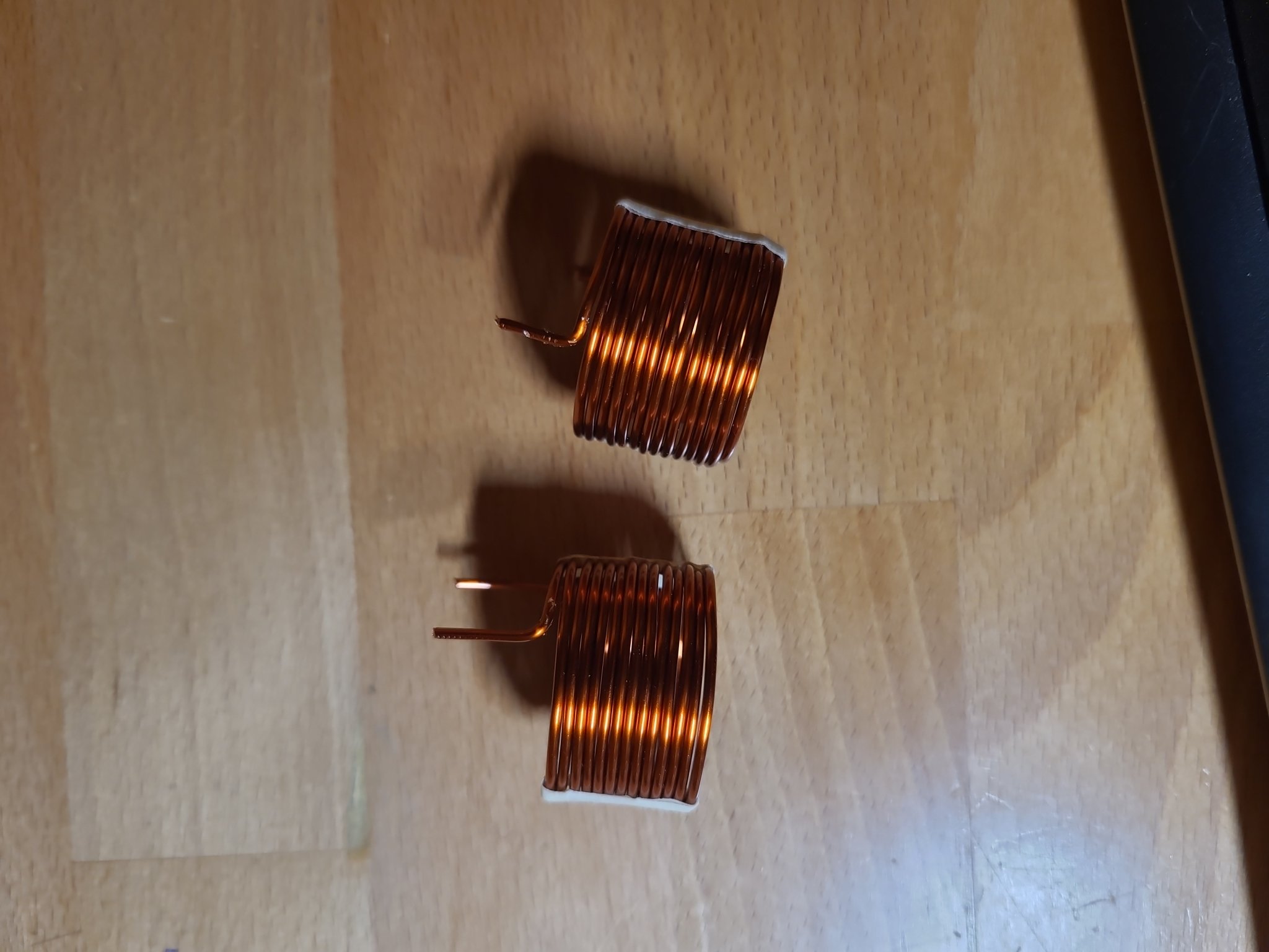

I made two 4µH coils on a 26 mm kukident roll. 🙂
I have got all teeth...kukident is needful for the toilet...and for copper coils 😎

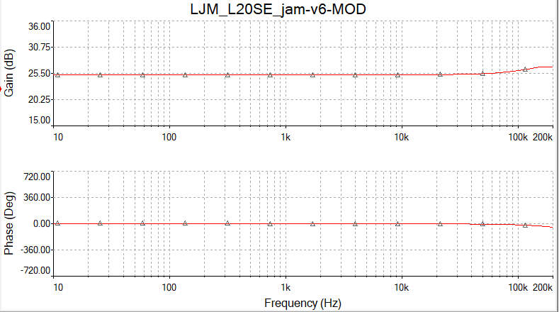

The input and output filters operate outside the 20-20 kHz frequency range of your best DAC.
1. Regarding the input filters (also called High Pass filters, or just HP filters):
  • In order to to push the input cutoff frequency below 2 Hz the HP filter must consist of a 5-µF coupling capacitor. These are either electrolytics (with all their problems), or bulky and expensive film capacitors like, for instance, Wima MKP 10.

Hum... let's see:
"With a 20 kR input return resistor, a 5 µF coupling capacitor is required to push the input cutoff frequency below 2 Hz. This capacitor should be of very high quality."
source: pg. 155, Designing Audio Power Amplifiers, Bob Cordell, 2011, ISBN: 978-0-07-164025-1
The formula for frequency cut-off is fc = 1/(2*Pi*R*C) Hz.
In the L20SE, the return resistor is the 10K R2.
So, to achieve the desired cut-off frequency below 2 Hz, the coupling capacitor should be 8 uF (cut-off: 1,98943678864869 Hz).
To avoid electrolytics you would have to either use multiple expensive/bulky PP/Polypropylene, or look at the less than optimal PET/metallised polyester (not exactly the realm of "this capacitor should be of very high quality").
To be more precise 6.8uF
That's right, that's exactly what I use
Cut-off frequency around 15 to 20Hz is usually involved, not 2Hz.
not true, because The cutoff frequency should be lower by at least an octave, or even better by 10 times i.e. at a frequency of 2Hz. This is due to a change in phase.

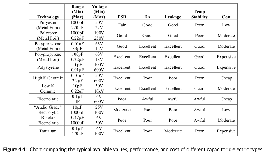

More often than not the source already has a decoupling cap so if you are doing the amp for yourself you may not need additional coupling caps.
My amp don't have a coupling cap and my source is dc coupled (5532 direct via 100 ohm resistor) and there are no issues. The feedback filter in this amp lowers the gain at DC so a small amount of DC on the input stays small.
If you insist on a coupling cap I suggest you test them is your system. You may find that you prefer a 47-100uF BP elyt over a 5-8uF PP cap.
PS, that table is too general because you cannot possibly claim for example, that every Tantalum between 0.1 and 470uf have identical characteristics. Same for all the others.
Your statement contains a syllogistic fallacy. You cannot possibly claim, for example, that the author states or the table implies that capacitors within each class of dielectric capacitor types must have identical characteristics. They only need to be typical enough to be grouped into each class of capacitor types.
