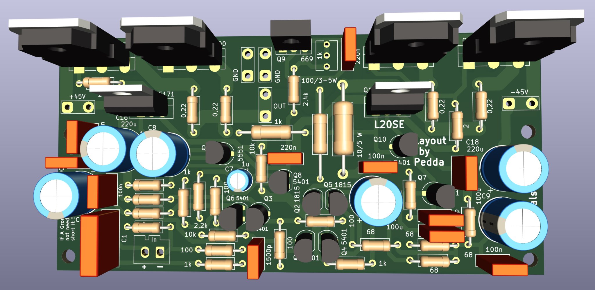

My pcb's had arrived. But i had to register that some coponents need more space, to near to others, the final pcb was not the final. 😕
I had to made three changes.
For testing i could use the pcb, but thats not my claim. I have done the necessary changes in Kicad and new gerber files are uploaded...
Good news..the holes on the pcb for the transistors and screwholes are similar to the original pcb.
Especially the 0,22 ohm resistors need more space to the other components. I have made a own version in the foodprint editor and tested the necessary space.
For other projects i will save such a footprint in the libary, because the change only is not shown right in the 3d view.
I guess it takes a little bit more time to build the mod...

Hello Peter!Peter
Please post a diagram with the values that will be on the new board with the tweak. So that I can check the modes in more detail and, if necessary, adjust the compensation and general settlement.

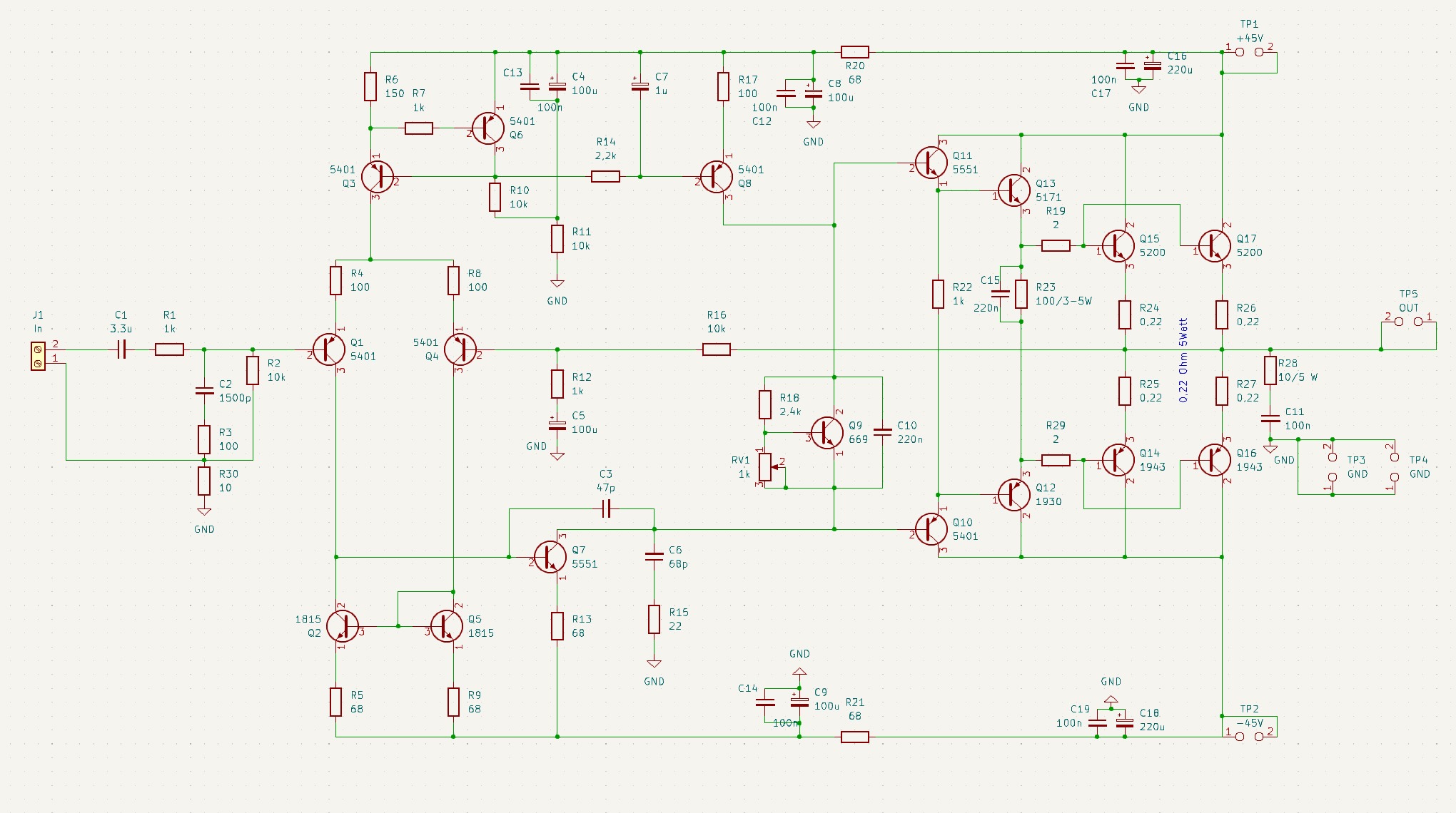

Hello Hennady,
what do you mean with a diagram with the values ? I hope you want to get the schematic ?
In appending to the schematic my new pcb.

Yes. that's right.Hello Hennady,
Thank you.

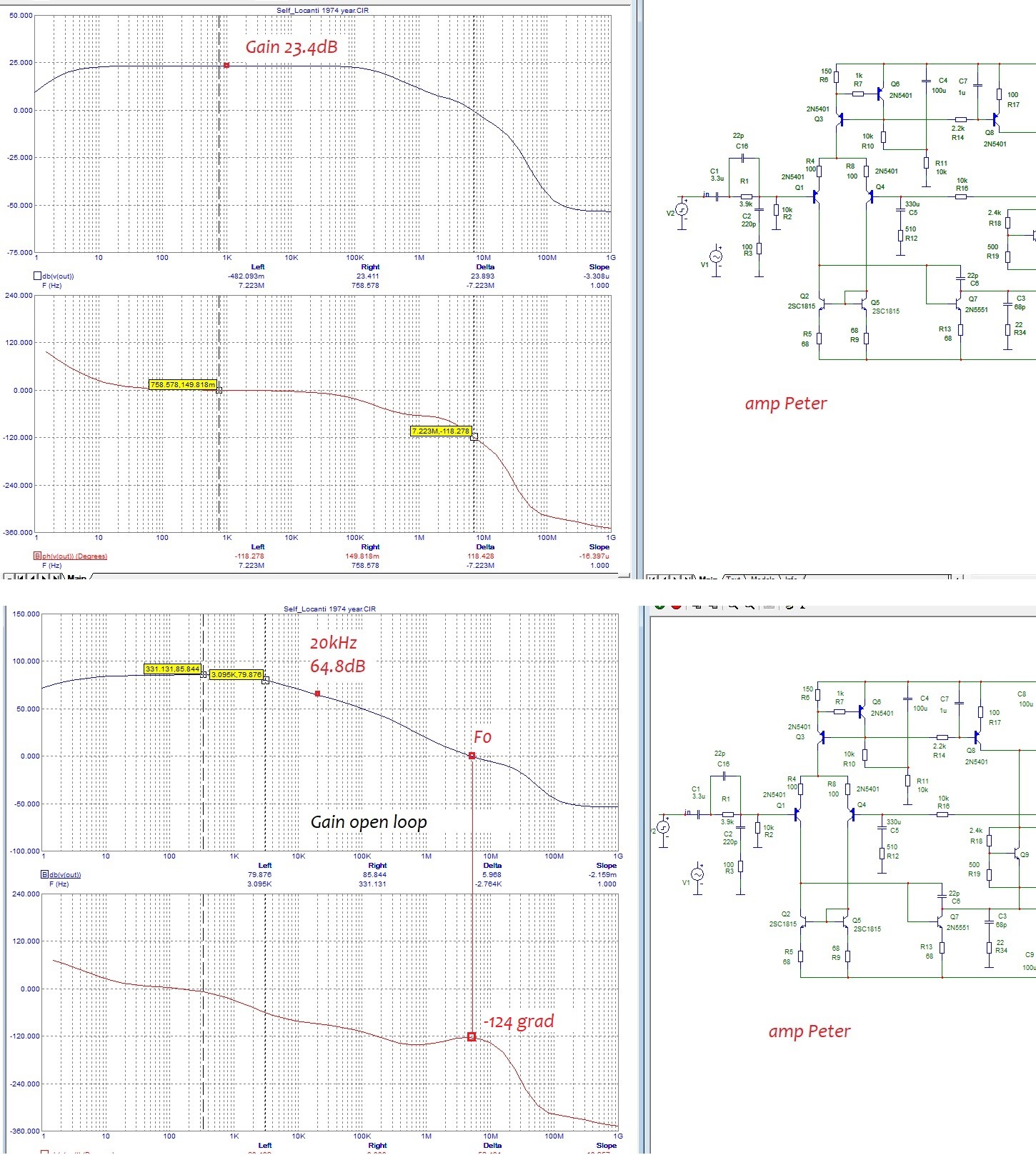

Progressive compensation is the process of changing the frequency characteristics of a signal in the range from 1 kHz to the unity gain frequency using links of zero (R) and first order (RC) circuits.but you can try to explain the progressive compensation you made.
application options
1st compensation in the local feedback circuit
2nd compensation outside the feedback loop
3rd combined option (outside the loop and in the local feedback loop)
* according to the 1st option, everything is clear - this is Miller’s common compensation.
The main application is operational amplifiers, because such compensation is stable at any gain from 1 or more.
* according to the 2nd it is applied for a certain gain, because Ku is included in the calculation of the parameters of the RCRC circuit.
An amplifier is an amplifier to amplify sound, therefore, unlike operational amplifiers, audio power amplifiers have a completely fixed gain
The calculation is based on the "state variable method" for calculating filters. The state variable method is based on the orderly composition and solution of a system of first-order differential equations that are resolved with respect to derivatives.
Most common in audio the second option for progressive compensation is "Loudness" compensation in the audio frequency band;
in our case, the amplifier compensation frequency configured an average of 700 kHz.
The filter of acoustic systems is also calculated using the method of variable states.
the implementation of the 2nd option was first seen in the scheme of ours with you fellow countryman Michael Wiederhold in 1977, and began to be seen more often in schemes after 1998...
* 3rd. A combined compensation option is used in the case when, when controlling a push-pull output stage, its input resistance at high frequencies becomes either equal to or less than the load resistor of RC-shunt - at the input of the power output stage.
I see the implementation of the 3rd option in Cordell’s some diagrams

This can be seen in the open-loop frequency response if, with increasing high frequency, the gain changes sign from decreasing to increasing, this is a complex variable. and this means that one of the amplification stages (usually the first) amplifies a wider frequency band than the next one, if the resulting high-Q peak in the frequency response cannot be corrected by increasing the gain of the first stage or reducing the gain of the second stage, then it is necessary to add compensation in the negative circuit feedback, and this is not from the output point of the amplifier, but this is either a high-impedance point - the point of operation of the voltage amplifier at the output stage, operating in class A, or for example, the first stage of the Lokanti output stage follower.The third case i dont understand yet. No idea how i could work "its input resistance at high frequencies becomes either equal to or less than the load resistor of RC-shunt"
Of all the options for compensation solutions, only single-pole correction using zero or 1st order circuits ensured ideal sound reproduction on any music.But i trust in you. It seems you have a big knowhow in designing an amp or making a mod to an other amp.![]()
The most important condition is that this amplifier compensation pole does not fall within the range of maximum human hearing sensitivity - this is 300Hz-3kHz.
Those. so that the pole is will by:
* in the frequency range 120 - 300Hz for the first compensation option (I also do not recommend below 120Hz, because in acoustic systems the low-frequency speaker begins to work with the linear stroke of the diffuser, and it is very important for the quality of reproduction of low frequencies that the depth of negative feedback be linear )
*pole at compensation in the frequency range from 3 kHz and higher - for the second and third compensation options.

Hello PeterHello Henneday,
look at the attachment.
* denominations that should be replaced are red highlighted
*additional - must be added сapacitor "Сextra" parallel to R1
- gain resistor R12 reduced before 510 Ohm
- Capacitor C5 should be increased in value before 330uF min, this will reduce 5,7,9 harmonics in the distortion spectrum.
The gain pole turned out to be at 1.8 kHz, but if you look at the linearity of the open loop gain in the range of 300 Hz - 3 kHz, it is +/- 3 dB. that's not bad either.
