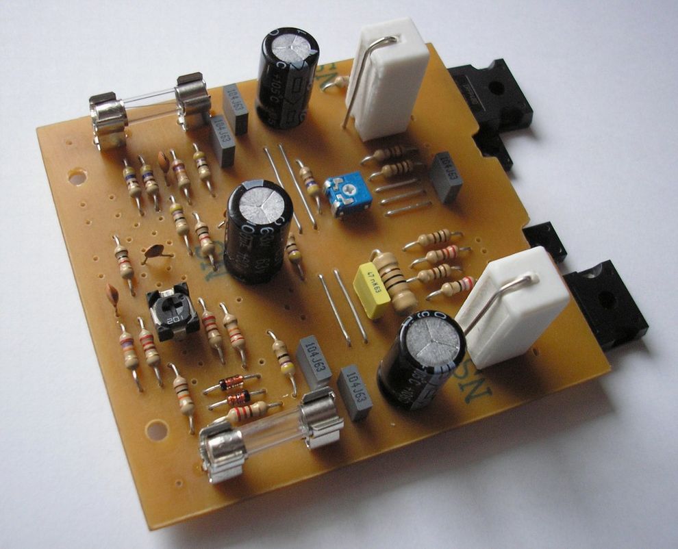

Finished Nmos 200
I'll test it later this week.

Re[01]: Finished Nmos 200
As always fine building and PCB technique by the quasi GOD.

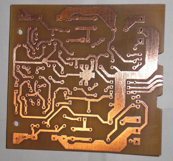

marus said:my PCB ...![]()
Cool, what are the notches at the end for? Good luck with the build.

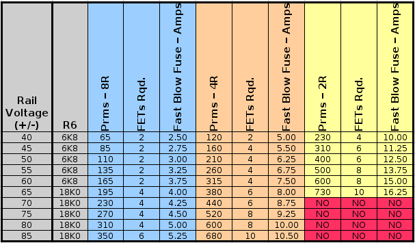

Hi all,
I have updated the Table of Post # 285 to include the R6 value based on Vrail and fusing for the required load power in my comments of Post #1190.
Please note that the above referenced table has been reposted as is a few times in the thread. I do not have the time to find those postings to list them in reference to the updated table attached with the fusing and R6 columns added.
I have used Andrew's suggested method in Post #1451 to calculate fusing.
Please note that this table does not agree with quasi's recommended fusing shown on the quasi PCB layouts. Quasi's recommended fusing for 6 FETs for 4 ohms is 5 Amps, for the 10 FETs for 4 ohms is 10 Amps and the 4 TO-220s/2 TO-247s based design of 4 Amps which I believe is fusing rated for 4 ohms. I am not sure if quasi's fuse recommendations are based on using slow blow fuses, which may account for the lower fuse rating quasi suggests.

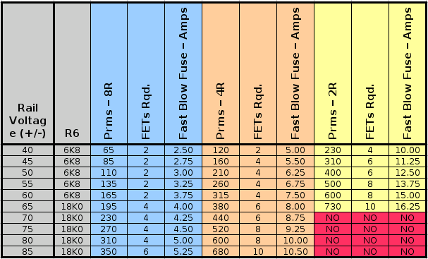

Hi All,
Sorry, one last update to the table so the headings do not bleed into the borders. I managed to find where the setting was to control this after looking a few times earlier.

Hi Pejinm,
Did you use fast or slow type fuses? Rail voltage and speaker load for your amps?
The chart I posted is certainly open to revision. For sure if one's normal music listening levels are typically in and about the 1W-5W RMS range then the fusing from the chart can likely be reduced by about 35% - 40% I would guess.
