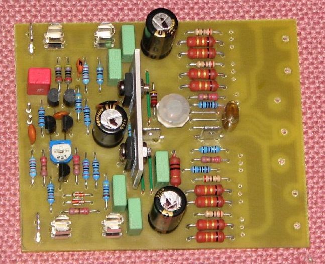

Besides the power stage changes i see that are diferences in the input stage from nmos350 to nmos200 schematics :
R3, R17 from 33K to 27K
T1 T5 from 2SC1845 to BC546
R6 from 18K to 10K
Why ? The imput stage isn't the same for all output power versions ?

R17 was changed so that the gain makes more sense for rails of 50 volts. R3 was changed to match. T1 & T5 was changed to BC546 because it is more common and is suitable for lower rails. The only reason the 2SC1845 found a place in the amp was because of it's high Vce, but at $1.00 each I'll use them where they are needed. R6 was changed to 10K so that it did not drop as much voltage leaving enough across T4 so that it worked properly.
Anyway here's a pic of a half completed Nmos200, waiting for it's output stage.
Cheers
Quasi
marus said:
Very very very nice "half completed Nmos200" 😱
I'm looking forward to make this version.
So .... this nmos200 meens 200W RMS on 8 hmms ?
Marus,
The 200W rating is for 4 ohms, therefore the 8 ohm rating would be 100W assuming output devices of suitable power handing ability are used. This assumes a well designed power supply.
