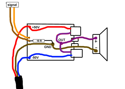

Marus,
You'll have to use the Speaker-GND pin on the PCB fpr both GND.
So I'll use the gnd Pin for the incomimng PSU wire and the outgoing Speaker-wire.
Alternatively you could only apply the incomimg GND (from PSU) to the PCB and get your speaker GND from your star-ground.
Greetings
I think i understand now ... 🙂
is that 10r on the PCB linking signal ground to decoupling ground?
If so, then that is the short route low impedance connection for HF across the PCB.
You can add a direct wire link from the RCA ground to the floating Central Audio Ground (esure the RCA ground is isolated from chassis).
Also bring the PSU 0v common to CAG and
the Zobel return to CAG and
the safety earth disconnecting network to CAG (one for each channel) and
transformer centre tap to CAG.
